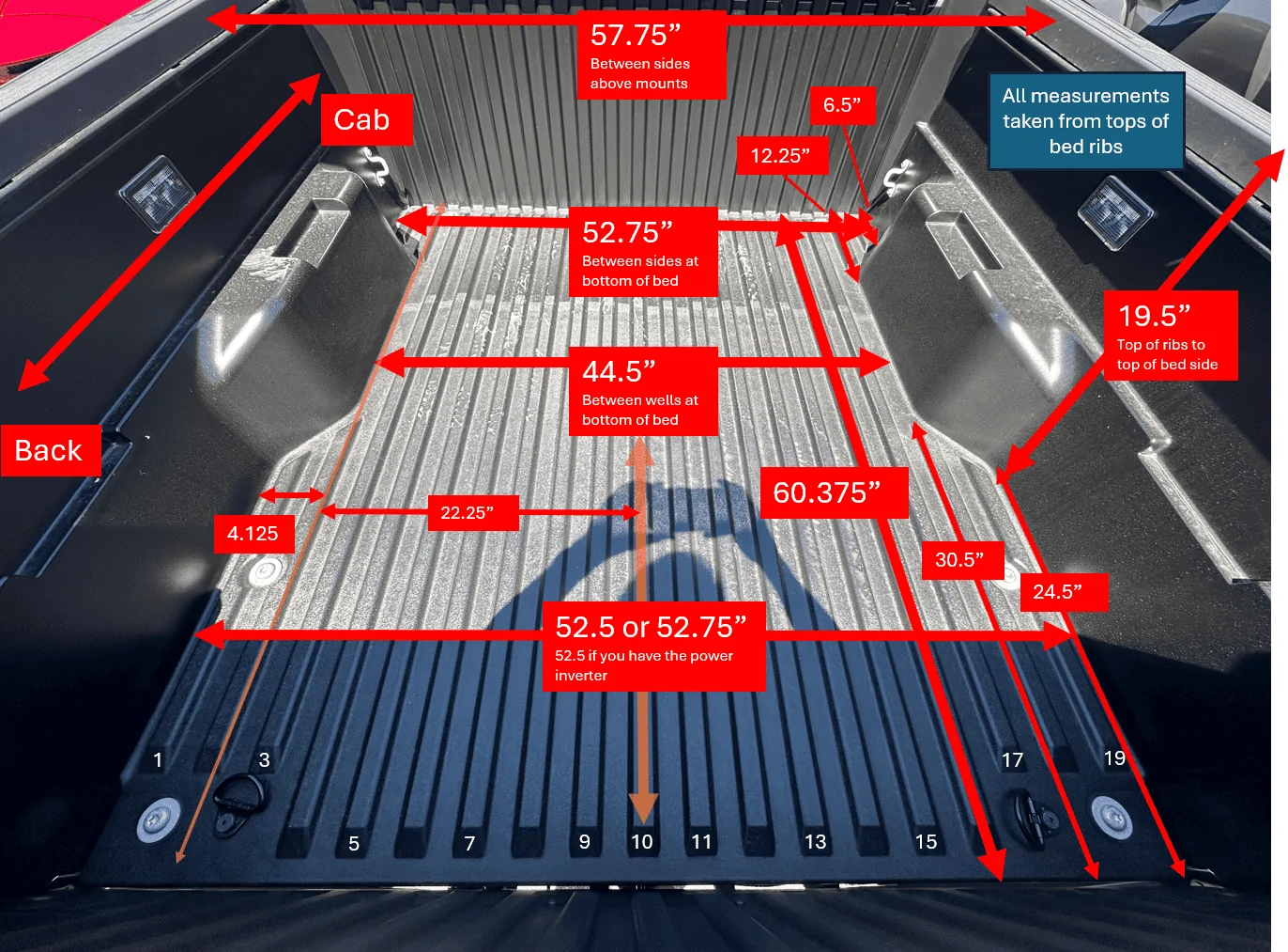

I'm working on a camper build so I took some pretty detailed measurements of the 2024 Tacoma 5' Off-Road bed! Sharing in case it helps someone else!
Solid work on the detail. I just sent this to one of the shops that's doing part of my buildout for my Trailhunter to be (once it arrives after QC hold).

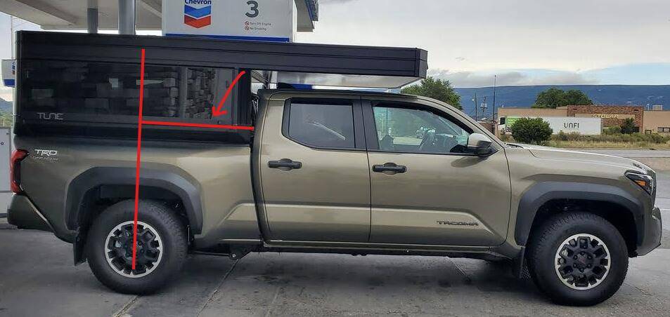

I'm not quite sure which measurement you're talking about, could you annotate a picture? Is it what I drew here, where if you took an imaginary line straight up from the center of the rear axle and then measured horizontally to the back outside of the cab?
2024 Tacoma 2024 Tacoma (4th Gen) - 5' Foot Bed Measurements - Detailed Dimensions Screenshot 2024-10-18 114055
I have my 5' Tacoma now, so I'm happy to try measuring things, but I'll need ya to be much more specific! (Yes this photo is a 6' one, I just found one online of a side view to annotate for clarity)

yes exactly that size! Thanks a lot!

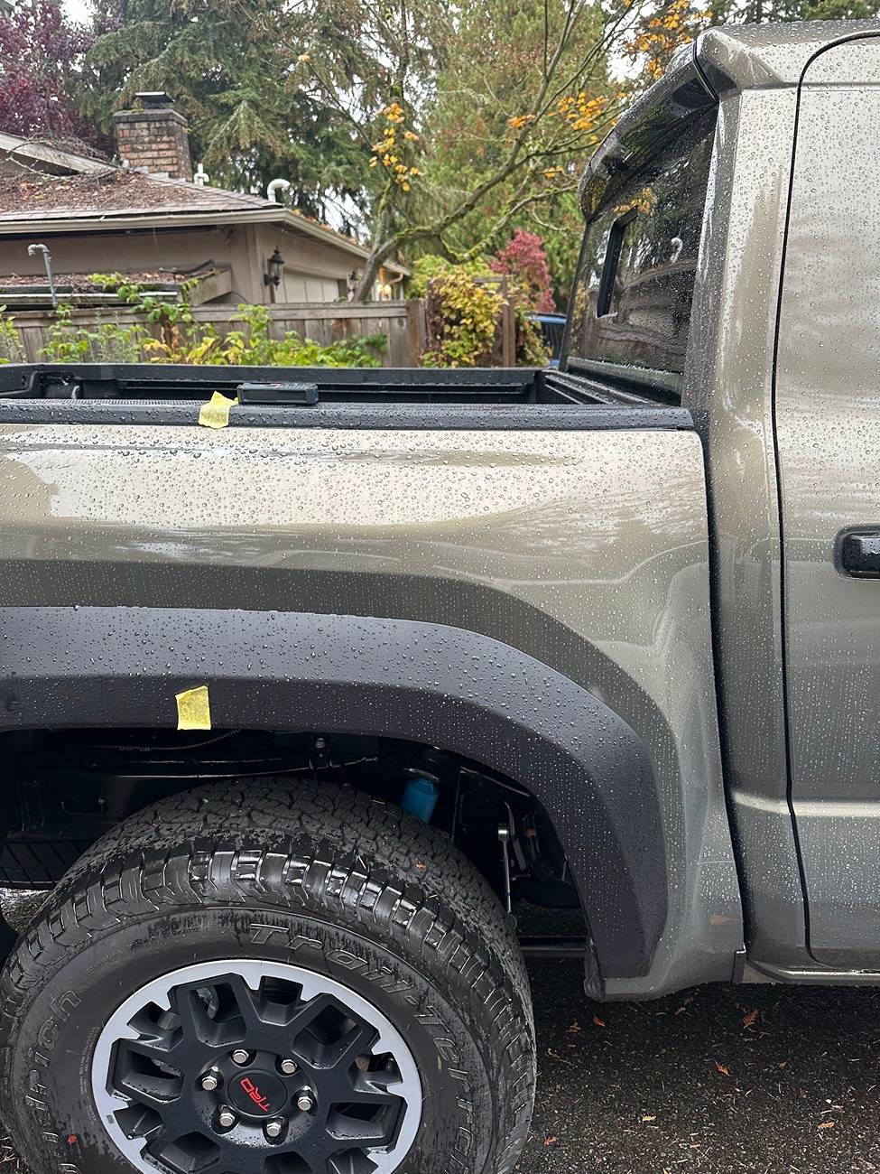

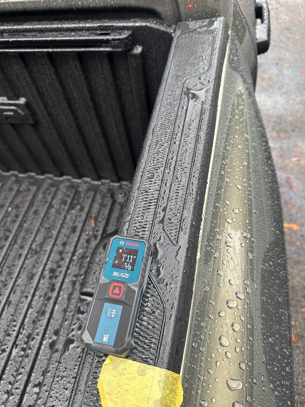

I can't promise centimeter-level accuracy (visually guestimated that imaginary line from center axle up), but I measured 23.125", you can see the attached photos. I'd give it a margin of error of 1 or 2 inches in either direction. Hope that's enough to be helpful!
