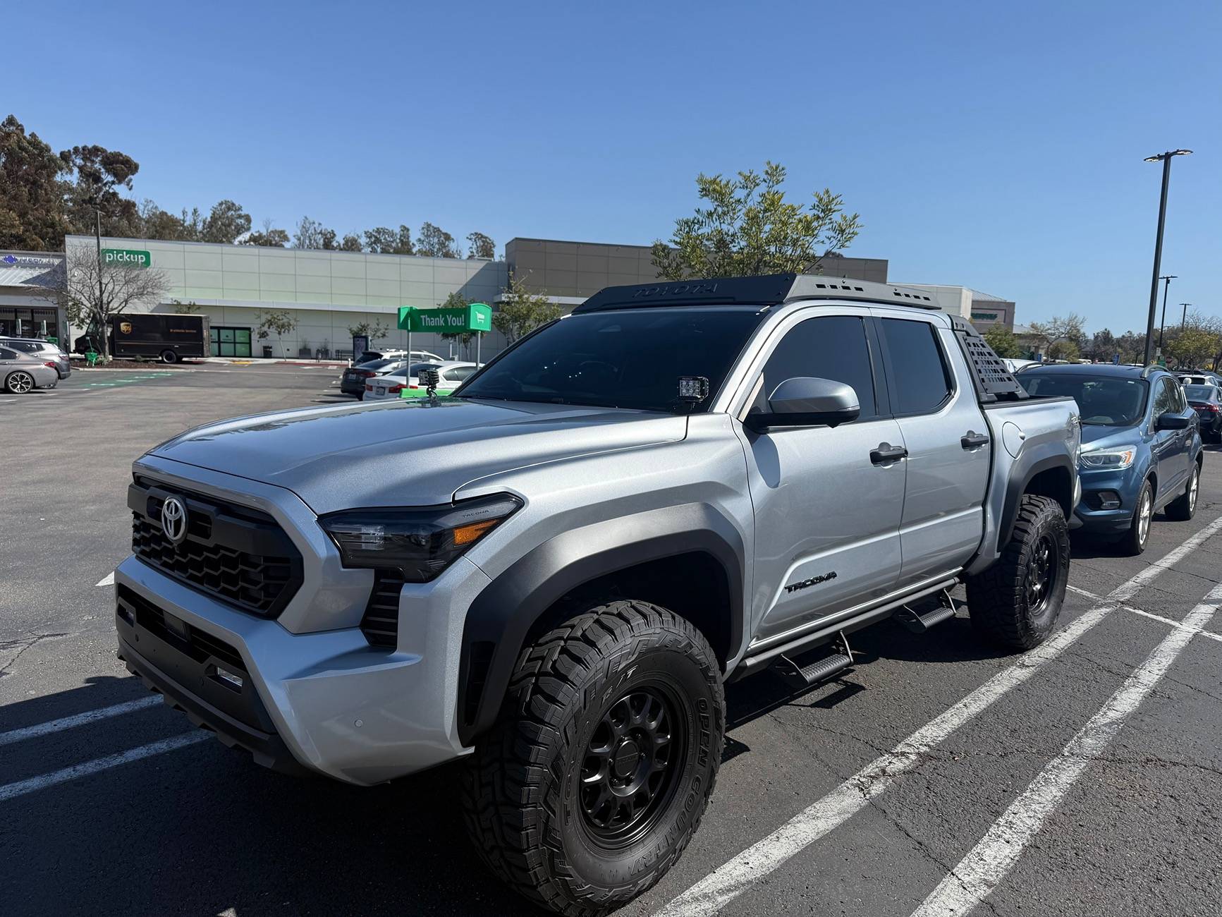

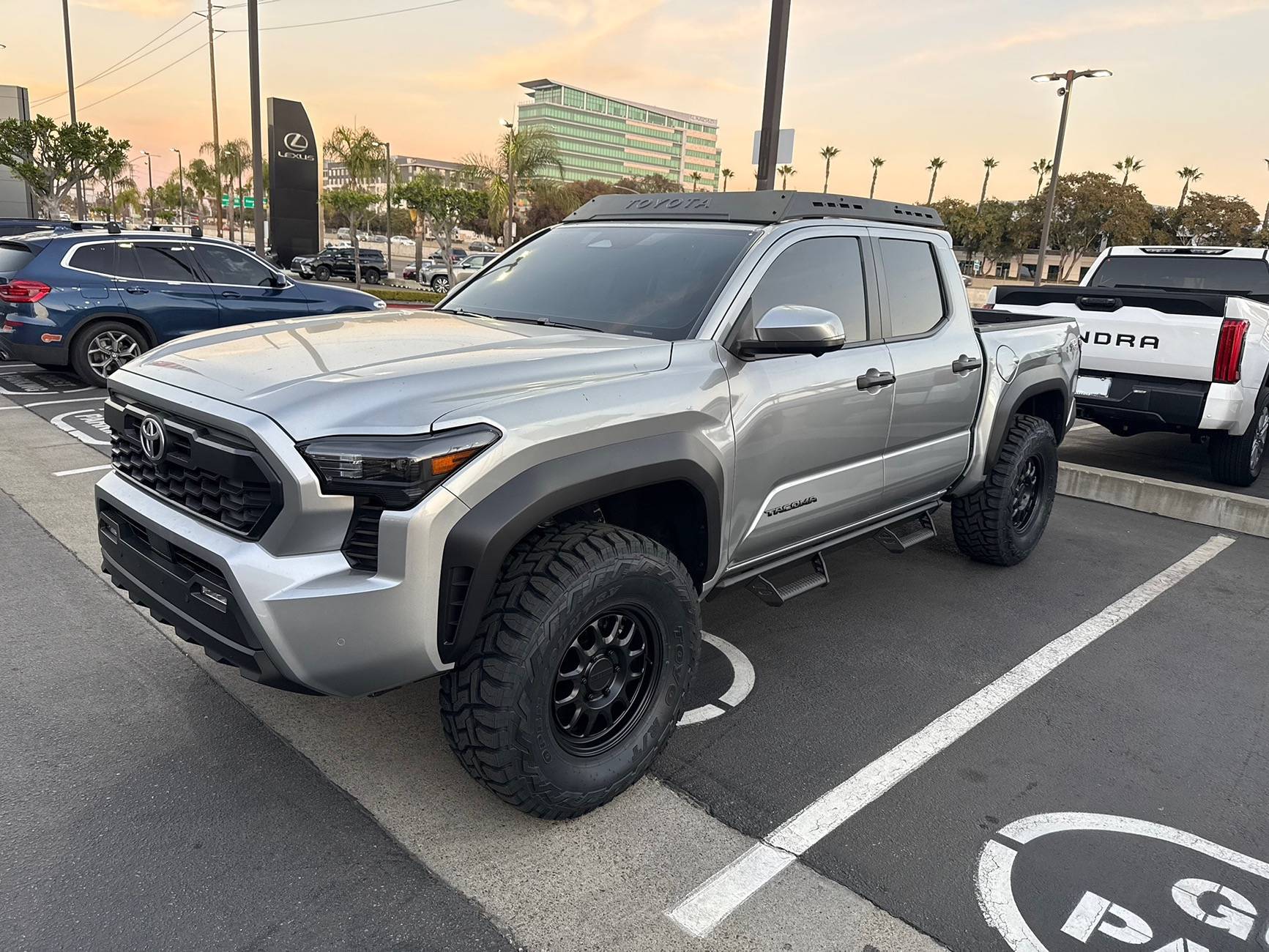

So I just got a Wescott level kit and it looks amazing. Went with Raceline wheels and Toyo Open Country R/T tires in size 315/70/17.
I haven’t seen many people go with 315’s but it feels nice and looks great. Has anyone went wider on tires without trimming ?

Great looking truck! I have the same color TRD OR Premium. What are you thoughts on the kit? I just replaced my OEM tires with Falken Wildpeak AT4W in OEM 265/70r17. I just want mine leveled.

It’s a great kit. I’m loving it. Only put about 200 miles on it so far. I also got the k&n intake and honestly that helps out so much with lower end torque. You definitely hear the turbos as well. These wescott kits are made to feel the same as factory and honestly it really does.

Yes that’s the exact spec. I also added the rigid lights and the arb sports rack recently. No complaints at all

No trimming. Just took off Mudguards in the front.

How's the noise inside of the cabin ?

Looking good. How much poke do you have with the wheels? Any chance getting a photo showing from the front or the back? I'm still trying to figure what I want to get wheel and tire wise.
As for the Westcott leveling kit. Are you referring to the preload collar lift kit that gives you a 2 1/2 lift up front and .75 lift in the rear? Did you install it yourself or have it done for you. Did you have the alignment checked afterwards?

Truck looks great, i installed the pre load collar kit a month ago….what a difference, solid feeling truck handles like new , nice ride, i did a aliginment at install …..this kit has quality all over it, very nice parts…good luck with truck

With the rack if you have the sunroof open or the shade you will hear wind noise. With it closed it is pretty quiet
