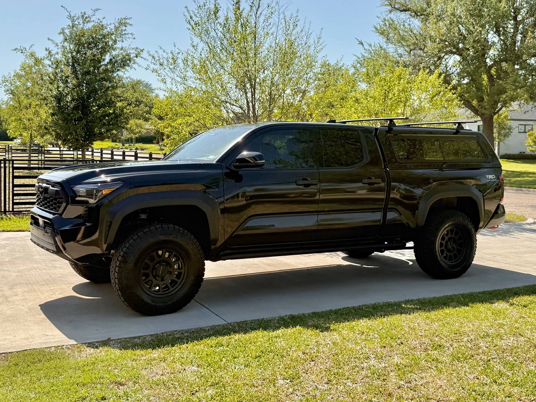

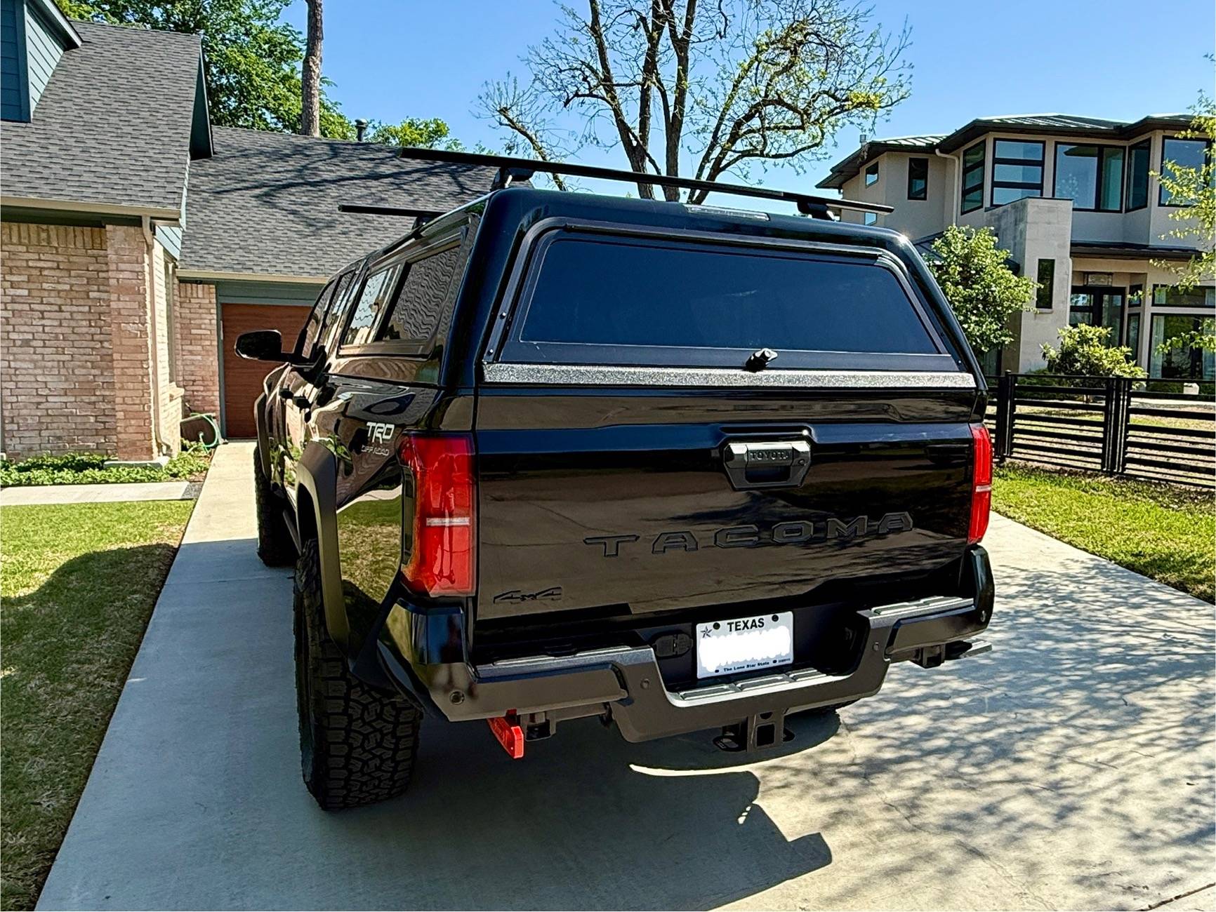

Did you get the tracks for the Rack from ARE or did they come from Yakima? I have almost the same setup, but I want to add a rack in the back for longer items (Kayak)

It’s Yakima branded but I believe ARE sent it altogether as pictured. If you want to ask my installer, you can call DFW Camper Corral in Mesquite TX to confirm.

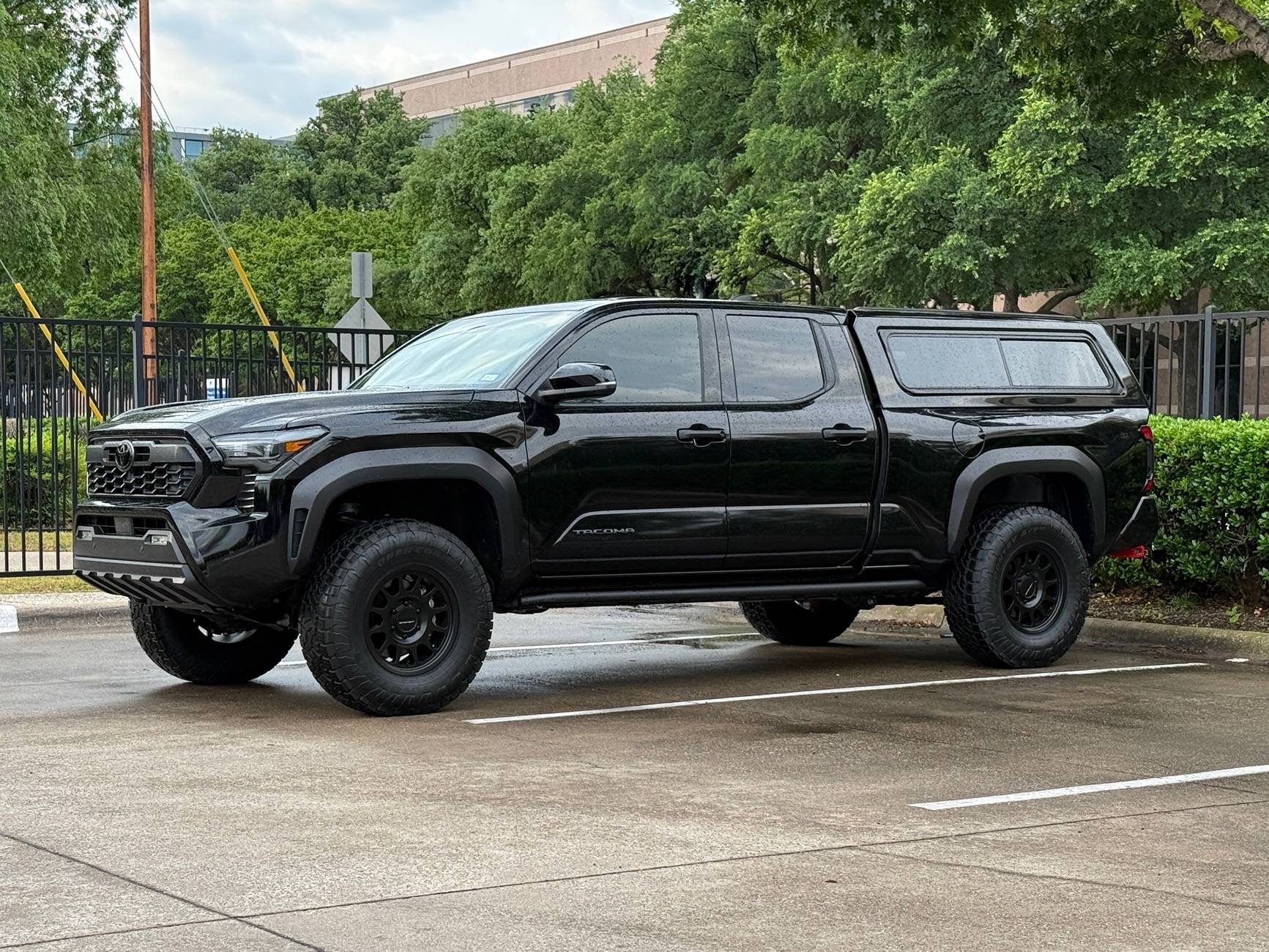

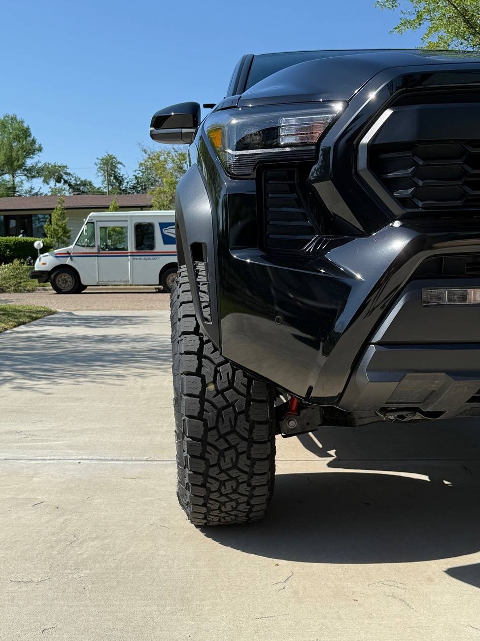

Great looking truck. If you don't mind, can you take measurements from the ground to the bottom of the fenders, through the center of the wheel, for both front and rear?

It’s 39.5” front and 39.25” back. Didn’t get the chance to measure it before the cap went on, that’s probably sinking it the 0.25”. I chose the readylift (1” rear collar) over Westcott (0.75” rear collar) because I anticipated the cap reducing my ongoing rake.

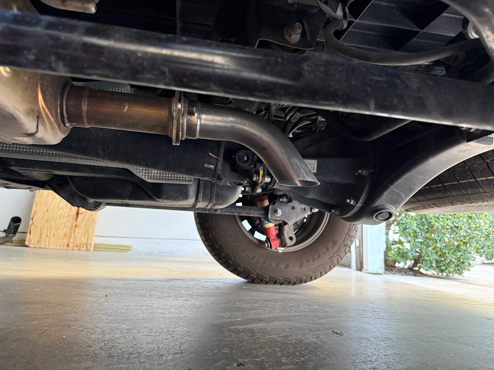

Truck reeally looks good, think im going to order the exaust dump, seems pretty forward install ? Unbolt old, rebolt the new ? Does it use existing hardware ? Nice job on your truck

Thanks. Yes doable, had to drop the spare down and twist/tilt the existing exhaust to get it out. Yes, use two stock bolts and rubber hanger. Took 30 mins. Haven’t been able to unload the exhaust pipe… might take it back to a shop to recycle.
