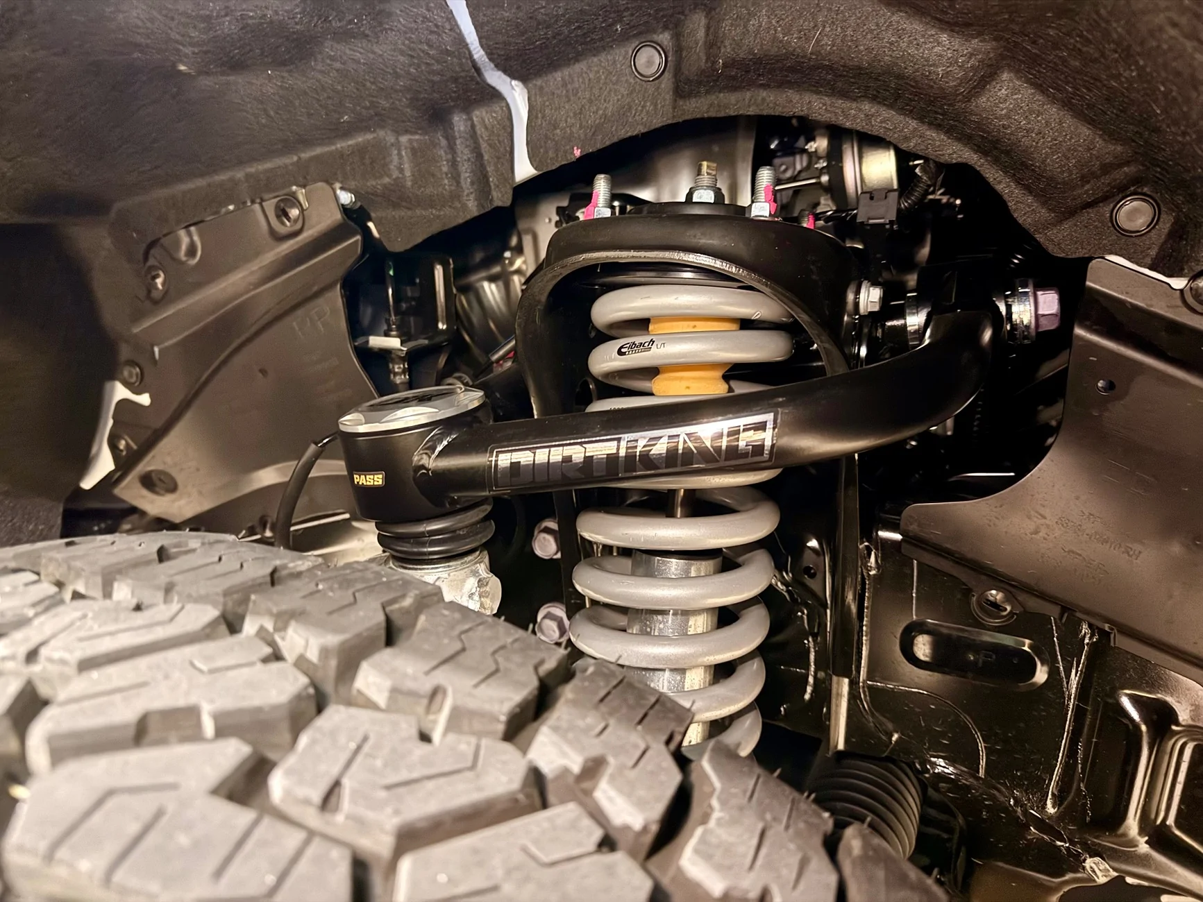

Nice set up! I too just installed the Eibach Pro Truck 2r and very happy with the set up. I noticed you used an after market UCA. Why did you go that route?

Thanks! I went with a new UCA to grab a little more down travel and to make sure I can dial in the alignment where I want it. Plus I can easily run extended travel coil-overs in the future.
What setting did you choose? I’m at 2” in the front with the OEM UCA. They were able to dial in the alignment, but any higher I would probably need an aftermarket UCA.

I’m at about 2.5 in the front, but I’m assuming they will settle a bit. It’s really about just future-proofing the truck with the UCAs, that and they look sweet!

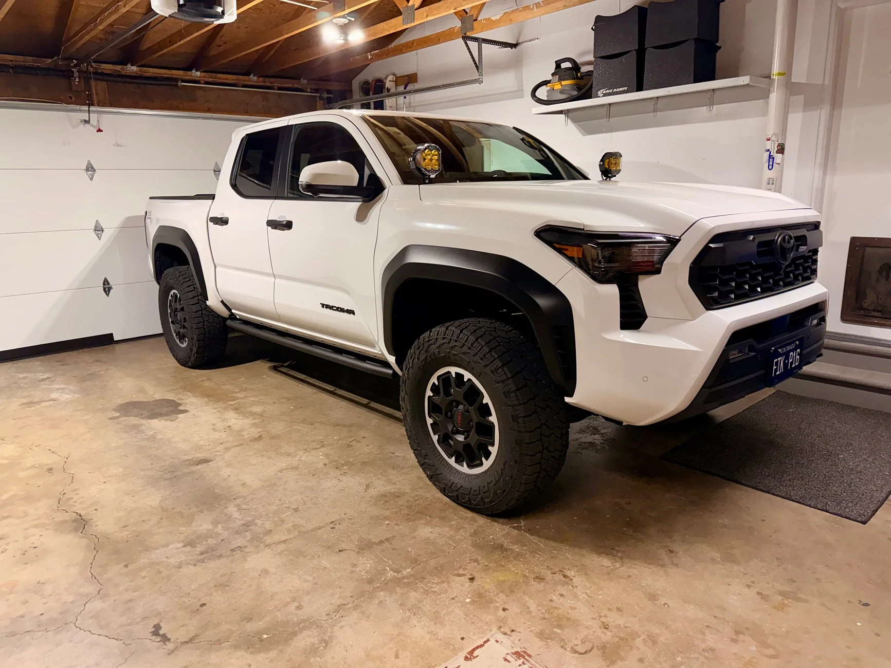

Could you post another side shot? I’ve got the exact kit coming in, I’m still trying to decide if I want to keep the OEM rear springs and just level the front with the coilovers or add the +1” eibach rear springs and add more preload. I really like how yours sits.

No problem, here’s another side shot. I didn’t add any preload and there’s only about a 1/2 inch of rake. So, I would definitely add the rear springs.
