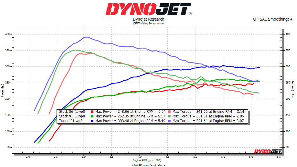

I'm back with the information I promised I would get. I spent almost three hours on the dyno, letting the vehicle cool down between runs, and I took the best of four runs in all cases.
One thing that I have characterized on both the 4Runner and the Tacoma is that the first run after an ECU reflash always reports lower power on the dyno. I have not quite nailed down why but it is something with ECU learning certainly.
On the stock tune with 91 octane the KCLV value was 18 to 19, meaning that the confidence level of the ECU was very high. When I first dynoed it on 86 octane it was 13 to 14, meaning that it was actively reducing timing. I did runs on the stock map and then I tuned the ECU on 91. You can see that in the very low RPM there was not a big difference but in the higher RPM when charge temps start to climb and knock is a lot more likely, the 2 curves diverge quite a bit. You will notice that I used a different base line here, and that's because we dynoed on 86 again, and it was warmer today. I wanted to have a direct, same condition comparison to keep everything as accurate as possible. This was the best of 4 runs, with the lowest being 242whp. 91 was added on a low tank, so there was still just a small amount of 86 in it.
In summary:
  • Peak HP was just over 14whp higher on 91 vs 86, and tq was ~10wtq higher. I didn't quite nail the run start on the 86 run, so I will say that the peak tq gains were likely a little less. What you'll note is that the hp and tq curves begin to really separate around 4200rpm, and stay apart.
  • You'll also note the bump in both 86 and 91 octane runs around 5000rpm. This has been present on every stock tuned 2.4T I've tuned. You'll note that it's not present in the 91 octane tune.
