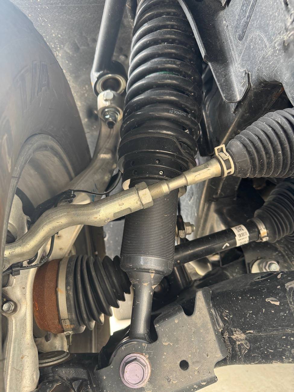

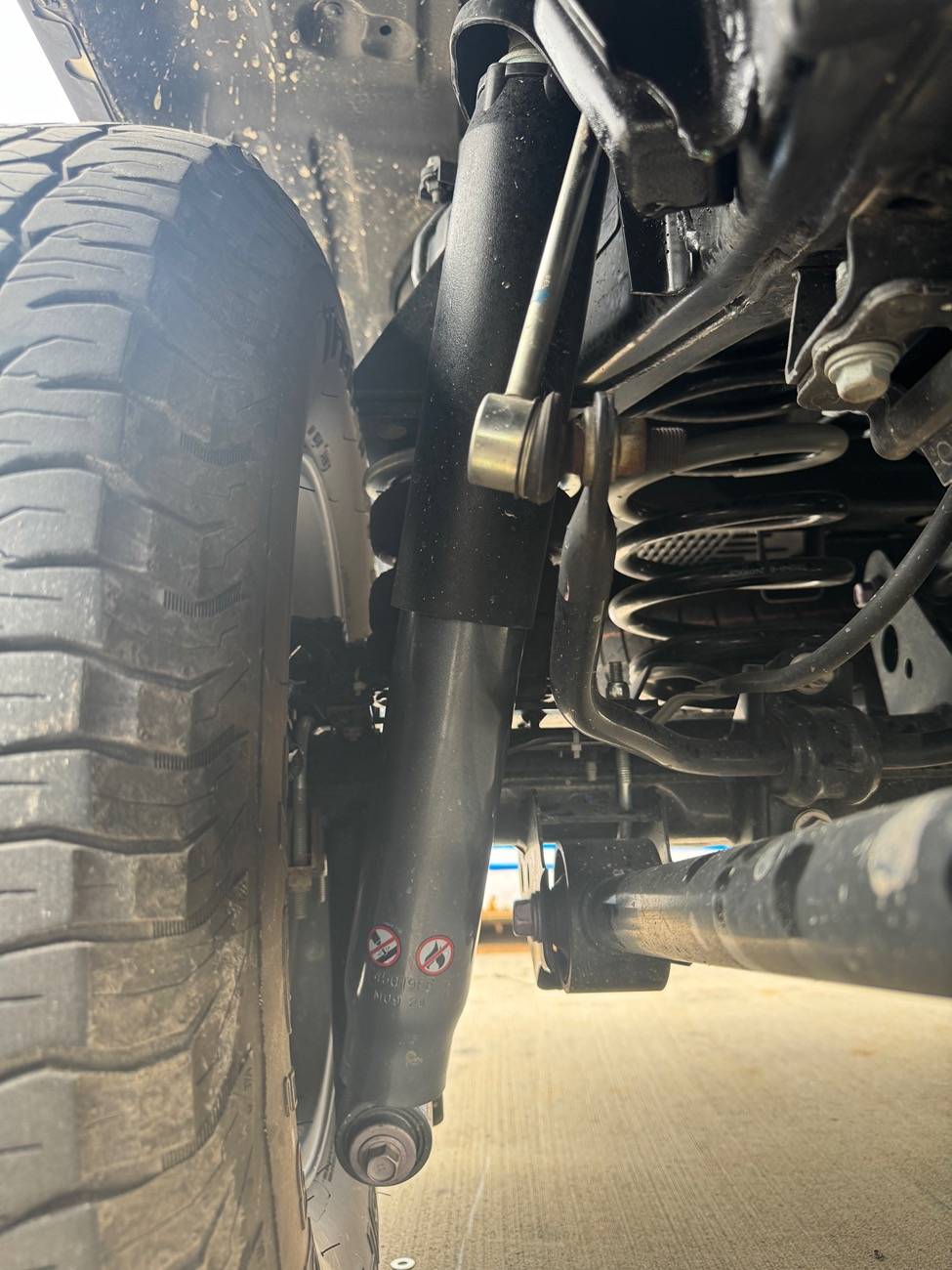

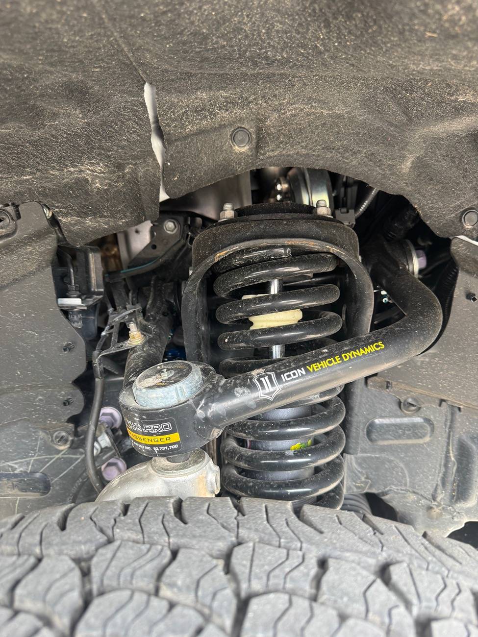

I have just finished installing the iron man 4x4 3.5in lift kit stage 2 foam cell with icon front diff drop and upper control arms, on my TRD-off road. Install went easy instructions were okay but I have done other lift list before on my 2nd gen. Ride is pretty good I did go with the light load set up. Front is a little stiff but going to put a front bumper on later. Very happy with the over all lift kit and have gotten it aligned. No issues so far

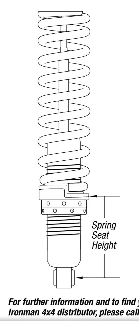

and could you do me a huge favor and try to measure spring seat height? It would be from bottom of spring seat collar to center of the lower strut eye
the reason I’m asking is because I am putting together my coil overs which are the foam cell pro but with dobinsons coils because I already had the coils. I called ironman and the guy on the phone didn’t have the numbers for me I’m waiting for someone to hopefully help out from them.

Driver side is 10 1/2 in on the dot and the passenger side is 10 9/16~5/8. This is with a Milwaukee tape measure

Dude thank you!! And this is how they came in assuming? Which yields about a 3”-3.5” lift?

Yes this gave me exactly 3.5 stock front bumper, with the ARB Zenith, front bumper, and winch it drops down to 3 inches in the front
