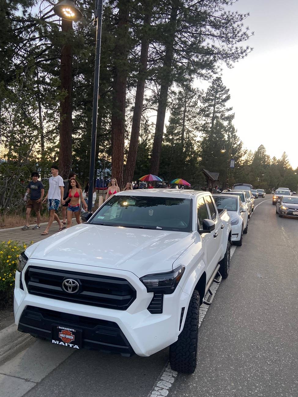

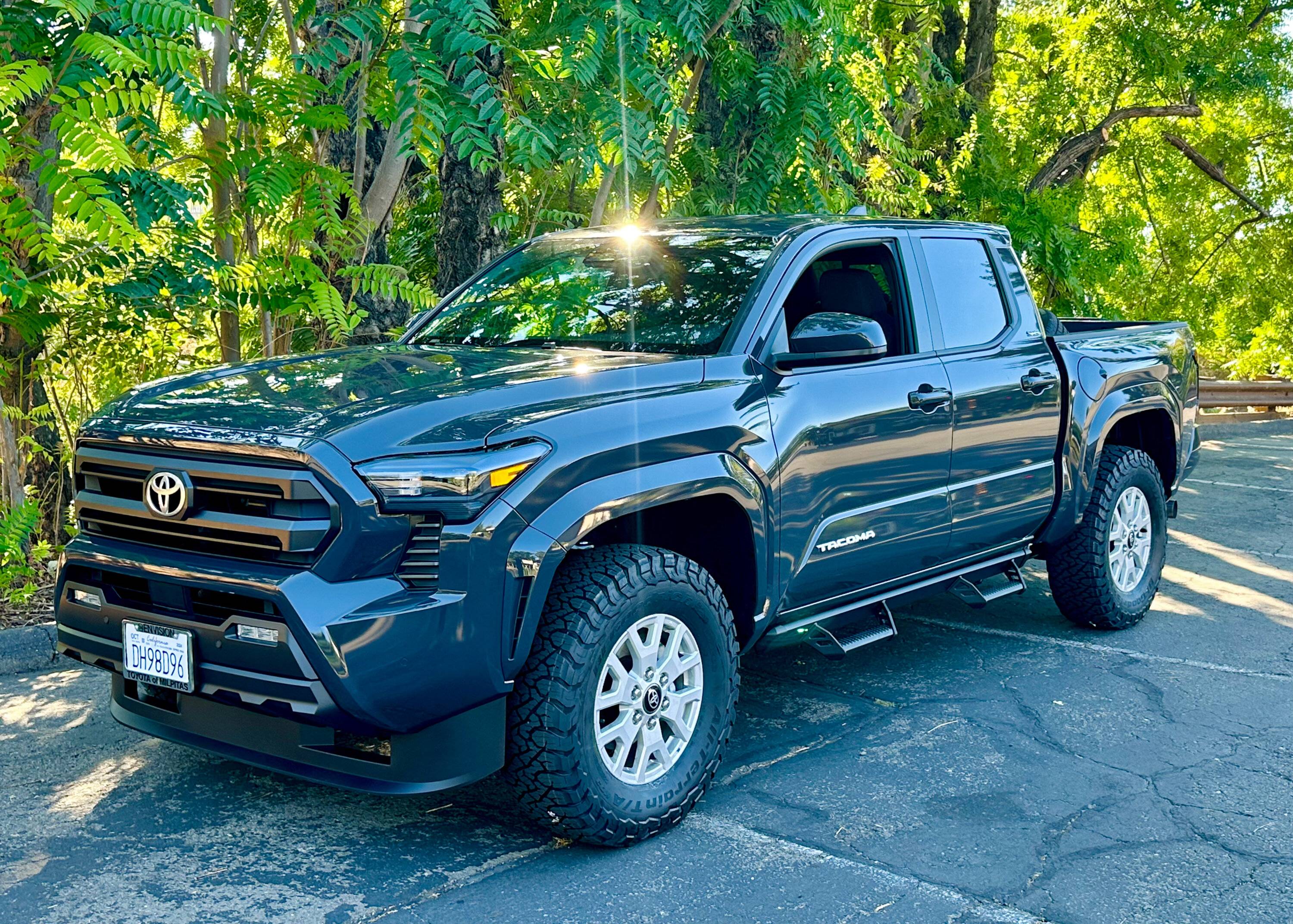

Long time Jeep guy (+ Multiple Tacomas + old school 83 long bed toy w/ 22r motor). I've been viewing this forum a good bit to get insights on what would work with a new 24 SR5 we added for a utility family vehicle. It has been really helpful. So many posts about the the larger tires that work on these new 4th gen... but nearly all I saw referred to the TRD Off-Road or Sport... but couldn't find much in the way of specifics for the SR5.
Literally just picked up the truck on Sunday and assumed the 285/70's would work - but then the fella helping me today at my local America's Tire indicated he was convinced it would rub as I still had the air dam up front. While I was pretty confident that it would fit, his comments did give me pause and was suddenly second guessing.
So after a quick forum and google search didn't give me a certain answer - I was relieved that they did in fact fit on stock 17" wheels / offset and WITH the front air dam. (likely will remove - but hope this post can help those with a firm confirmation that it will in fact work!)
Lastly, Ive run BFG ATs (Before they were KO's) and KO2's on trucks and Jeeps for almost 35 years. So really excited to try out these new KO3's. My Jeeps and trucks are primarily snow runners and I need to replace the 315/70/17's on my JL in the fall!
2024 Tacoma 285-70-17 KO3 tires do fit on a bone stock 2024 Tacoma SR5 IMG_2330
2024 Tacoma 285-70-17 KO3 tires do fit on a bone stock 2024 Tacoma SR5 IMG_2341
2024 Tacoma 285-70-17 KO3 tires do fit on a bone stock 2024 Tacoma SR5 IMG_2339
2024 Tacoma 285-70-17 KO3 tires do fit on a bone stock 2024 Tacoma SR5 IMG_2344

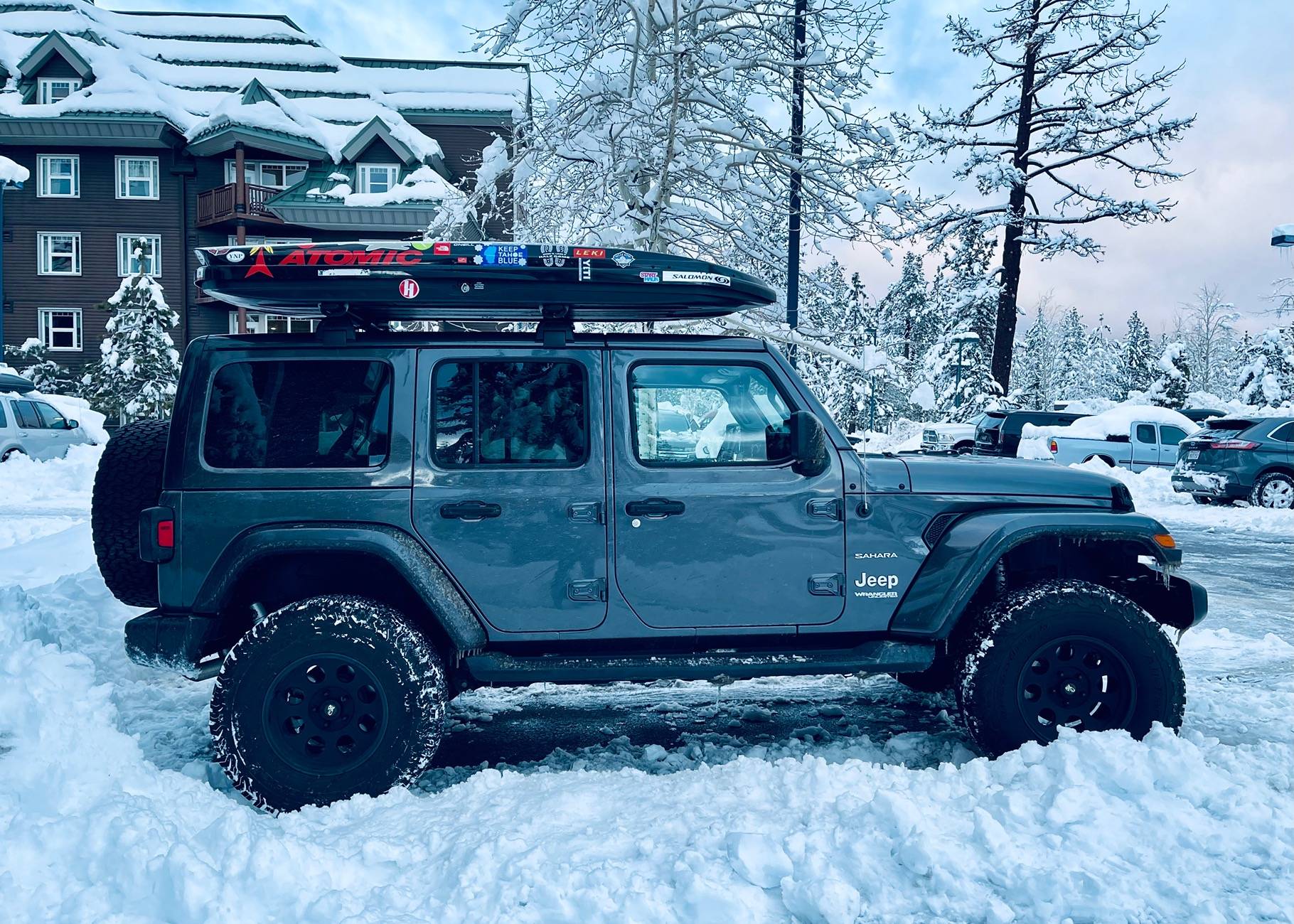

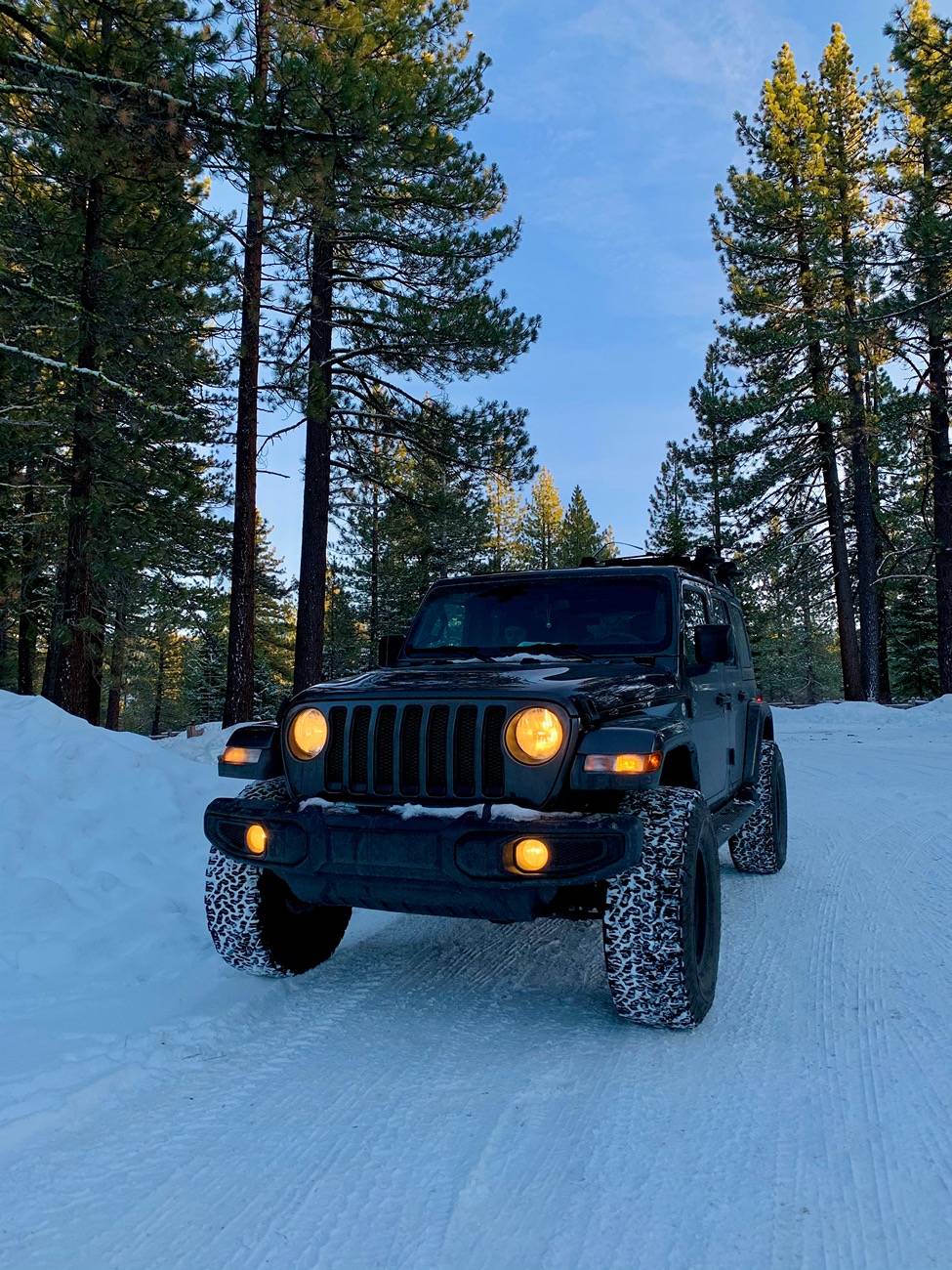

Yea, that has been my experience as well. I’d say the only time someone at the shop would potentially advice against is in the instance you ask for a tire that is well to wide for the wheel application you have.
In that instance it is less about what will fit without rubbing given the concern is more likely one of instability. For example, my JL runs a 315… I wouldn’t feel safe to run on a stock 7” wheel. In those instances a 9” creates stability and my offset / back space is less about the look of adding poke — but to keep my steering geometry to feel more planted given the height change from modifications to suspension. More important on Jeeps that have zero aero dynamics, a solid front axel and loads of bump steer.
The guys at the shops I historically deal with can also tell if you are familiar enough with your requests to know enough to know better! ?
I have never, at any tire shop, not install what I want when I am the one paying. Any good tire guy knows what will fit, and most will even throw one one to check if there is a question what will and will not work
I get they have 'recommended' size from the manufacture, then you can 'UpGrade' to whatever you want, even have a lift installed with bigger tires. My area it is not the norm to see a Truck/Jeep/SUV in stock form
2024 Tacoma 285-70-17 KO3 tires do fit on a bone stock 2024 Tacoma SR5 IMG_0191
2024 Tacoma 285-70-17 KO3 tires do fit on a bone stock 2024 Tacoma SR5 IMG_5614

Thanks for this. It was my question too and seeing the before and afters are really helpful. I would ask if/how you recalibrated your speedo and mpgs but I read that these are utility based and not commuters so it would make sense that you didn't. I love this look and will be changing mine asap. Thanks again!
