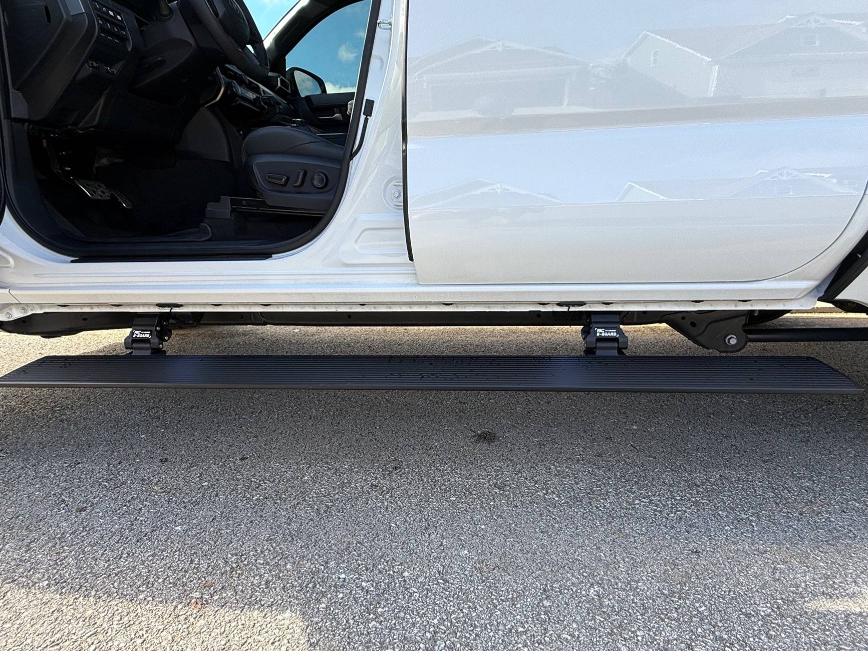

Installed the Rough Country E-boards on my hybrid, It's actually easier, the power tap can go up through right next to the battery there is already a blank rubber grommet there.
The wife loves them, I hate them. The actuator linkages are not sealed, and have brass bushings that start to make this terrible squeal every time they deploy. Douching them with oil works for a few off road trips.
If I had to do it over, rocksliders...

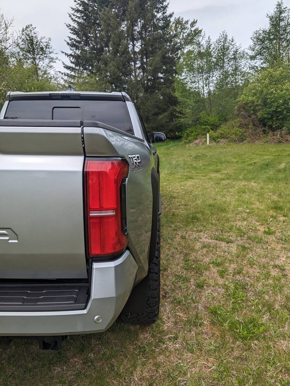

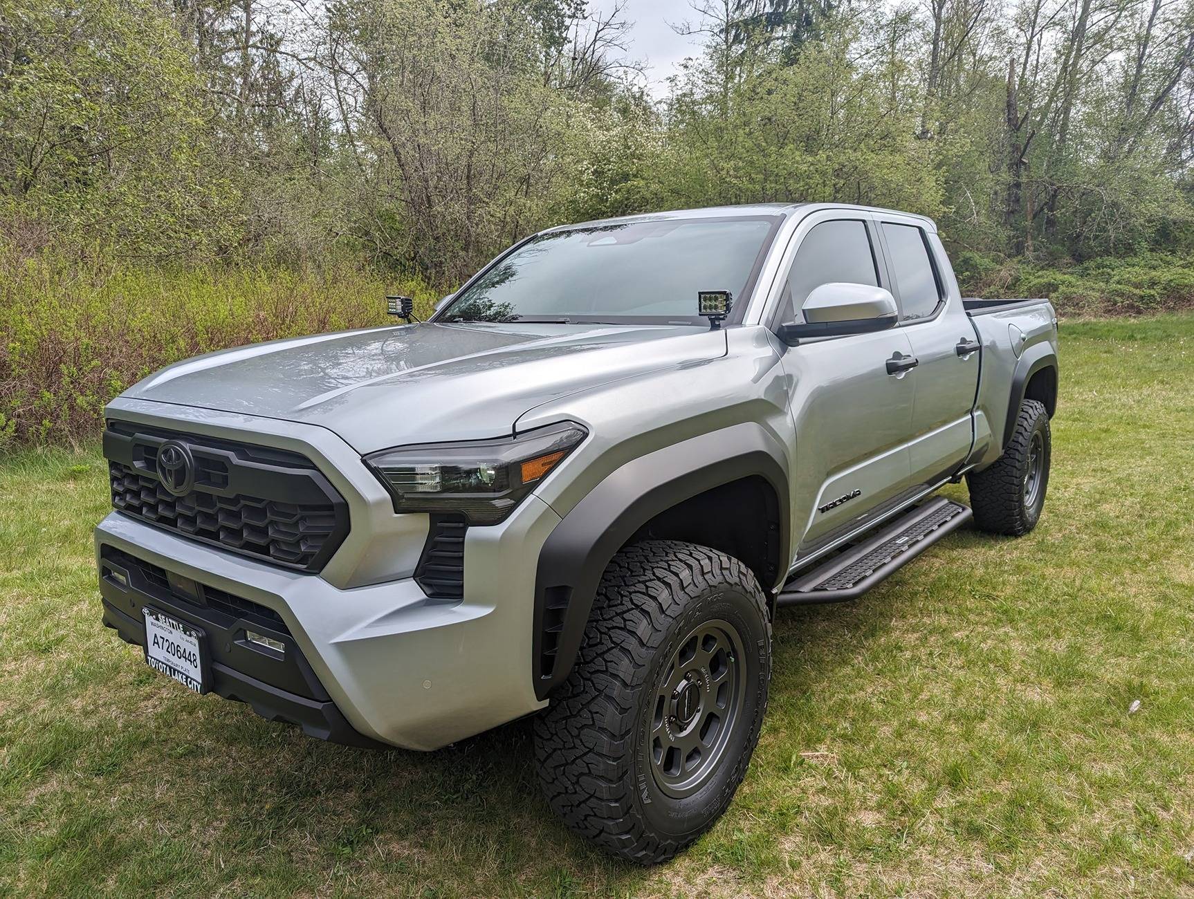

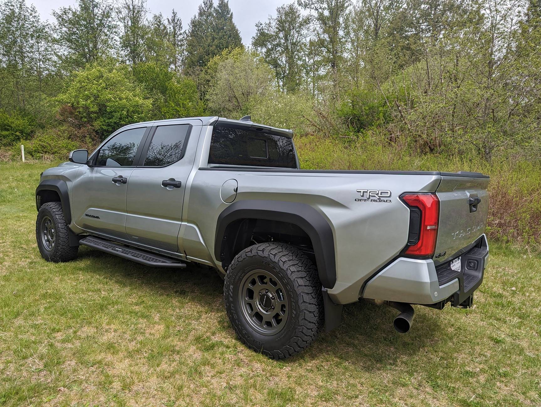

For a temporary solution until you get your AMPs: Trumgeta EZ step C1844V30 for 2-door or C1844V29 for all 4 doors. Rock sliders like Greenlane are not really meant to be great steps, they are really meant to be better at vehicle protection than steps even though they can work as minimalist steps. Greenlane will tell you how high the slider is and how far out it sticks if you ask, and several of the slider manufacturers have it buried in their specs somewhere. I think Rough Country also tells you how far their step type boards are below the rocker or the pinch weld. Almost bought Greenlanes for mine, or Rough Country SRL2 but for the ugly end caps (SRL2 is not a slider), so just went for Trumgeta EZ at 1/10th the price of Greenlane for a temporary fix until I decide or see something I just can't do without. Almost decided to make my own frame mounted out of 80/20 aluminum extrusion and parts from McMaster until I saw the Trumgeta EZ. I could make a frame mounted version of the SRL2 pretty easily going that route. You can reclaim most of your ground clearance for a temporary trip with the SRL2, the EZ or an 80/20 fabrication. The EZ only takes removal of 3 screws per step to get all your ground clearance back. FWIW, I think it may be Rough Country (not sure) that does show someone getting out of a truck onto one of their steps, maybe in one of their SRL2 videos. But I think they cleverly only show the foot going down on the step, not the contortions going on above that required to keep from ripping the bolster off the seat without bashing your head into the door frame.
For now, the EZ steps and Weathertech mud flaps will have to do for lower body rock chip protection on my '25 Taco. May end up rethinking that in the end.
