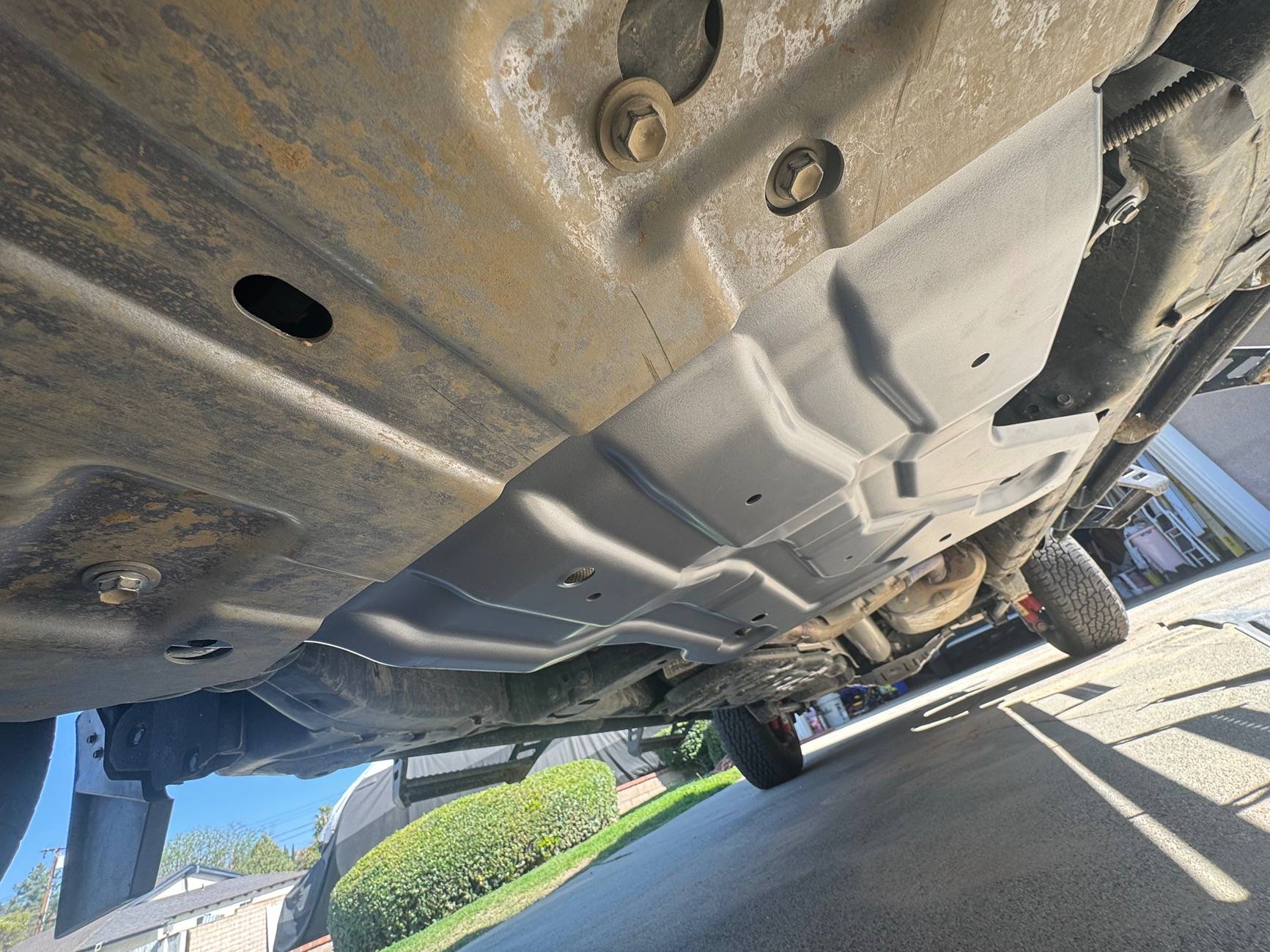

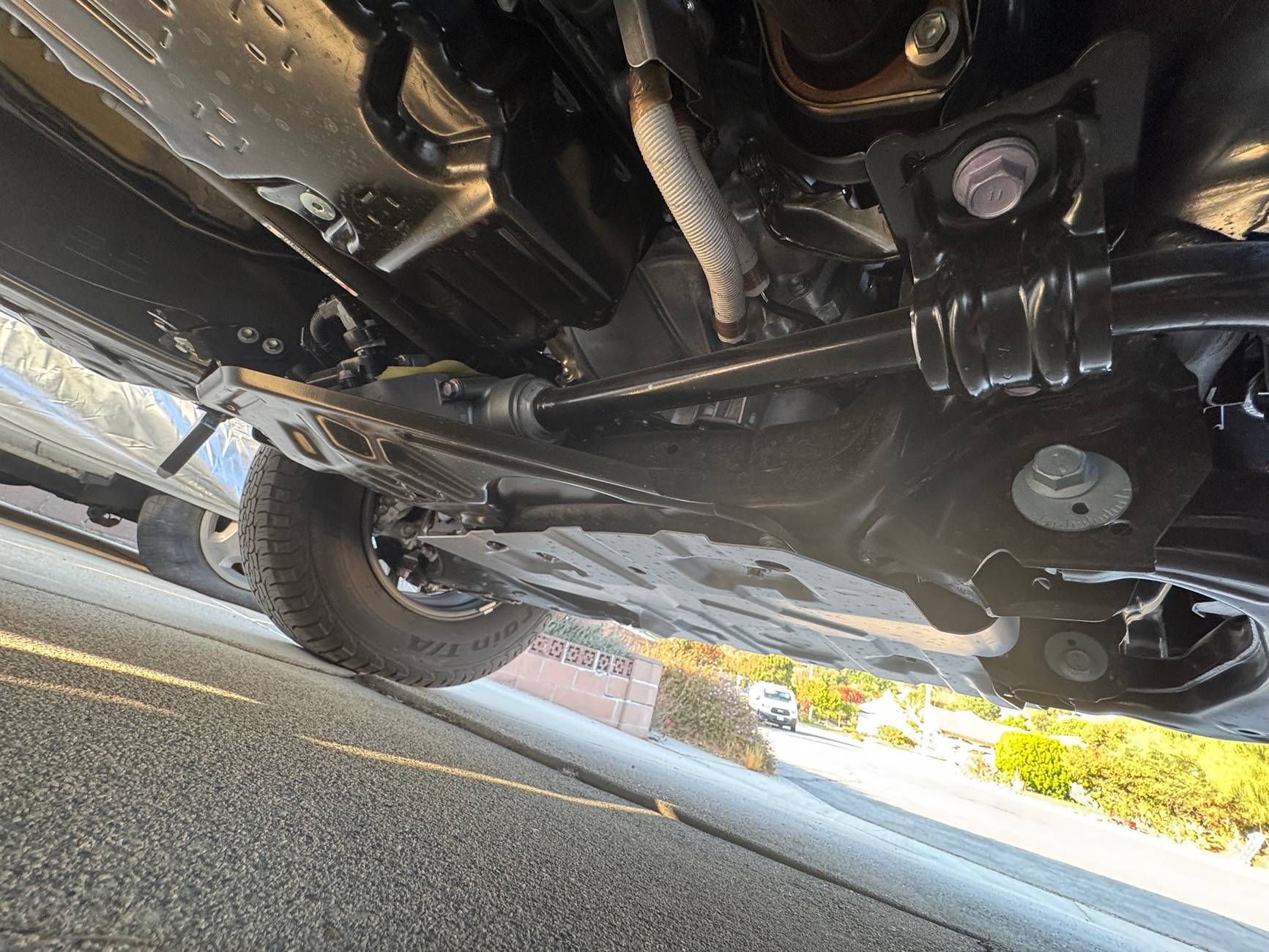

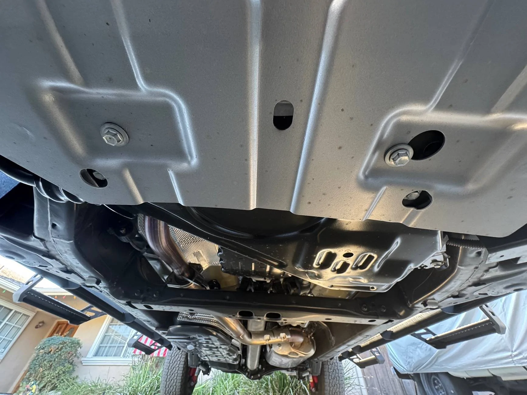

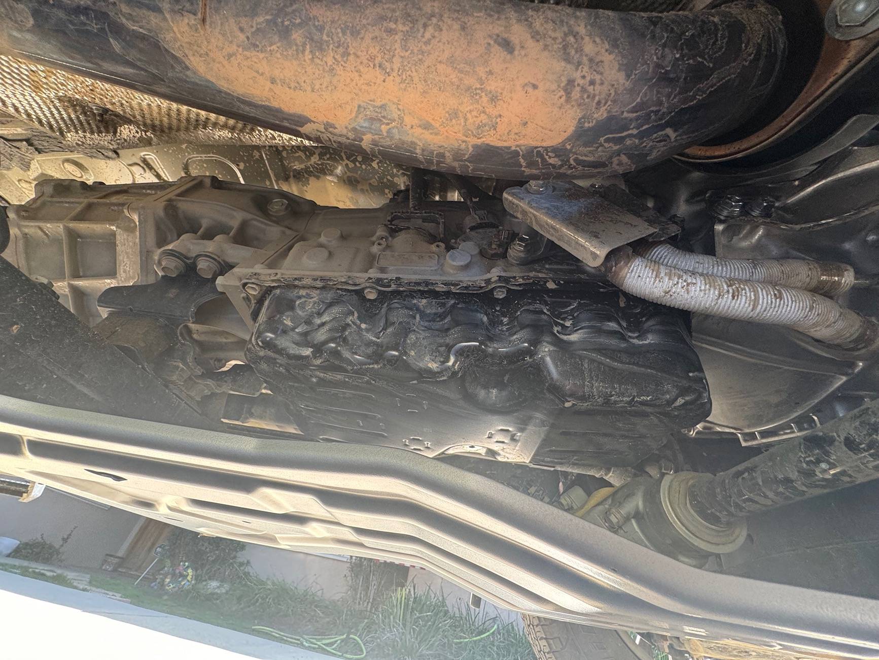

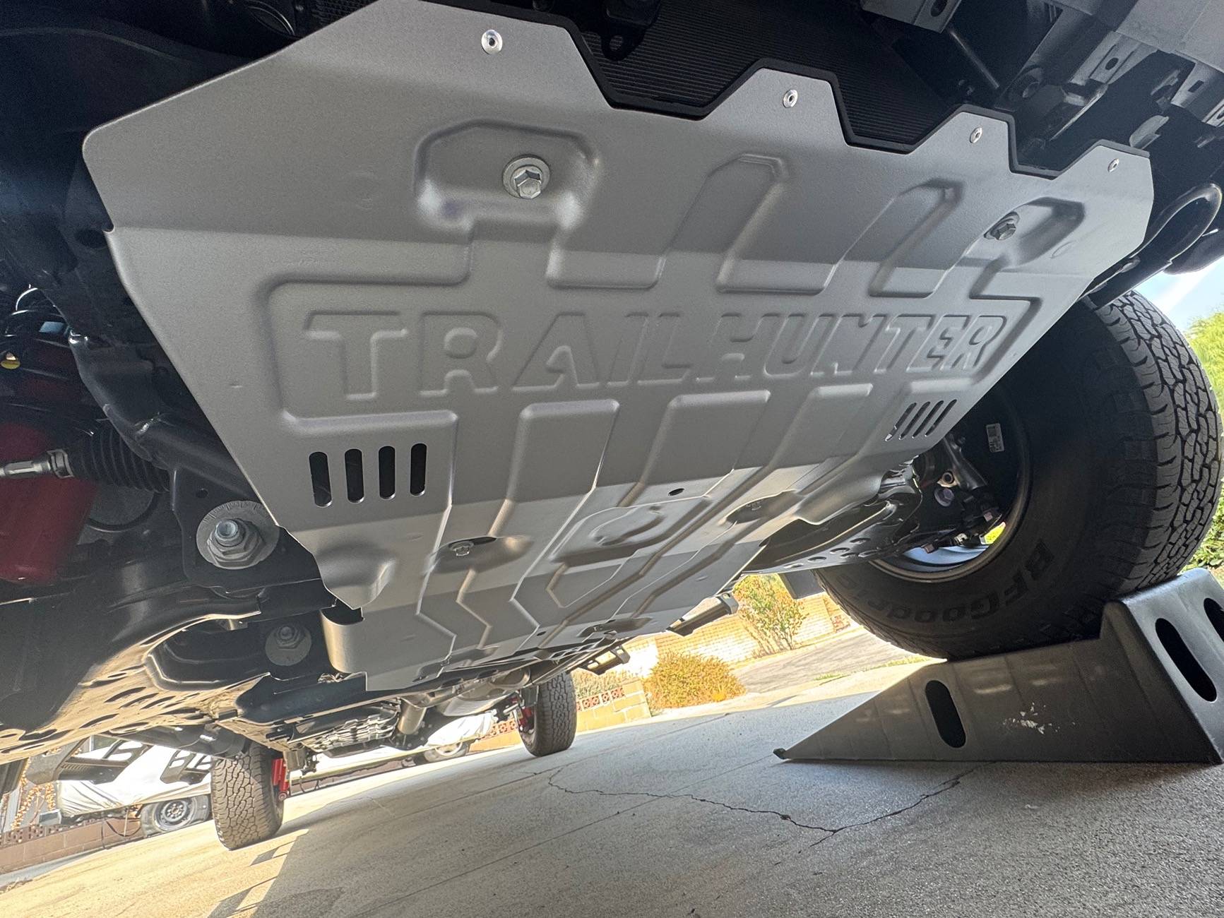

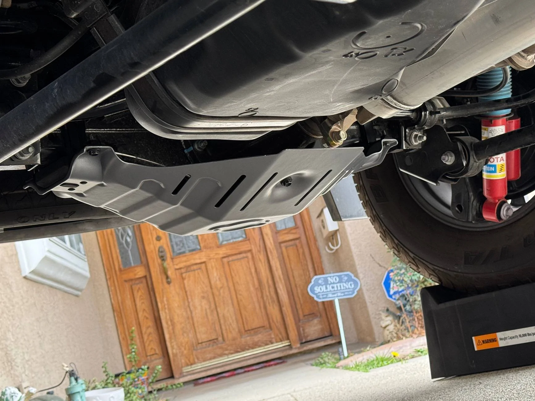

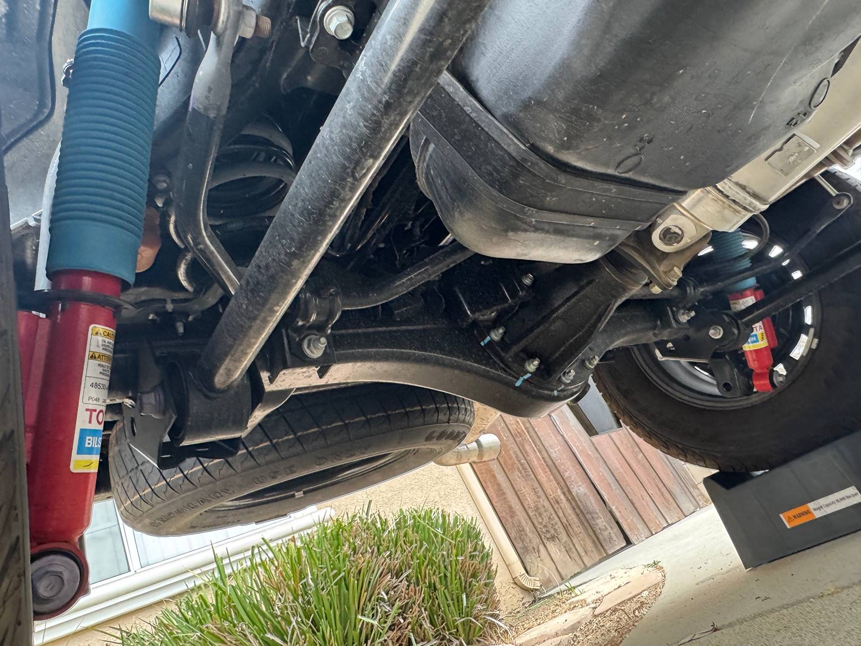

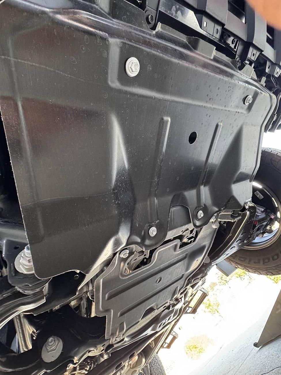

Ive installed all three skid plates found on the Trailhunter. Front Bash Plate, Transmission Plate, and Differential skid. Ive seen some confusion as to weather or not they are steel, they definitely are. They are heavy and magnets stick. Some important notes before buying, all the front bash plates fit every Offroad, Pro, and TH model Hybrid or not, The Diff skid and Transmission Plate are different part numbers and sizes for non Hybrids. Installation for the diff skid was slightly more compliacted but still very straightforward and easy. The other plates just bolted on.
TrailHunter Front Bash Plate vs. Stock OR Plates
Diff Skid Before and After
Transmission Plate Before and After (I have the SDM), The Transmission Plate plate did come with new bolts.
