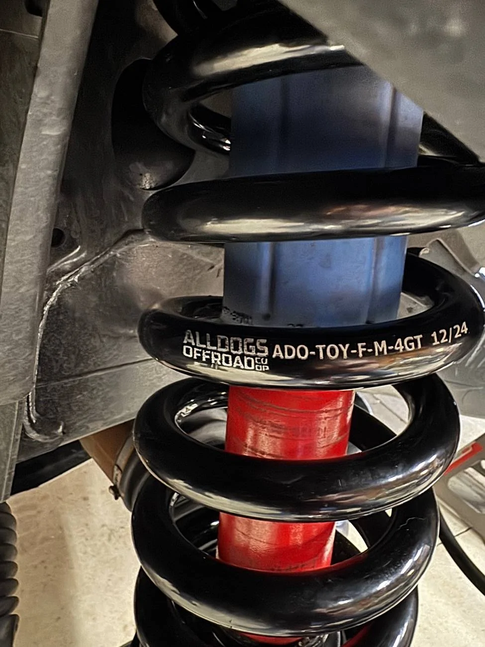

I have the All Dogs lift but have only installed the front so far. Truck is 38-1/4” from the floor to bottom of fender. A Westcott preload collar was in the truck before, installed by the prior owner, so not sure what the actual lift would be from stock. I’ve also got 285/70-17 tires. The Westcott collar also put the front of the truck at 38”.
I still have the Westcott collars on the rear and haven’t yet installed the ADO springs. I can’t compare the front ride to stock as I didn’t have the truck then, but as compared to stock with the Westcott collar, it is a fantastic ride. No mure clunking and overly firm feeling front suspension. It’s a very, very good ride.
As for install, it’s the same as any other strut/spring install. Remove the coil over from the truck, compress springs, loosen top nut, decompress springs, swap springs and reverse. Removal of the coil over and reinstall was as easy as I’ve ever done before, literally 15 min per side to remove and maybe 20 min per side to reinstall.

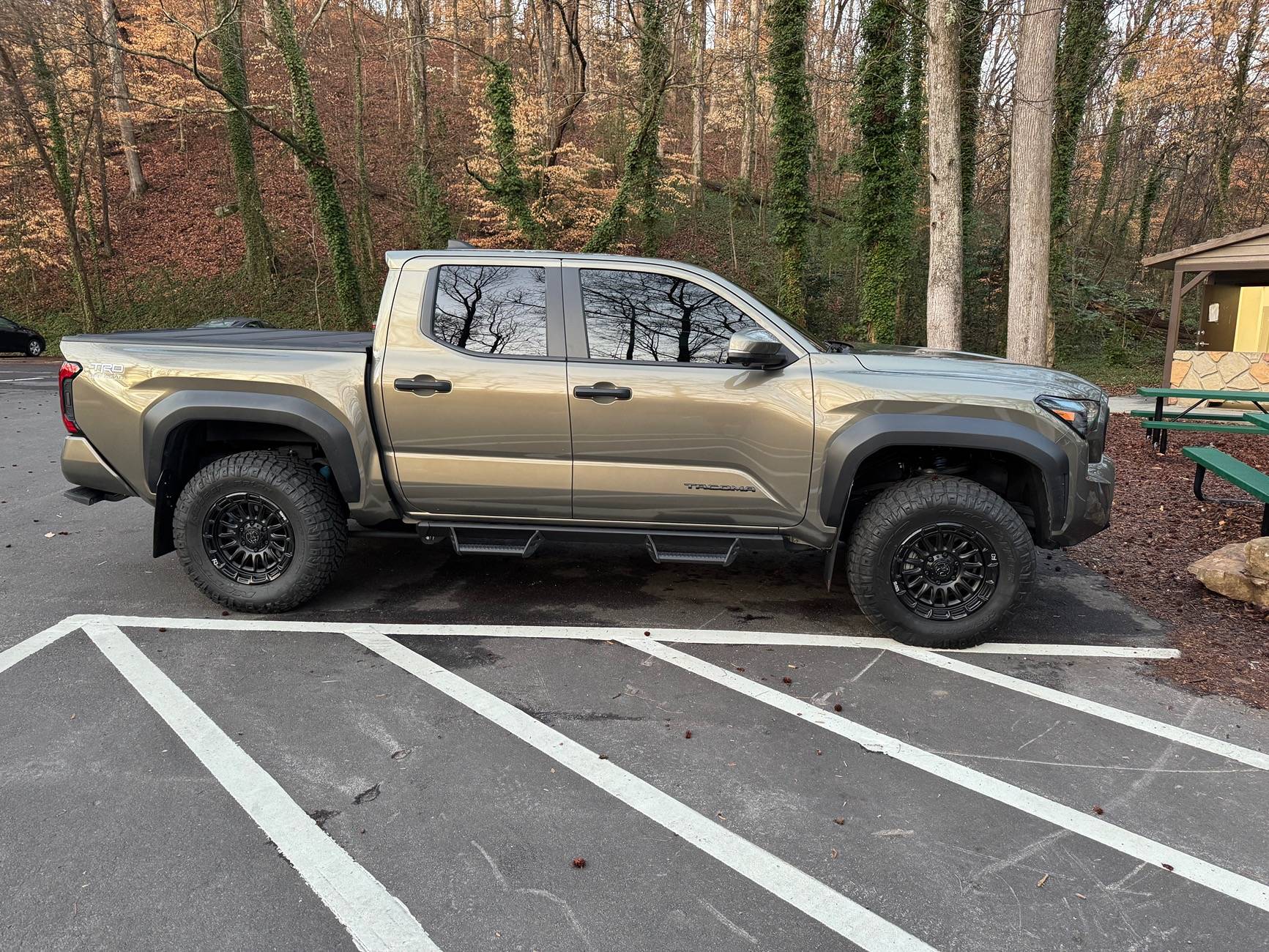

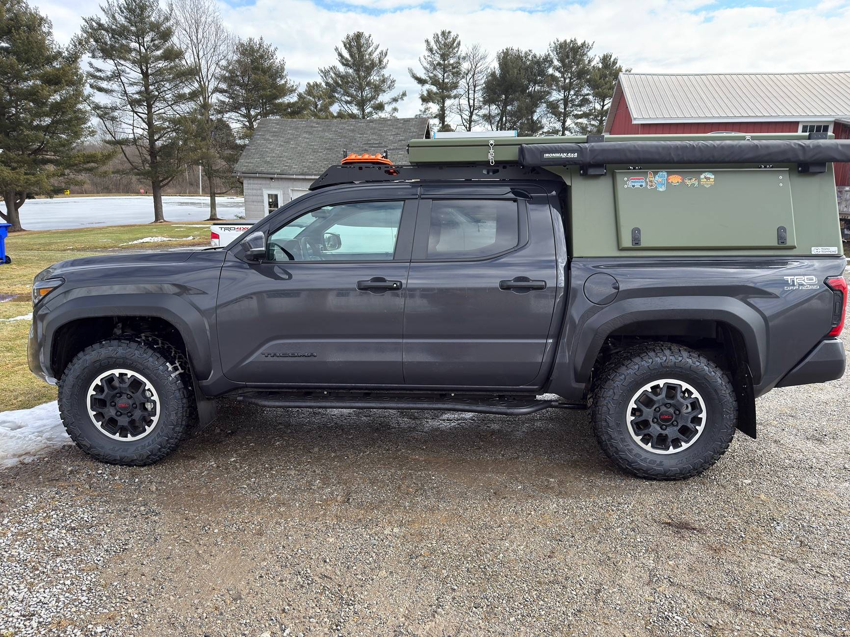

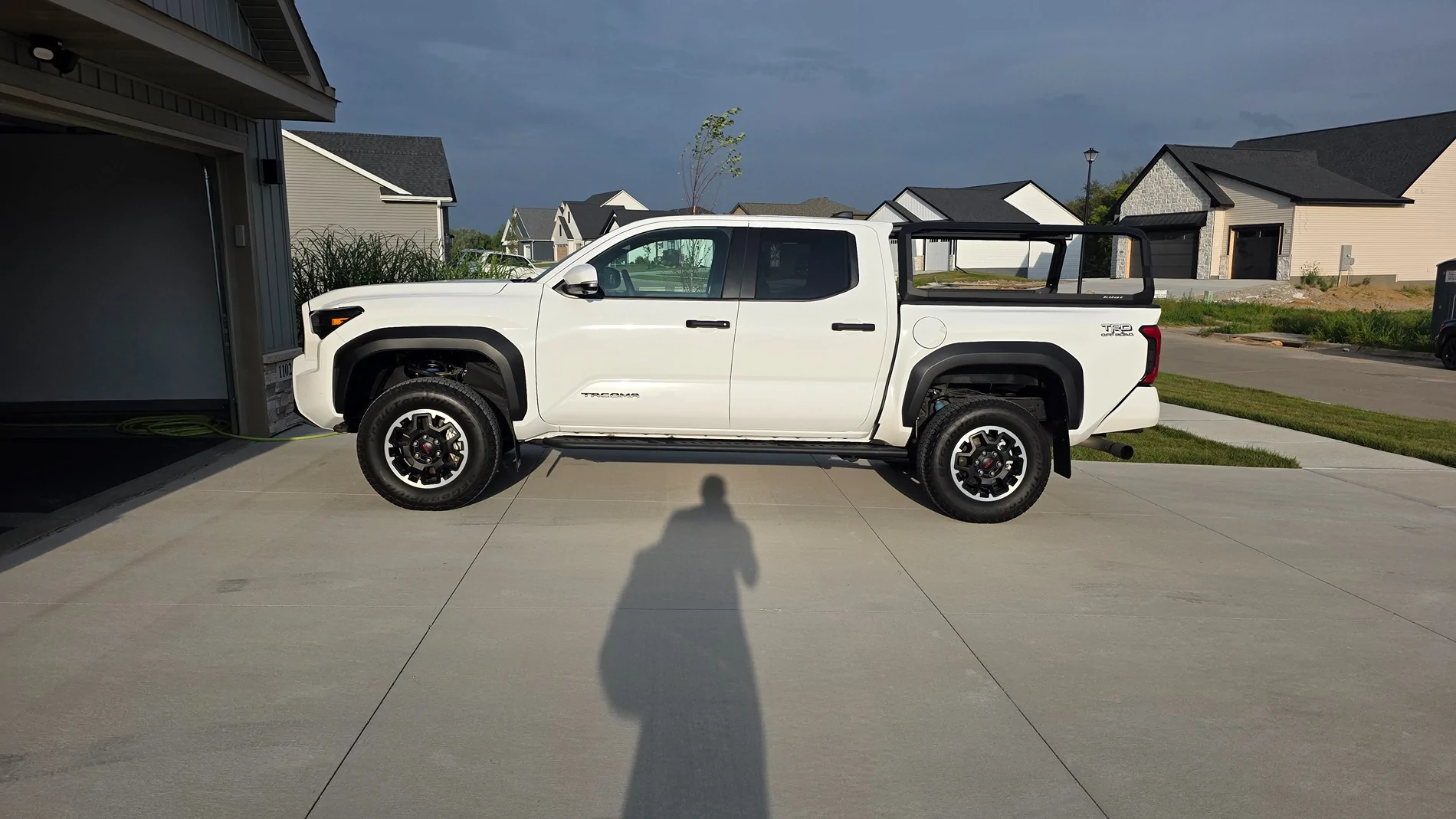

Here you go… Alldogs springs in the front, OE springs with the Westcott collar in the rear, which gives about .75” of lift. The rear ride is fine, the rake is about 1” taller in the rear.
The tires are 285/70-17 on Black Rhino Rivals, +25mm offset.

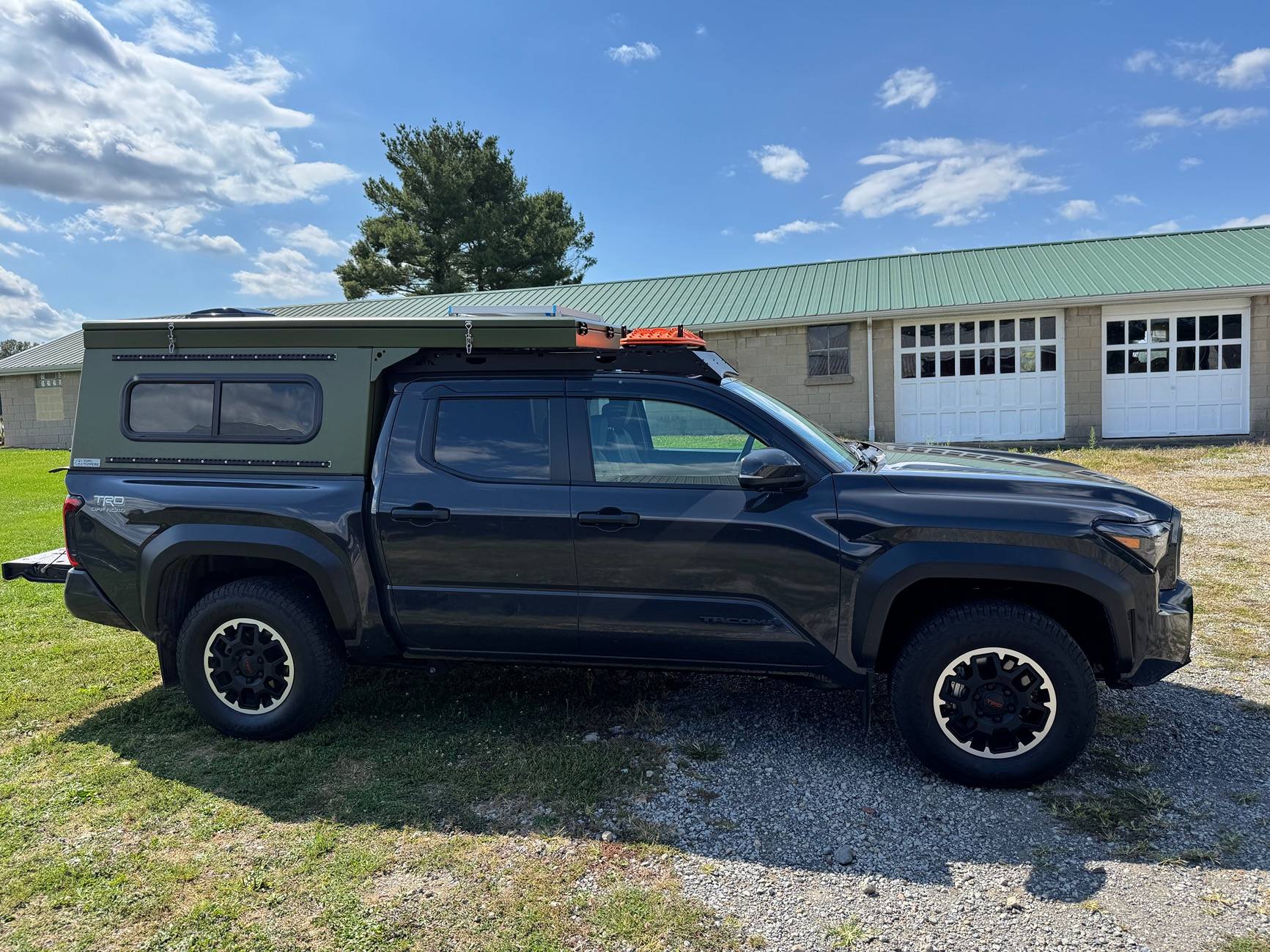

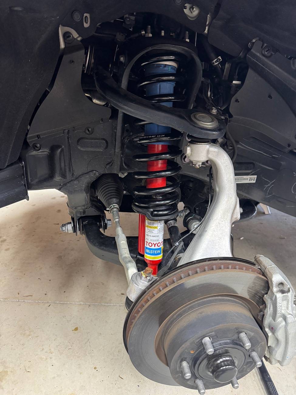

I installed the ADO Spacer Eraser kit. Four springs to replace the OEM springs.
Ride has improved (topper weighs ~350) overall. Prior to lift I would often hit bump stops in the rear over dips on pavement roads. Post lift I have not hit bump stops.
Installed myself using a Vevor spring compressor. It was much easier than the ones you rent from a hardware store. I used lift and jack (the jack helps with supporting the rear axle while changing rear springs.
Front driveline seems to be visually okay as far as angles go. I did take it to a shop for an alignment after, and they said it was needed. I am comparing it to past Bilstein lifts installed on 2nd gen taco and 2nd gen tundra, which has noticeable change in drive (also were higher lifts ~3”).
Wheel hub to fender measurements.
Prior to lift: front 20.5” rear 21”
Post lift: front 22.5” rear 23.5”
Tires are 285/75r17, and have not noticed rubbing yet on pavement. Have not had it on trails post lift to check rubbing with articulation.
