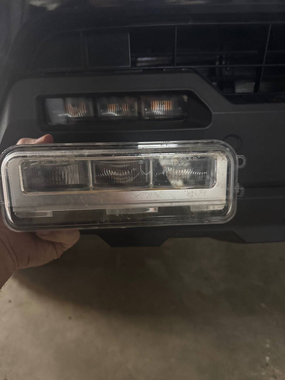

Install done today. Looks OEM until you use them. Far brighter, simply turn your fogs off/on to change from clear to amber and they came with a pigtail to tie them into you turn signal making them sequential.

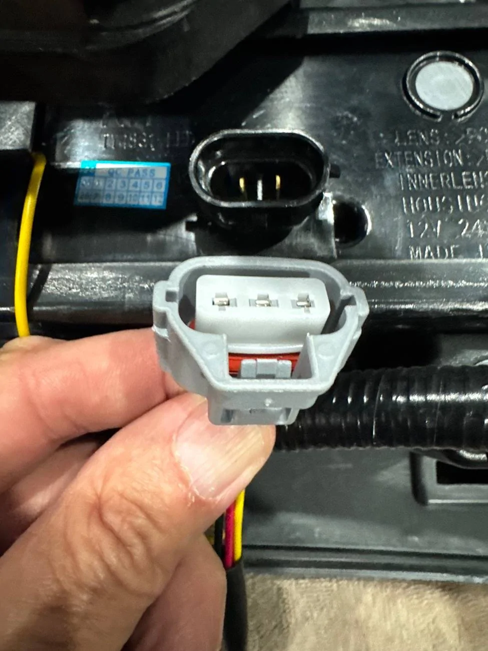

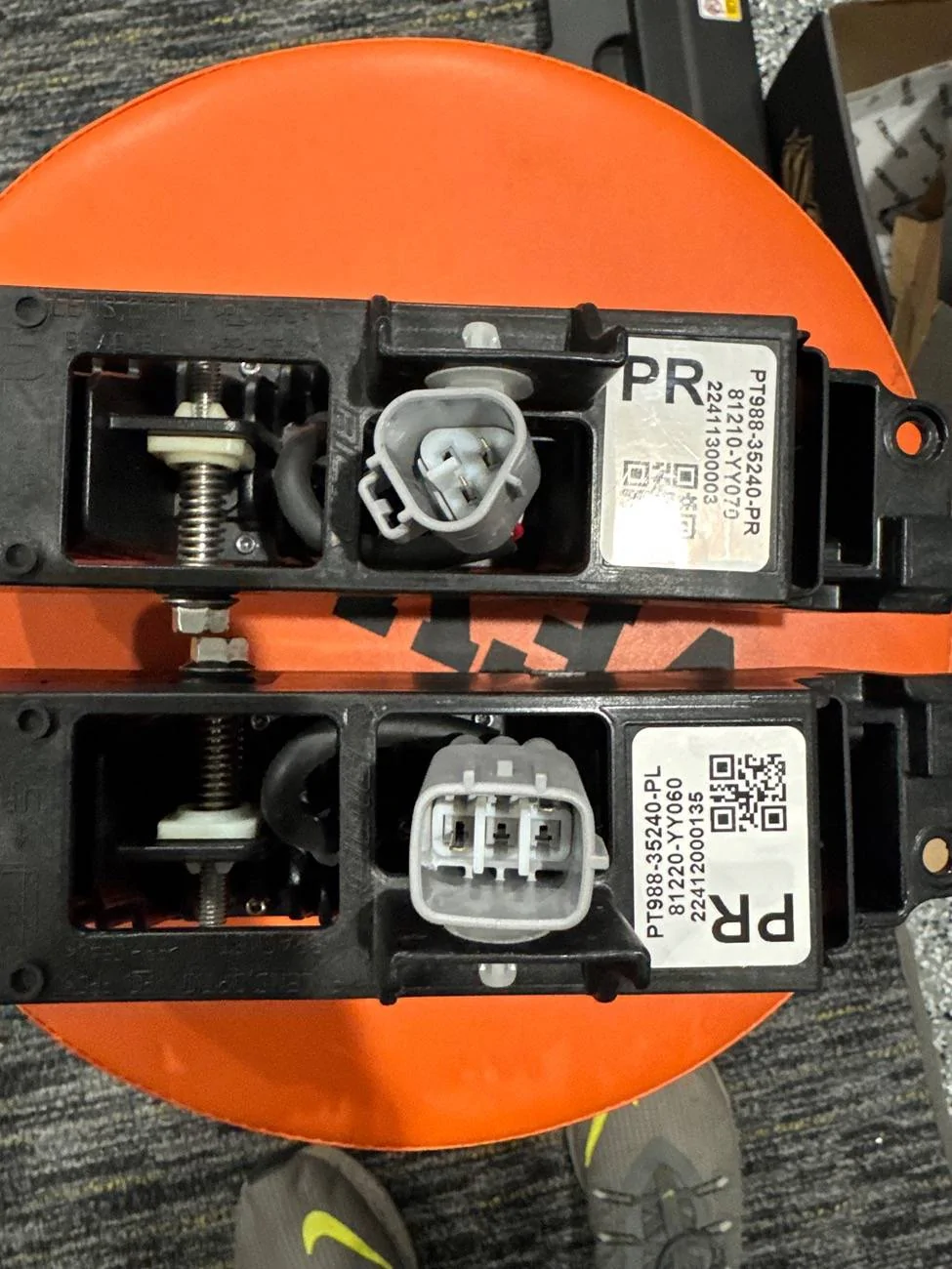

Wondering what Tacoma model you installed the Alpharex Fog Lights in?
I have an issue with the OEM harness - 2 different size 3 pin connectors.
I have the TRD Pro
Hmm. Tech support closes in an hour if I remember right. They helped a bunch when I installed the nova headlights.
888.924.5888
Bob
Oct 2, 2024
Toms River, NJ
888.924.5888
Appreciate it, I spoke to them last week, they don’t have an answer or a harness. Wanted me to ask around what other Tacomas had. They believe that my truck was built early stages of production and the OEM harness has changed. Alpharex is checking with distributors and installers if they’ve run into this issue. Worst case I was told to run to an AUX switch.
I’m fishing for suggestions too

Late May built TRD OffRoad, was plug and play. Does the Pro come with Ridgid fogs? That could be the problem??
Yes, exactly that, which is the reason I verified before purchase that it would work, Rigid Lights. I just can’t believe I’m the only one that’s run into this problem. That’s the reason I’m on here looking for someone else.
