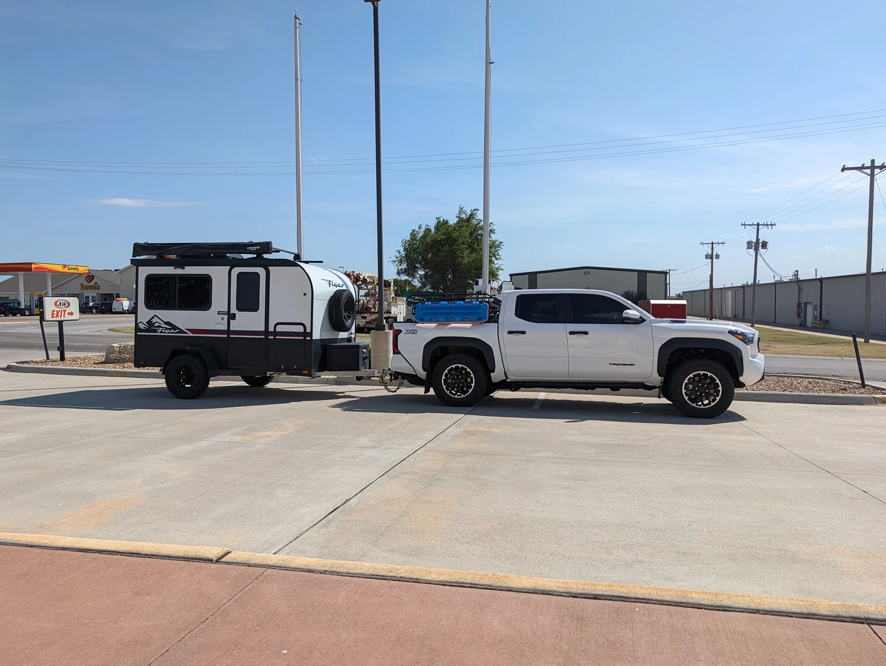

2024 Tacoma Anyone brave enough to tow a camper yet? I was. PXL_20260912_201514142

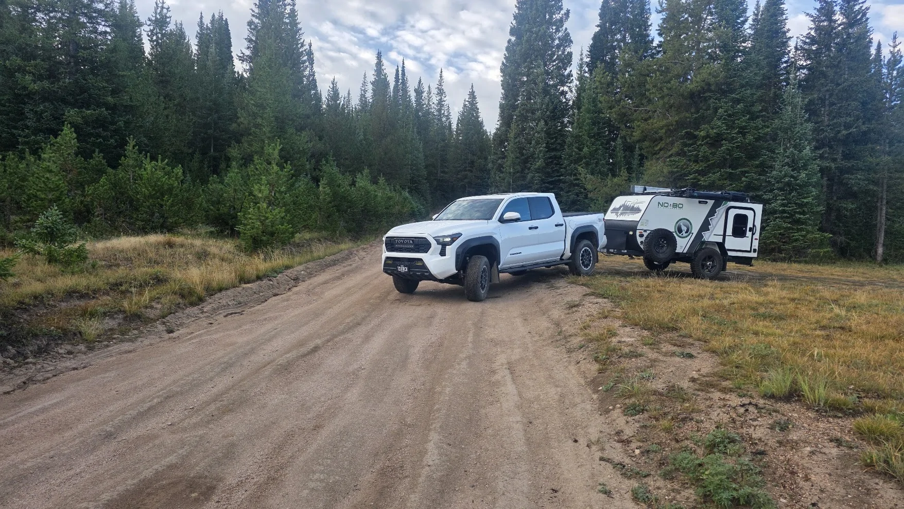

2024 Tacoma Anyone brave enough to tow a camper yet? I was. 20260822_150541

Thats a nice setup, I like it and the mpg is crazy good with a load. Do you have the stinkbug effect with no load? Do you have a pic without the camper?
Doesnt seem to be much for photos of the truck. It looks slightly taller than stock but not by much. The pic with the bed rack and nothing loaded is the only picture I seem to have of it with the alldog springs.

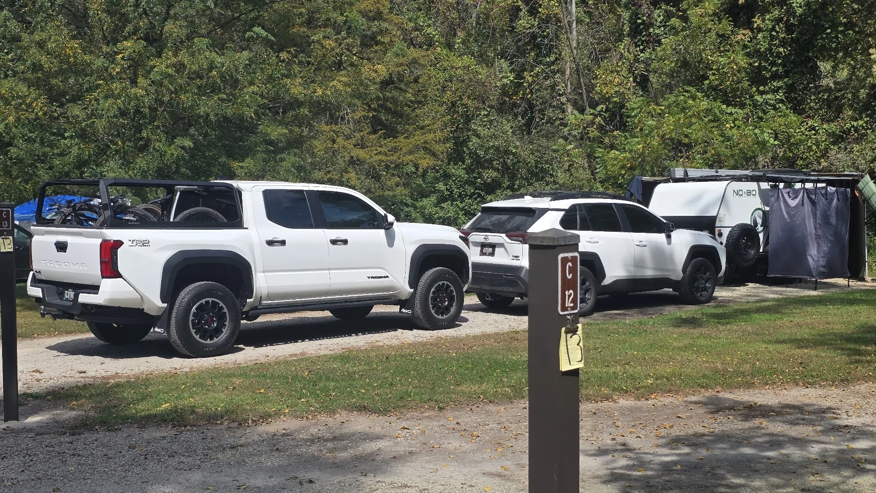

2024 Tacoma Anyone brave enough to tow a camper yet? I was. 20260825_072215

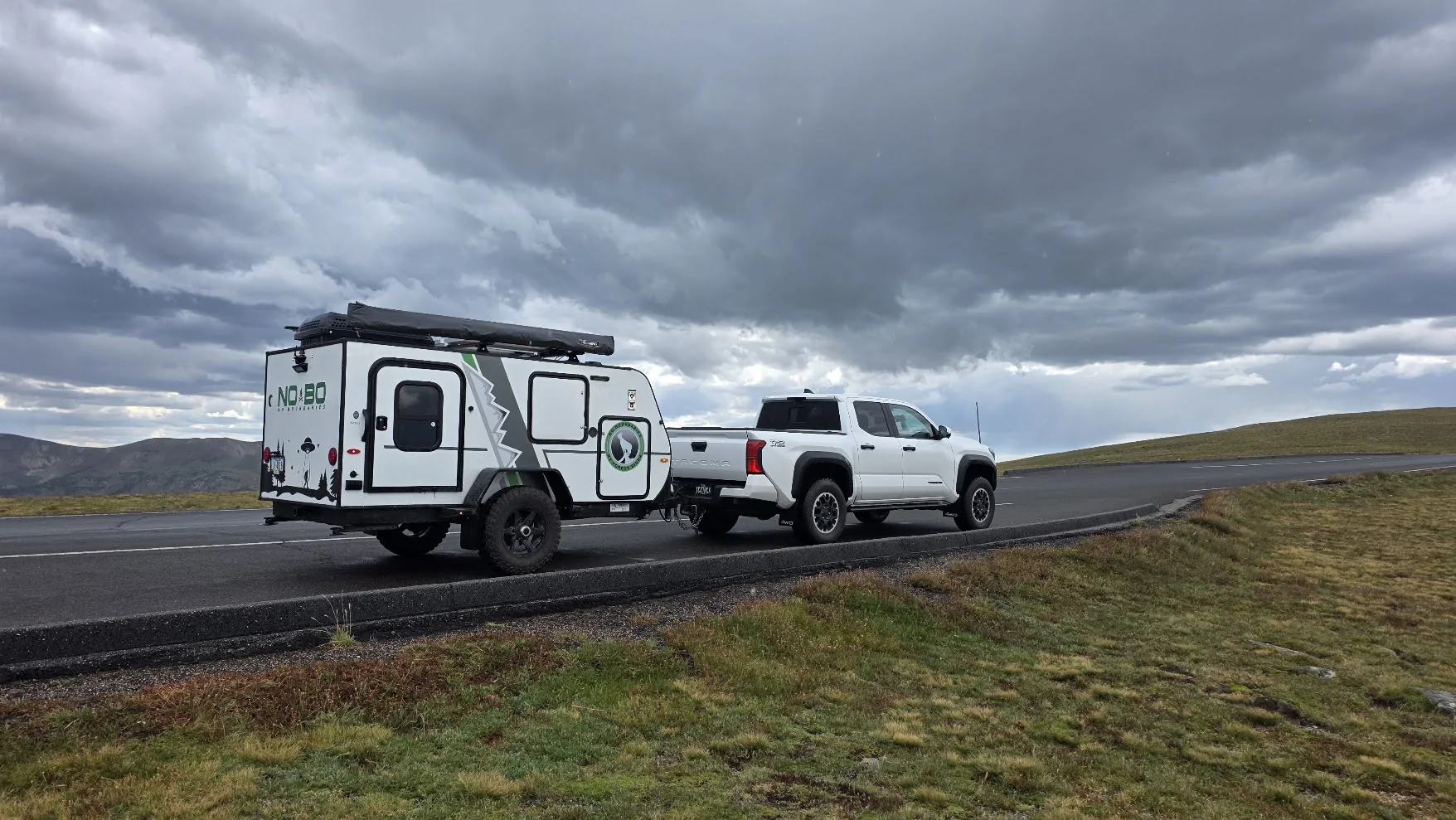

2024 Tacoma Anyone brave enough to tow a camper yet? I was. 20250913_135259
