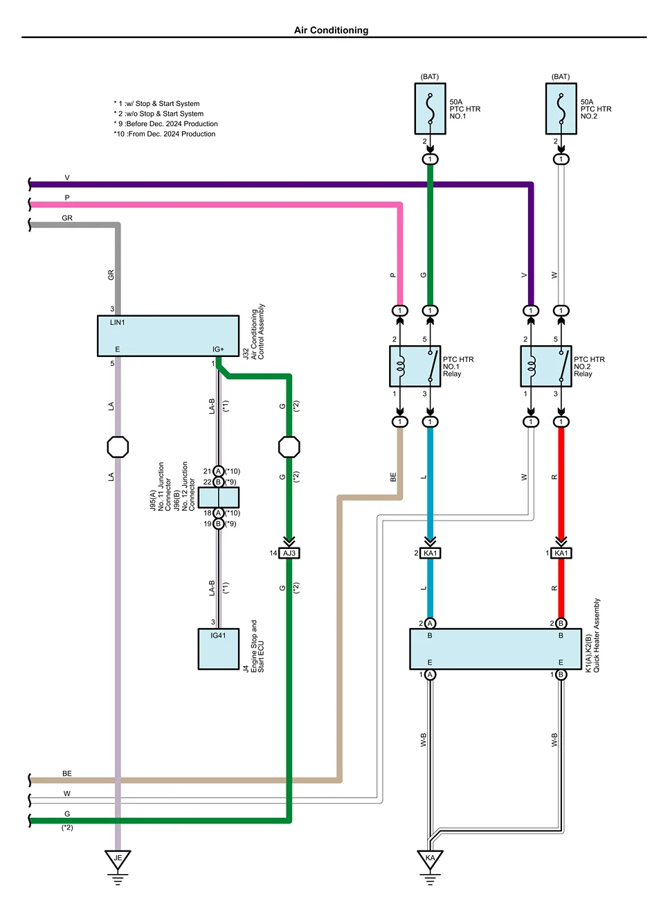

Also maybe someone with a parts diagram can check and see if these trucks have PTC heaters like the 3G and many other Toyota vehicles.
These are small ceramic (think indoor space heater) heaters that heat up the interior before the engine gets warm.

It has a PTC heater, powered by two relays.

Good to know! Thanks for providing the diagram.
Then crank that heat to the max and it'll probably solve all this whining about the heat :cwl:
If it's anything like the 3G, you need the heat to be maxed out and engine running for it to work.

I don't have too many complaints, and it's hard to do a direct comparison with my 3G since it has auto and does all the heavy lifting for me. Manual climate totally depends on me being competent. I would say on a cold day of 20 degrees, if I put the fan speed on max and turn the heat all the way, I am probably comfortable in 4 minutes and uncomfortably hot in 8 minutes. But I haven't really given it tons of seat time evaluation either. Again, it also seems to vary drastically whether the AC is on or not. I tend to have it on for humidity control. The heat definitely seems drastically neutered with AC is on.
The 3rd gen I was good in about 2 minutes of driving. By that point the PTC heater was already doing it's thing and the engine was starting to output heat. The 4th gen seems to be slower for the heater to respond with engine heat (despite the engine actually being warmed up by the same amount). If anything, that is what my complaint would be. For example, if I'm halfway warmed up on the 4G, it seems to be less warm than halfway warmed up on my 3G. I think that is where any of my confusion and complaints come from. Overall I'm fine with mine though. It kinda sounds like OP has a problem, or maybe there is a small chance the usage of the controls isn't quite right.
