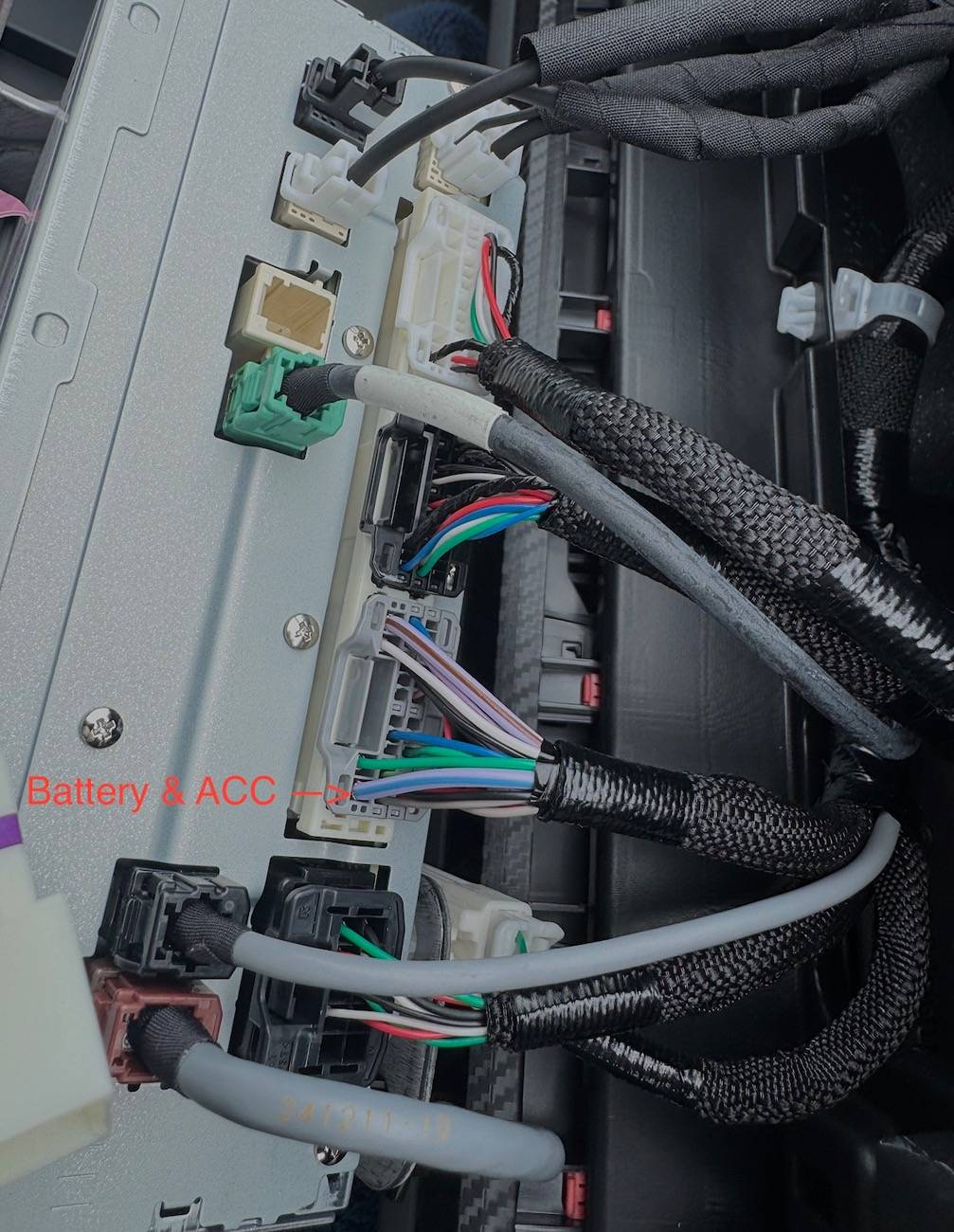

Head unit power supply [photo below]:
On all models the stereo/head unit has both 12V ACC and Battery wires. The main harness/connector to the HU will be white on some units, grey on others and is generally located towards the left of the HU rear. Battery +12V is pin 1 row 1 (top left), ACC is pin 1 row 2 directly below the battery. Use the side of the HU for negative car ground.
