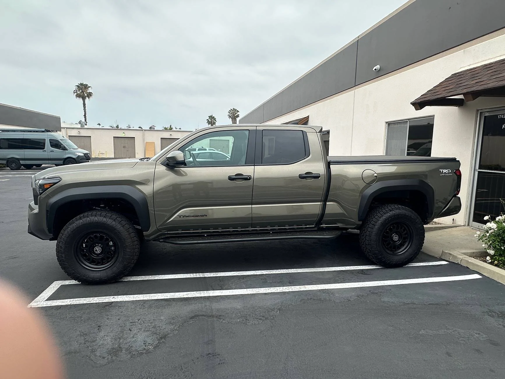

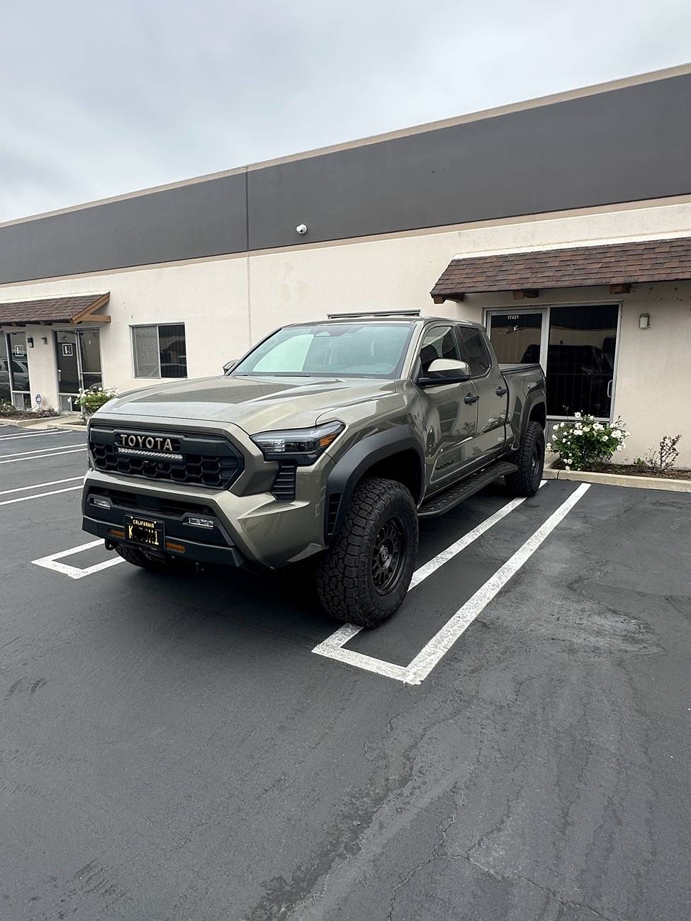

This weekends project was installing the RCI bumper with the overland vehicle systems scar 10 winch. Got the winch on sale from optics planet of all places and also used a coupon code ending up with it shipped to my door for 421$.
2024 Tacoma Bronze beast build thread IMG_8740
So just some notes about the bumper
First off I love the fit and finish of it. The license plate mounts in the original spot and doesn’t interfere with anything.
The trd off road skid plate doesn’t work with the bumper. I left it on, but you have to remove the front two bolts to get the bumper under it. No biggie as I’ll be running rci skids soon enough.
I’m running the TH grille with cali raised 20 inch light bar mounted using a bracket design I made which is part aluminum and part pa6-cf.
tires are Toyo 285/75R17 and the wheels are icon anza with 25mm offset.
I have a long bed and I’m currently working on a sort of “weather proof” bed divider. The idea is to run a 5 foot bed tonneau cover and leave about a 13 inch gap up near the cab so I could mount my spare tire against the cab and still have at least 5 feet of covered space.
icon suspension is en route and I’ll be installing that next weekend and cali raised sliders on order no clue when they’ll ship but looking forward to it.

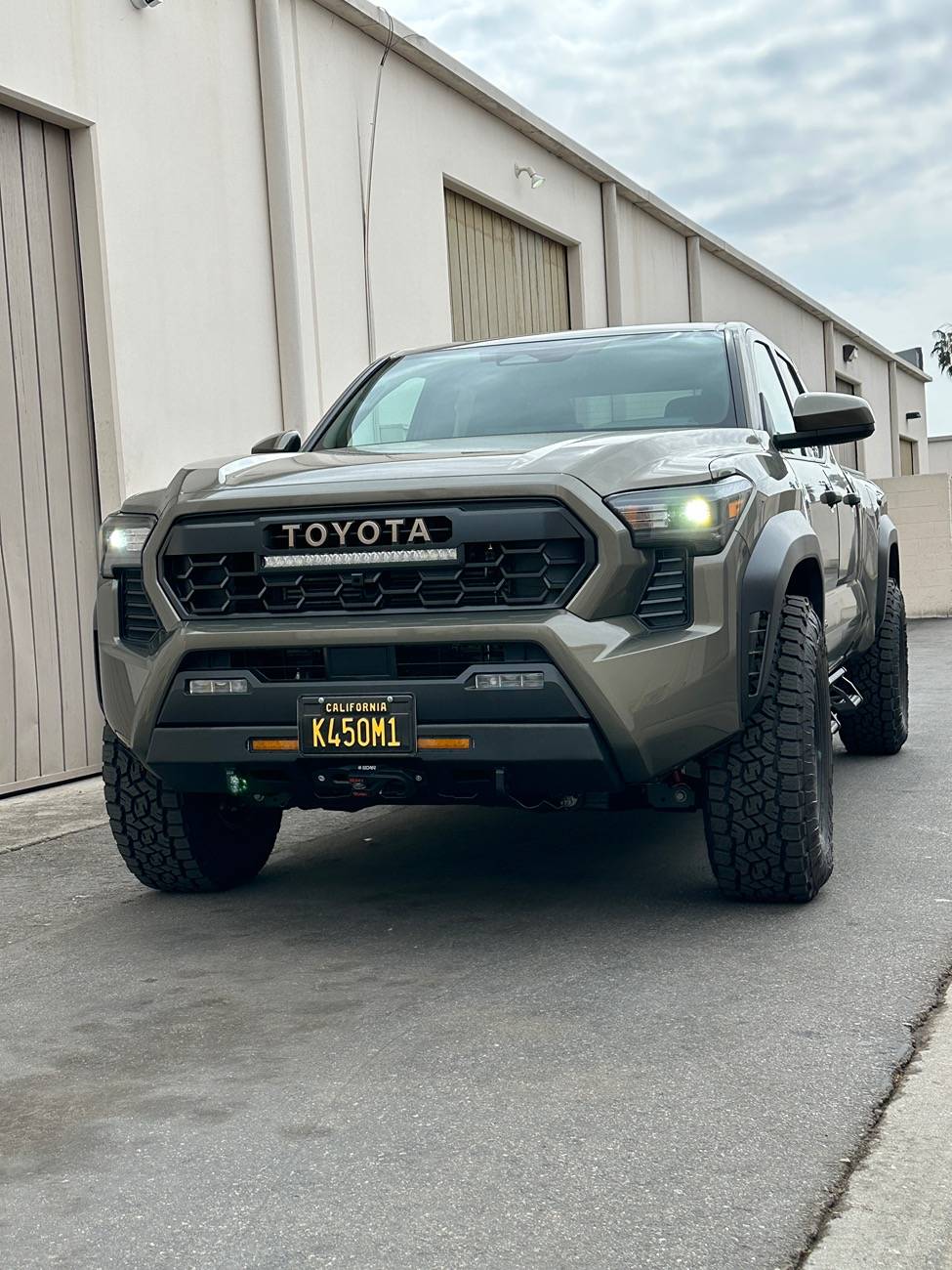

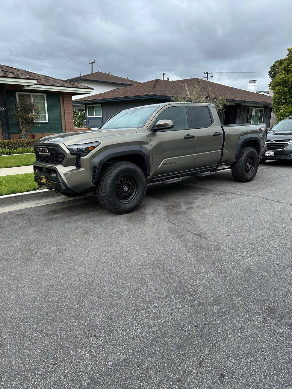

installed the @Ironman4x4 foam cell pro, but with dobinsons coils up front. I went with the Ironman coils in the rear. My problem is I only want 2.3-2.5 inch lift. I’m not looking for it to be level, prefer a slight rake maybe 1-1.5”. Front is 2.5 but the rear with these coils is sky high. I went with the lighter coils too. These photos I have 180lbs in the bed and it’s still jacked way up. I know the coils will settle some but no more than a half inch is my guess. I’m adding an ARE cap, and putting a drawer so my weight will be about 350 constant. Hoping that puts me at a 1 inch rake but we’ll see. I’ll update for anyone thinking about this kit.
