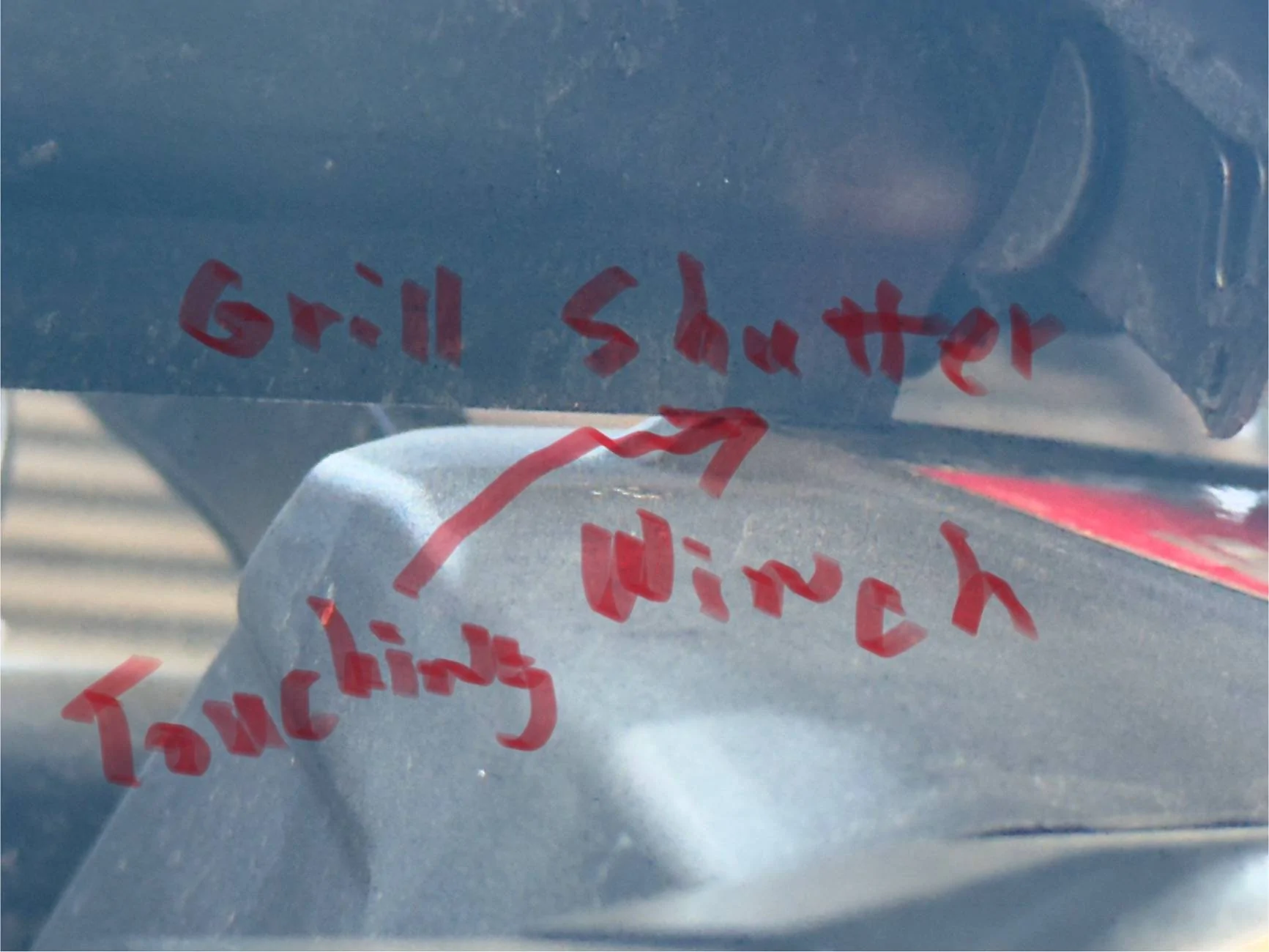

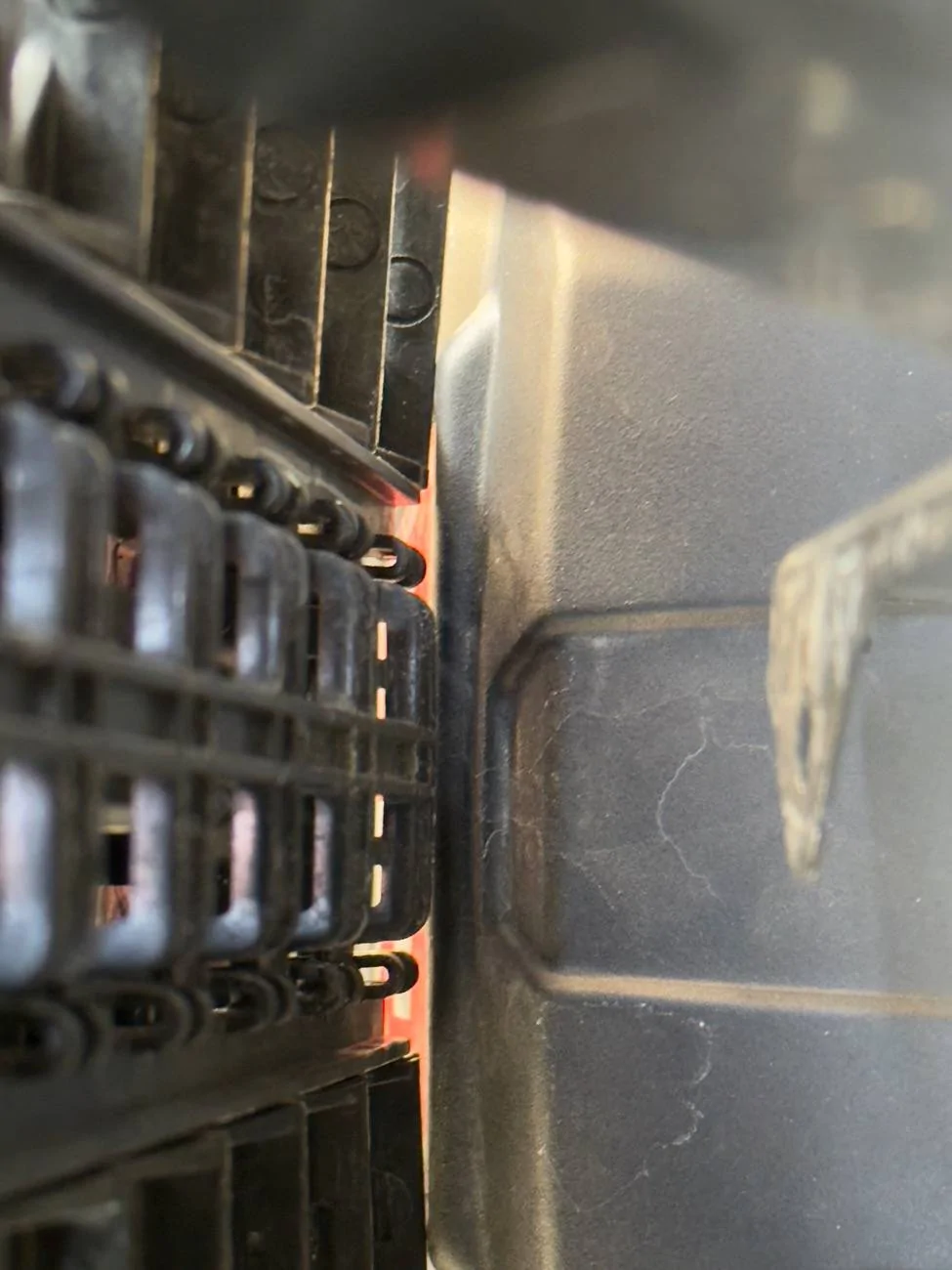

I did a lot of research before I went with a lot of CBI products.. Prinsu Pro roof rack for 24 Tacoma ( decided not to get ARB/ Toyota Rack after hearing all the noise comments). Rack is awesome and that’s where CBI stopped being awesome.. had AVO in Asheville order the Covert front bumper which was advertised as retaining all factory sensors and lights and had mounting and would fit a winch.. They actually advertise the WARN VR 10s to sell with the bumper to fit… That didn’t work well as there were some problems mounting the front bumper with what sounds lie multiple calls from AVO to CBI during the process.. When they finished they said BTW CBI didnt figure in the Fog Lamps and havent created brackets for that yet so yours are in the floorboard until they make the brackets that will fit. AND THEN, while driving home from MS to TN, got the dreaded multiple warnings (Grill Shutter malfuction/ Check Engine/ System Malfunction/ Drive-Start Control Malfunction) as I started up after refilling gas tank. Drove to dealer the next morning and they claim it is all because of the winch touching the grill shutters. Also there was an Ambient Temp Sensor just flopping in the breeze.. Looks like AVO will have to remove the winch until CBI can desing a bumper that will mount a winch that wont interfere with Grill Shutters.

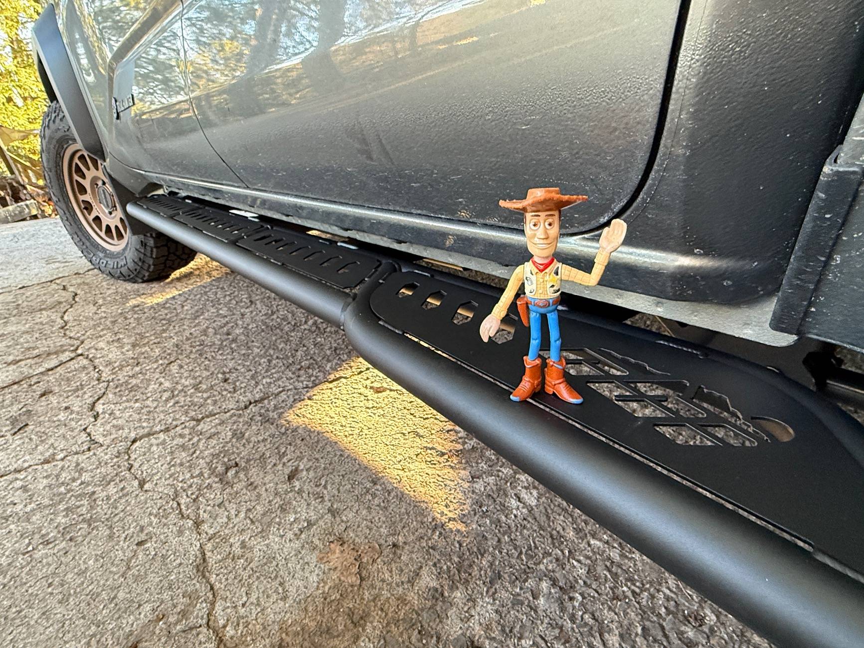

All this on top of the CBI Tacoma Overland Bolt on sliders didnt bolt on when we attempted to bolt on.. had to cut a small piece off a metal hanger on both sides to get the holes to line up.. And the long through bolt through frame did not work as there is no hole and there is framing. There on the hybrid that it doesnt work as they described.
very little communication back from CBI after I sent them pics and description other than they heard from someone else who had same problem.
They said that the Hybrid was a little different in stuff on frame than the non Hybrid..
I will say that once we cut and bolted the sliders on that they are really nice..
But someone needs to be proofing their designs before they release products to customers. I will have to drive 3 hours one way to Asheville and spend the night to get the problem fixed.. Not happy to say the least..

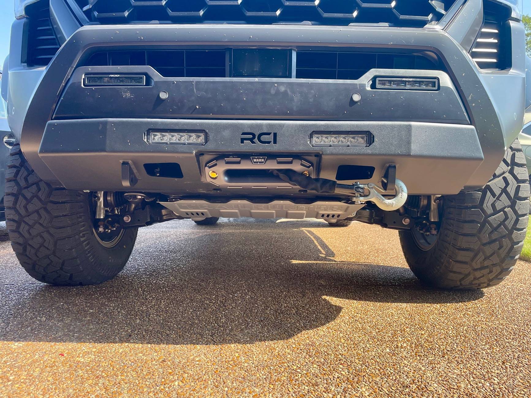

All products I’ve received and installed from RCI have great fit and finish.
