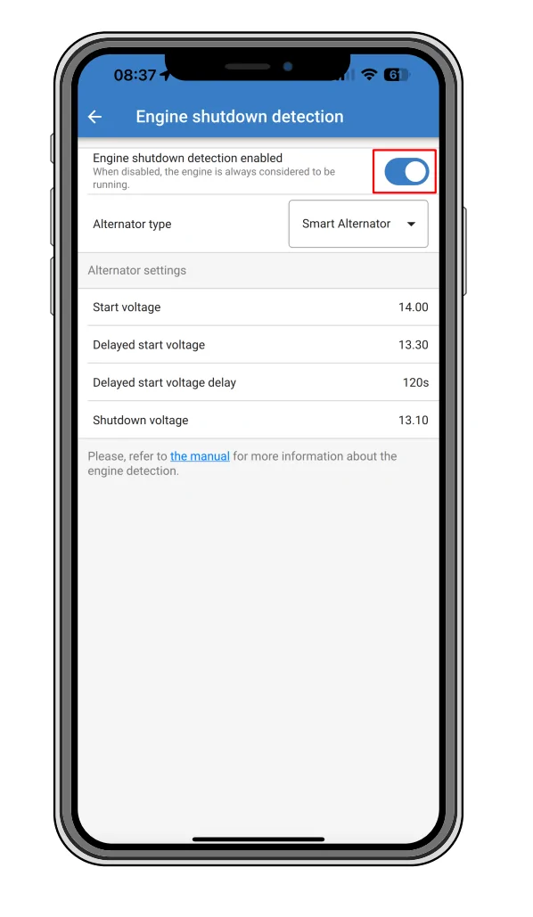

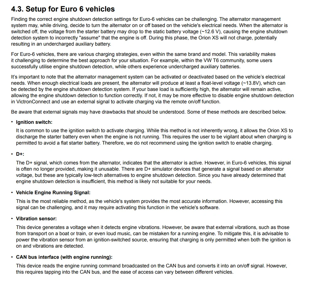

Installed a deep-cycle battery (Optima Blue Top) in a box on our bed cargo slide and am charging it with a Victron Orion DC/DC 50amp charger. The hybrid charging system on my '24 is causing an issue with Victron's engine-running detection algorithm. So, the options are either to find an engine running circuit to tap into on the truck or to use a CAN bus interface that detects engine running I think. Sometimes the charging system on the truck drops to 12.6 while driving, so I don't think it makes sense to drop the Victron's engine running sense that low.
Just talking through it and wanted to make a post in case people search online for the same issue.
Those of you with alternators on the newer hybrid trucks may not have the same issue? Not sure.

My 3rd gens were tuned, so I could adjust the smart alt algo in the tune for my AGM dual batteries, not sure if that's an option on the 4g or not. Hesitant to tune this truck while it's under warranty, with all the issues that Toyota has been having with drivetrains.
