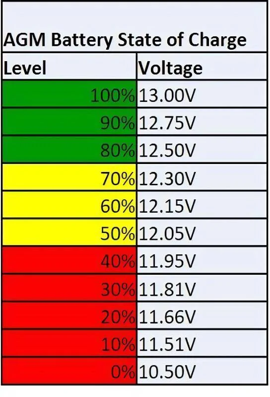

Unless your truck has been sitting for an extended interval, that's unusually low for a Tacoma, even with Hybrid power system. You mentioned you weren't sure how low it can go to power your electronics. That battery voltage is something like 50 % charged or less. (depending on the chart used) Lead acid batteries really shouldn't be run down lower than 50% at most. At 12.08v (FWIW) you might consider topping your battery off... If your battery is the kind specifically made for "start/stop" operation and not a standard AGM, (an EFB battery) I'd still bring it up, again, "For What It's Worth."
Update: When the voltage read 12.08V it had been sitting for four days. Sitting overnight it went back up to 12.25V, which is where it usually settles, and enough to power the electronics and it started fine. As soon as it is running it shows in the middle of the voltmeter range, which I am guessing is about 14V. I can charge it up, but after a few drives it will just be back there again. I'm hoping that my dealer decides the battery needs replaced and that is the end of it. I will report back later.
