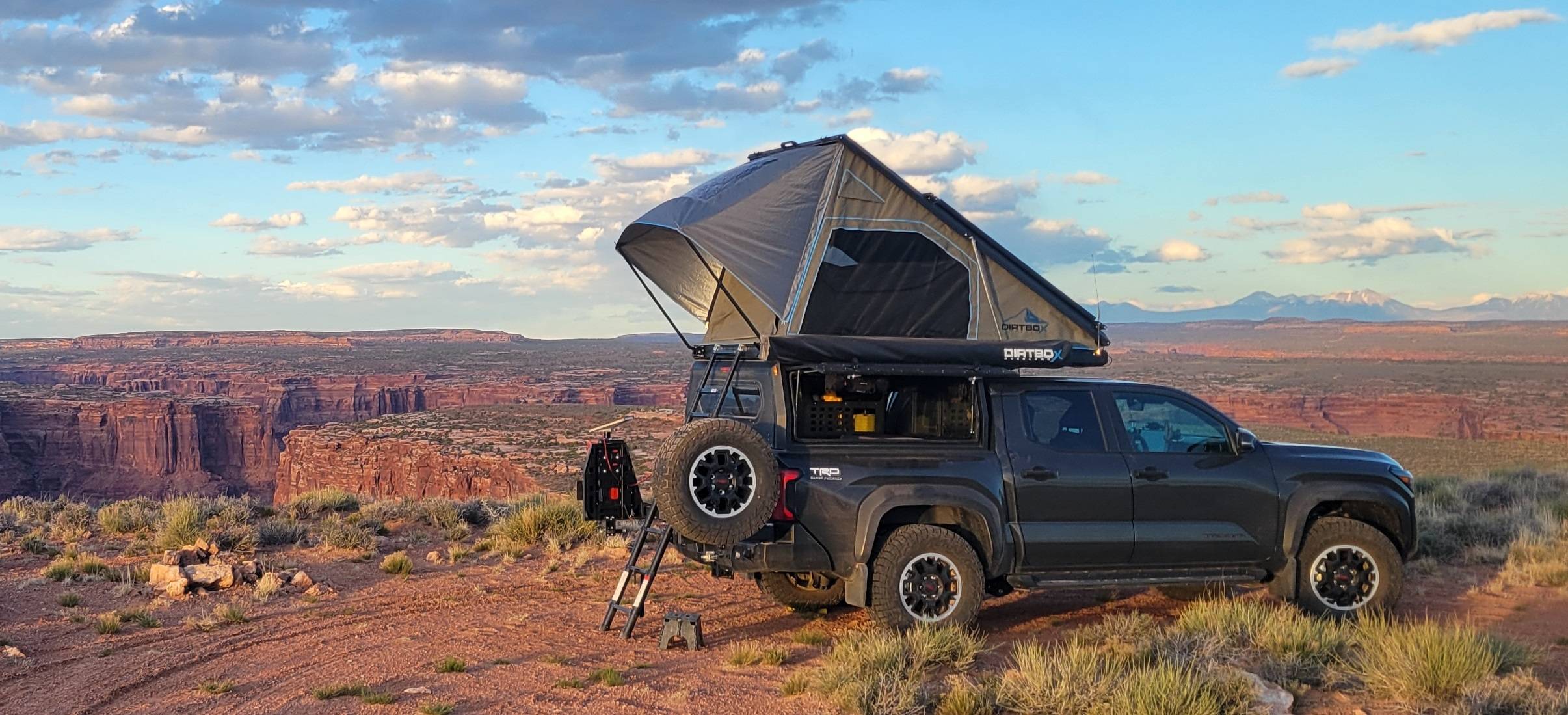

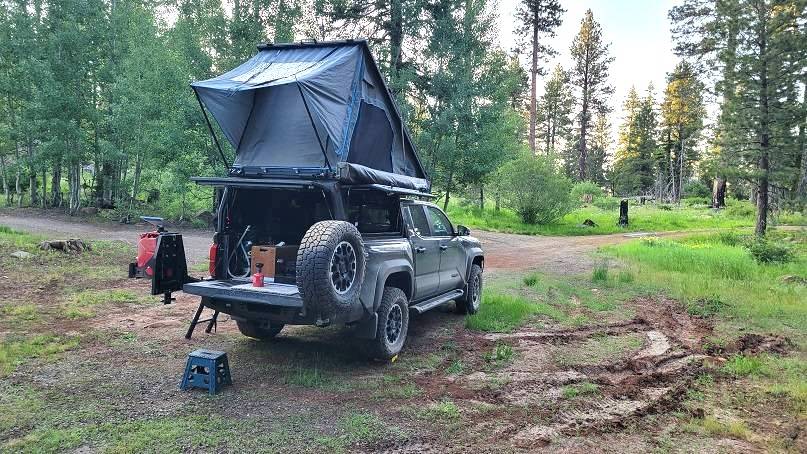

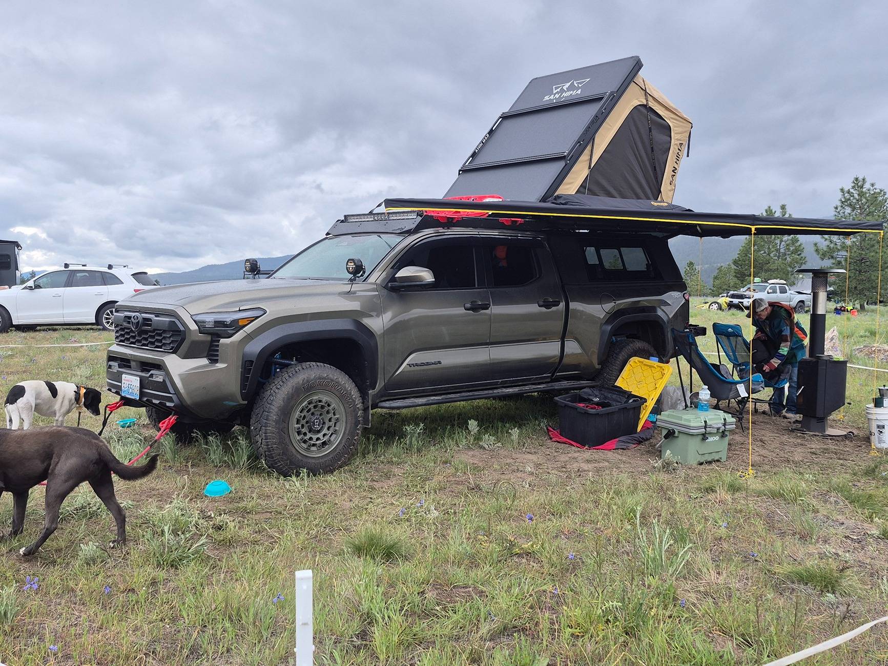

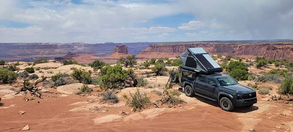

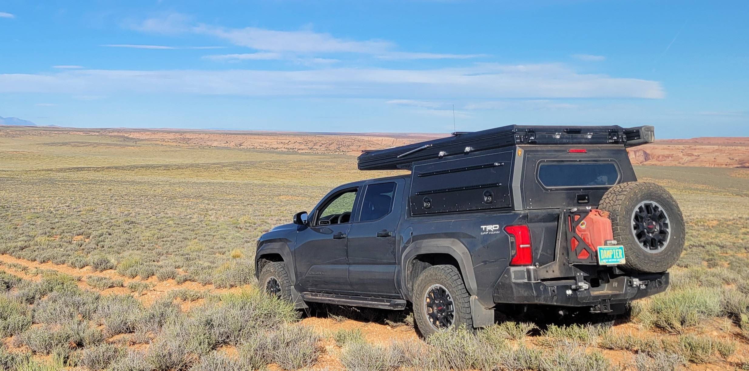

My truck is getting built for a specific purpose. Extended camping/overlanding trips lasting +/- month where I won't be doing anything that requires the capability of my Gen1 4Runner. I still have that for Canyonlands and the like. Yes, the Tacoma will be capable, but not Moab capable.
I looked at just about every camper/canopy out there and came to the conclusion that the Dirtbox fit my needs the best. This will be an evolution. I've only had three shake down trips, and it will continue to evolve.

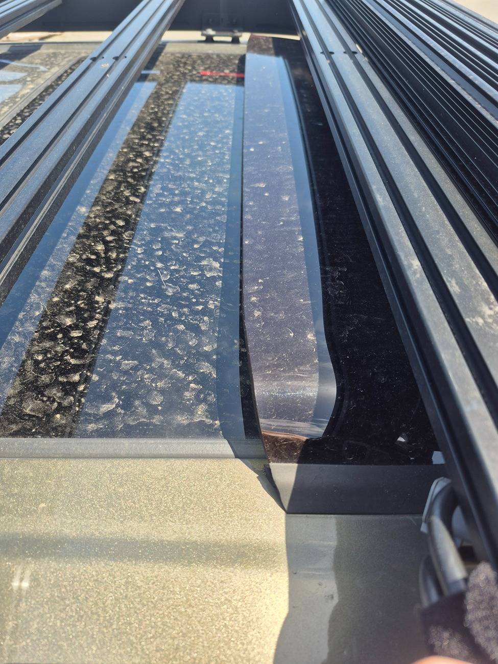

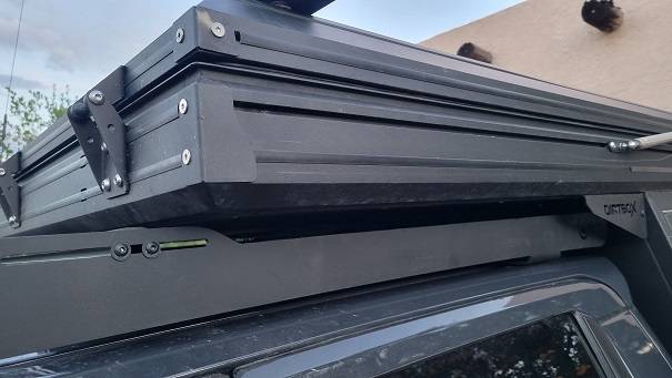

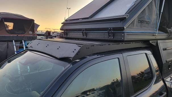

One of the issues I had was wind noise. Mostly in the space at the back window. I looked at several solutions ranging from some sort of a deflector on the camper, to a roof rack. After a bunch of research there only appeared to be two low profile roof rack solutions that might fit between the top of the cab and the camper. Front Runner, and Prinsu.
I talked with both companies, and neither could tell me for sure if it would fit. I went to Overland Expo a week ago and talked with both companies, and looked at what they offered. Prinsu happened to have a rack for the truck at the exhibit. Between the event discount, and no Oregon sales tax, I bought it. It was installed in camp with the assistance of a camp neighbor. Install of the rear bolts was a PITA with the camper.
It was tight, but fit. When I came home I pulled the rack and modified it under the camper to give more clearance. It not only significantly improved the wind noise, it appears my gas mileage went up a little bit. I now have a rack over the cab if I want to install something (gas?).
Before.
2024 Tacoma Dirtbox Overland Canopy/Camper + Prinsu Rack rack before_sm
After.
2024 Tacoma Dirtbox Overland Canopy/Camper + Prinsu Rack rack after_sm

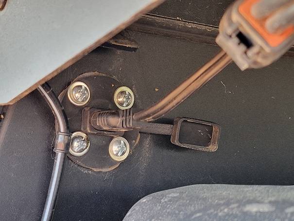

  • Pre-wired for third brake light and running lights. You need to wire them up.

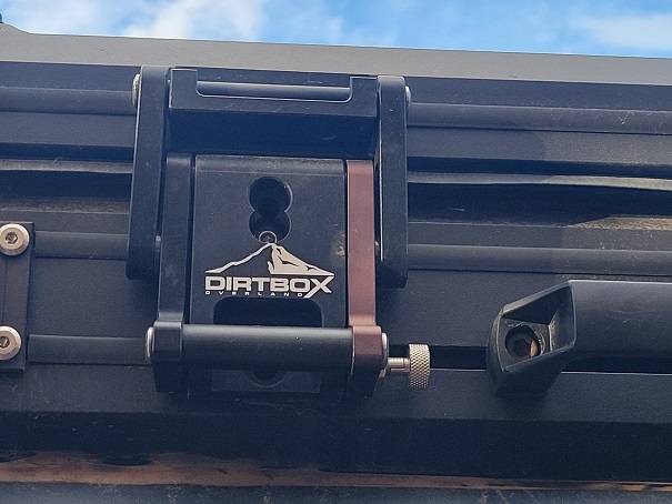

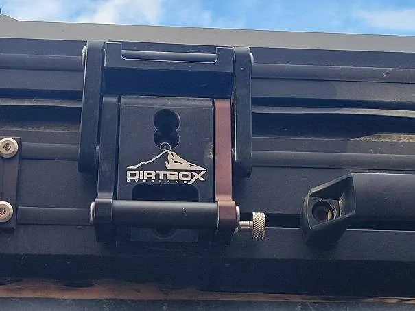

  • The latches on the tent, and the gull wings are great.

  • I've had some fading on anodized parts. One of the three L-tracks faded, and one of the arms on the tent latch faded. Dirtbox is sending me a replacement latch arm.

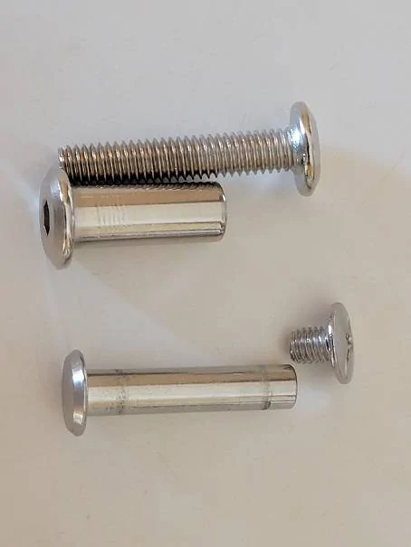

  • On the optional awning I lost one of the screws that holds the legs to the arms. Dirtbox sent me a set of replacement screws. Unfortunately, they didn't match. Fortunately, they had potential and I thought they were a better idea. I was able to modify them, and I'm very pleased with the replacements.

Faded tent latch arm. Replacement inbound.

The awning screws. New screws on top, original screws on bottom. I needed to drill out the awning arm for the larger sleeve screw, and shorten the bolt from 30mm to ~26mm. Easy.
2024 Tacoma Dirtbox Overland Canopy/Camper + Prinsu Rack Awning bolt_sm

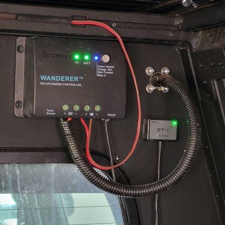

  • Renogy 30A solar controller, with Bluetooth.

Renogy 30A controller with BT.

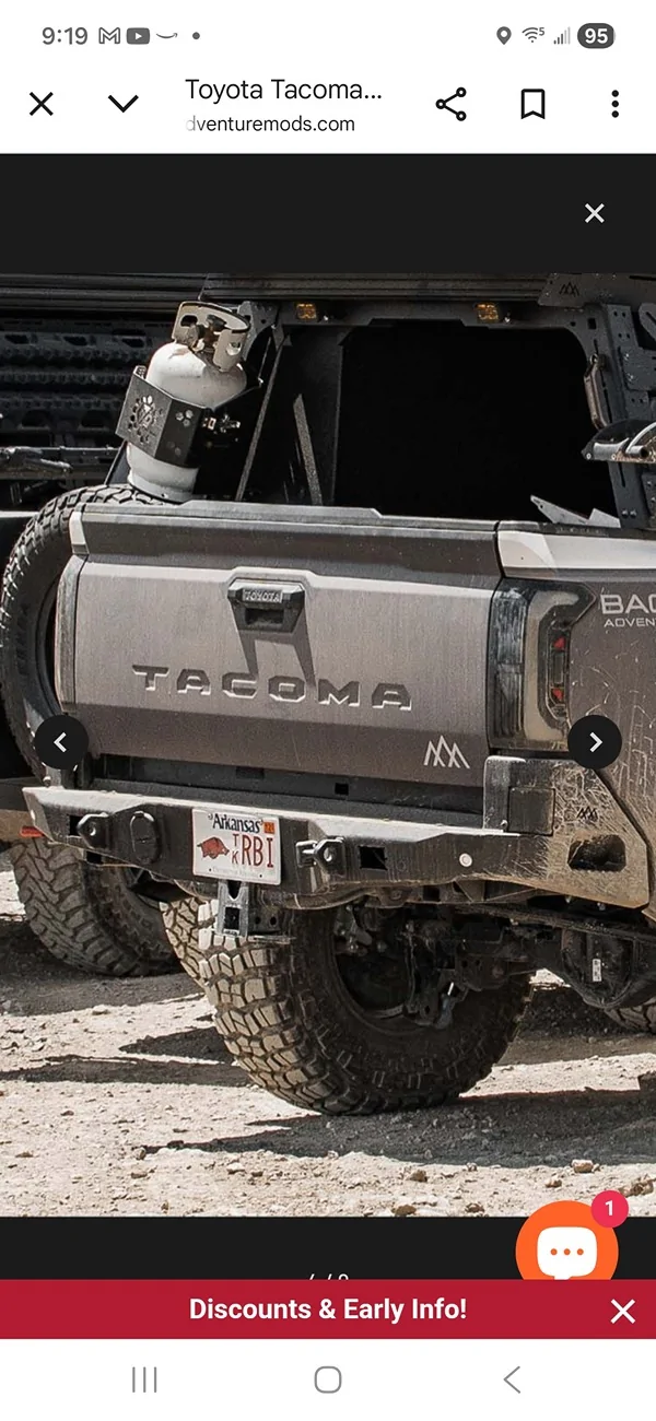

I'm waiting on backwoods to release their high clearance.Overland rear bumper to match the front high clearance rear bumper, with their hitch mounted dual swing or.
2nd choice would be DRT fabrication high clearance wrap around rear bumper, with backwards adventure hitch mounted duel swing.

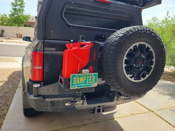

Victory 4x4.
Thoughts? Overall, now that the bumper is installed, I like it a whole bunch. Unfortunately, installation was not a smooth deal. Most issues were easy to resolve myself. The issues were:
1. Victory 4x4 sent me the wrong parts to mount the rear swing outs (too short), fussed with me about it, then admitted they messed up. They did make it right.
2. On the swing out is a stop plate. It's engineered to hold the swing-outs perpendicular to the side of the truck (i.e. out in traffic). That would not work for me. My solution was to drill a second hole where I wanted the swing-out. This way it sat parallel to the side of the truck along the tailgate, which is what you see in the pictures.
3. The counter-sunk screws that hold on the swing-out stop plates are ridiculously too short. A quick trip to Home Depot solved that issue. Longer screws made it easier to get the nuts started on the very blind back side.
4. The gas can carrier is designed to be mounted perpendicular to the swing out (shown in the pictures). I didn't like that idea, so with a little measuring, drilling, and new hardware I mounted it flat.
5. The swing-outs blocked the rear camera. I bought a second camera and tailgate harness, teased out the camera wires and remounted it to the license plate location on the bumper.
6. This was the largest issue. There is a top plate that ties the bumper together. NONE of the frame bolt holes lined up. I had to drill out the bumper to get the silly thing installed. I did see another individual also installed their bumper, and he didn't mention this issue so hopefully my bumper was a one-off.

Remounted gas can carrier.
2024 Tacoma Dirtbox Overland Canopy/Camper + Prinsu Rack gas can-sm

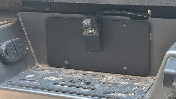

Remounted camera.
2024 Tacoma Dirtbox Overland Canopy/Camper + Prinsu Rack 20250616_160407-sm

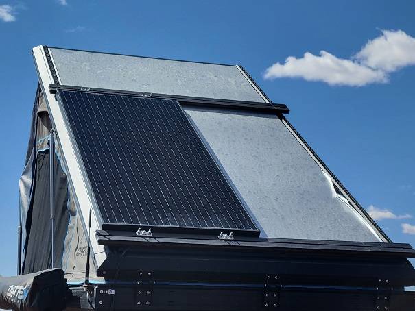

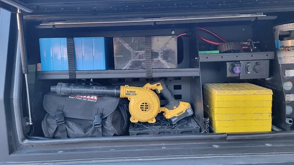

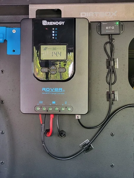

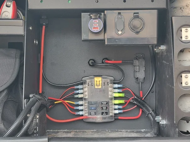

Since this has come back up to the top, I did make a few changes after spending 50 nights on a Canada/Alaska trip this summer. Bottom line, I needed more power in the camper. I have since installed a second 190w panel, replaced the 30a PWM controller with a 40a MPPT controller, and doubled the batteries from 100ah to 200ah.
The fridge in the back seat was originally powered off its own 50ah battery under the seat, but since I doubled the power in the camper it is now powered off the camper batteries.
Second panel on top of the Dirtbox.

40a MPPT solar controller, with Bluetooth.
2024 Tacoma Dirtbox Overland Canopy/Camper + Prinsu Rack Solar controller 40A short-sm
Two 100ah batteries relocated to the top shelf of the molle box.
2024 Tacoma Dirtbox Overland Canopy/Camper + Prinsu Rack Dual battery-sm
Fuse block. Power for the camper lighting and outlets, two refrigerators, additional outlets (Starlink), water pump, and DC-DC charger input.
2024 Tacoma Dirtbox Overland Canopy/Camper + Prinsu Rack Fuse block-sm
