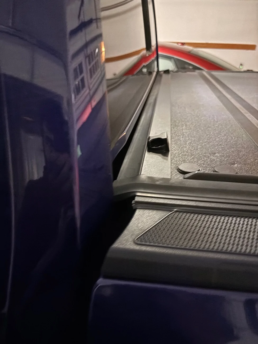

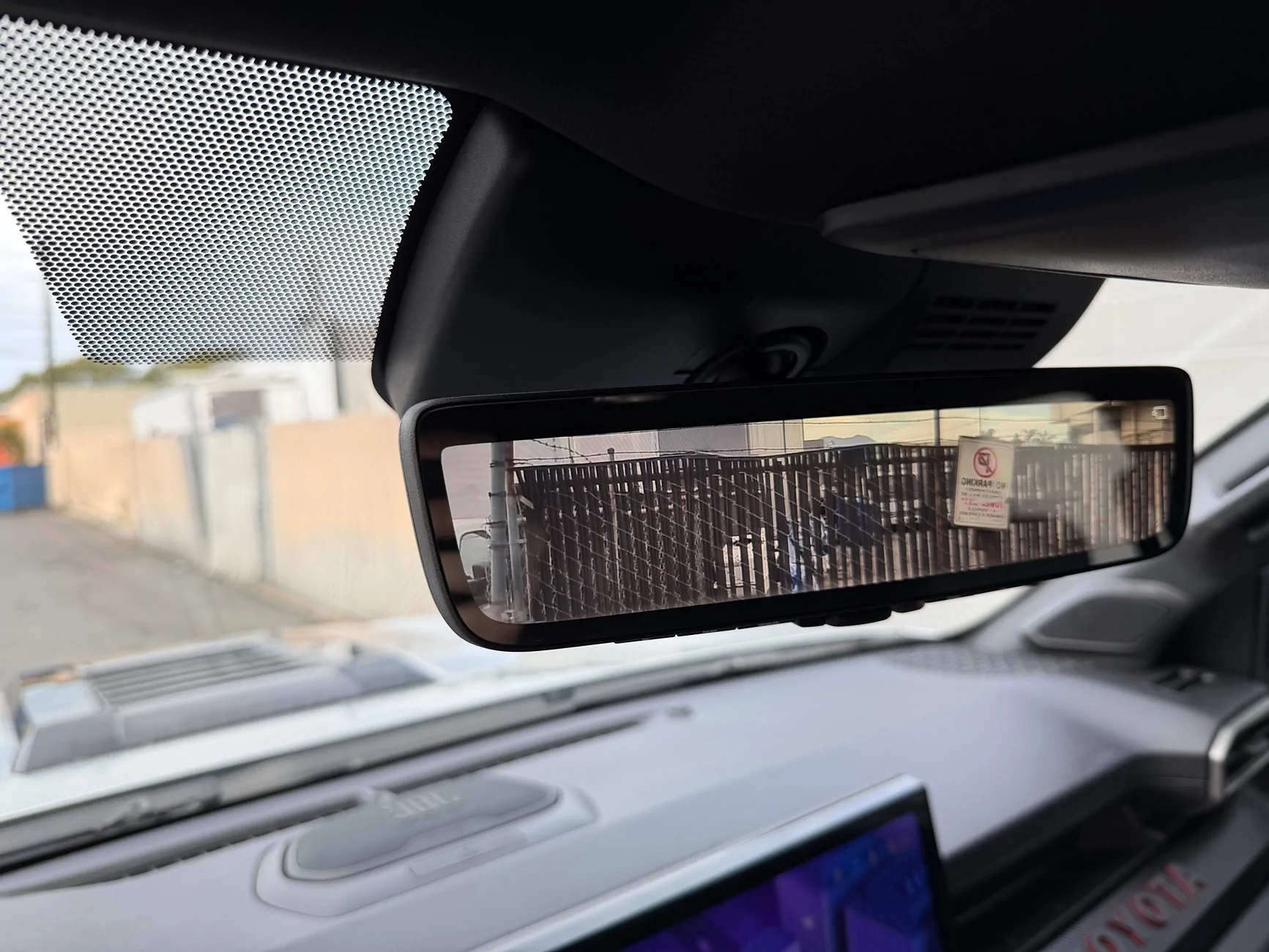

2024 TRD OR premium hybrid, bought it used. Truck came with the Toyota accessory hard trifold, opening it up all the way blocks the rear view camera feeding the rear view mirror. I assumed that was just the penalty for having a trifold but I saw a post on another forum saying they liked their trifold because it didn’t block the mirror camera. So…is mine just installed too far back?

Mine doesn’t cover the camera feed. Make sure it’s folded correctly. There is some adjustment that can be made to how they’re stacked once it’s folded.

It shouldn't cover the cameras, mine also doesn't. like mentioned, looks like you just need to adjust the tri-fold. Slide it a little back towards the tailgate until it clears the cameras when folded.

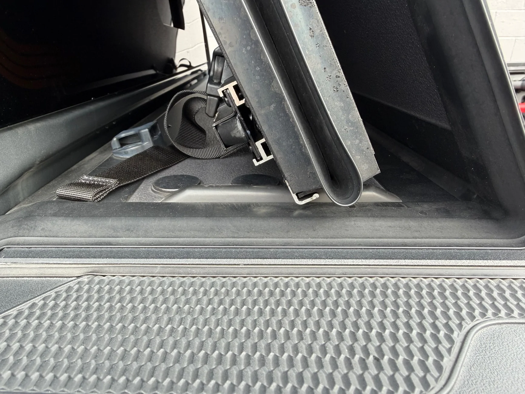

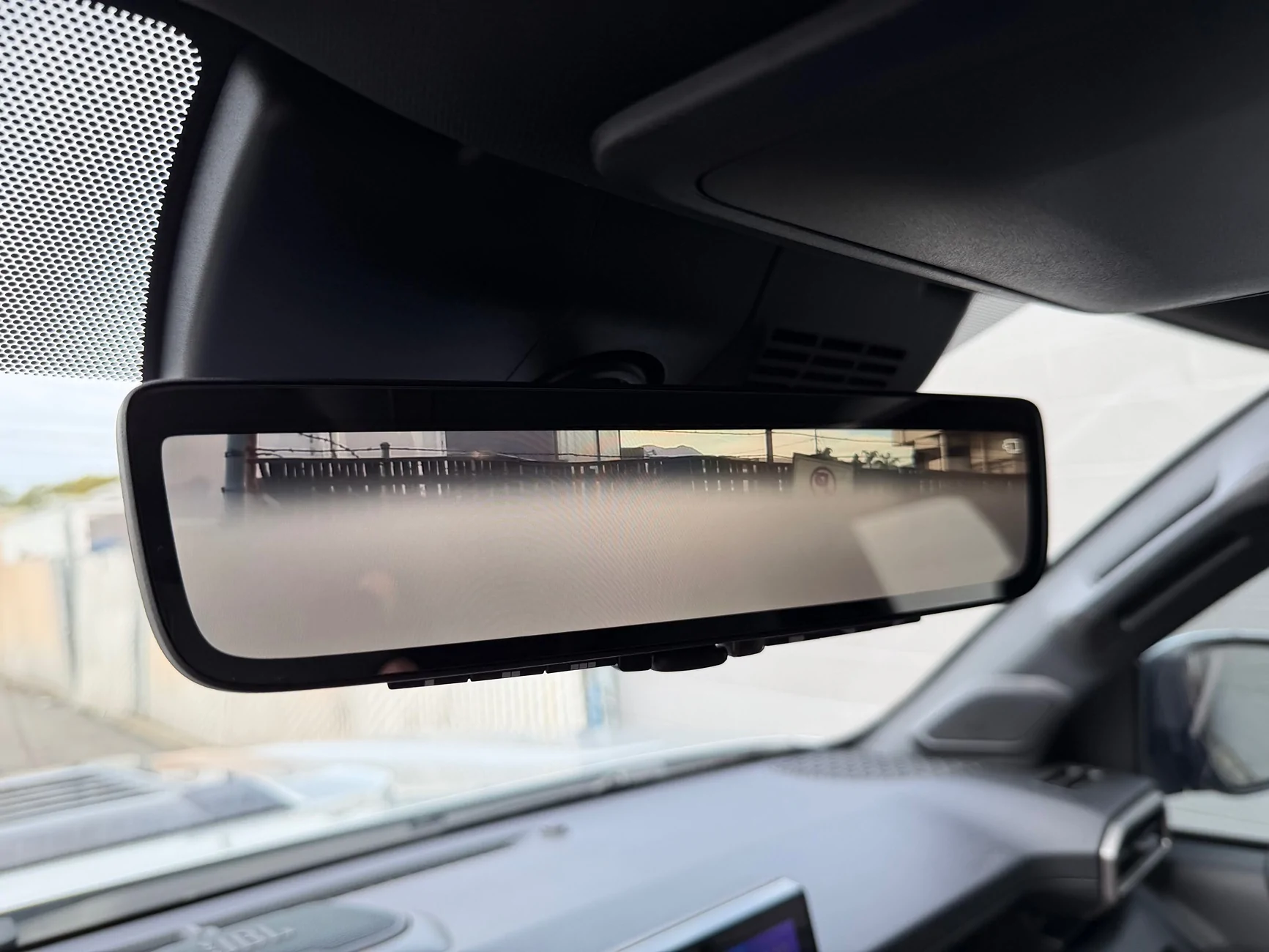

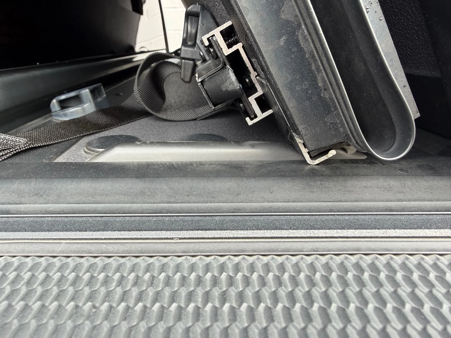

Here’s an example of how the panels are folded can block the camera.
Mine is blocked almost exactly like your top mirror image. I’m going to see if I can adjust it the way you have it in the second position. Thanks
