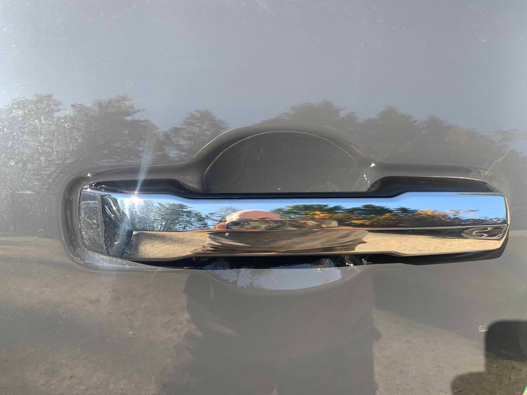

Here is a PPF template i used for the door cups.
They are about 4.25" on the short side so i used a 6" roll.
They're normally hard to see but i chose the light for this pic so you can see the lines.
Ideally this one would be 1/16" lower.
Door cups are kinda a pain. If you're an amateur like me watch some videos and expect to sacrifice a piece for practice.
I used hybrid Tac/Slip solution - only on the ppf, not applied to the door. But it seems everyone has their preferred method.
2024 Tacoma Door Cup PPF template (download) IMG_1654

What kind of tac/slip solution you use?
I did mine and did a pretty poor job at it, want to redo it.

@chon_jee
I used the hybrid solution on the left side of page 2 (for 99% iso).
With hybrid solution you have to go slow and try to get it right the first time. I started at the top and carefully applied it a bit at a time with my finger.
