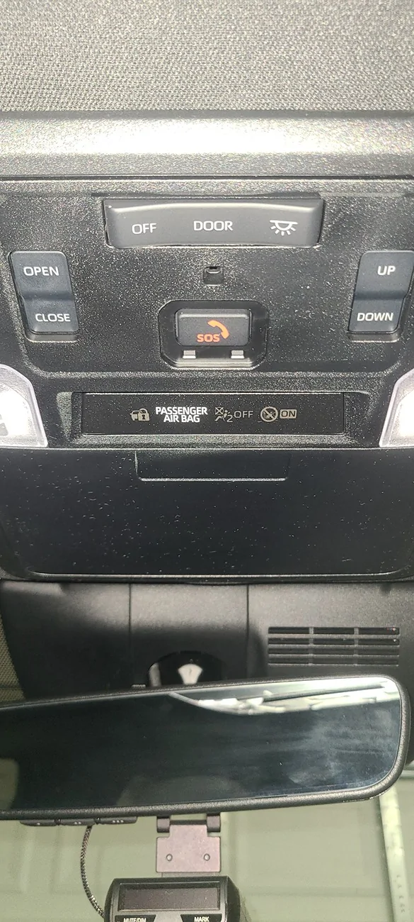

So my 2025 has both the map light and the bed lights switches set to door. But the lights wont turn on when any door is open. However the dash indicates the door is open and the lights function if i set the switches to on. So its not a door switch or a fuse.
Am i missing some setting?

Are your lights set to "Door" on the center top controller?

Yes it is. So is the one for the truck bed.

So I was about to get the truck ready to bring it back to the dealer for the day or two that they recommended to troubleshoot it. Then I figured out the problem. Within the lighting controls of the truck you must have the auto off timer set. If the auto off timer set off, the dome light will not come on. You have to set it for at least 7.5 seconds or more for the dome light to come on when the door opens.
Great job Toyota on this very intuitive menu. Great job for the dealer for not knowing this.
