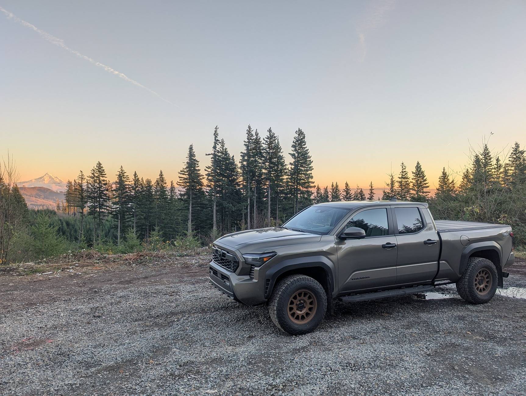

Pic first for those who don't want to read:
Hey, I'm new to this forum but a longtime survivor of many other forums (Pirate4x4, Irate4x4, iH8mud, others).
The goal of this truck is consolidate my GX470 and F250 into one vehicle, to serve as a capable but civilized daily driver. I live in the PNW woods and drive logging roads, Forest Service roads, and powerline roads somewhat often. I regularly drive in 12-24" of snow during the winter. My hardcore wheeling days are behind me; while I considered adding steel rock sliders to this truck, I don't want the temptation to wheel it hard. That's the same reason that I skipped the SDM option - in the 8 years I had my GX470, I was never held back by the swaybars even when I wheeled it a bit harder and I never felt the need to disconnect them. On my old 3rd Gen 4runner, I built disconnects and then never even disconnected them.
My other goal is for this to be the opposite of my past trucks; AKA, NOT A PROJECT. Factory build and OEM parts/accessories everywhere possible, and no DIY. At most, minor bolt-ons that take an hour or two. My time is my limited resource these days. I have turned every vehicle I've owned into a project, to the point that I couldn't trust any regular shops to work on it; therefore, all the maintenance fell to me. I'll happily work on my dirt bikes that I ride for fun, but being required to maintain my trucks became a chore and lost its luster. I'm going to try this "new truck" thing for a while with dealer maintenance - it's been great for our 2023 RAV4.

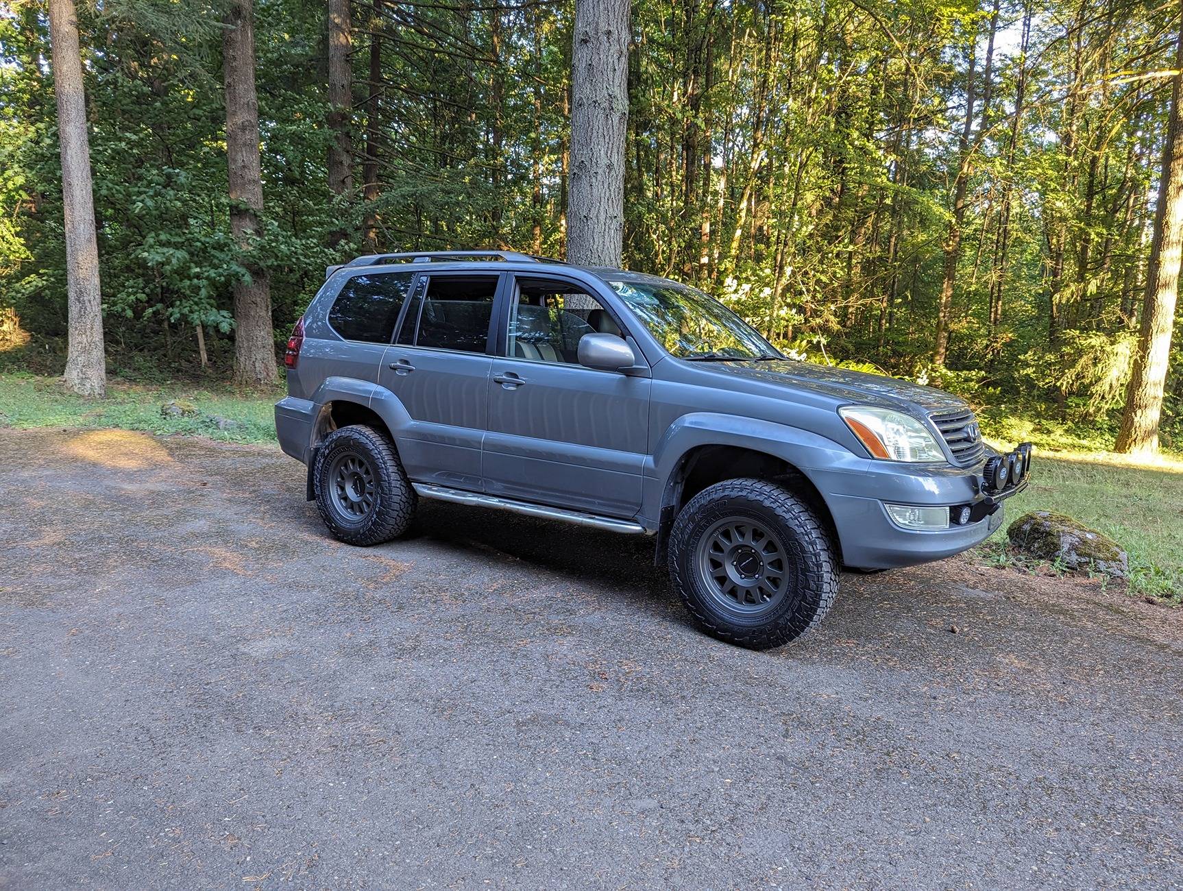

Here's my old GX:
Icon suspension with lots of other aftermarket parts, sliders, skids, lights, little mods everywhere. I loved it. But it became more than I really needed.

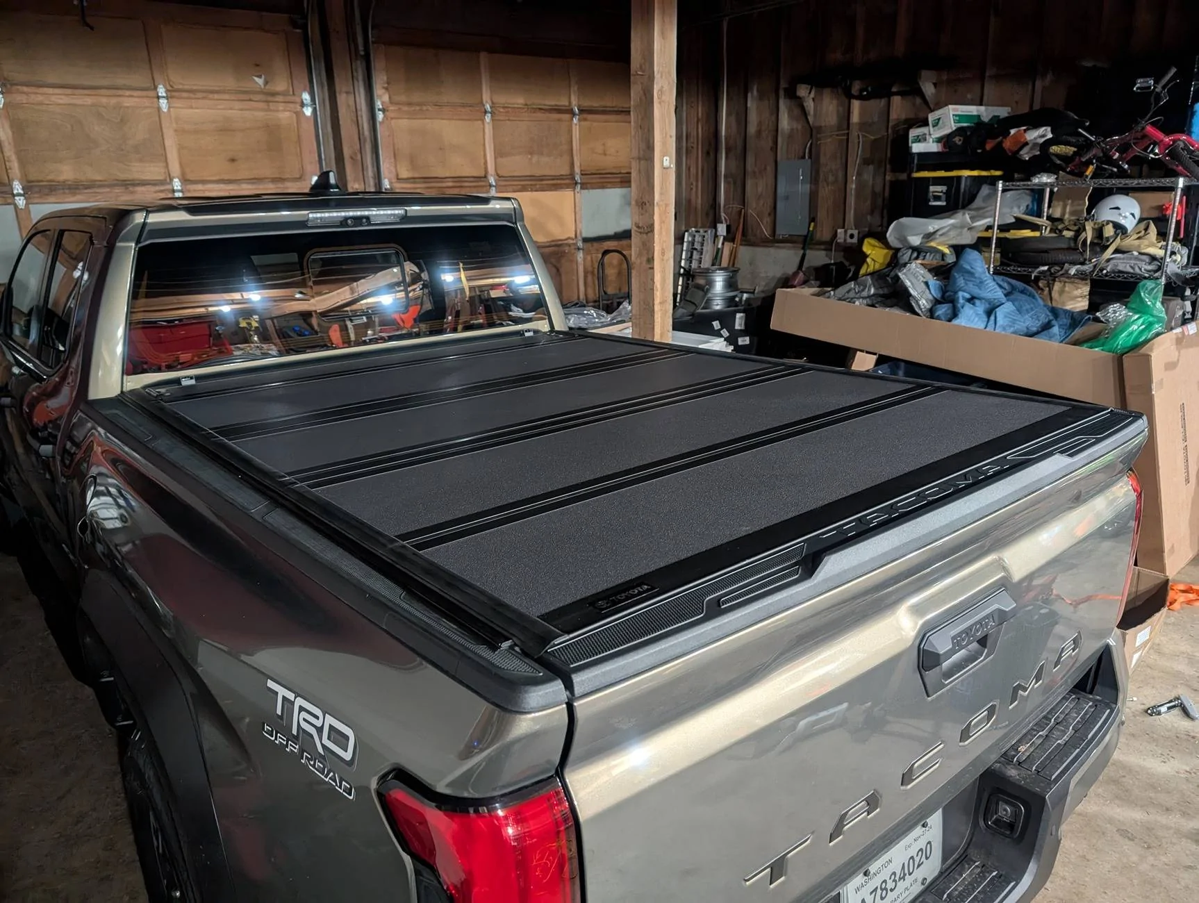

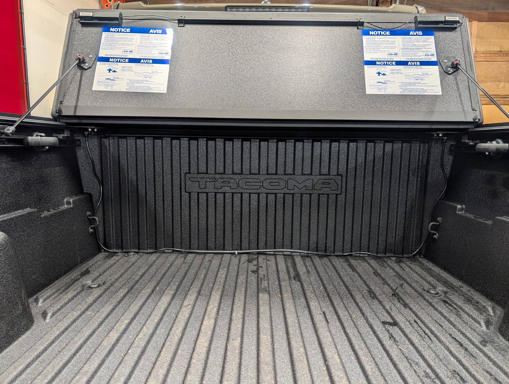

For anyone who has ever looked into the hard folding tonneau cover options...
I shopped aftermarket and OEM accessory versions, and read install manuals for both. I definitely did NOT want to drill holes in my new bed for drain hoses. Luckily the Toyota cover includes hoses that are supposed to fit in the 1/4" drain holes at the front of the bed. This is in stark contrast to aftermarket Bakflip and other brands with larger drain hoses.
My bed has the optional spray-in liner, which I like for traction and protection. It also makes the drain holes a little smaller. I could have used a tapered reamer to clean up/widen the holes a bit. But I also wanted to link both drain hoses into the center drain holes in order to leave the two outer holes free, in case more water gets into the bed.
2ft of 1/4" ID vacuum hose and a 1/4" nylon hose tee made this work. I previously had shorter sections of vacuum hose and didn't like how it looked, but finally got it situated last night:
I really like this Toyota accessory tonneau cover. It's not 100% watertight, but I'd say it's easily 95%. Last weekend I had the bed completely full of household stuff to donate, in cardboard boxes and a few paper bags. The 30min drive to Goodwill (with a stop along the way for a donut) was solid rain, and everything stayed dry enough.

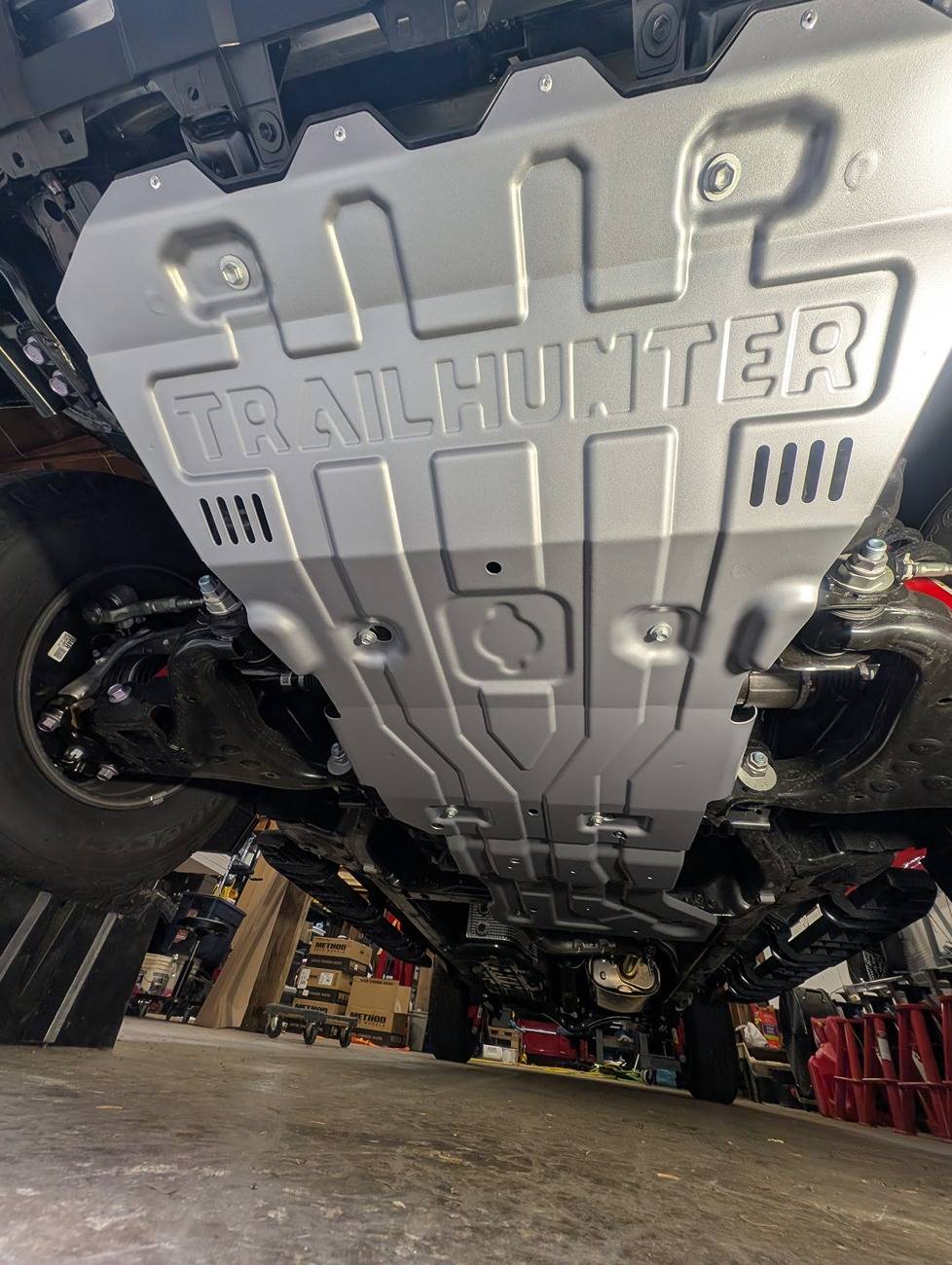

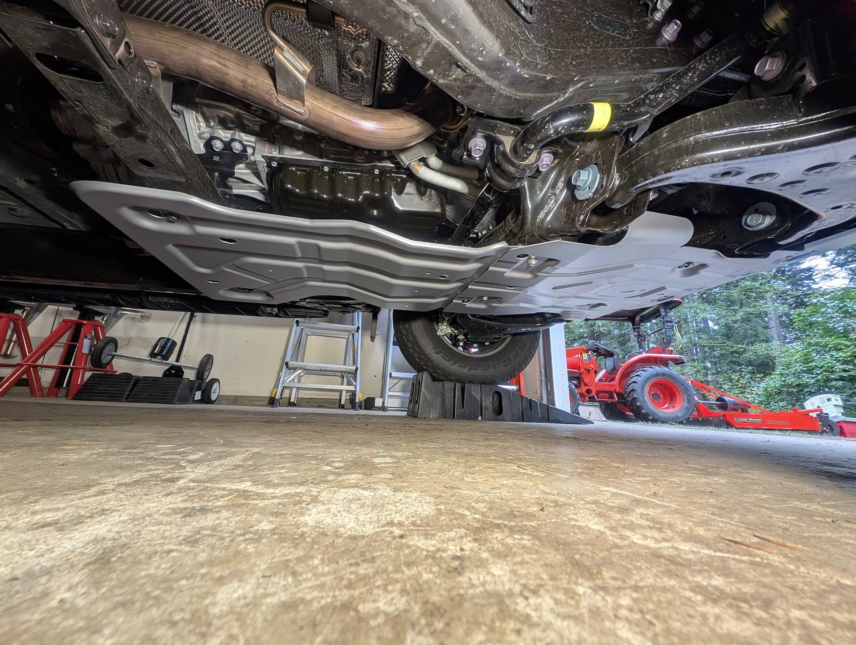

Ran across these pics from my install of the Trailhunter skid plates...
What came on my TRD:
Not bad, and probably adequate for 90% of truck owners. But we can do better...
That's more like it:
Install was super easy with just a pair of Rhino Ramps and one socket. 30min at most. I also used an M8 thread chaser bolt to clean up the mounting holes that hadn't been used before but that's probably not necessary.
These were a bit cheaper than the equivalent coverage aftermarket skid plates. My main motivation was to stick with OEM parts so the dealership techs know what they're looking at, and won't get confused. They know how to work with OEM stuff, and usually ONLY with OEM stuff.

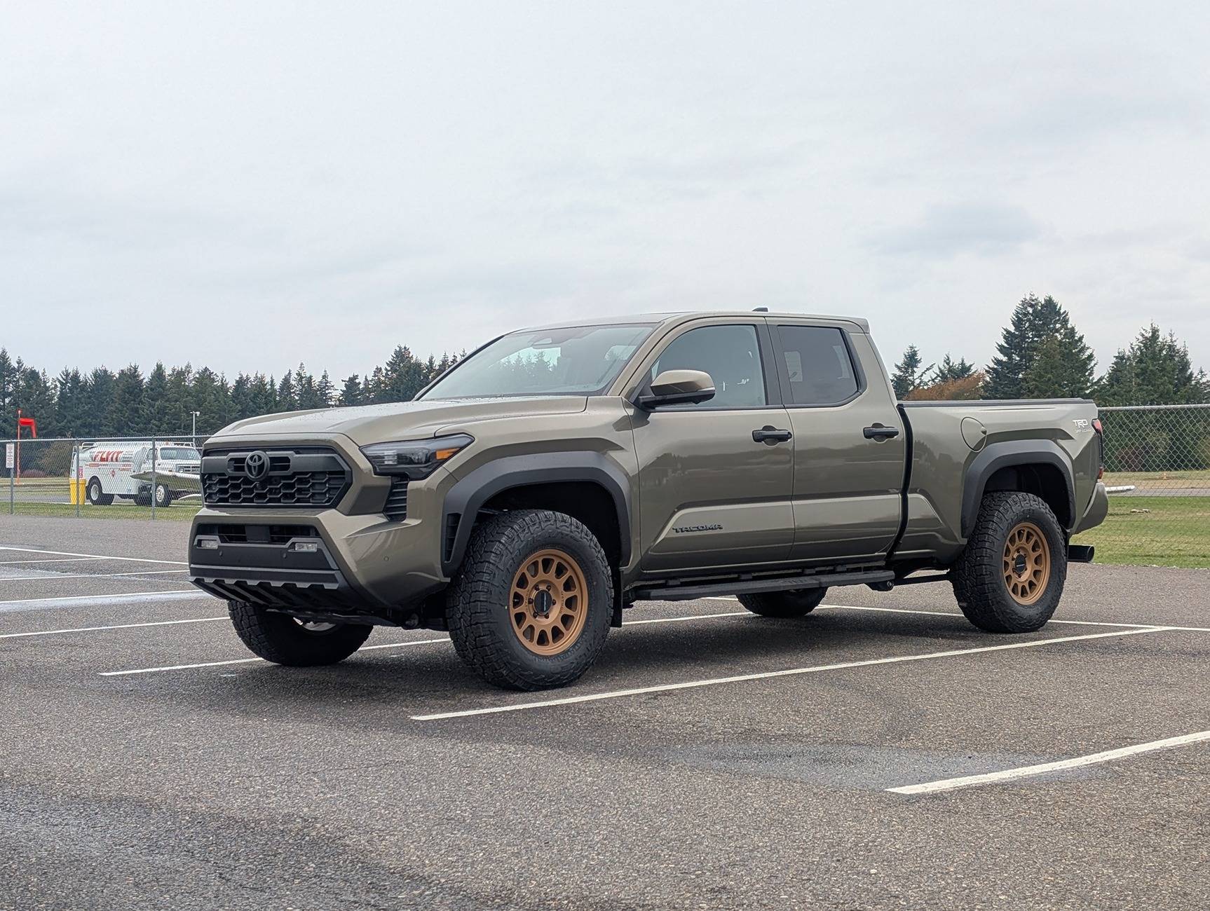

For a 32” tire that looks sick. Nicely done.
Thank you, I agree 100%. I'm super happy with how the tire and wheel combo worked out.
10mm wider on the tire and 20mm less wheel offset, resulting in 25mm more "poke" than stock, made a perfect change to the stance of the truck. And the ~12-13mm tire diameter increase was enough to notice, but not enough to completely throw off the truck.
Older pic from the fresh tire/wheel install, but pre-mudflaps:
I loved the Falken AT3W and the AT4W is just as good, if not better. It's a smooth, quiet tire for an LT C-rated All-Terrain. And so far, traction is excellent. They took a few hundred miles to break in, and have since been my new favorite tire.
My only other AT option in C-Rated LT275/70R17 was the Yokohama X-AT, which is supposed to be a good tire as well.
Toyo also makes their new RT Trail in that size, but it's an XL rated tire and the tread is more open/aggressive than I really wanted. I also have a negative opinion of Toyo tires in the PNW... they have a history of terrible traction in ice and snow. Maybe that's changed, maybe not.
