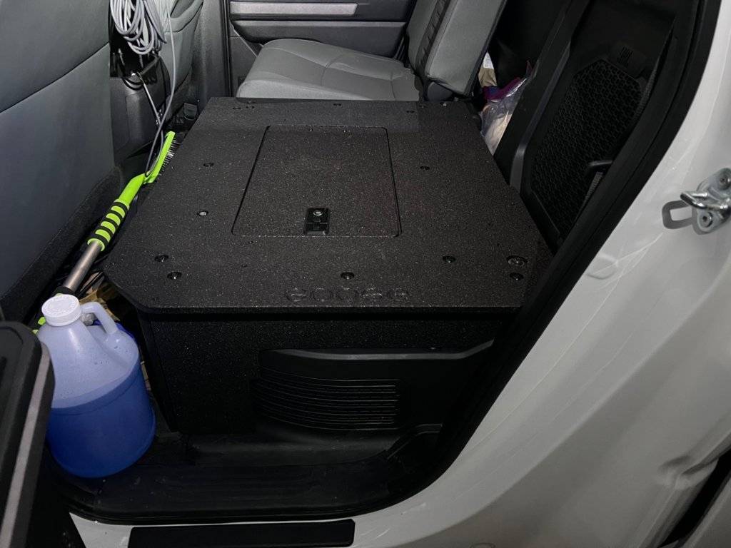

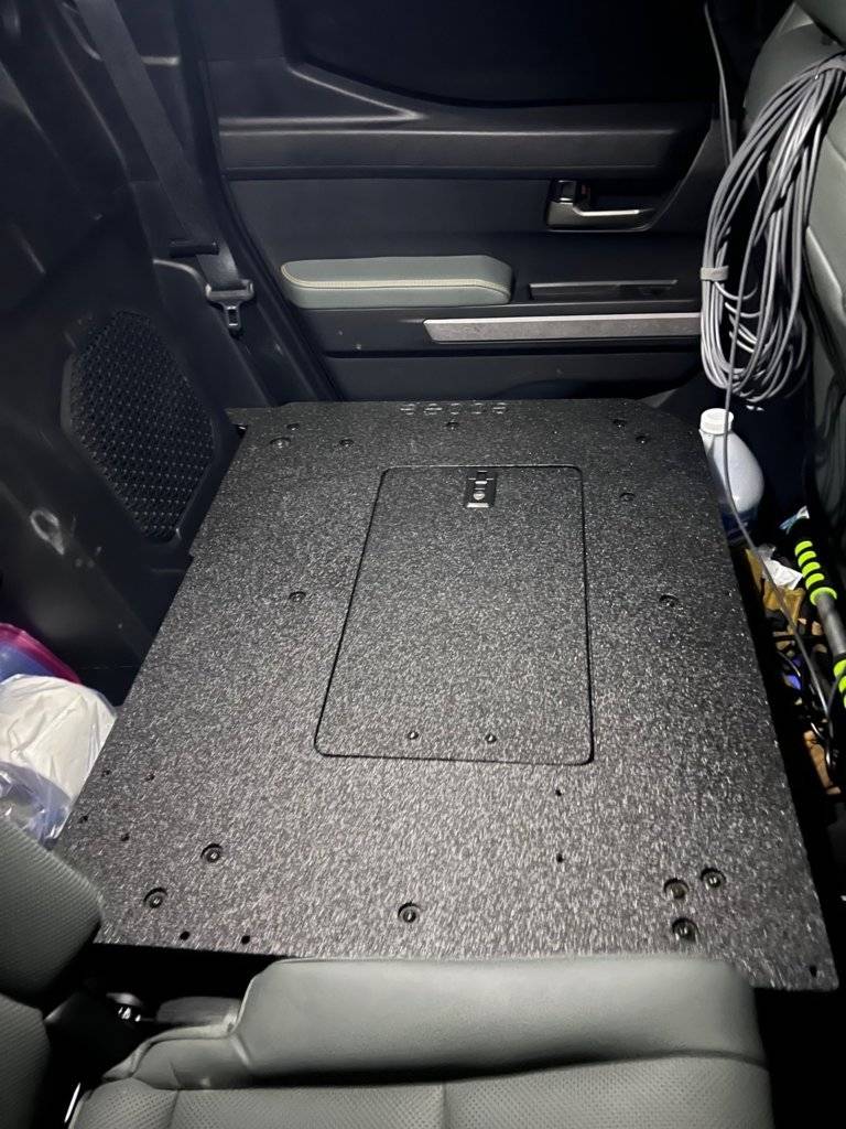

2024 Tacoma Goose Gear 60% Seat Delete - the good, the bad, the ugly. cabin-side-view-
View from the passenger side (40% seat remaining.)
2024 Tacoma Goose Gear 60% Seat Delete - the good, the bad, the ugly. door-side-view-
View from the door side.

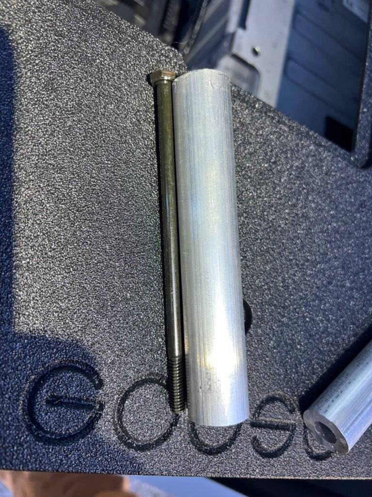

The 60% kit comes with three aluminum spacers- to raise the panel to the height above the center seatbelt brackets. One shorter one for the back, and two longer ones for the front. I don't know what happened to mine, but mine were exactly one inch too long. The bolt shown screws into the riv-nut when installed- obviously this spacer wasn't going to work. Once I got it all mocked up, I took the spacers to the chop saw and lopped an inch off them. Oddly, they seemed to be exactly one inch too long. In the same hardware vein, two oddly sized fender washers were supposed to be included, but instead I got 2 extra flat washers. The hardware is an odd combination of metric and non-metric. All of the hex pan head screws that hold the panels into the base channels are SAE, as well as the long bolts for the riv-nuts, but the large bolts that fit into the bracket in the back are metric. I have no idea why. None of their hardware attaches to Toyota threads, where you would expect metric, so you would expect either one or the other, not both.

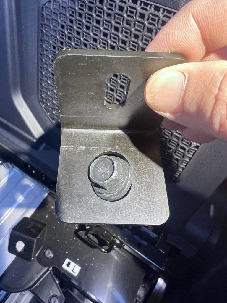

These are the brackets in the back against the rear wall. Those are the Toyota factory seat bolts. No idea why they made the hole so large that the bolt and washers just fall right through it. Ultimately, you have to position the bracket so it is clamped on the top and one side of the bracket, since the hole is so large. I suspect, like the aluminum spacers, these are made for a different vehicle.

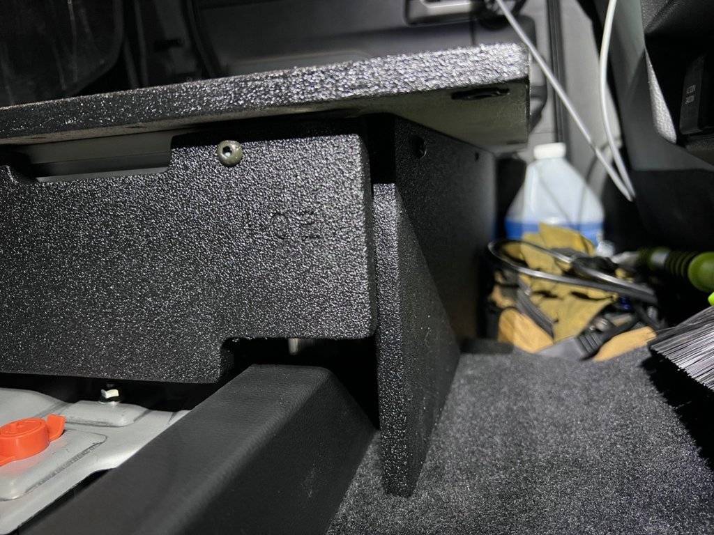

Another peculiarity- The front panel sits about 1/16th above the carpet on the center tunnel. The shape seems to be generally correct (once I cut the aluminum spacers to fit.) However this other side part (hidden by the 40% passenger seat) doesn't s eem to match. It sits about half an inch above the front lip created by the battery well. Not sure why it looks like this. Again, it seems like a design error- if you bother to notch the board, seems like it should probably fit a bit closer than that.

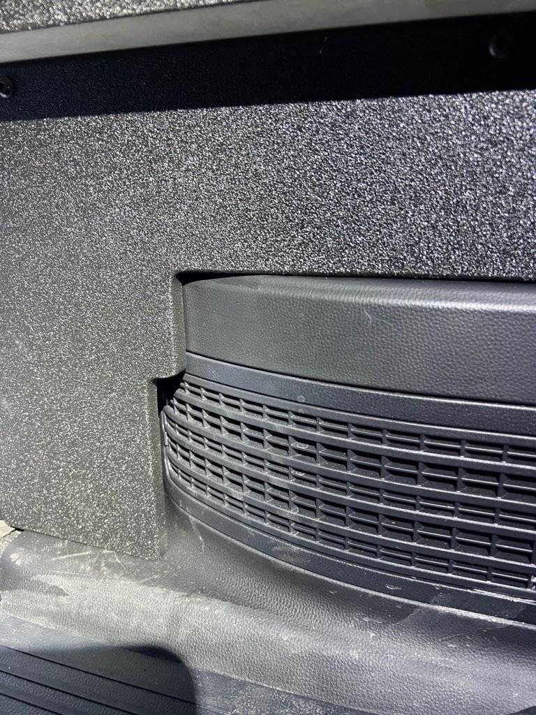

Another poor design aspect that was obviously built without a hybrid. These vents cool/vent the hybrid battery and associated electronics under the seat. The vent grill pops off and the filter is to be replaced periodically. Unfortunately, the access tab to remove the vent is hidden behind the panel now. To remove it, I will have to remove the entire seat replacement panel. Very irritating. I suspect if I had done both seats, it would be the same on the other side as well.

No update, as I suspect they won’t make changes. Just gonna have to live with having to remove the whole thing every time you have to change the inverter filter.

I never received feedback from goose gear, but I have since had to temporarily remove the assembly to install an under hood power relocation. Taking the panel in and out was less of a pain than I anticipated, but still not a great design, and more work than it should be to replace the hybrid filter assembly.

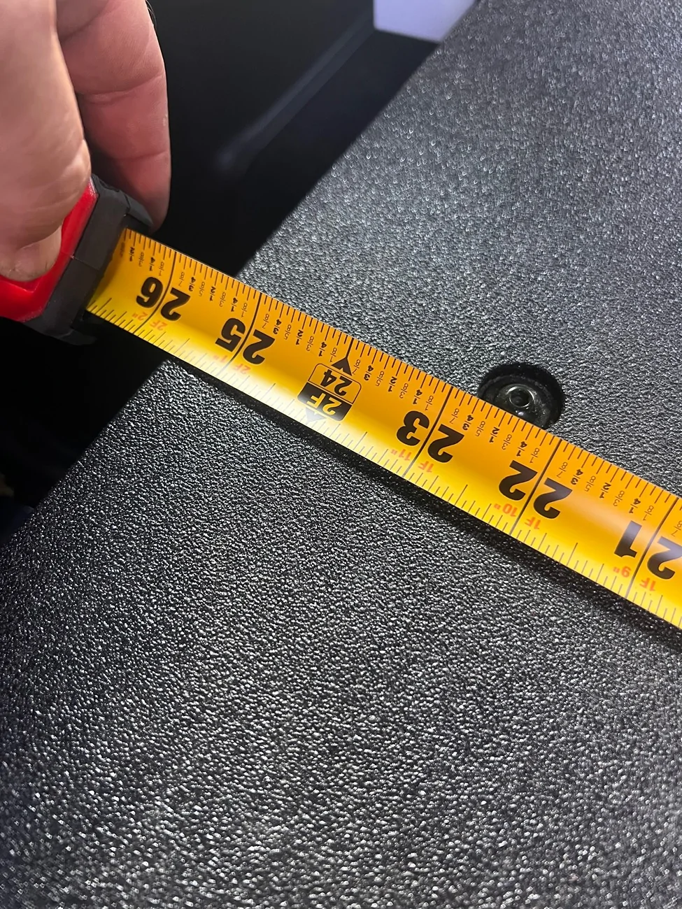

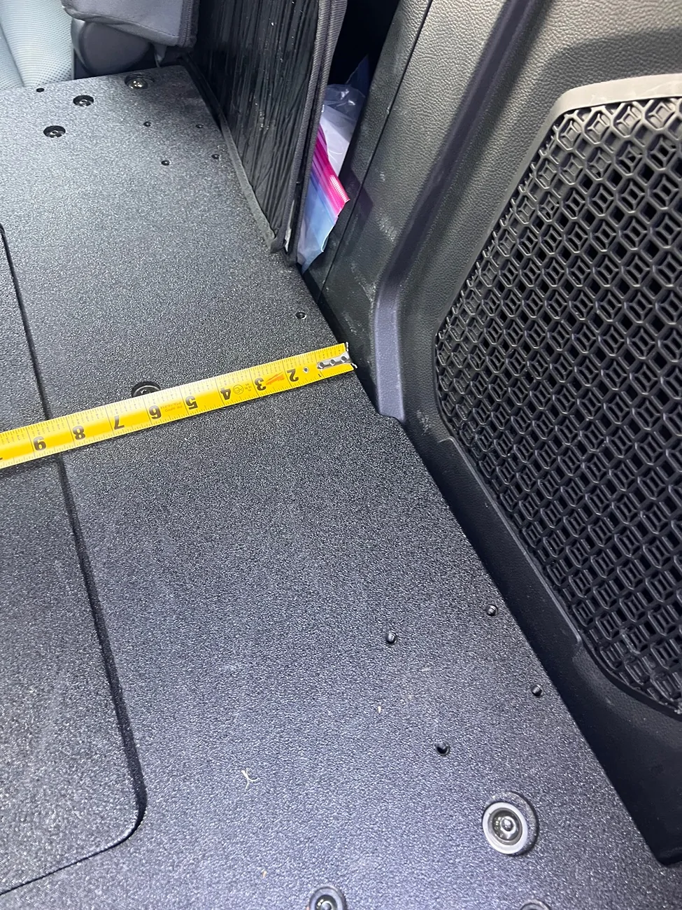

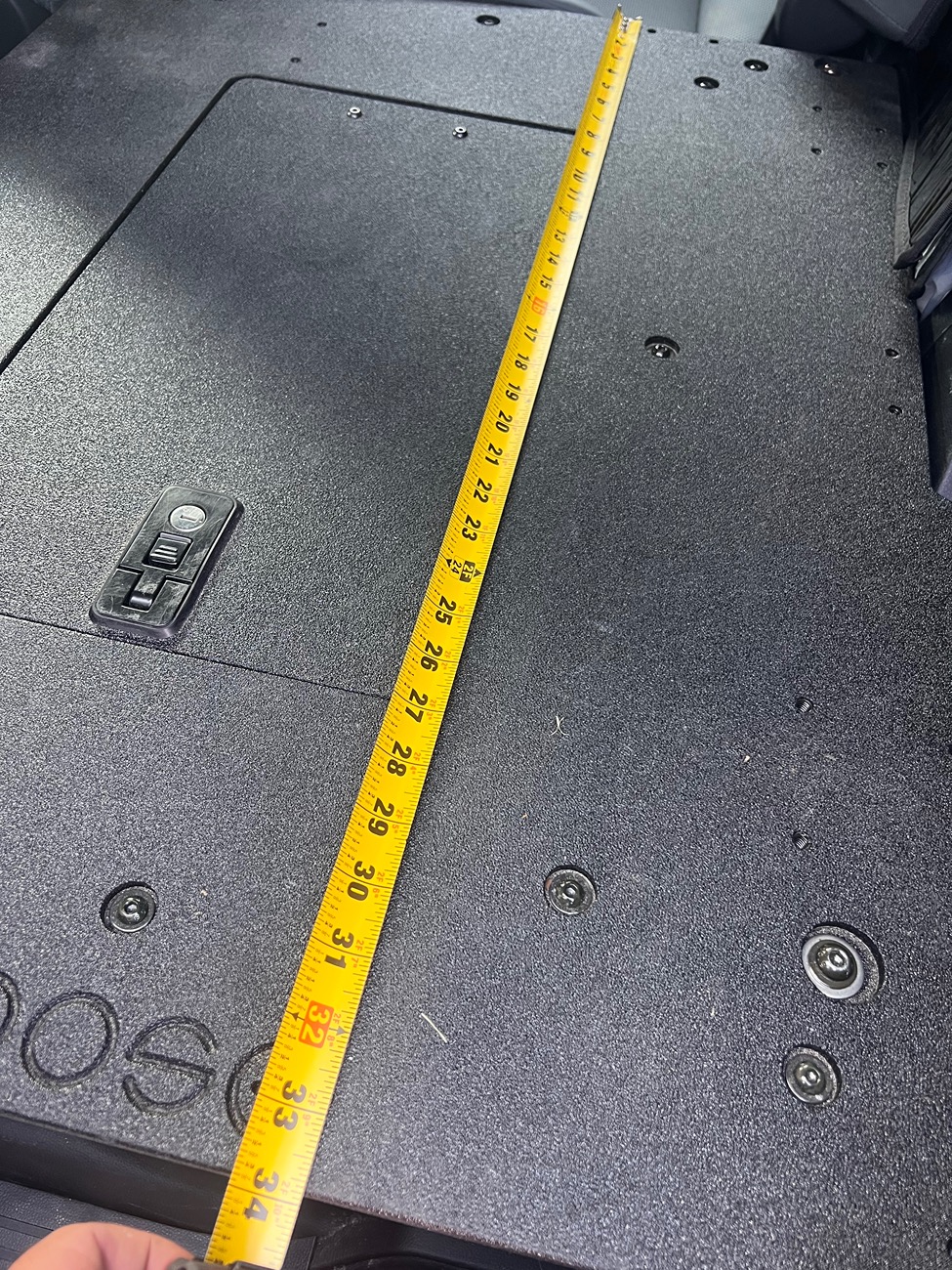

Does anyone have the top measurement of the platform for the goose gear? I wanted to maybe order the delete but I'm worried about the room since I have the dynamic seats (TRD Pro Model Tacoma). I was looking to see how close everything would be .....
here’s the dimensions on the 60%, the back is shaped to fit into the JBL box a little, so I show where I measured the back from, which I suspect is the dimension you’re worried about.
