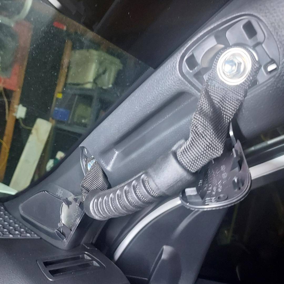

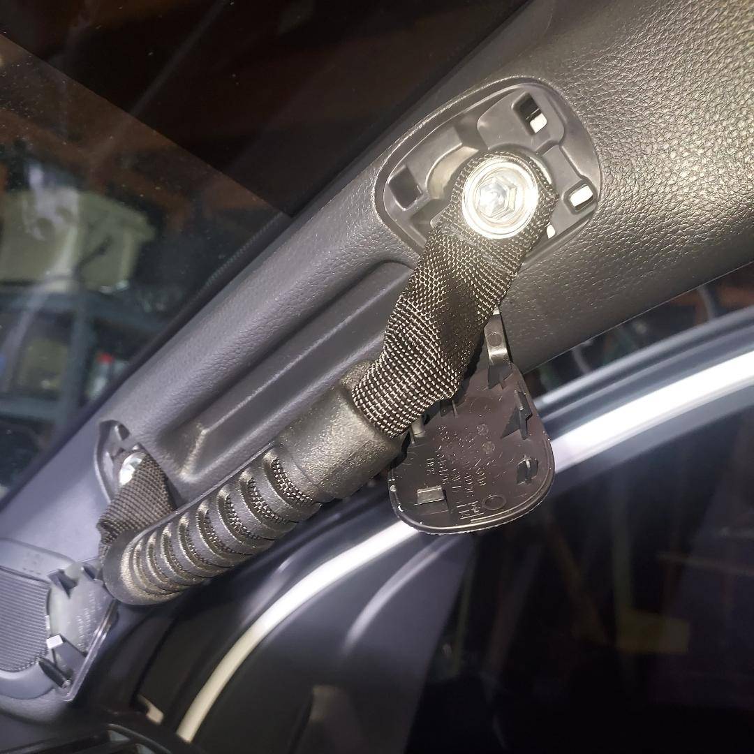

I took a chance and ordered these grab handles from Amazon. They come two to a pack.
They fit the passenger A pillar very well.
They are very sturdy and are a great solution over the OEM bump.
I still have to trim the covers to fit around the strap.

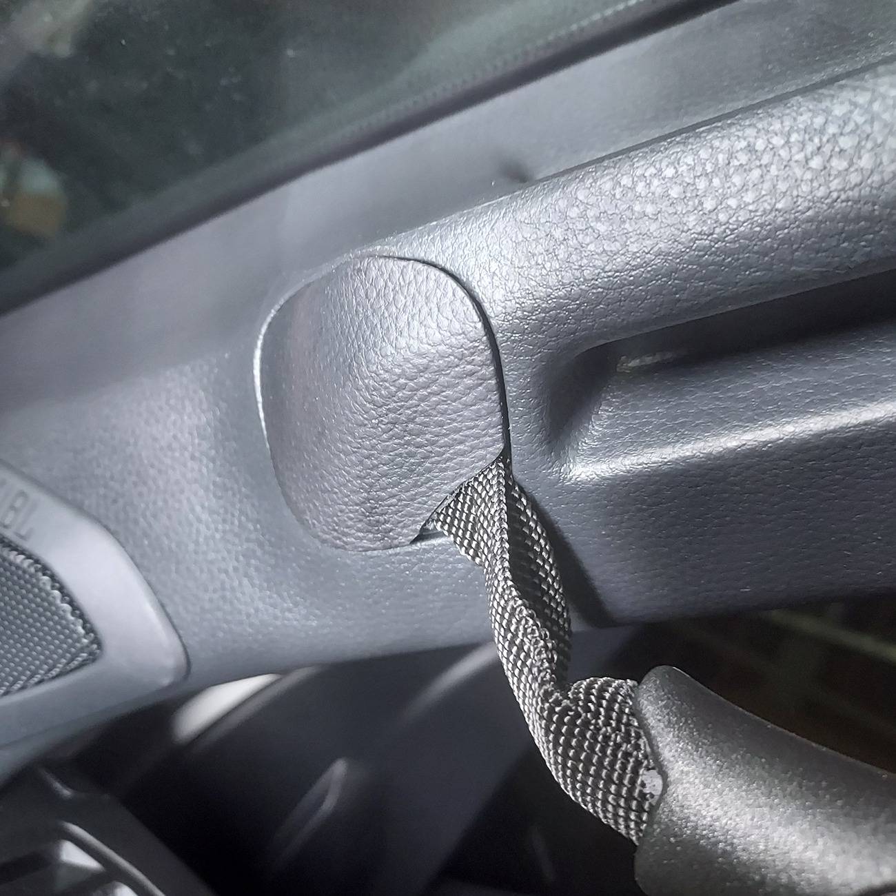

Got the bolt covers installed.
Top one I had to hot glue into place.
Top cover I had to remove one of the retaining clips to clear the strap.
Bottom cover was able to snap in.

I'd like to try this - did you find a way to remove the screw covers without breaking the plastic 'lead' that keeps them attached?

I trimmed the leads off.
So far, has been working really well.
