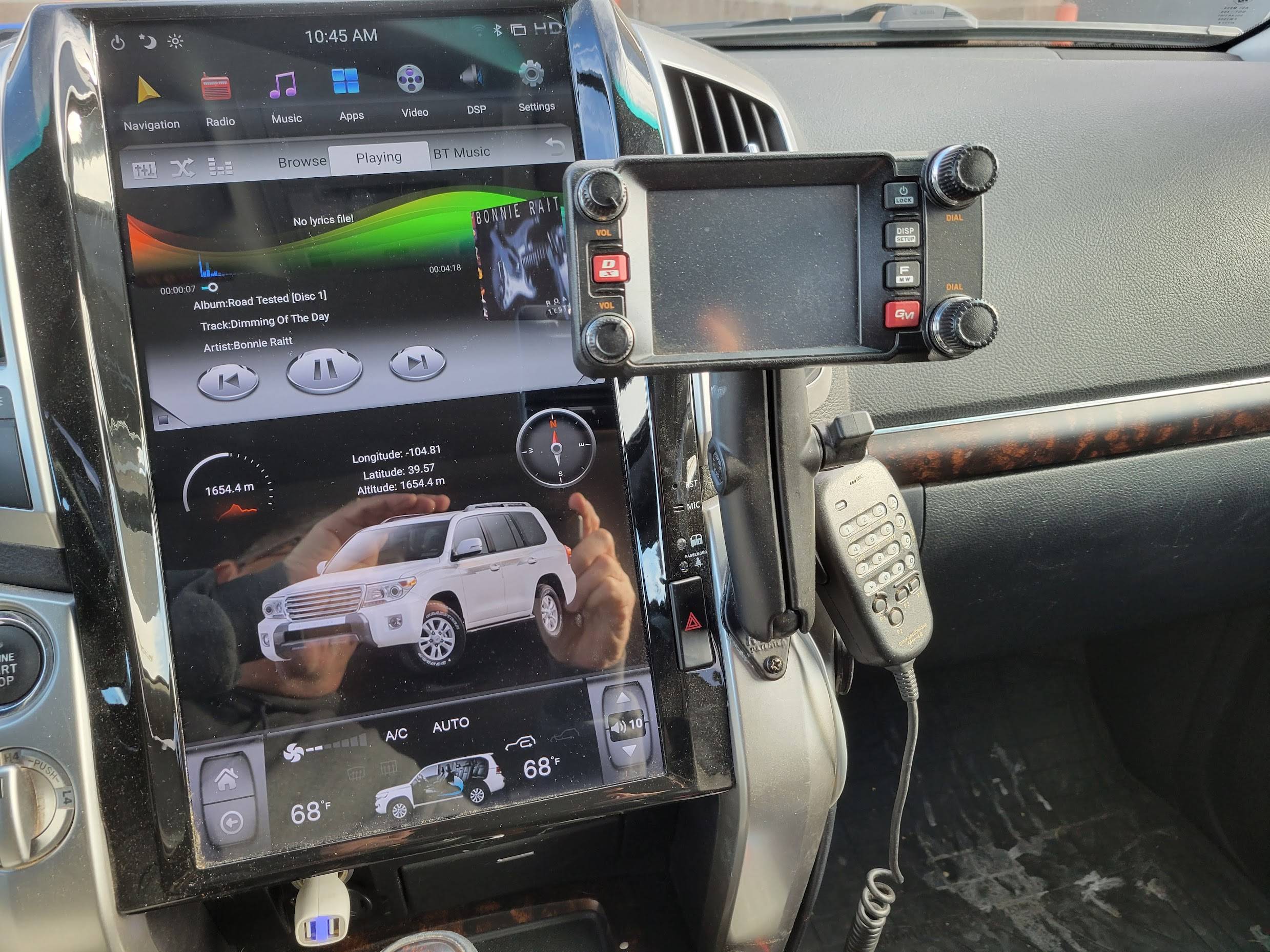

In my 200 series Land Cruiser I Have a Yaesu FTM- 400 and a Midland MXT-275 GMRS radio. Only the HAM is pictured. That is an aftermarket Android head unit which did a lot to update my technology.
2024 Tacoma HAM and GMRS Radio Installs in 4th gen Tacoma -- Post Your Setups 20220116_104555
Both hard installed. The HAM antenna is on the back tailgate and the GRMS antenna is on the front bumper. I also have handhelds, but they only work at a much shorter range

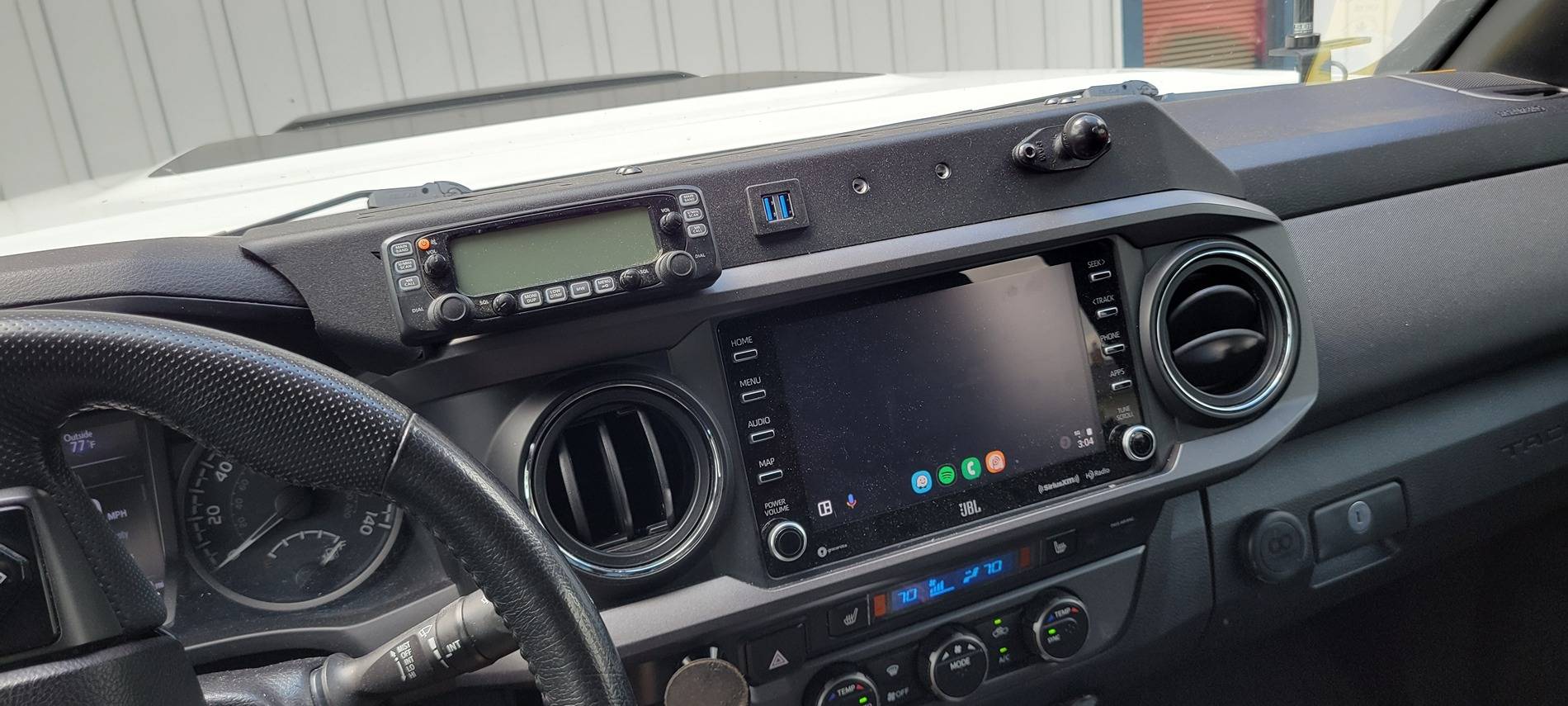

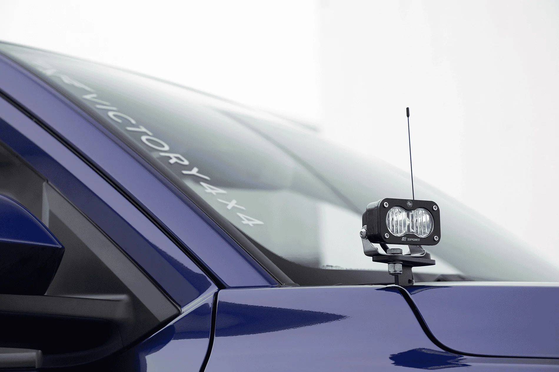

We haven't installed a radio in the 4g Taco, but we do make a mount that works with both ditch lights and antennas (1/2" hole.) I actually switched to this mount setup in my 3G Taco as well.

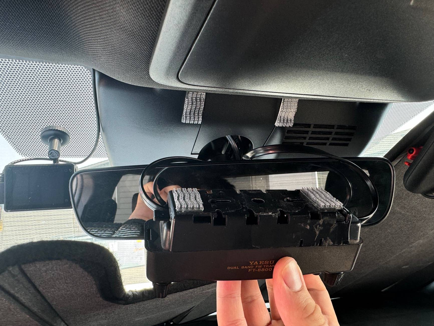

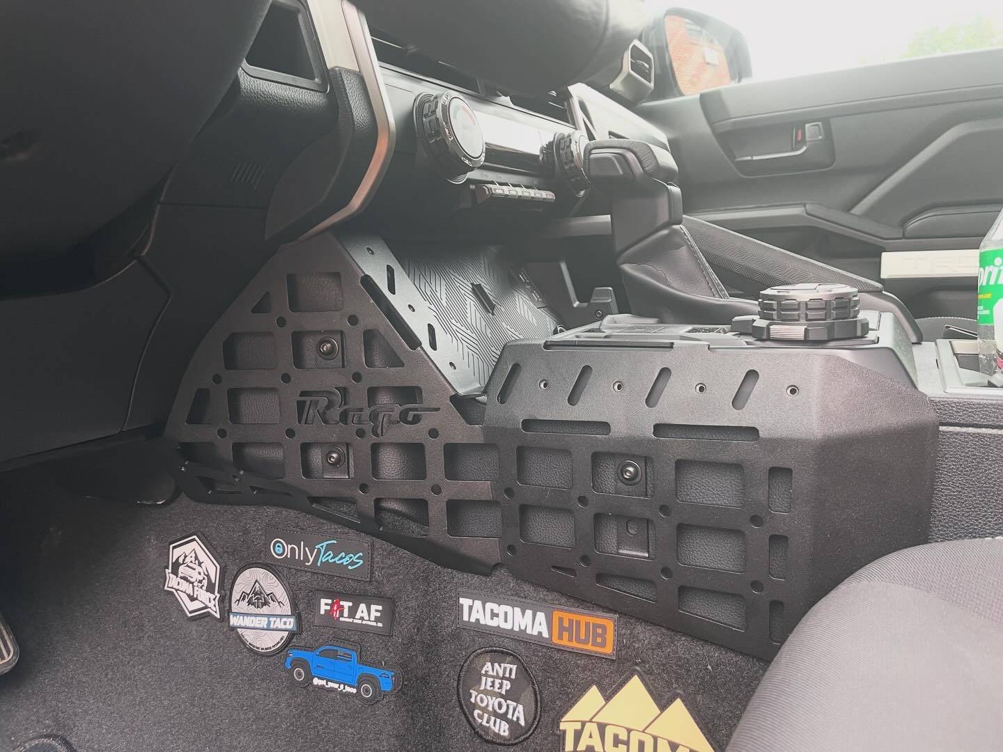

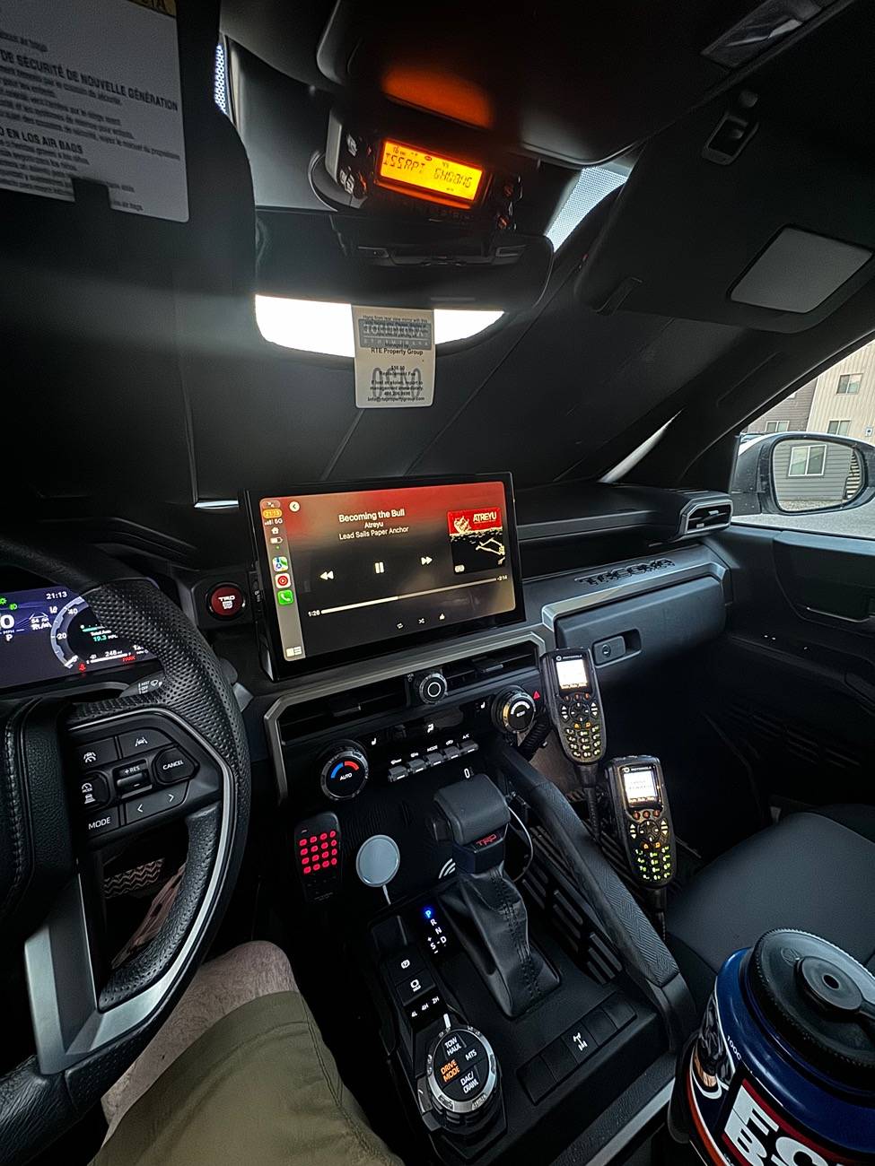

I have a Yaesu FT-8800 mounted with clicky Velcro above the rear view mirror and the microphone is mounted to a Molle panel from Rago. I also have two Motorola XTL5000s mounted to the passenger side molle panel with 67 designs mounts. All the radio bodies are under the back seat.
My antennas are mounted to a Prinsu roof rack.

Thanks. Any thoughts on if a HAM antenna like 3-4 feet long would hit the pillar when the hood is opened?
It should not be an issue at all, but I will verify for you tomorrow. They are currently shooting a front bumper install video on our 4G.

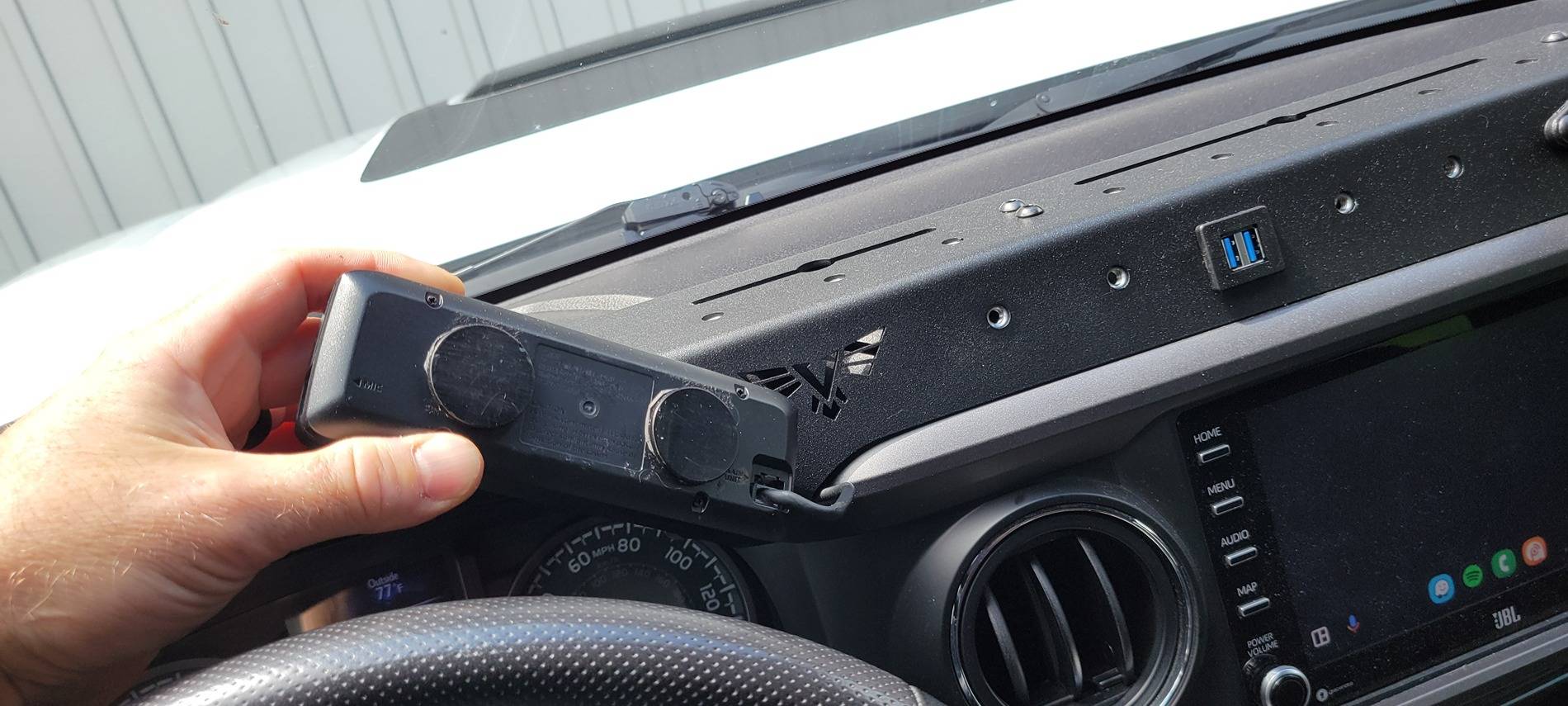

On my 3G I have my faceplate on my dash mount with magnets. Works awesome. Our dash mount for the 4G is behind the screen though, so I will have to figure something out for that.

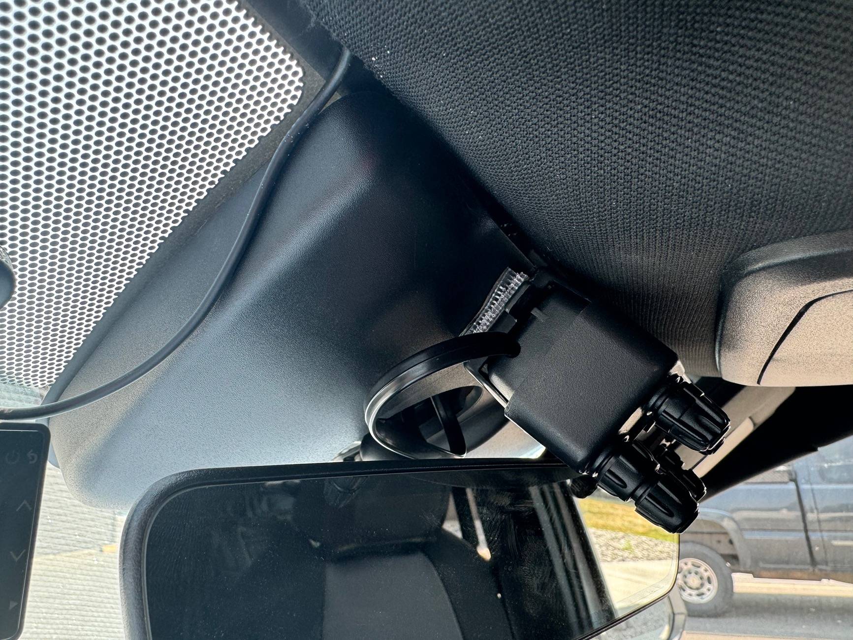

I tried using ram mounts to the rear view mirror arm and could not get it the way I wanted it. Always blocked the sunglasses compartment. I decided to just use some clicks Velcro on the control head and the trim piece around the mirror. Wire running was super easy. It works ok since those trim pieces are not very rigid.

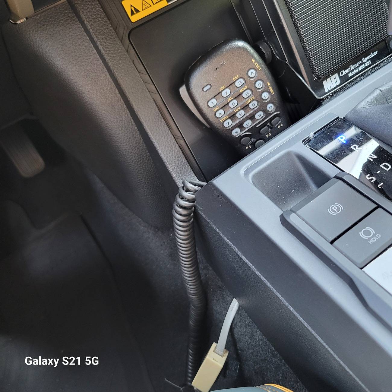

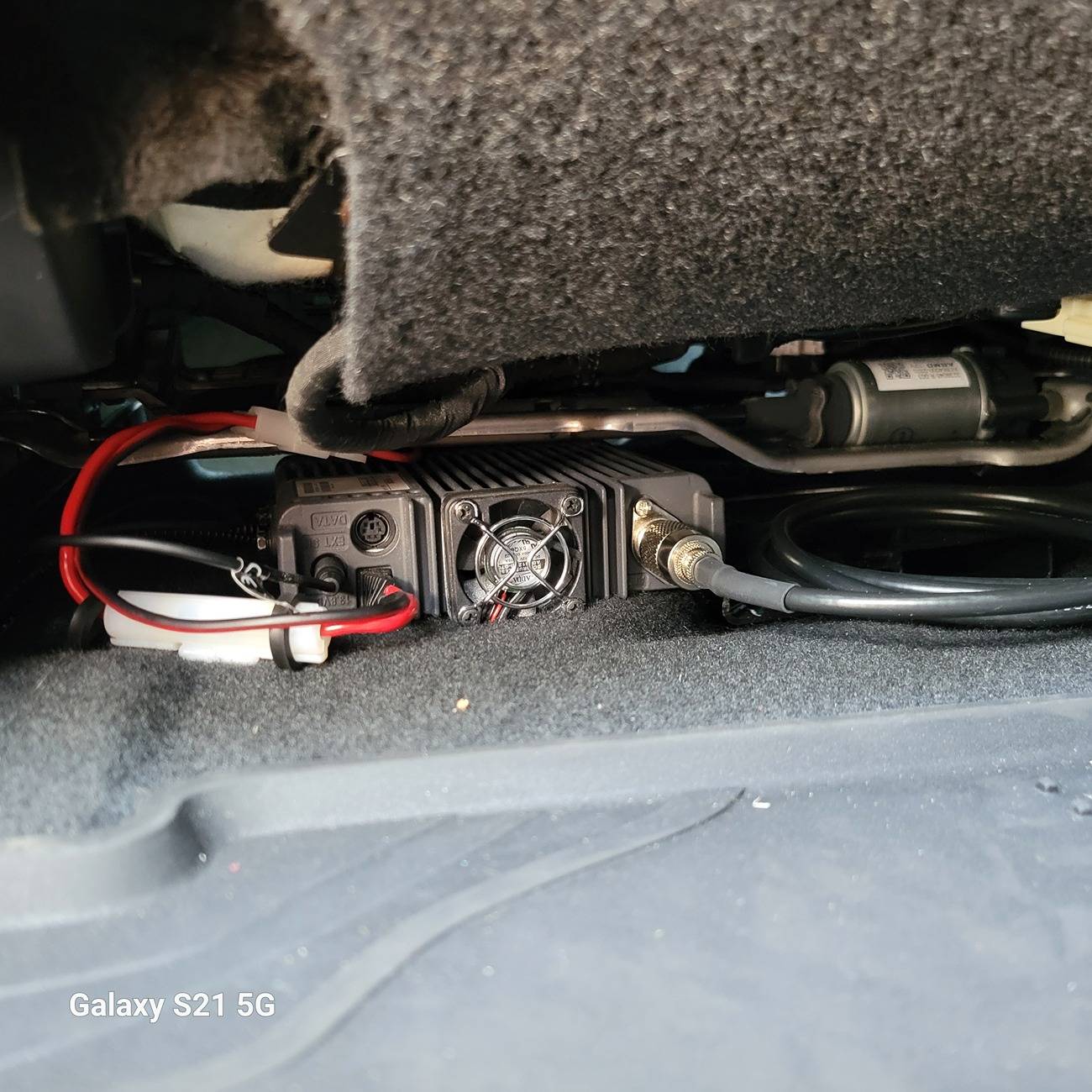

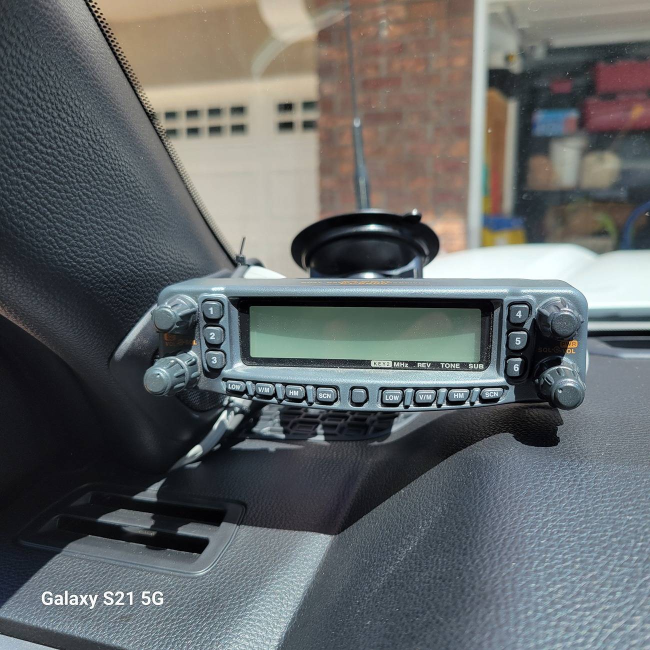

My Yaesu FT-8800 mounted in my Tacoma Trailhunter. I scavenged my mounts from my old Prius. The same Yaesu in my old Landcruiser was built into the dash and just left it for the new owner. It uses a Ram suction cup mount for the head unit. The body of the radio barely fit under the driver seat. The antenna uses an old Diamond 400 hatch mount that attaches to the lip of the hood. I tried a Caliraised ditch light mount, but it was so stealth that the PL-259 antenna off the Diamond mount was just too deep and hit the hood lip. Speaker just sits in the center console. Not great, but I still have access to the phone charger and usb/12v port to the right. I haven't figured out a good mount for the mic and don't particularly want to be drilling holes for the mic clip. Looking for ideas there.
