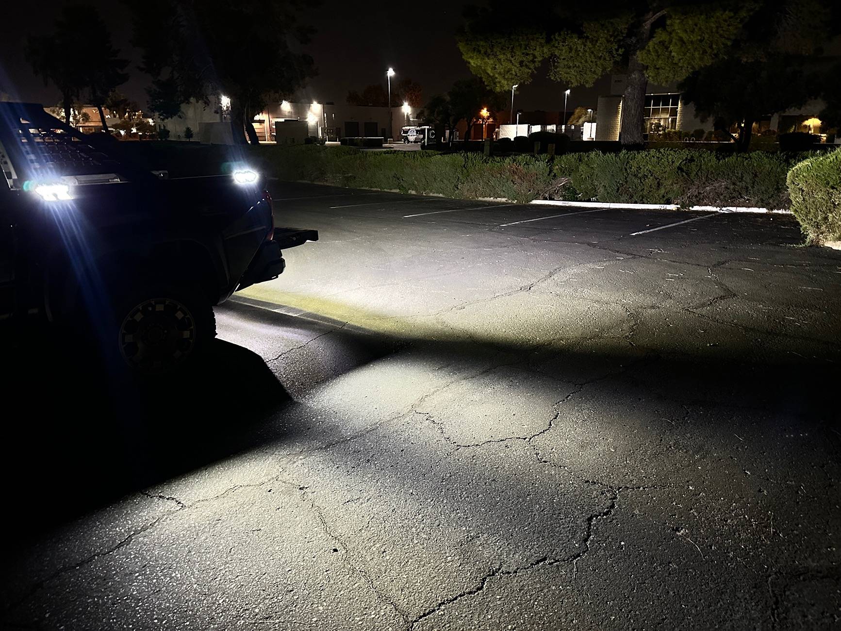

A couple more just because I was already taking photos (Ditch lights are manually fired off of AUX 2 now): :sunglasses:
2024 Tacoma HOW TO: Rigid SR-L Series Lights for ARB Rear Bumper Installation IMG_0176 2.JPG
2024 Tacoma HOW TO: Rigid SR-L Series Lights for ARB Rear Bumper Installation IMG_0175 2.JPG

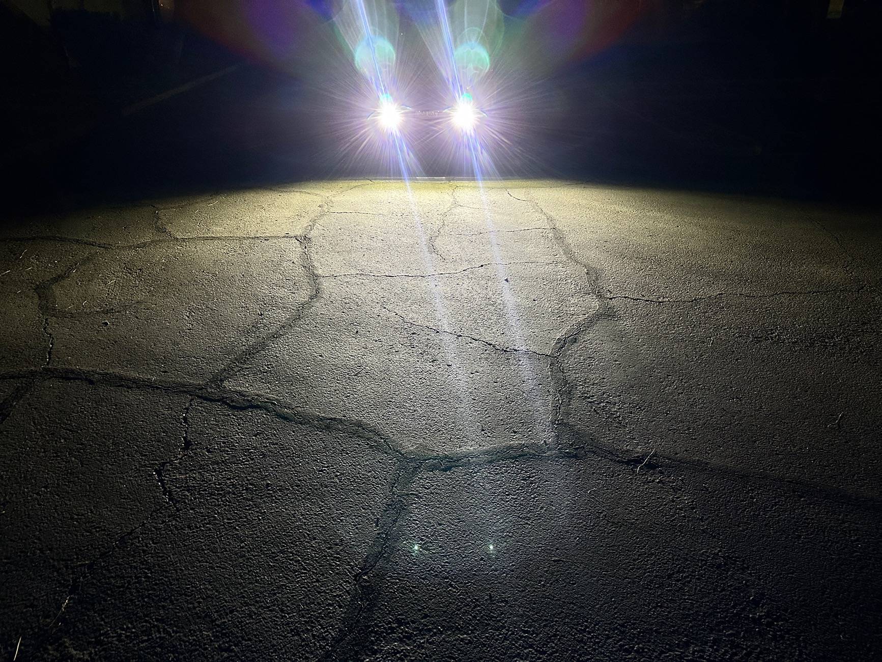

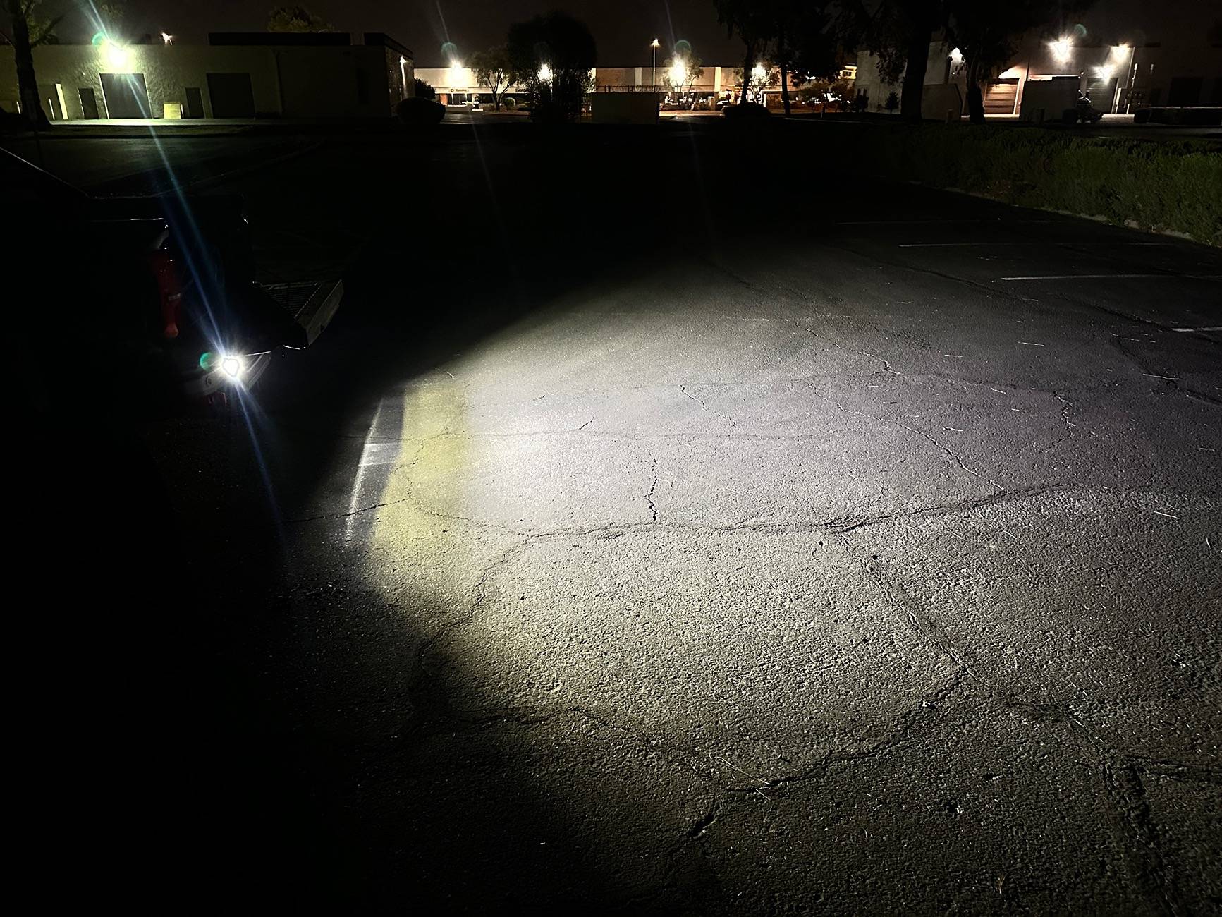

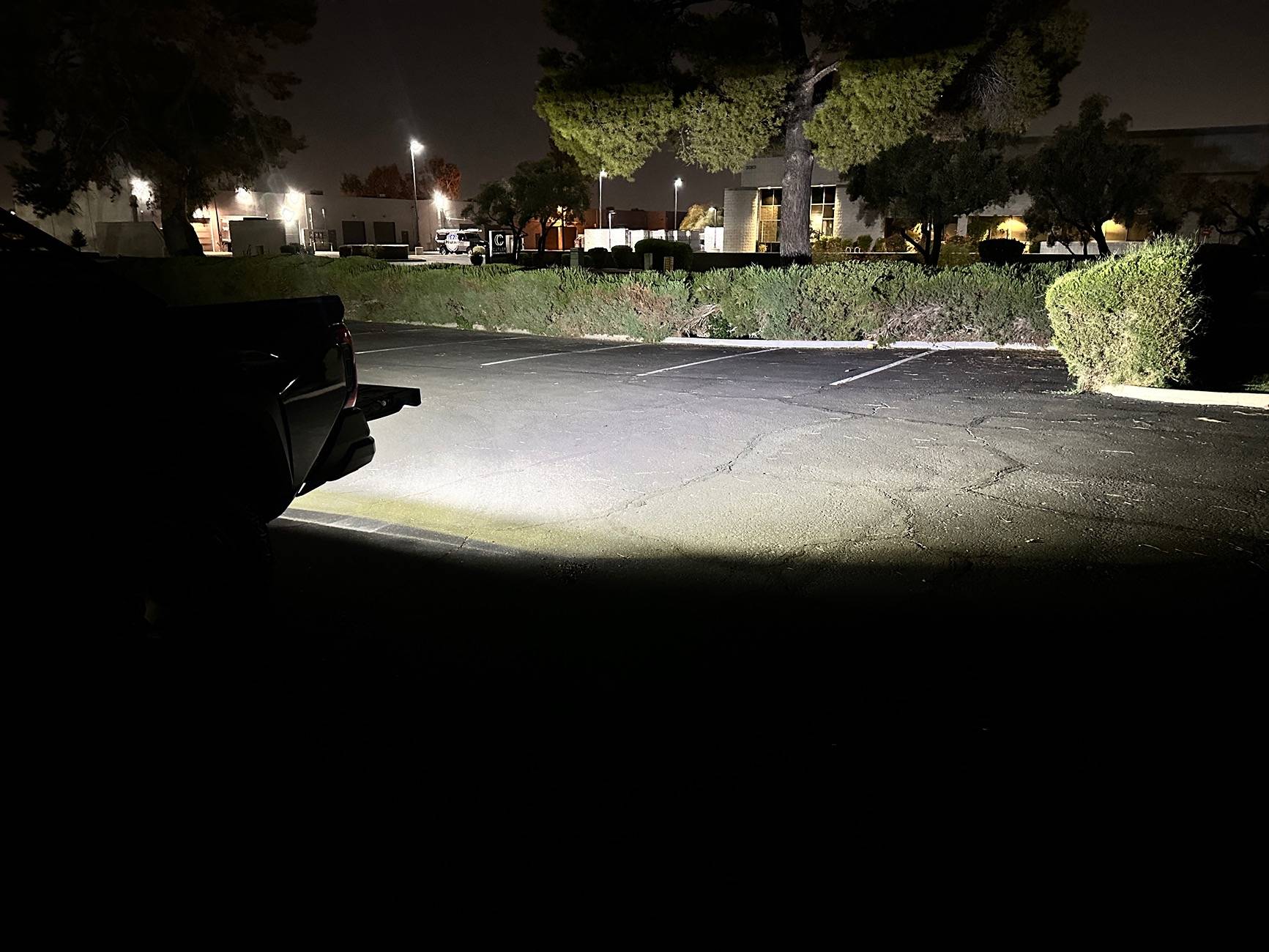

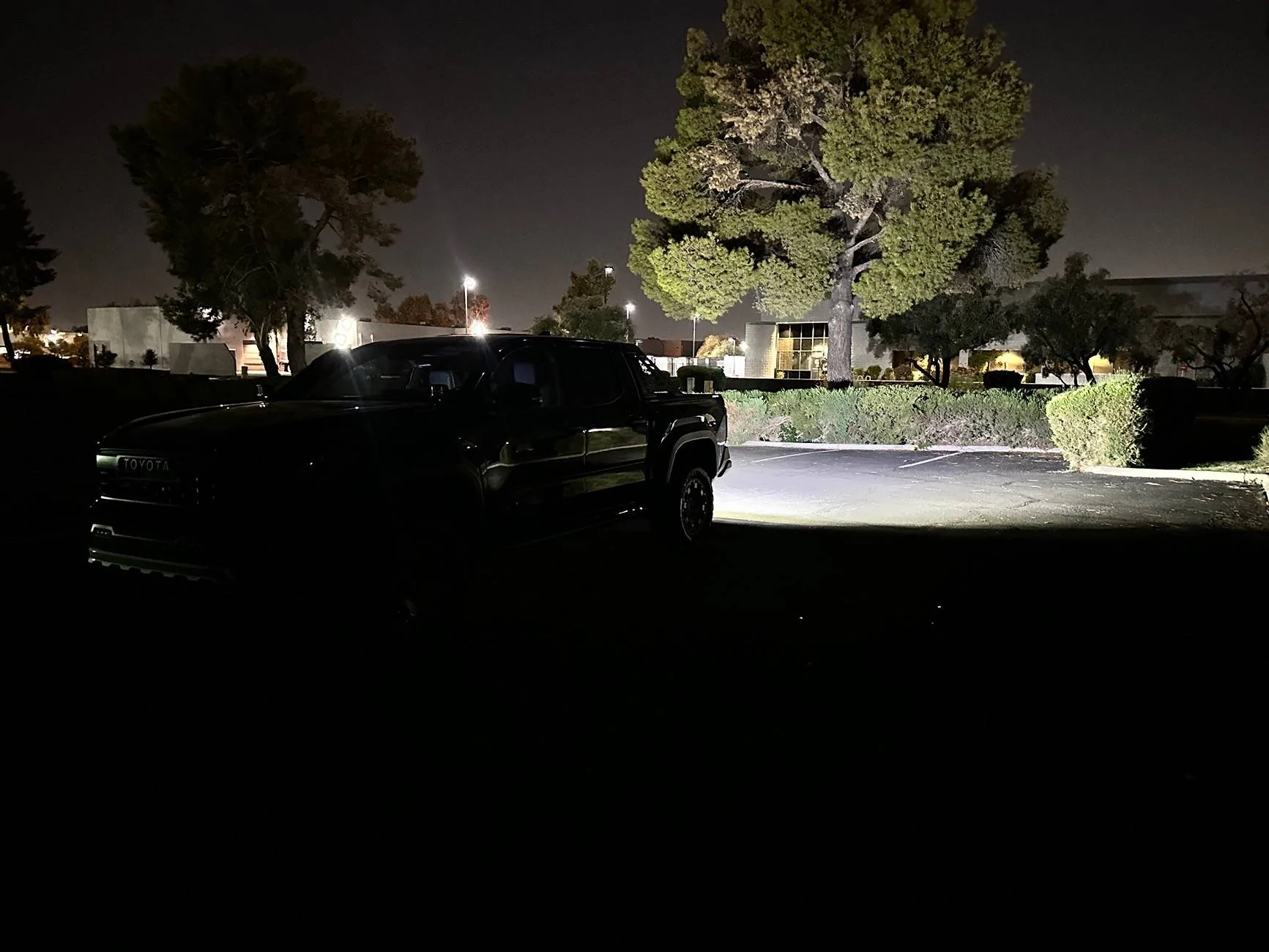

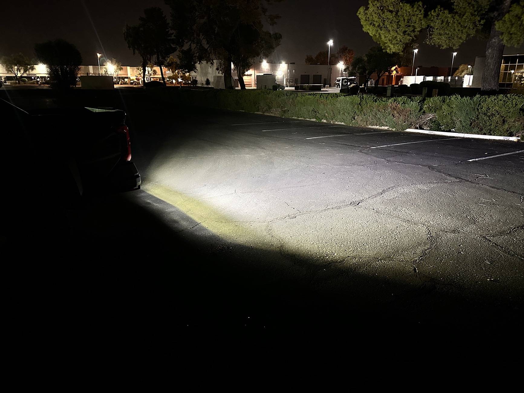

was able to snag a few photos tonight in the darkest spot I could find on my way home:
tailgate up (all other lights off):
2024 Tacoma HOW TO: Rigid SR-L Series Lights for ARB Rear Bumper Installation IMG_0193
Tailgate up (all other lights off):
2024 Tacoma HOW TO: Rigid SR-L Series Lights for ARB Rear Bumper Installation IMG_0194
Tailgate down (all other lights off):
2024 Tacoma HOW TO: Rigid SR-L Series Lights for ARB Rear Bumper Installation IMG_0196
Tailgate down (bed scene on):
2024 Tacoma HOW TO: Rigid SR-L Series Lights for ARB Rear Bumper Installation IMG_0195
2024 Tacoma HOW TO: Rigid SR-L Series Lights for ARB Rear Bumper Installation IMG_0197
Tailgate down - directly looking at back of truck (all other lights off):
2024 Tacoma HOW TO: Rigid SR-L Series Lights for ARB Rear Bumper Installation IMG_0198

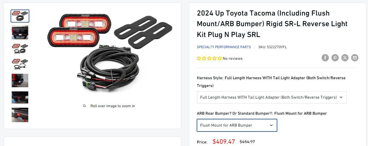

Would this one kit from SPV cover everything, or would I need to call and request the specific parts you mention?
2024 Tacoma HOW TO: Rigid SR-L Series Lights for ARB Rear Bumper Installation 1728575040864-pl
wolfpackwest
wolfpackwest
Paul
Sep 4, 2024
64
100
Arizona
2024 Tacoma Trailhunter
you don’t need the full length harness with switch; just the short harness, but you also need an additional Y-Splitter and single pole connector. I’d just call and ask for John, and ask him to get your order setup with the same exact parts ‘Paul’ ordered.
SPV Parts
Sep 12, 2024
61
Greenwood IN
F-150 Raptor, Ranger Raptor
Since that's going to be a popular option Paul. I think we may just make up a single harness plug in basically that is the Toyota Pig tail in the back, and the Y splitter all in ONE piece.
Can you tell me how long that Toyota Pig tail is? And if you had to add wire to it (if it was long enough or not?) and it looks like they have 2 wires coming out of it. (I assume for power and ground if needed) So which wire/side is coming out of the Toyota Pig tail for the power?
Then I can just have those simple one piece sets pre made. Eliminates the crimping to the Toyota Pig tail.
ejhenry001
Eric
Mar 5, 2024
2024 Toyota Tacoma TRD PRO
That would be awesome John - even the smallest crimping job seems to go haywire for me on occasion! PLease advise when you have this available and I will order the entire kit! Thank you!
