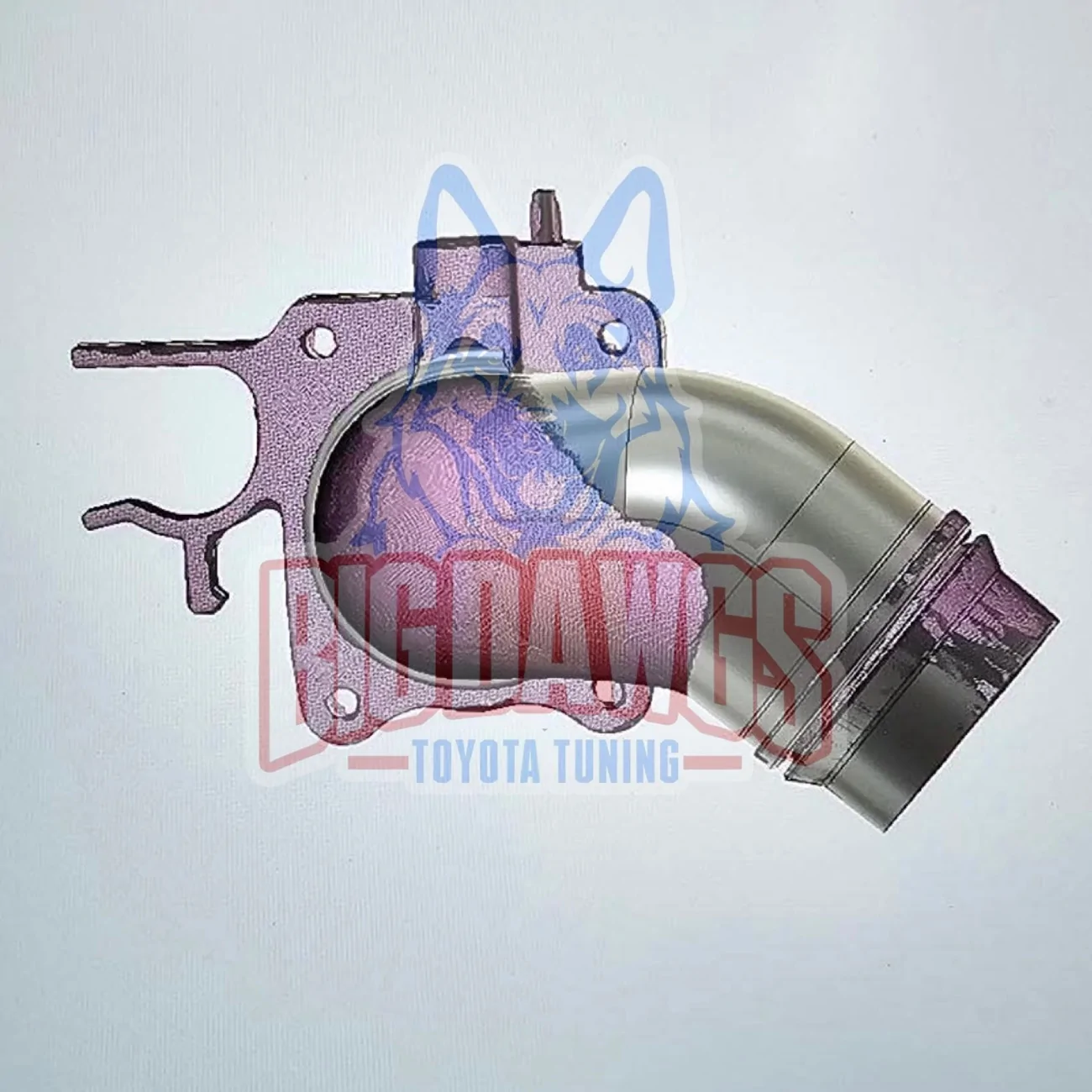

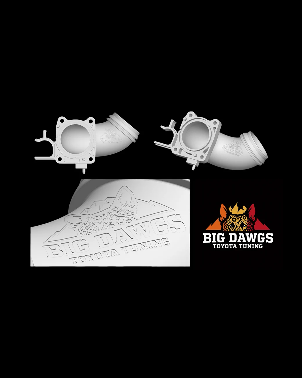

Here at Big Dawgs Toyota Tuning we’ve been working on something big that’s almost finished up in production and will be headed to the dyno shortly after that.
Pictured below is an aftermarket throttle body elbow designed by us here at Big Dawgs Toyota Tuning. We’ve increased the diameter on each end by a fair amount, and will have it produced in aluminum.
More to follow on exact specs when we get it in hand. We do know it’s guaranteed fitment based off of singular test piece we had printed.

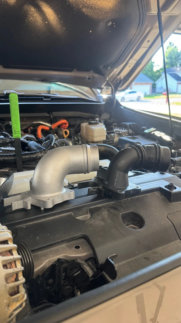

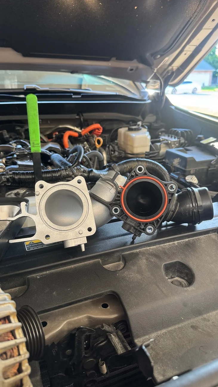

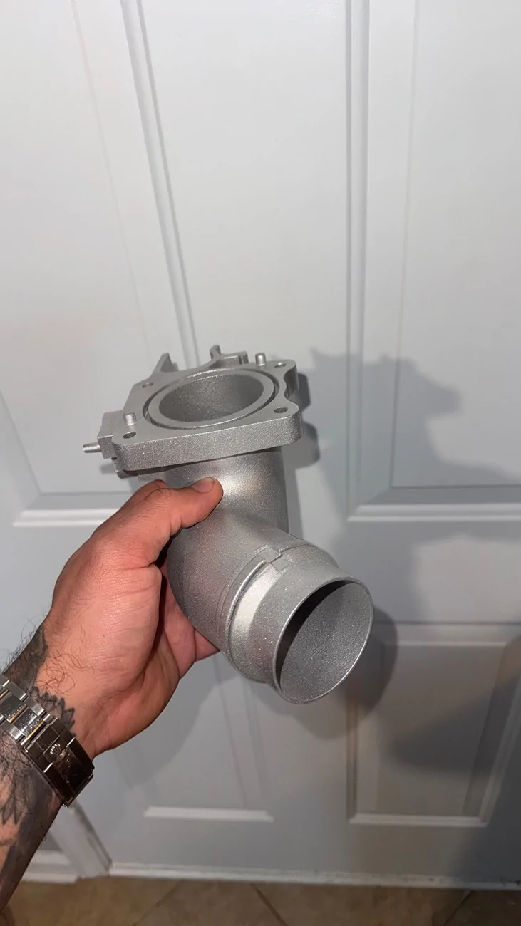

Quick update here: we got our initial test run pieces in. They were a fail. The O ring divot wasn’t big enough & there was no divot for the O ring tail. Also came unmatched. We’re going to rework the CAD on sizing, then look at a new supplier for the time being. We’ll probably look at moving to have them cast instead of printed.

Just for a quick update on this - we got a few revisions done. Going to finalize some slight tweaks, then we'll have a tester printed. Once we verify it fits, we will move on to work on production.
