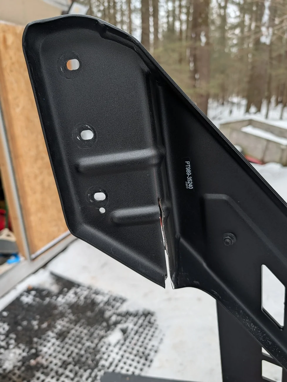

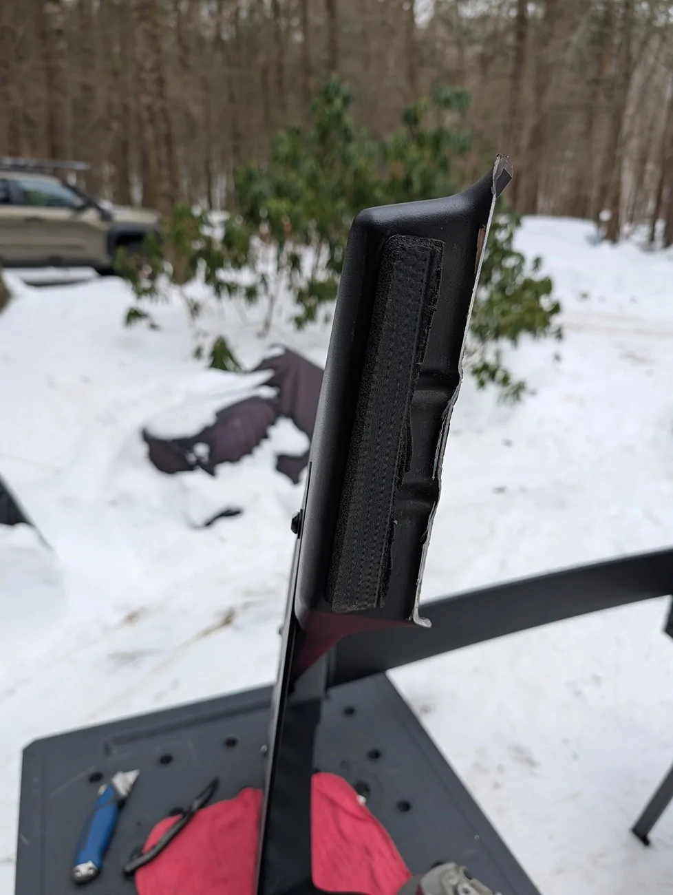

Make sure you have the bar in a comfortable place and secure from wiggling around. It's 1/8" steel, it's a lot to cut. The flip out Dewalt tables might be my favorite shop thing. I can drop dog clamps in from my router table to hold anything, and they are rock solid. First things first, peel the old weather stripping off the bottom cleanly, you won't need it anymore. You need to cut it to leave as much meat on them as possible, because the mounting holes are going to be very close to the edge. So cut on a 45 or so into the bend, and use the shaper to flatten it and take out any sharps.
Once you've got it flat and shaped, now we need to add the mounting holes. I wish I could have fit more, it had a lot before, but at this point, it's for looks. Now you need to measure the t-rail spacing. Be exact. Hook the tape on the inside edge on the far slot, and measure on the inside edge of the close slot, where it is going to mount. Write that down. Now, pick the ideal locations for mounting holes on the bar feet that have the most meat. Use the tape, and hold it across to rough in the spots using that measurement, it may not be obvious.

Use your combination square and mark it from the bottom first. Set the distance you want, and make a line across L-R, and make it the same on the other side. Do the same for the top feet.
Next, measure the outsides of the bar feet where those lines are. Take that number, minus the track distance, divide by 2, and now you have the distance from the outside of the feet on the line where the holes need to be. Use your combination square to set that distance, put it against the outside where you measured on the line, and mark your holes. Center punch them, and use the center drill to drill your pilot holes. Then use the 21/64 drill to go the next size up from 8mm. Deburr them.
At this point, it's good to have a friend help you dry fit it, making sure you don't drop it or scratch anything, it's awkward, unless you've got a good ape factor.

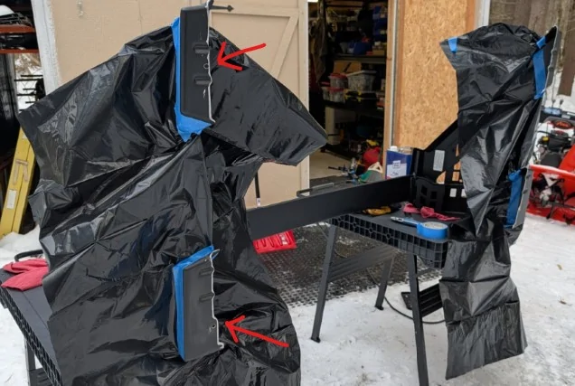

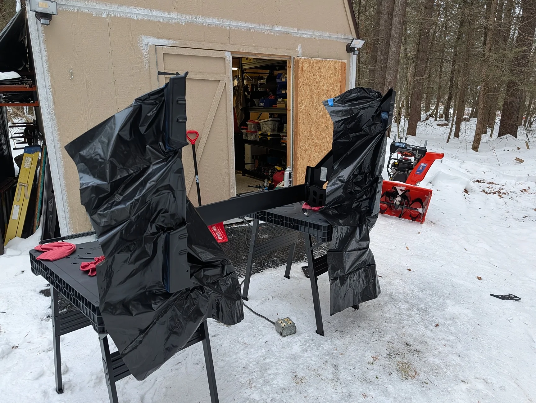

If it's all good, time to prep for paint. Mask it all up, trying to limit the spray to the bottoms where you won't see it. The spray on bed liner is nearly an exact match to the oem paint texture, with one caveat. DO NOT OVER SPRAY. I learned the hard way on one. It's not bad, it just gets shiny and looses that matte finish. Do 3-4 light coats instead. It'll dry to the touch in just a few minutes, so doesn't take long to do the next coat. Let it cure for a day or two. Then remove maskings and get ready to install.

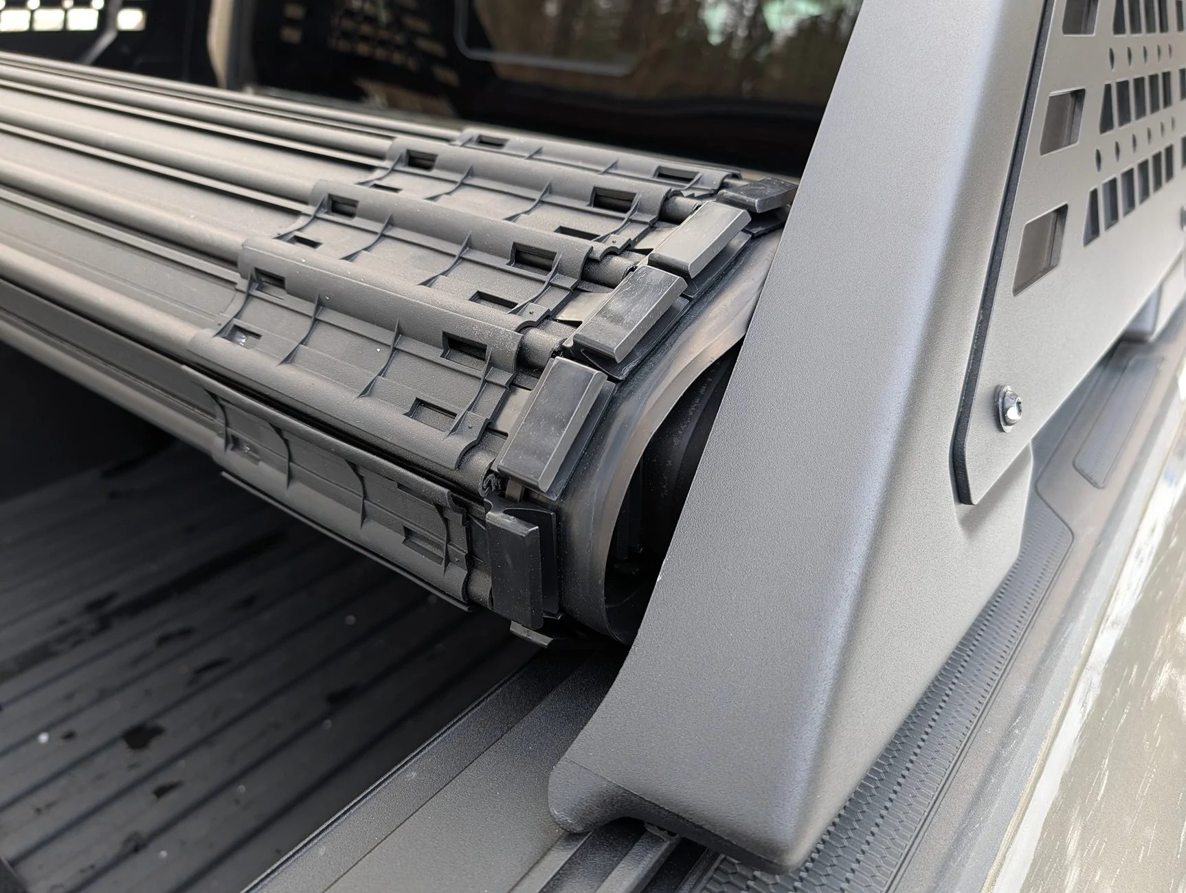

Another thing to note, is that the flexible rubber edge seal does squish to get it past the bar to roll it all the way up. NBD, it does that, so it works just fine, but you'll want to be gentle and not let your little kid play with it if you value its longevity.

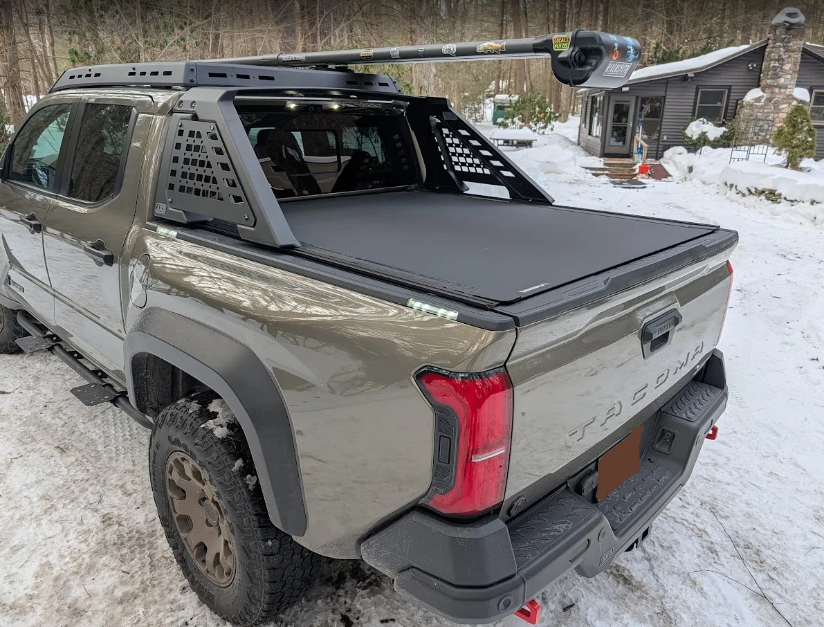

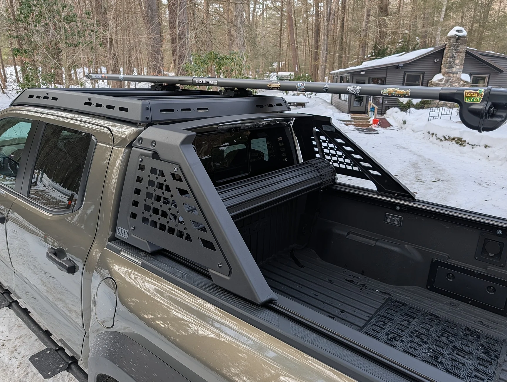

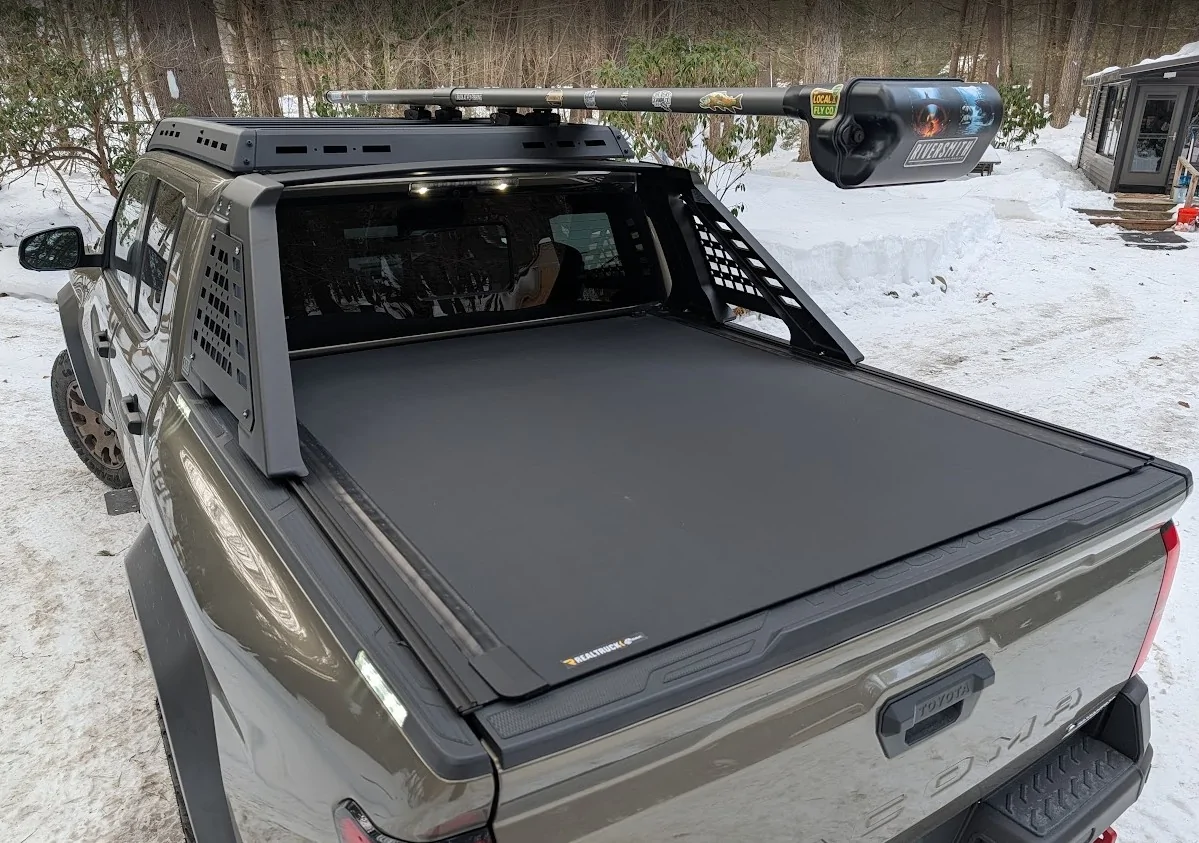

All done, and time for pics...

You bet, it's a Riversmith Euro 4-Banger fly rod carrier! Quite happy it mounts to the roof, I really didn't want to have to have a bed rack to mount it. It's supported right around the middle too, so no wiggles. I had it mounted all the way rear on my old Crosstrek, and at over 11ft long, it was comically the same length as the car. Stuck out like a rail gun. Now I can keep the rest of my fishing gear locked safely in the bed for daily use once it warms up and I don't have to worry about ice flows taking me out.

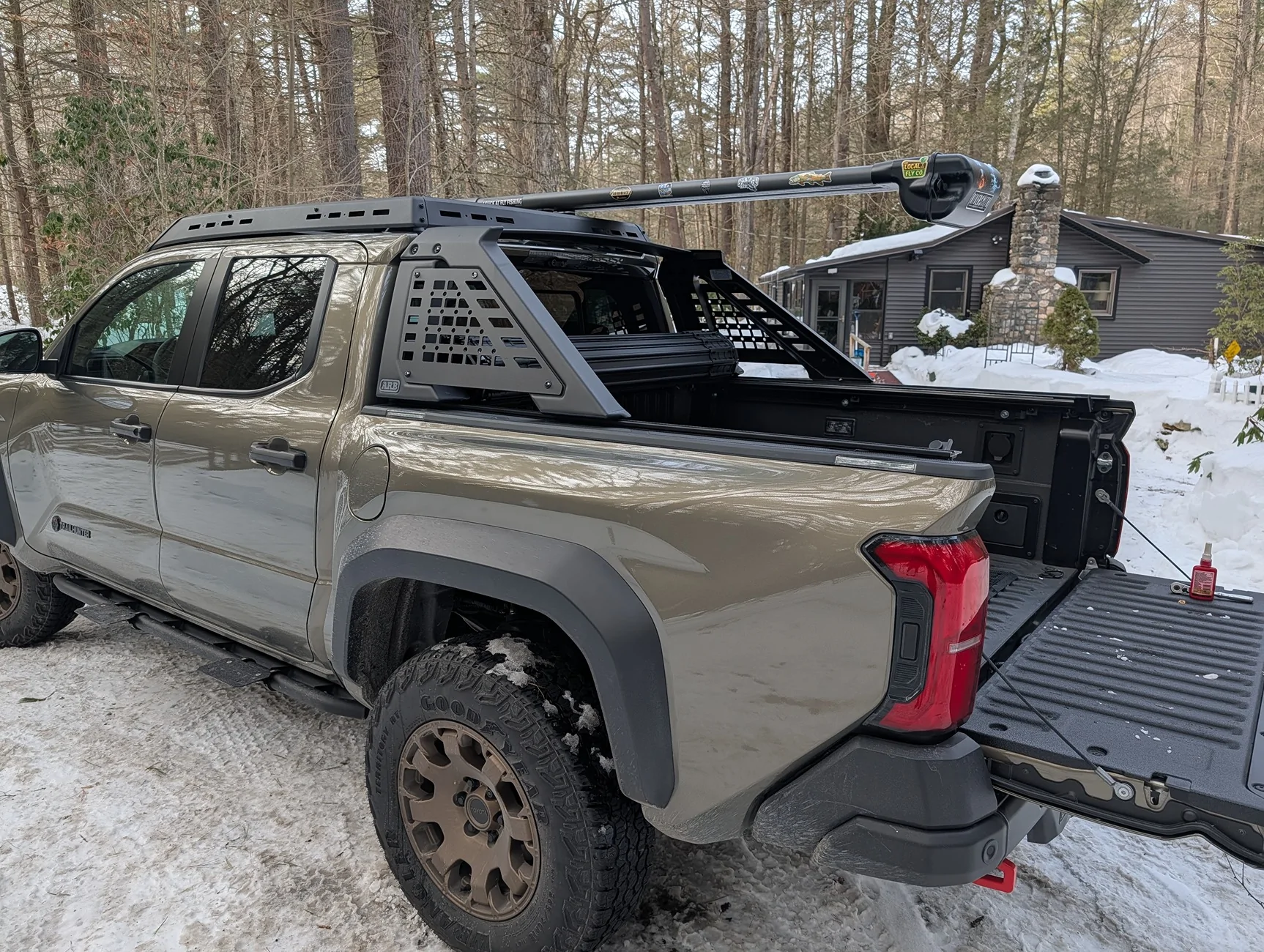

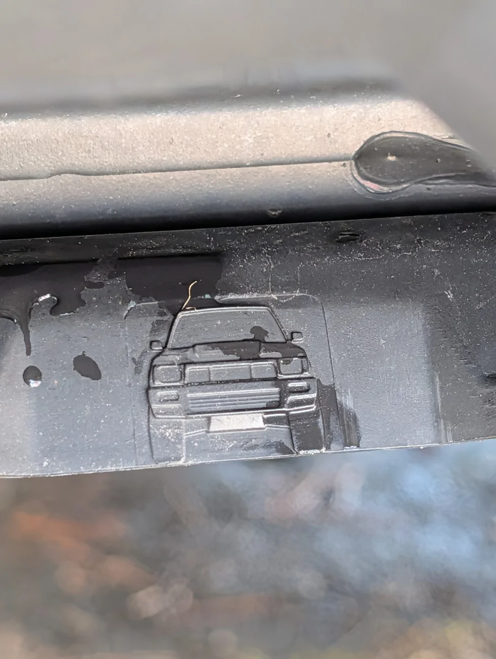

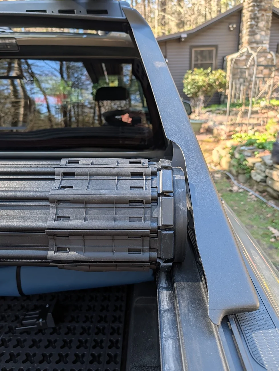

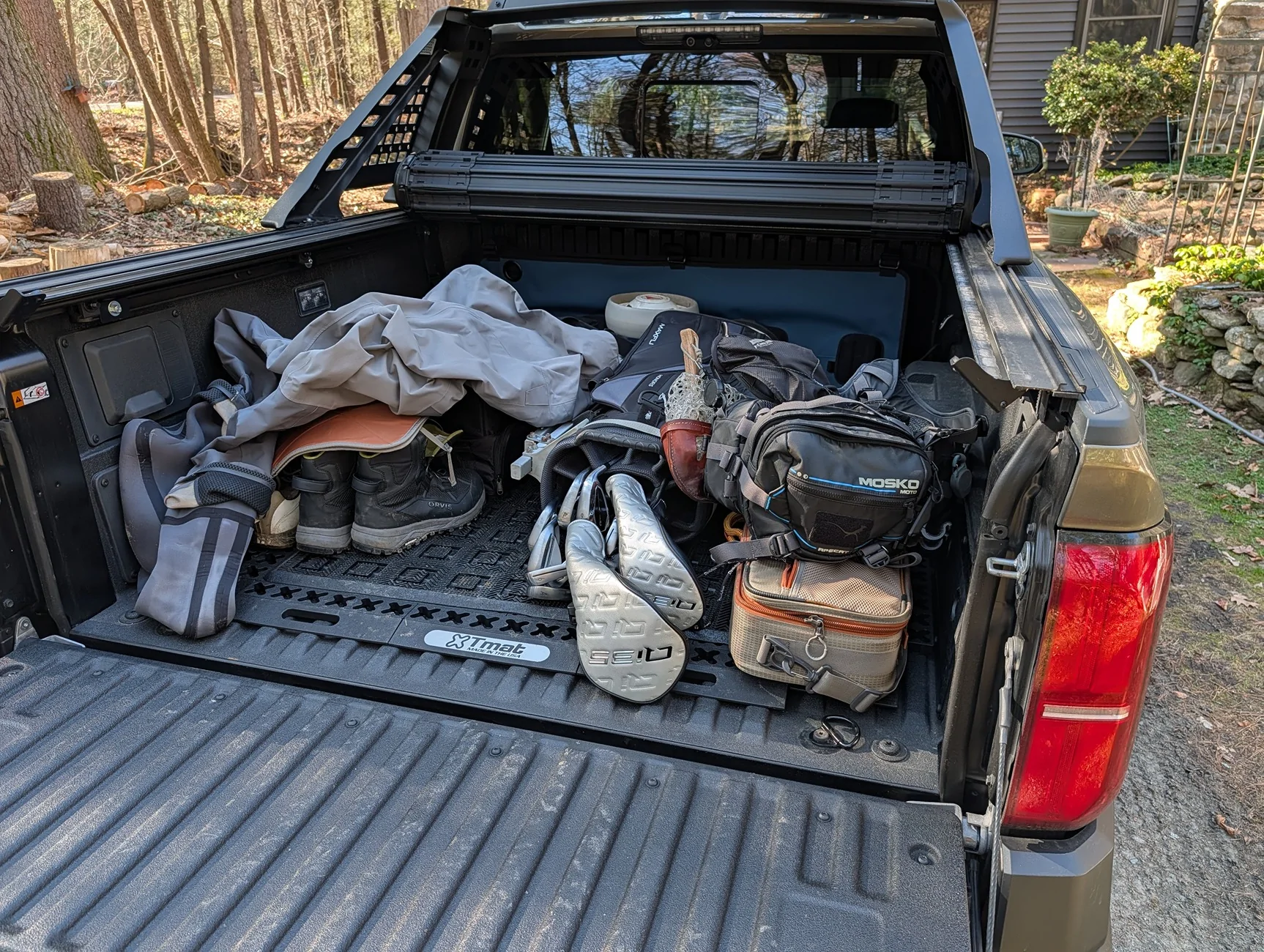

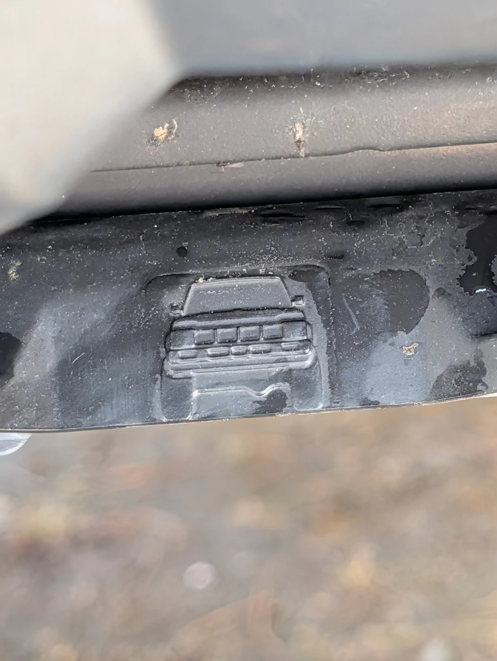

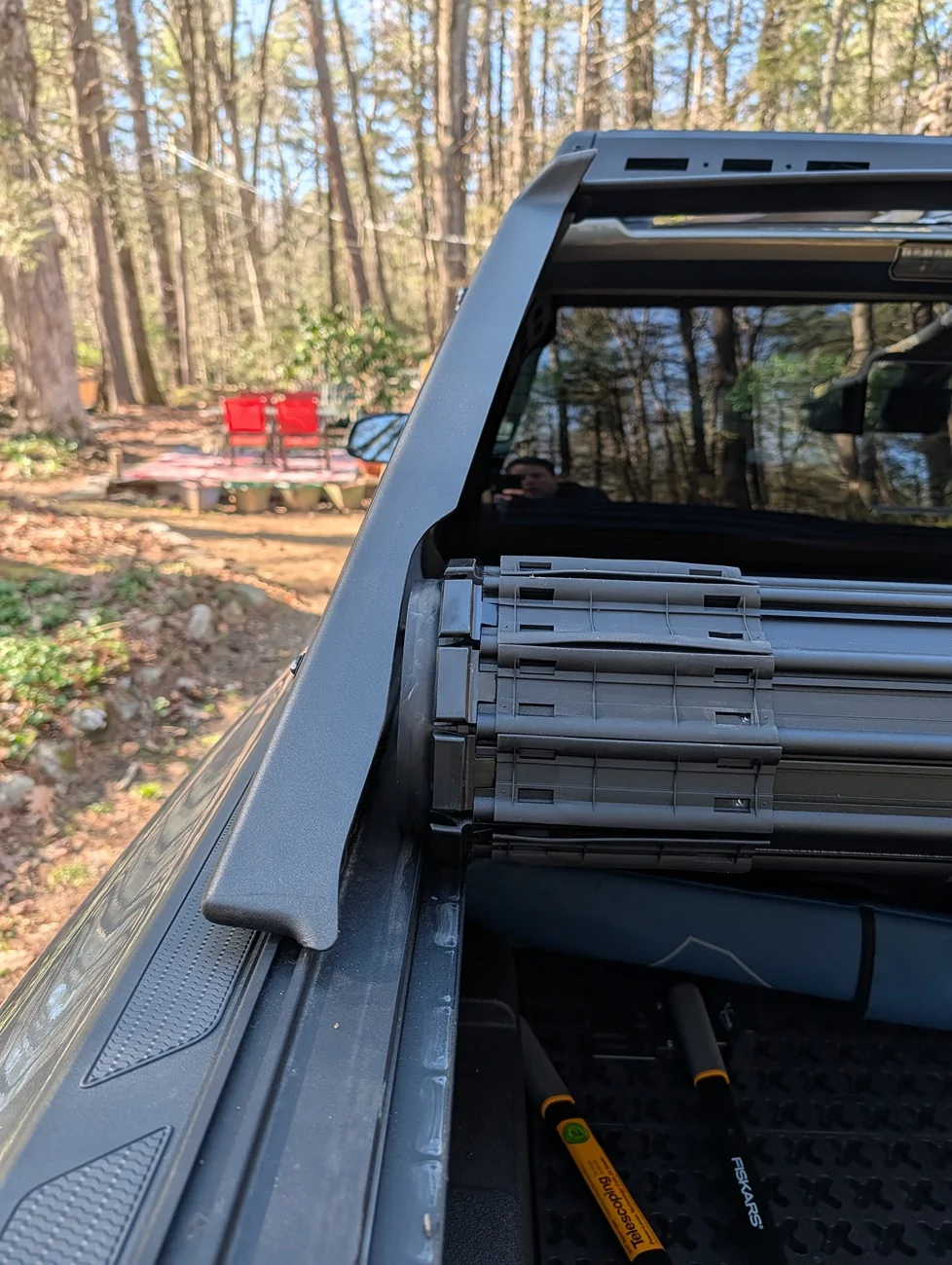

Hi all, figured I'd post an update on the project. Finished the last step this weekend of shaving the insides down so the cover rolls up cleanly all the way. So I pulled it back off, cut, shaped, painted, and here it is! Also, found two more easter eggs I havne't seen anyone post yet!
