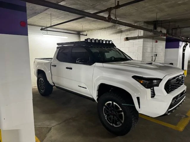

Installed the set up over the weekend, still need to finish the wiring, but should be easy with the factory aux switches...
Super high quality, easy to put together. I decided to actually put the rack together on the truck, rather than building it on the ground and then lifting it on. Limited help at the house and my wife is pretty short
I have the Baja Lights from a Jeep I built and took off before selling.
It's very solid, but as you can imagine there is a fair amount of wind noise. Just the price you pay when you mess with the aerodynamics

Honestly didnt notice any vibration, no rattle, whistles as I was going on the highway (75-80) The light bar mounts at each end of the rack and also in the middle - so no flex there either
The biggest is just the wind noise - while not horrible, I'm sure in part that because of the 7 BD lights and more surface area then a 40" low profile light

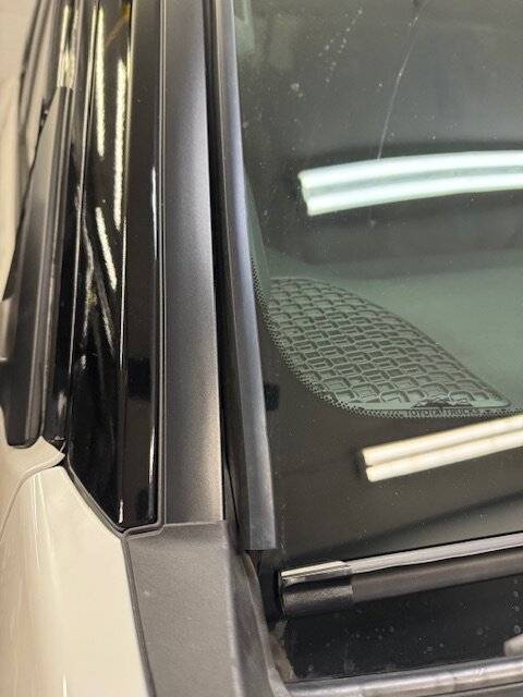

KC makes a "wire hider" that basically creates a channel for the windshield. Sticks on with 2 sided tape. I ran one for years on my Rubicon and had zero issues with it coming loose.
You wont even notice it once you install it.
So down the windshield, under the wiper cowl and over to the aux plug by the radiator. Used the factory harness they give you and put it on the aux 1 switch
