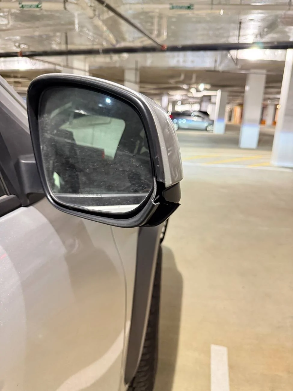

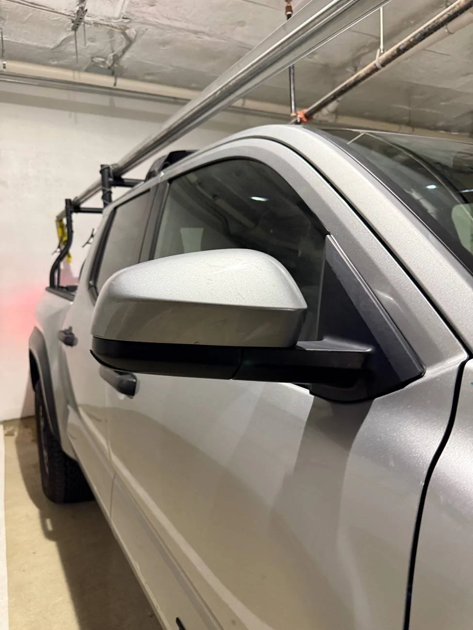

Hey I accidentally hit my car with a post in my garage, and some part of the plastic has been damaged,
Everything else in the mirror works, the heating, the signal light and the motor but I’m just looking to replace the mirror plastic cap or cover or whatever this is and I can’t find the exact part number or the item online,
Please your help with this is appreciate it!

I just replaced my mirror as someone hit it in the third day I owned it. There is the body colored painted cap, which looks fine In your pics. It snaps to the mirror assembly, which is framed in black plastic. It seems the frame is broken (the black plastic is what looks broken to me, but it’s hard for me to tell.). If you can confirm that to be correct, I can get you the part number I used tomorrow.

Unlike the mirror glass itself and outside cover, which can be purchased separately, unfortunately that bottom plastic area is part of the entire Mirror Assembly..so you'll need to buy that entire peice.
Looks like yours is without the surround view and without integrated mirror turn signal. Therefor the part number you for you is 87910-AK010

Hey guys thank you for the reply
But looks like the part is not matching based on the car information I entered
So you have any other suggestion on what should I do?
