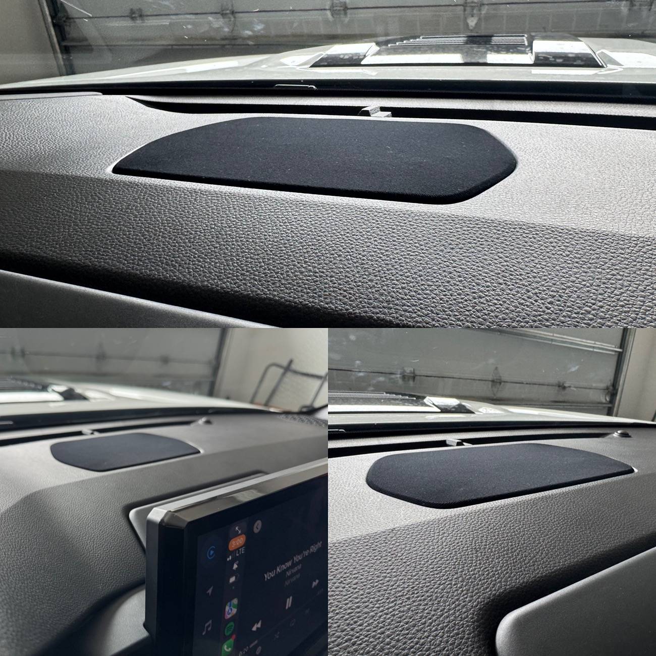

So far I'm very happy with my DIY/prototype center channel speaker and will be building a second, cleaner looking revision this week. Note: I'm using a Beat-Sonic ENA-2T3 so I'm getting additional amplification on what I believe to be all speakers/channels.
In summary I'd say the sound is pretty darn linear from left A-pillar to right.. meaning nothing imbalanced + canny-sounding in the center..
EDIT: women's black tights arrived today... looks much better than the glossy perforated camo vinyl;)
2024 Tacoma JBL replacement center channel speaker (prototype/DIY) 348DB411-8ACD-4958-A3F5-5749F70872F4.JPG

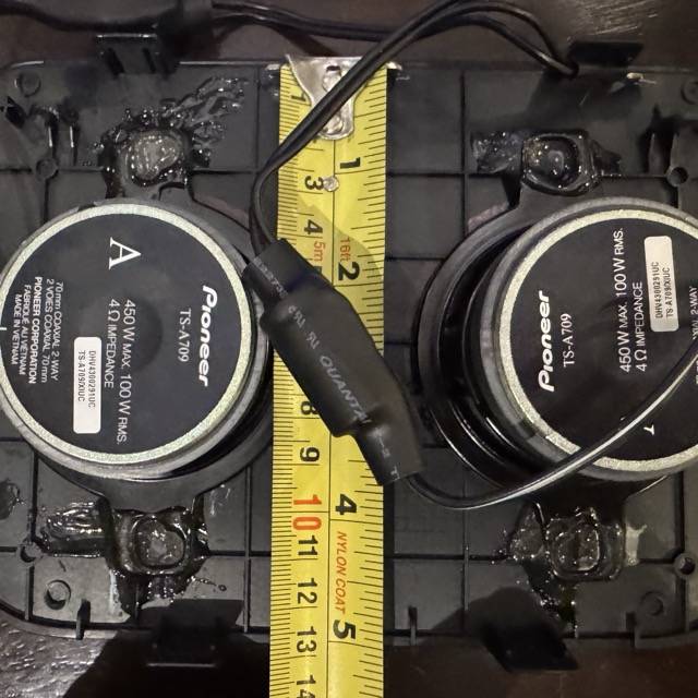

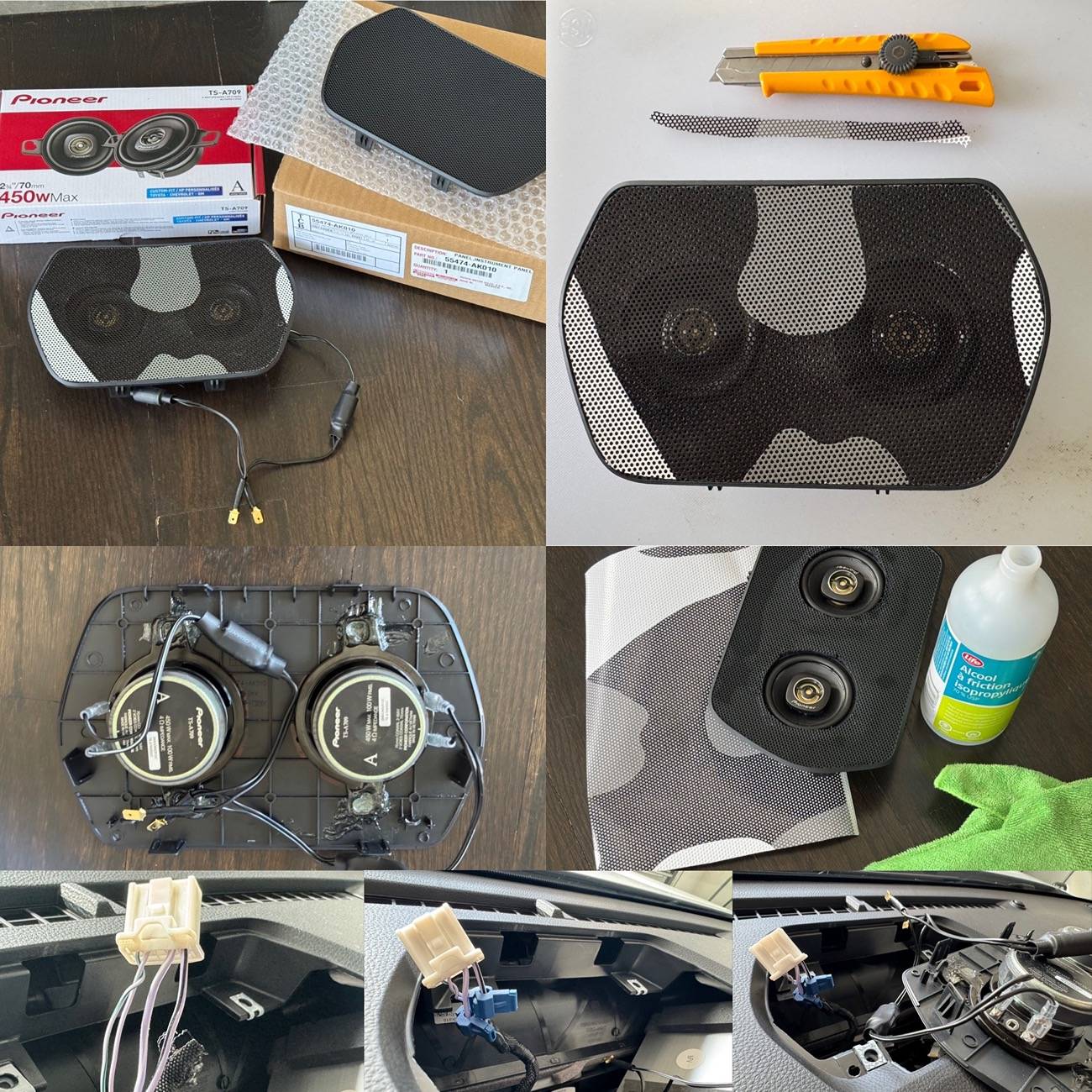

Parts Used:
1) Non-JBL speaker cover which would be cut to hold replacement speaker(s)
Dash Cover - OEM Toyota Part No.: 55474-AK010
2) Replacement speaker(s) - EG 1 or 2 JBL Club 34F, Pioneer TS-A709/879 etc
Pioneer TS-A709: https://a.co/d/0wTkOEF
3) Speaker cover (black nylon else one/two 3" or one 4" speaker covers)
Optional: Beat-Sonic ENA-2T3
Used to increase amplification to all channels, allowing me to rebalance two positions rearward resulting in a fuller soundscape/soundstage and better overall audio fidelity at higher levels.

Yes, I removed the JBL dock.. completely. Resulting in 3 pieces removed:
1) Speaker
2) Dock surround/top trim
3) Dock
Details:
There's a surround trim piece that pops up (by hand) to give access to 2x 10mm bolts at the front/button side of the dock. Also 2x 10mm at rear of dock (accessible with/without trim removed).
I had already yanked the 4x 10mm bolts out in my second video... which is the first in the above post. I've just edited the post to include my original post and also video which covers the JBL dock a bit more.
