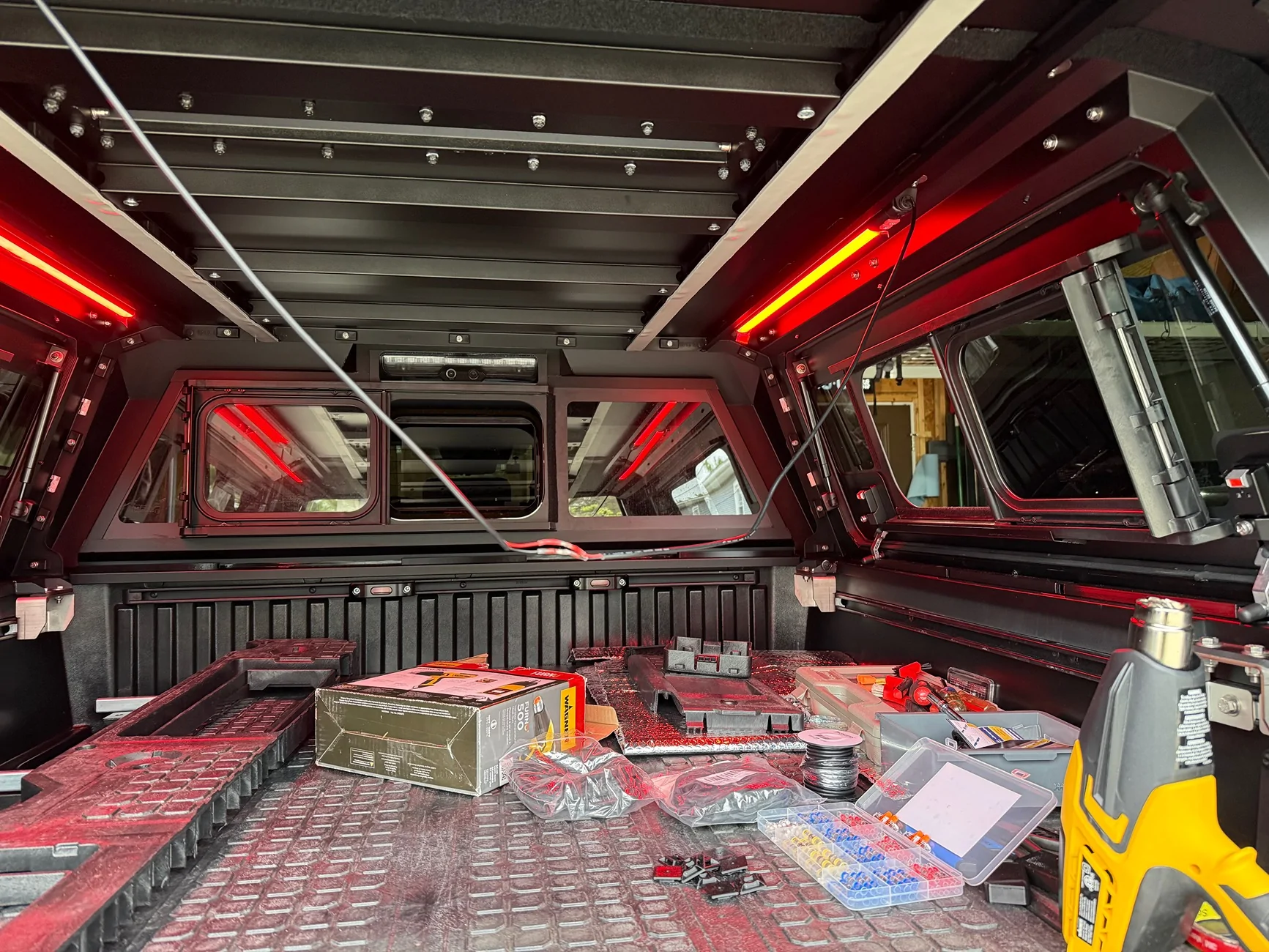

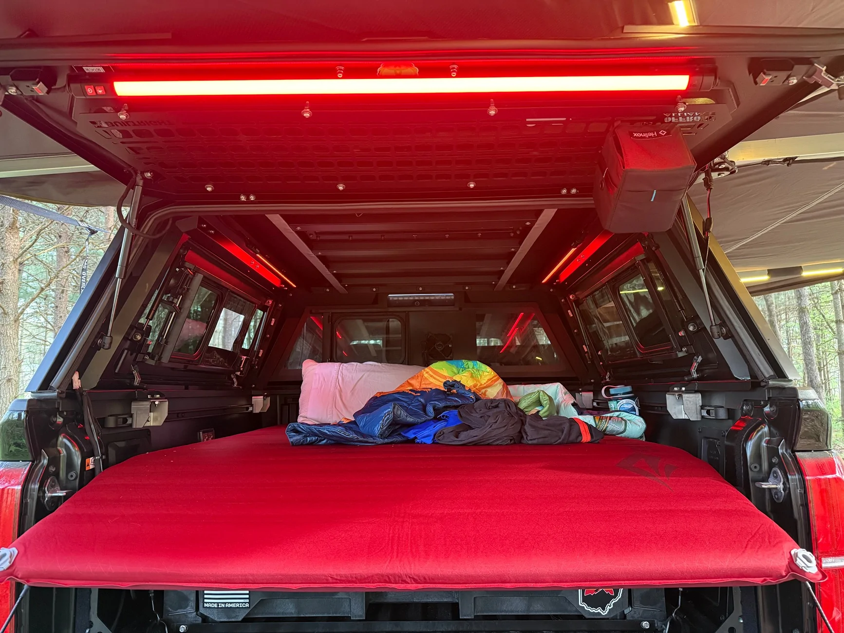

I recently upgraded my LED lights in my SmartCap from some Nilight LED strips, which did the job but the LEDs were visible, to the Kingpin Equipped F-Series light bars (1 - 40" and 2 - 28"). Man what a difference. These lights are bright, you can't see any LEDs, and high quality. I really like this upgrade to my truck bed for both when I'm camping or doing work. I think these are really worth the money.

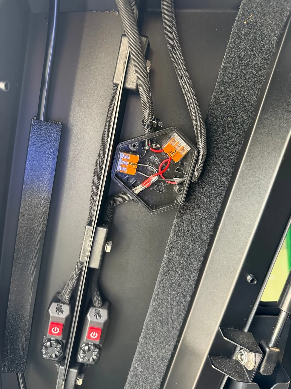

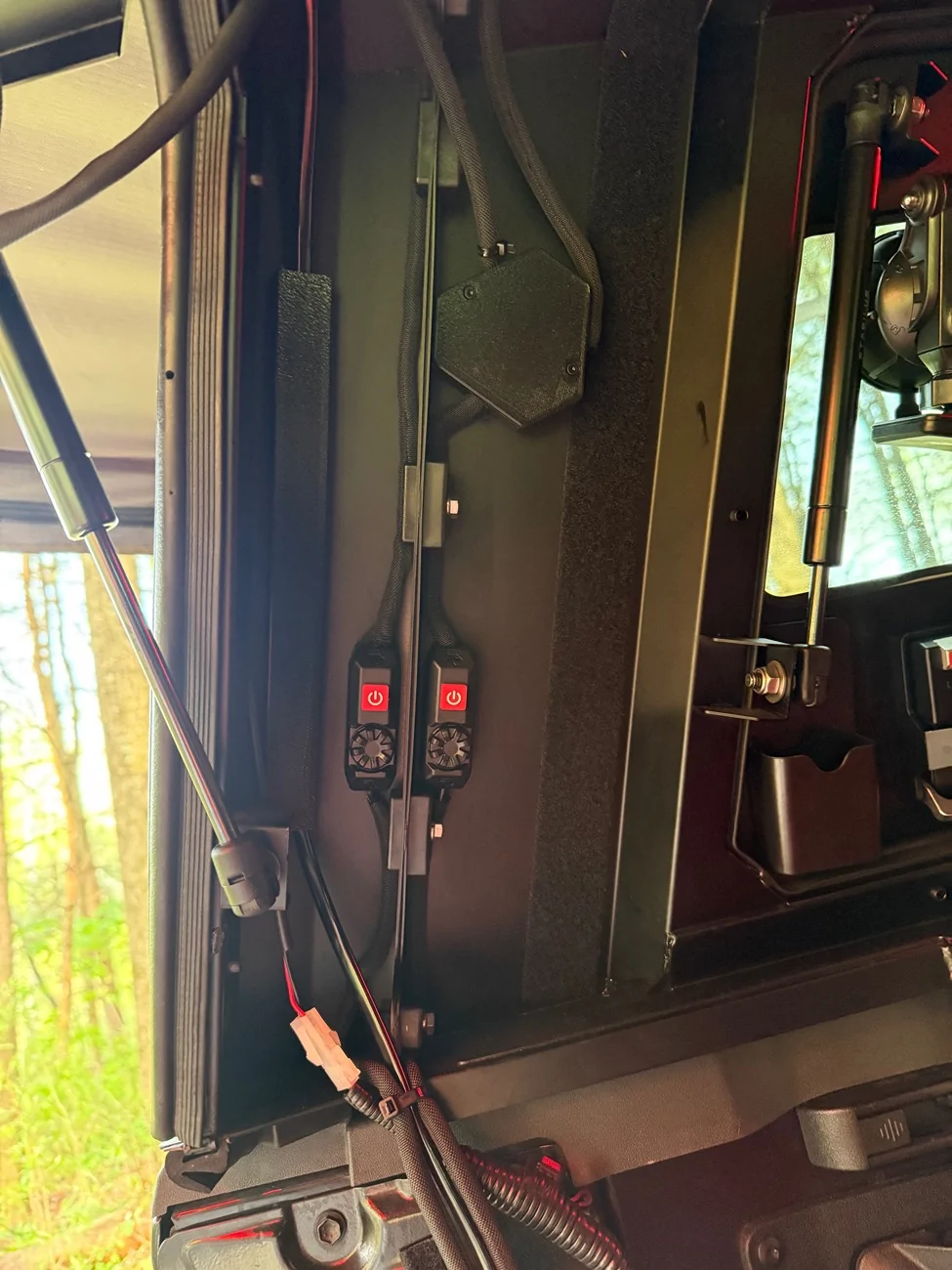

I also took my time and tried my best for a relatively clean wiring look. I even 3D printed a junction box to connect two light bars to one switch.
