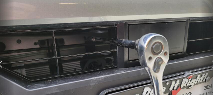

yep, it's this device, seen from just above the license plate:

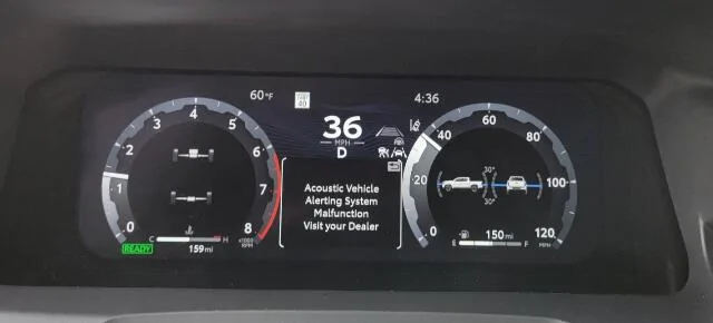

Removing it throws an error that you can say "ok! got it" but it will remain on your screen. cannot be dismissed:

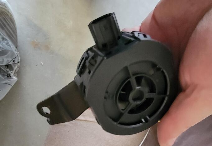

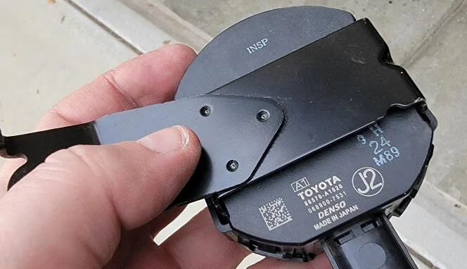

few shots of the device in question:

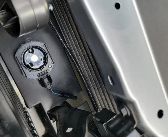

I upgraded mine by removing the facia, and pouring some epoxy in the speaker, letting it cure overnight, then rerouted the cable, and double sided VHB'd it to a peice of trim plastic inside the engine cavity, right below the horn:
it now works way better, and no error.
