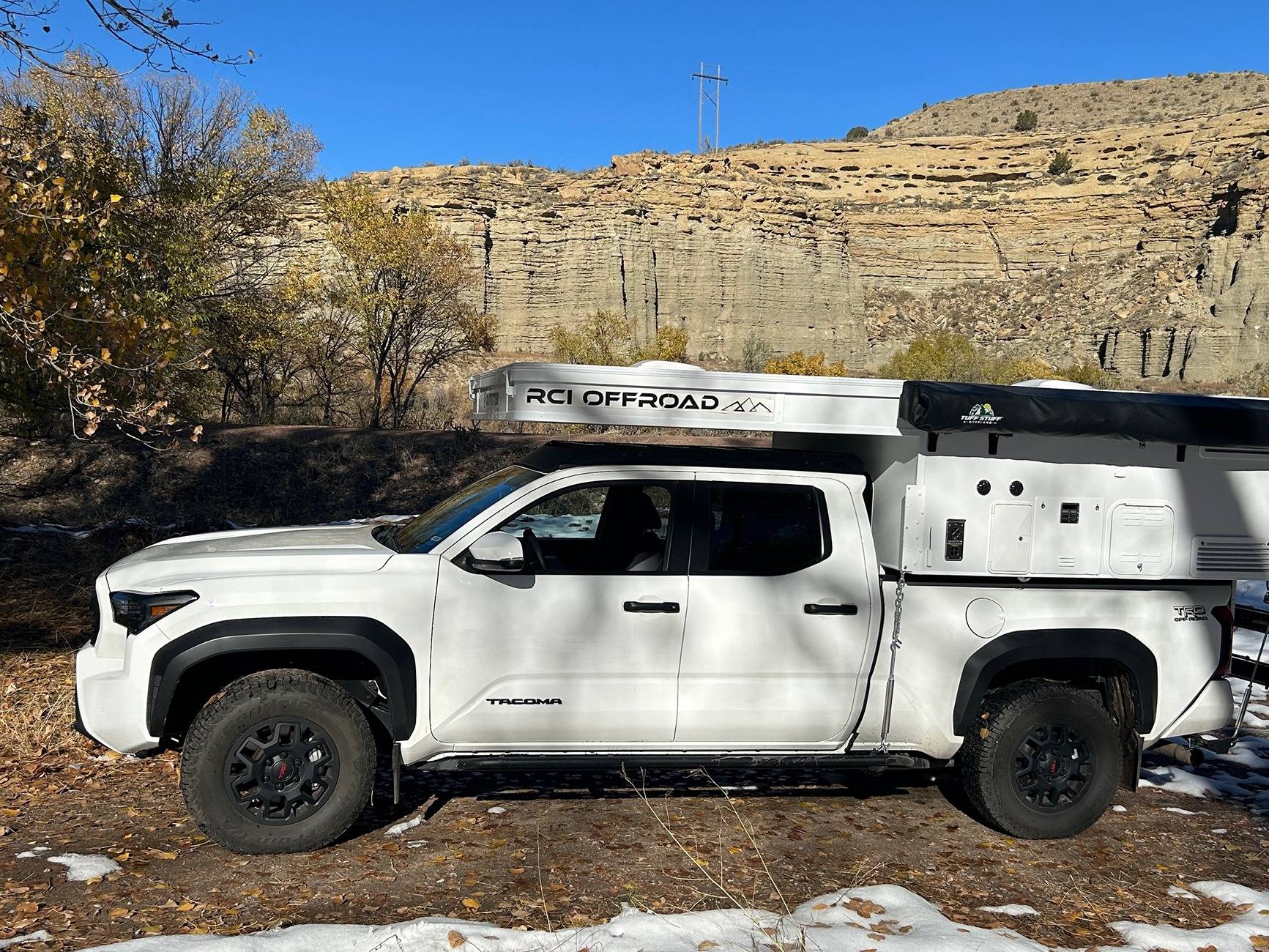

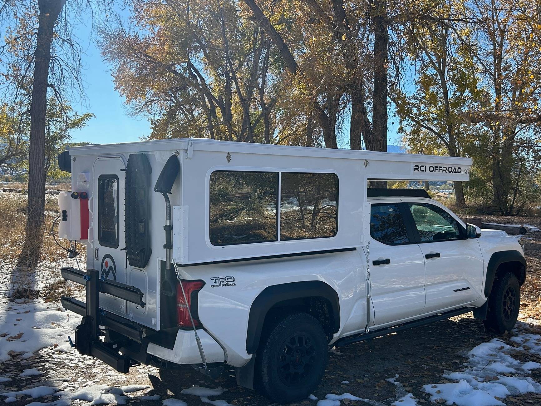

I recently put an Outfitters Caribou Lite on my Off Road w/6ft bed and stock tires. I also have a front skid plate and rock sliders from RCI. I installed Timbren SES bump stocks and Icon triple rate springs with 1/2" lift. I have only lost a 1/2" from original set.
