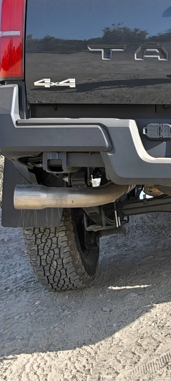

Fully flexed out the leafs get very close to the exhaust, which is part of why I got the trail pipe
Now imagine flexed the other way lol
2024 Tacoma Our SR didn't come with a resignator Screenshot_2026-03-04-08-19-59-870_com.miui.gallery

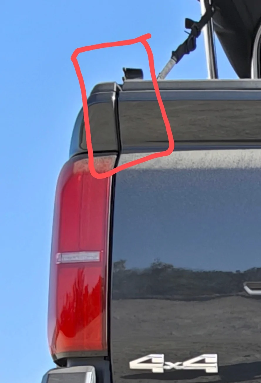

I will say though look how stiff the frame is on these:
nearly at the bumpstops on the rear end and the tailgate isnt smashed into the bedside
Yikes, You can definitely tell the 4th gen’s were designed solely around having rear coil springs, and were not really mean’t to have rear leaf springs. Not sure why Toyota didn‘t decide to make them all coil springs. At least the frames are all fully-boxed now, hopefully we don’t run into any of those rust problems that the previous gens had.

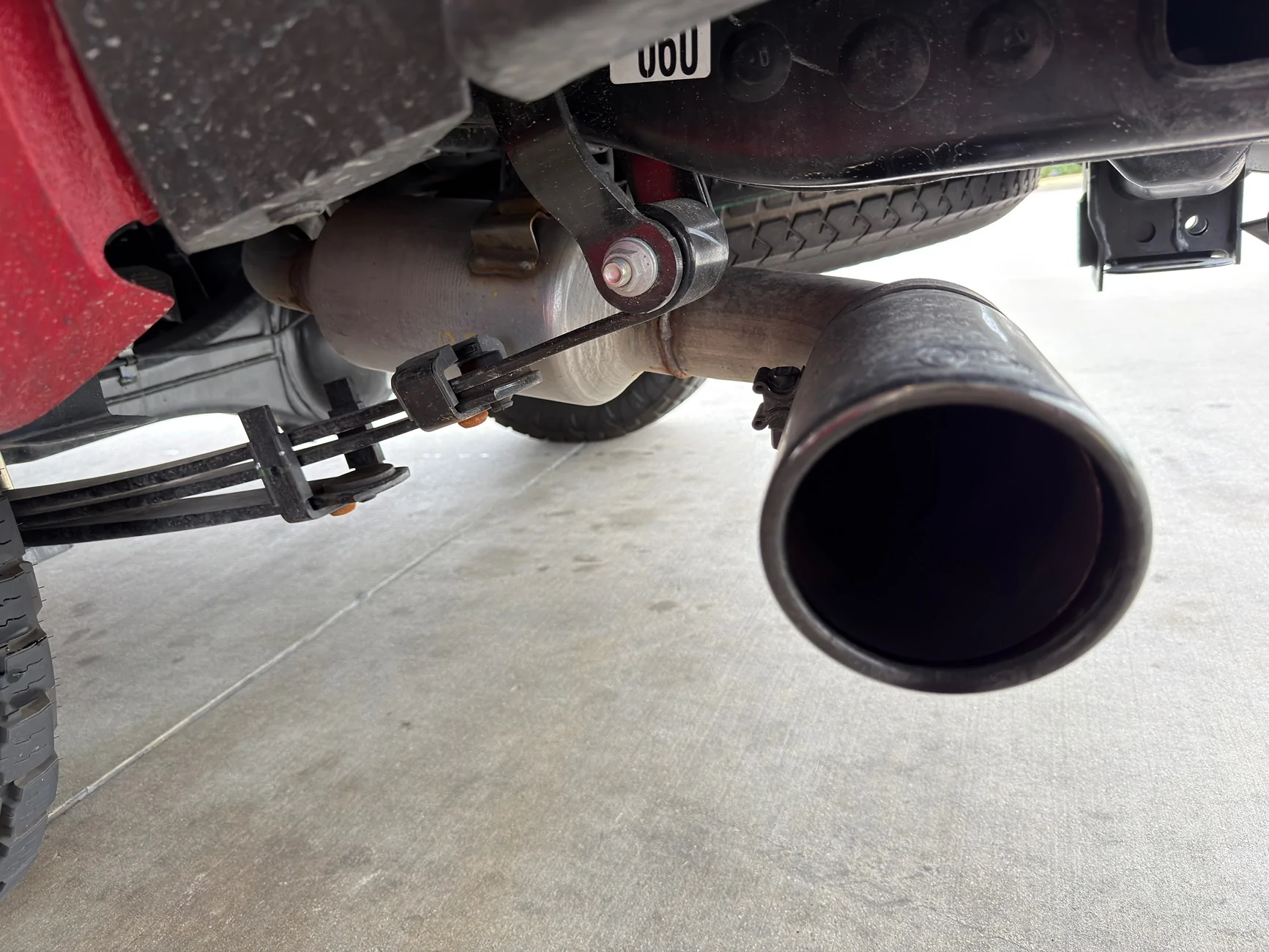

Am I screwed up here or does my SR have the resonator? So I guess automatics don’t have what’s in my pic?
Huh
You have MT though, higher output T24A, I guess they put resonators on those, interesting 🤔
