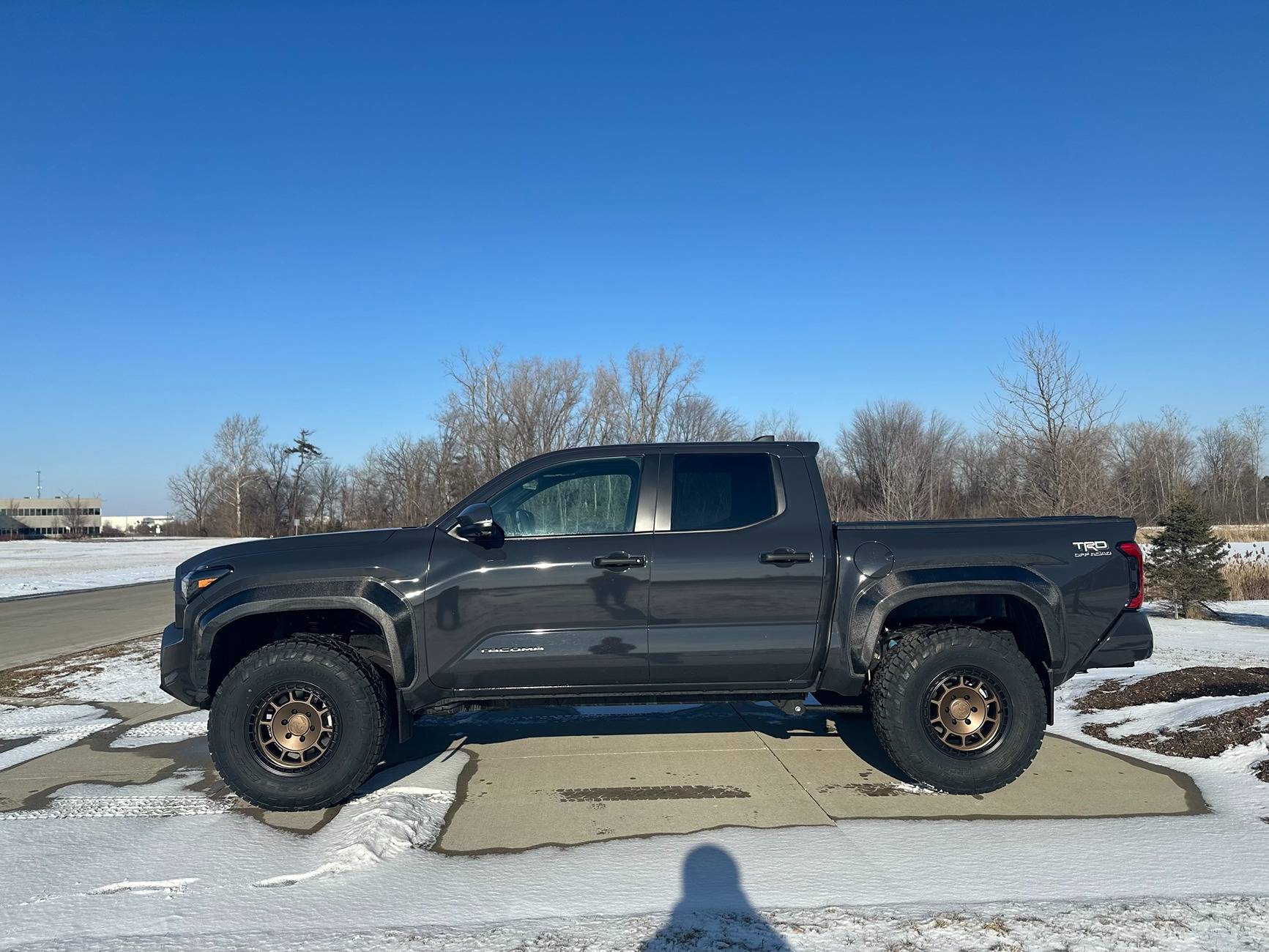

Well I got my Peak Suspension 1.25 leveling kit installed today. Truck has maybe 1/2-1”? Of rake now after the install. I plan on doing a full suspension setup down the road, but for now I feel the new style bilsteins on the 4th gen are pretty decent. If you’re looking for something to level the truck out with a small amount of rake I highly recommend these spacers from Peak. The craftsmanship of the spacer is probably the nicest I’ve seen so far, and they are super easy to install. Honestly you don’t even have to pull the strut assembly all the way out. We pulled the first side out to see how it was going to go on, but the other side we just dropped down and dropped it on top and slide the strut assembly back into place.
2024 Tacoma Peak 1.25” leveling kit IMG_5523
