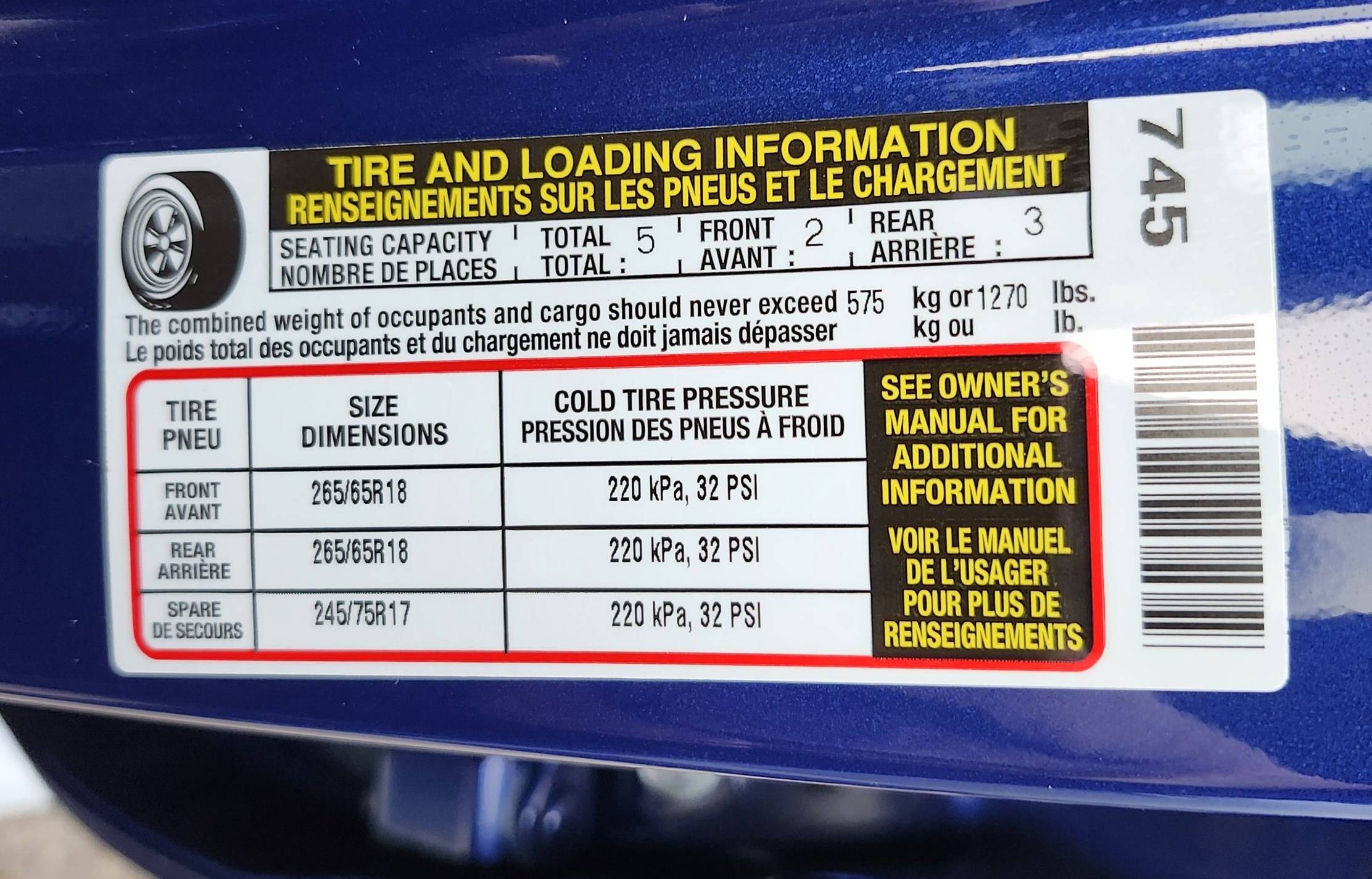

Correct me if i am wrong, but if you have five 200lb guys in the cab (if they fit), you will only be able to fit another 200lb of gear in the back before reaching payload limit. If this is the case there is very little wiggle room for any aftermarket addons.

I actually questioned this is my most recently video on the Tacoma I published seeing if I could get an answer from Toyota. The 4th gen manual says the rated cargo capacity PLUS the vehicle occupancy x the number of seats. But Toyota has never listed it this way before so I am curious if its a typo or not.

I grabbed this from the "Payload" thread in this area of the forum...
This sticker clearly states; "The combined weight of occupants and cargo should never exceed" ... then it lists the payload, in this case of 1270lbs. And if that is so, i would quickly run out of payload if i place a simple cabin-canopy and a week's worth of supplies plus my wife and i (at a total of 300lbs "occupants").
I do like the idea of grabbing a TH with a 6' bed, but if i could get the same ?apparent? 1700lb payload from an OR, i would do it as i certainly don't want to be forced into a rig with a mandatory/silly headache rack and other 'features' that are more or less bling for a simple camper-build??

Didn't see that in your OP, but it was in your 2nd post, but you should have about 550 lbs (there's always some "extra" in max payloads) of payload, so you'll have to do the math to see if that's sufficient.
