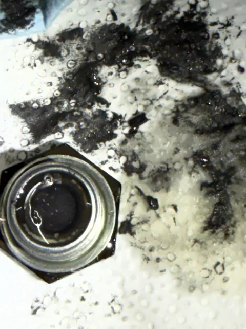

Rear diff oil change at 2000 miles, handful of decent sized shards on the drain plug, did a clean catch of the oil and there was grit suspended in the oil but no shards in the catch pan.
2024 Tacoma Rear Diff oil change at 2000 D2

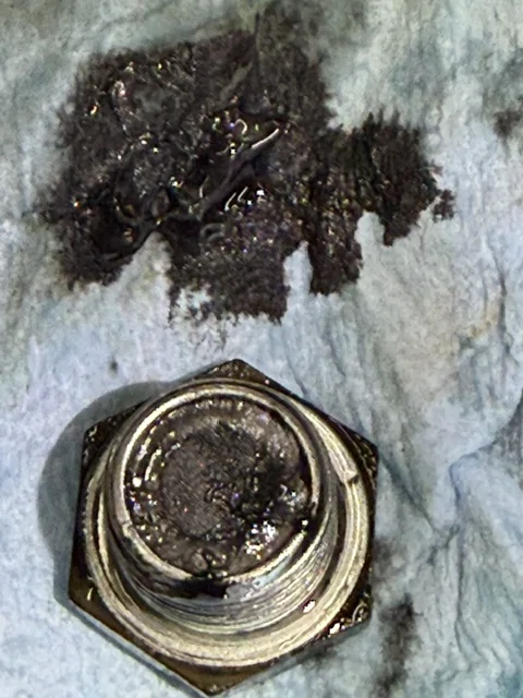

2024 Tacoma Rear Diff oil change at 2000 D1

I did both diffs, xfer case, and MTF at 50,000 km (30,000 mi), the rear diff magnet had some small shards on it, and the fluid was clearly very worn. MTF, front diff, and xfer case (used very frequently) looked super clean though. The rear diff takes a majority of the beating when daily driving though. I am at 80,000 km now so we will see if the wear improves at 100k
Good to know the xfer case is clean, gonna do the tranny soon.

I just did front/rear diff, transfer case, and transmission drain/fill - 21k miles. Front diff had the most gunk/debris. The rears were also pretty dirty but not as bad as front. The transfer and transmission were clean

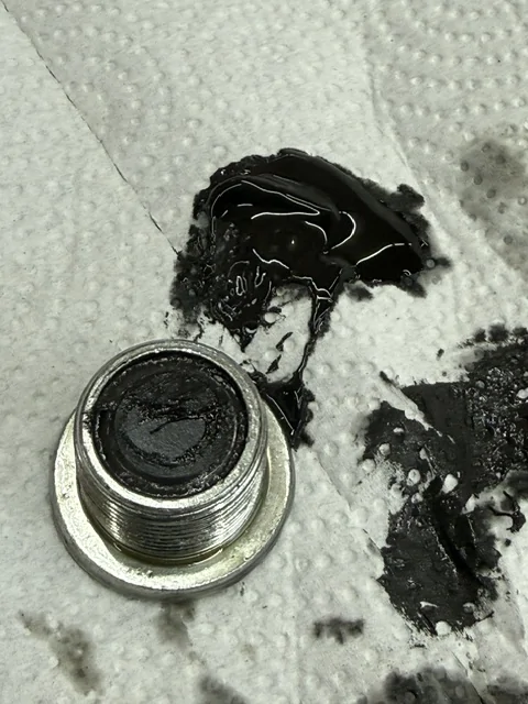

Just did the front diff at 2100 miles, didnt see any chips on the magnetic drain plug but a thick grease like sludge and silvery metallic streaks mixed in the oil. Overall not too bad, probably could of waited a bit longer. Good to know that its good to go tho to at least 20k miles.
2024 Tacoma Rear Diff oil change at 2000 front diff
