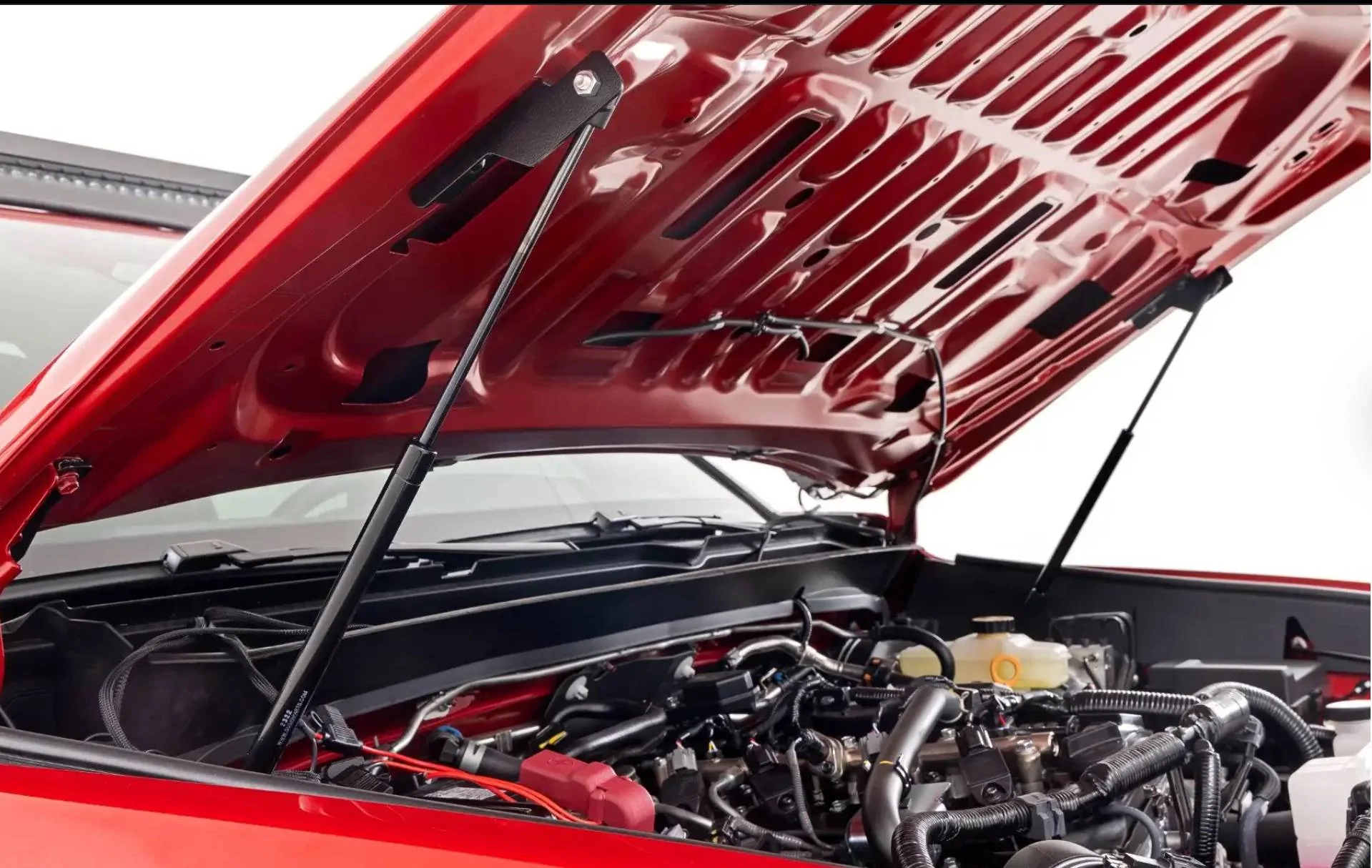

Yup, I just ordered a set last night.
Let me know how it goes installing it. The only part I don’t like is bore out the holes under the hood. I’ll get it if I don’t have to do that part!

I put them on my '23 Colorado Z71. Took about 10 minutes per side and I love them. The only slight drawback was the hood did not open quite as far as the stock option with the prop, but I'll still put them on this truck so I don't have to deal with that prop. I did not remove the prop just in case the struts ever failed.

Looks pretty cool to me. Ordered a set. Hate prop rods

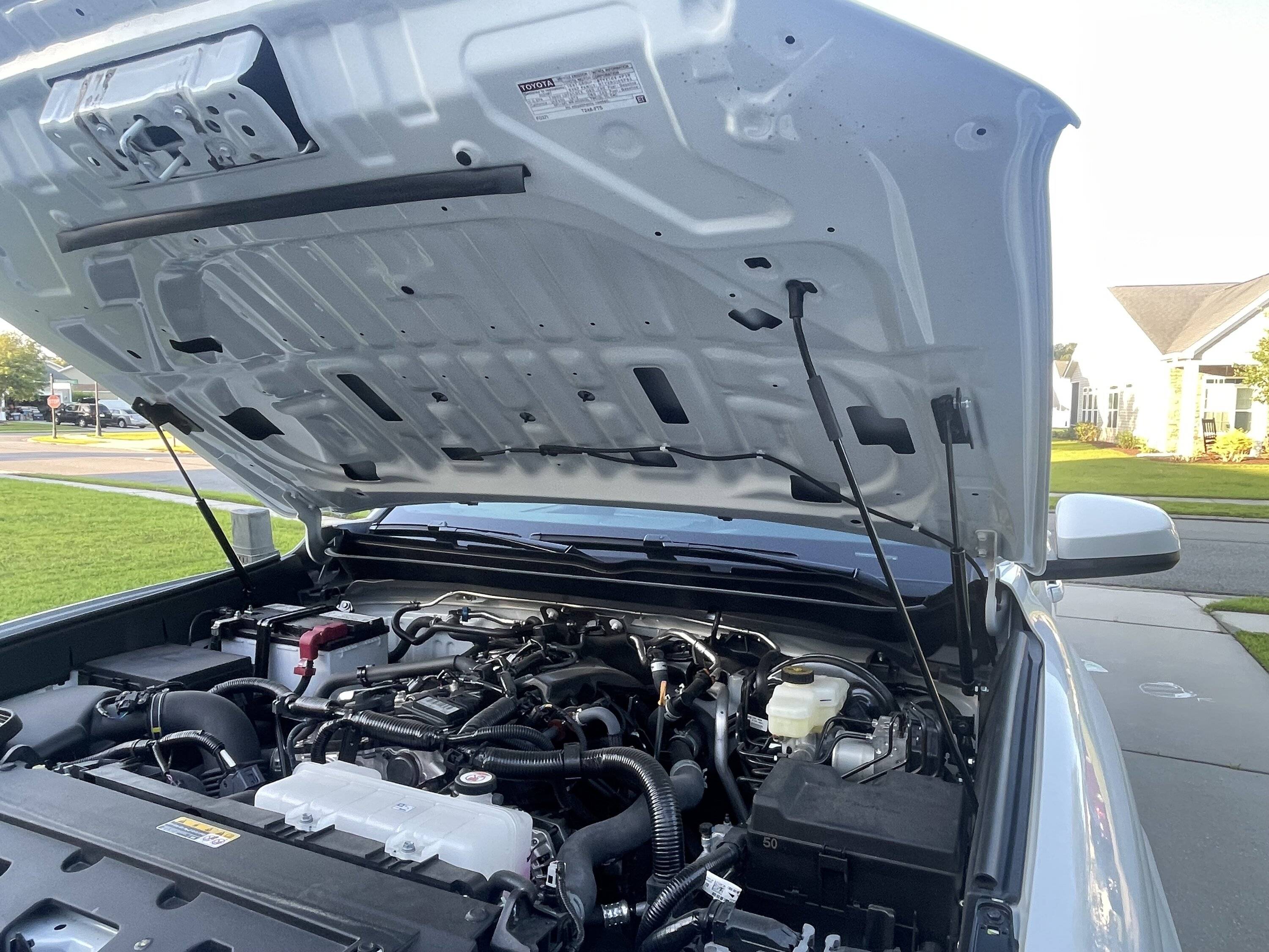

I just got done installing mine. Their directions suck. You’ll need an m12 socket for the bolts and a m5 Allen wrench. One thing they don’t tell you, you can’t have the prop rod in when you put the struts on. The struts won’t allow you to lift the hood enough to remove the oem prop. You can rest the hood on the outside of the hole where the prop sits in the hood. You have to use a little force but it will pull out once you connect the struts.
The photo was taken just before I realized I couldn’t get the prop out. Haha
