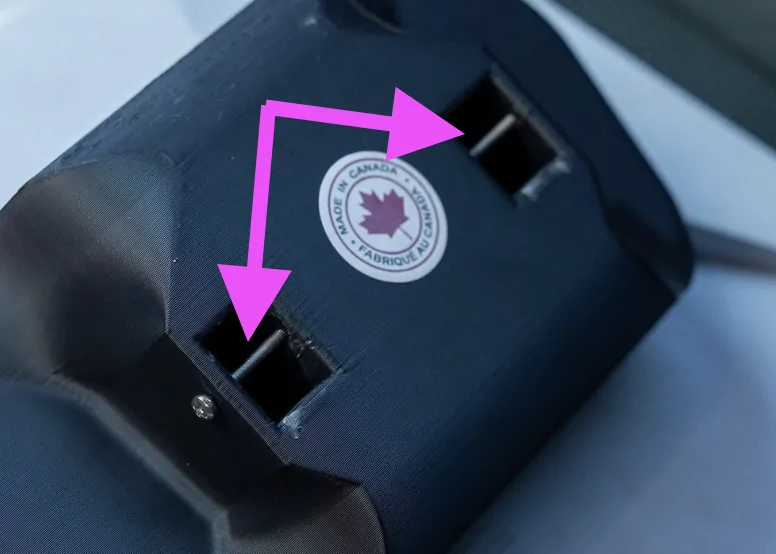

Got my Broken Rover 3D printed mount. Quality is so-so but design and function is good.

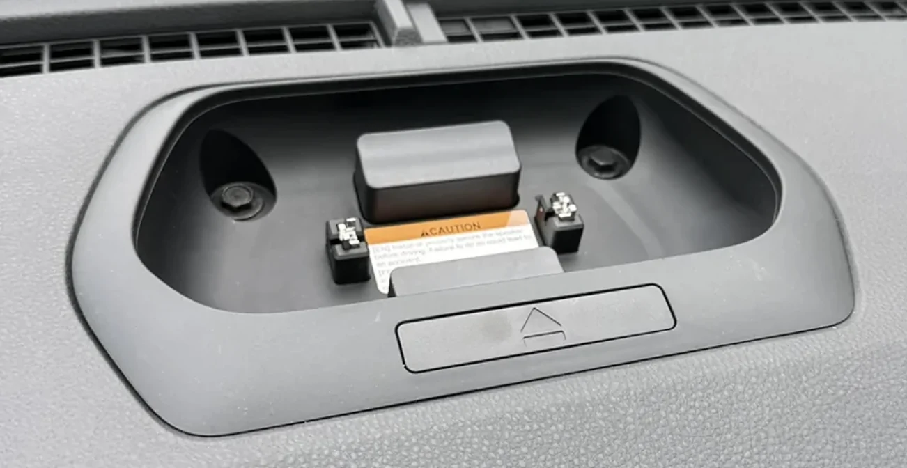

I spent some time shaving the rough edges and reinstalling on the Mini a few times. My tiny brain finally realized my copy will only lock into the JBL dock if I press it in without it being mounted on the Mini first. Once the mount is in the dock, then it’s easy to slide the Starlink into place and lock in.
Fortunately, the mounted Mini fits my dashboard and is over top of my existing bullet point mounts, so it is not too busy and there is no interference.

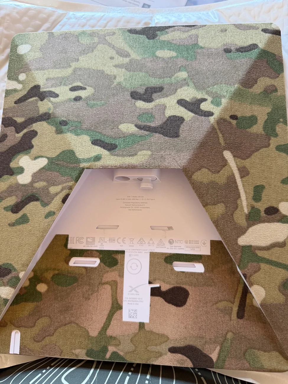

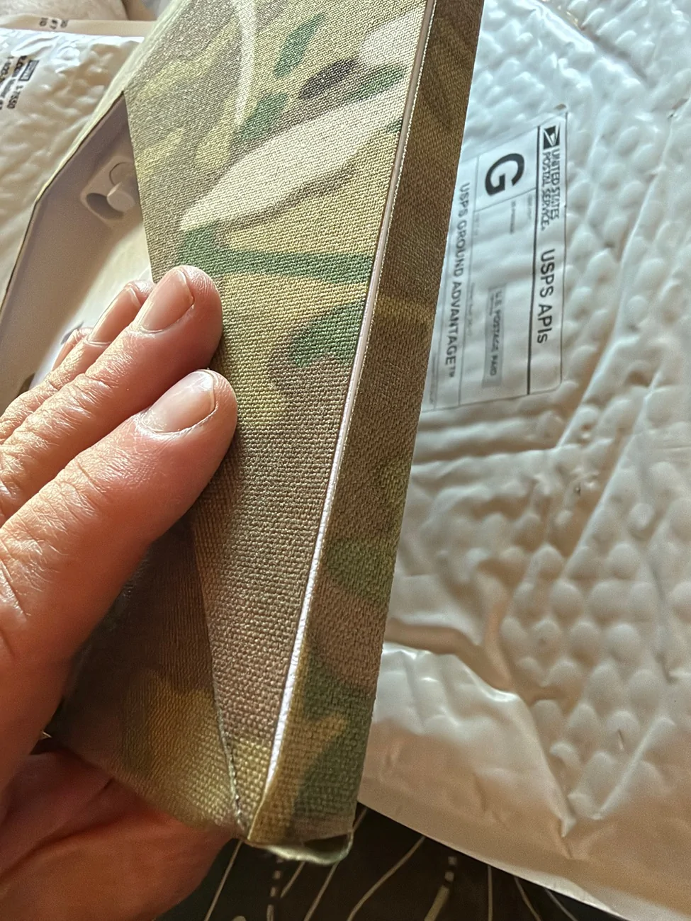

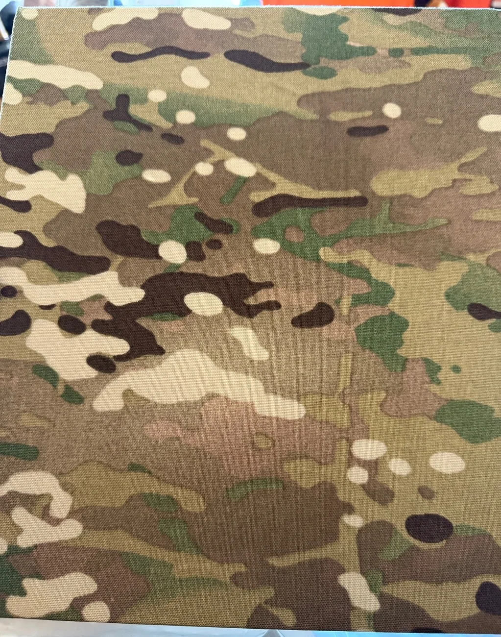

This afternoon the Ranger Wrap arrived. Thought I ordered black Multicam but regular Multicam is what I got. It’s easy to put on and repositioning is easy too. Jen (wife) helped me by holding one end up a bit while I maneuvered the pieces onto the antenna.
We did the back bits first, then the one-piece front, so the fold-down sides would cover any small mishaps. Smooth it a few times to warm the adhesive and it will stay put in the corners. You can see where I had not smoothed it yet in one corner but it’s fine now.
There are a few bits we didn’t use because we have the Broken Rover mount.
Sleek and non-reflective beats the bulky distracting silicone sleeve that I tried last week. The sleeve would be good elsewhere like outdoors. Buy once, cry once. This truck tends to make my wallet cry often.

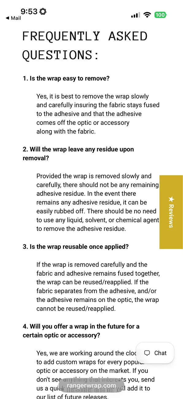

Thank you for the Ranger Wrap update. Would you be able to take off the Ranger Wrap, then re-add it repeatedly? I ask in case I need to put the Starlink Mini back in my Veritas Vans mount or if temps get extreme while operating it.
lauren01
Lauren
Aug 20, 2025
883
787
Ventura, CA USA
2025 Tacoma Trailhunter LB
They indicate Yes but probably there are limits to how many times you can do that since it is just adhesive.
https://rangerwrap.com/pages/faqs
