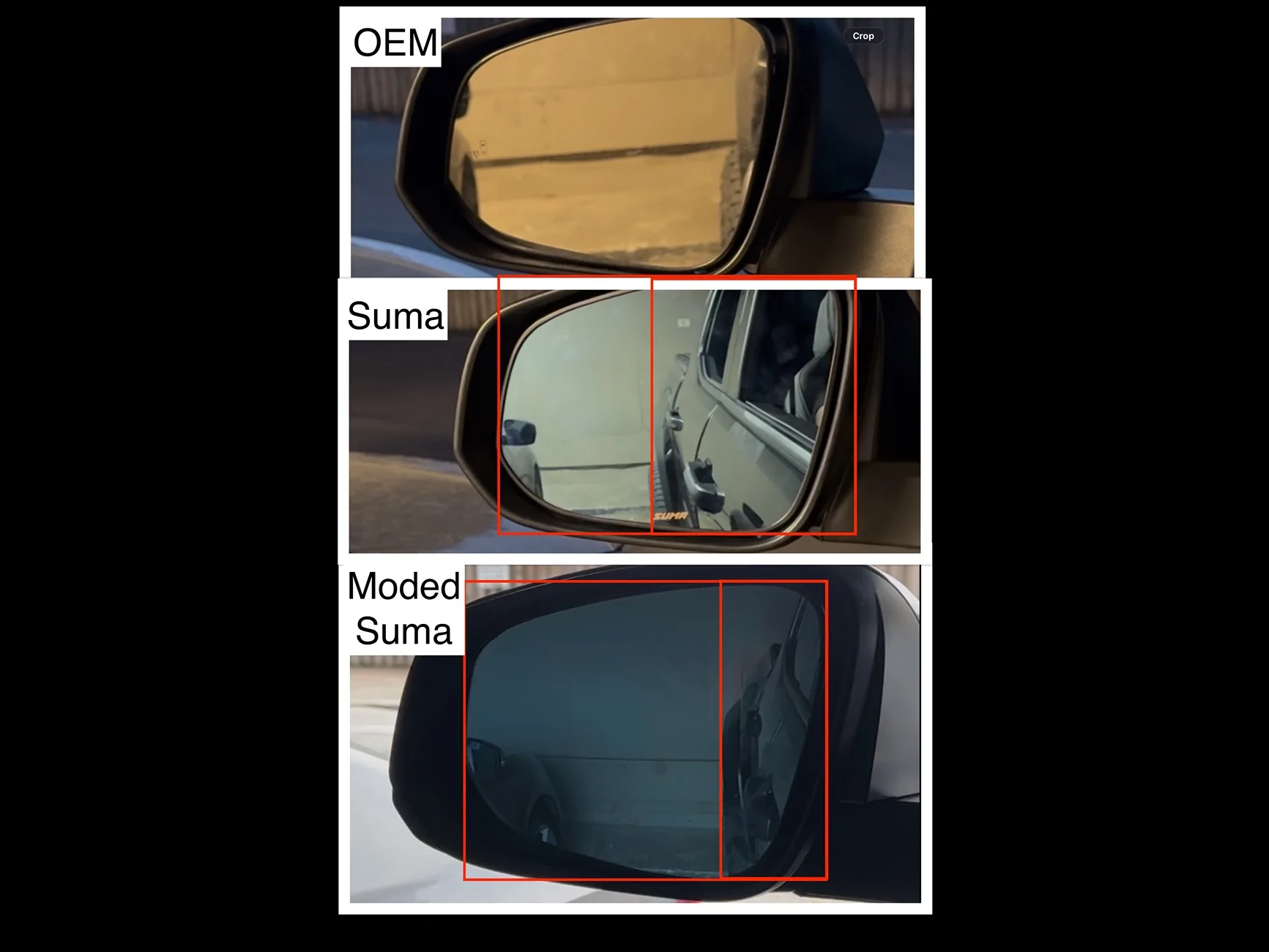

1. The mirror in their stock configuration, do not offer any real usable FOV increase.
As shipped, the mirrors are angled in a way that causes the side of the truck to take up like half of the mirror, even when they're adjusted as far outward as possible.
2024 Tacoma Suma Performance blind spot mirrors: think twice before buying Suma mirrors
As you can see, while there’s technically a field of view increase, it’s basically useless in my opinion because it mostly just increases my view of the truck itself. These mirrors are marketed as improving blind spot visibility, and in stock form they really don’t do that much at all.​

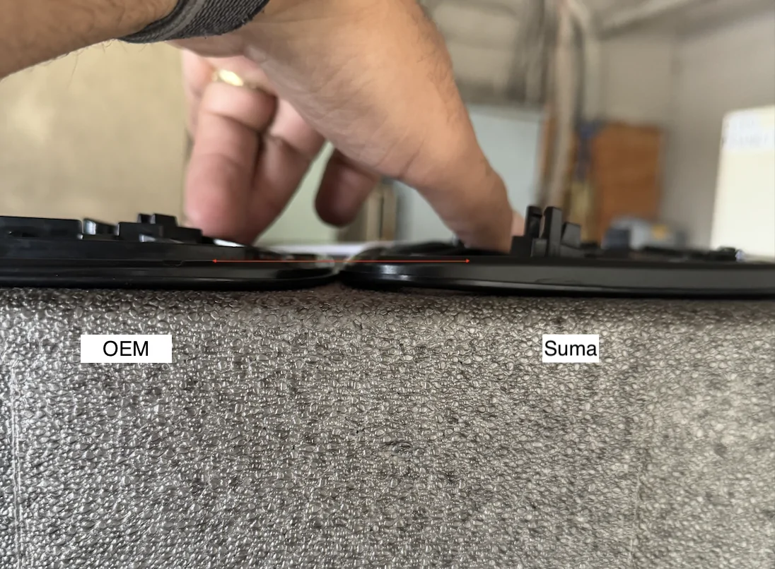

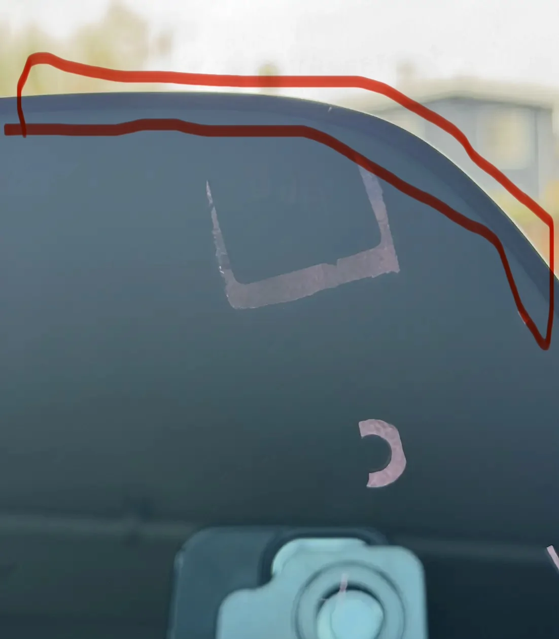

2. Less adjustment travel than OEM mirrors.
The main issue with these mirrors, which I’ll explain more below, is that the mirror frame is noticeably thicker than the OEM mirror frame. By itself that wouldn’t necessarily be a problem, but I believe it limits the adjustment travel quite a bit.​
Because of the thicker frame, the Suma mirror makes contact with the inner mirror housing much sooner than the OEM mirror does. This restriction seems to be the main reason the mirror can’t be angled outward enough and is a major contributor to the poor viewing angle.​
Below is a picture where you can hopefully see the height difference between the mirror frames.​
2024 Tacoma Suma Performance blind spot mirrors: think twice before buying Screenshot 2026-02-18 at 9.46.34 PM

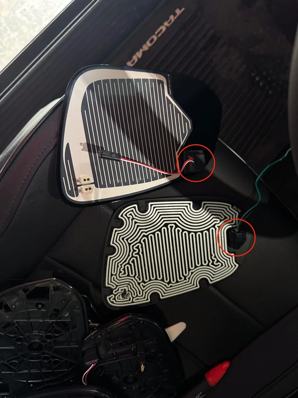

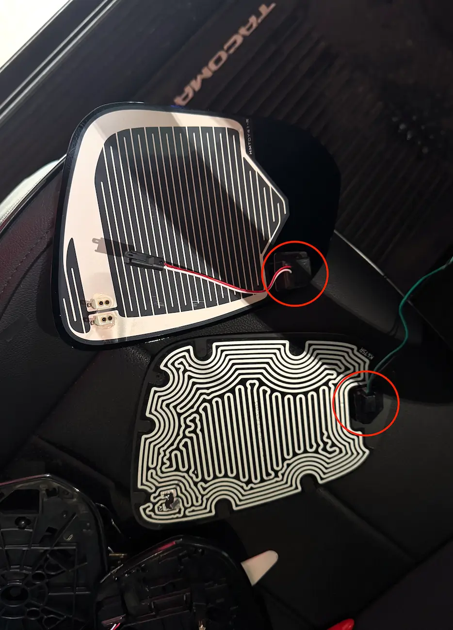

  • The heating element on the Suma's don't cover as much of the mirror as OEM
    2024 Tacoma Suma Performance blind spot mirrors: think twice before buying Screenshot 2026-02-18 at 9.59.08 PM
    My guess is that Suma uses the same heating element for mirrors with and without integrated turn signals to save money. If that’s the case thats a really crappy cost savings measure. Also the heating element on the Suma appears to be poorly adhered to the glass in some places and is bubbling up (see under the connection nub thing.)

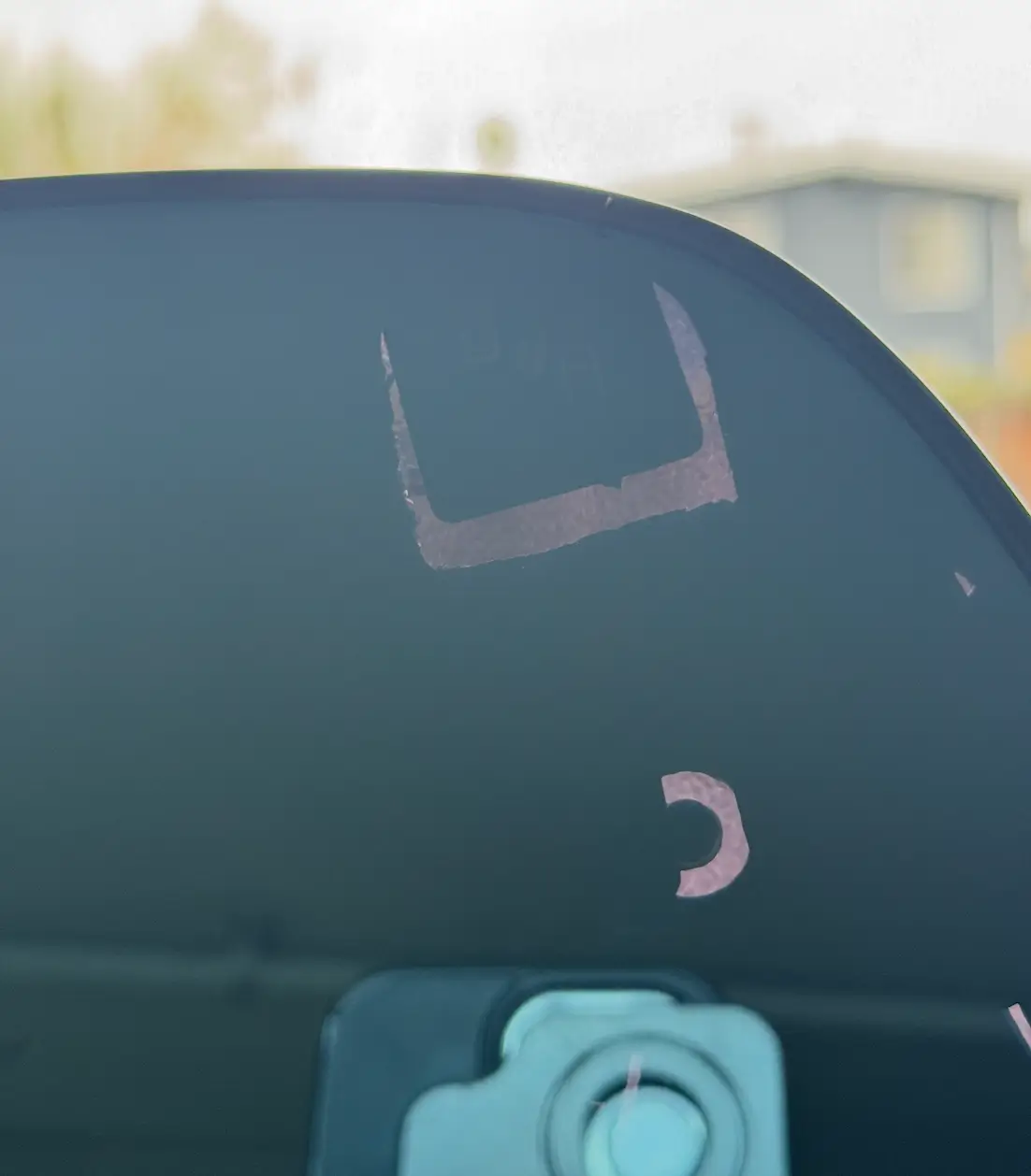

  • The Suma Mirror is translucent. (Picture bellow is with a modified mirror frame, not in installed into the mirror housing)
    2024 Tacoma Suma Performance blind spot mirrors: think twice before buying Screenshot 2026-02-18 at 10.14.26 PM
    The Suma mirror doesn’t have the typical gray backing that most mirrors have, including the OEM Tacoma mirrors. It almost looks like it just has a reflective tint applied to it. I didn’t try to scratch or pick at it to confirm because I didn’t want to damage it.
    I don’t think this would be an issue under normal use unless you modify the mirror frame like I did. That said, I do think there’s a chance light could get into the mirror housing at the right angle and mess with the image. This is just speculation. In the picture I’m intentionally holding it up to the light to exaggerate the effect.

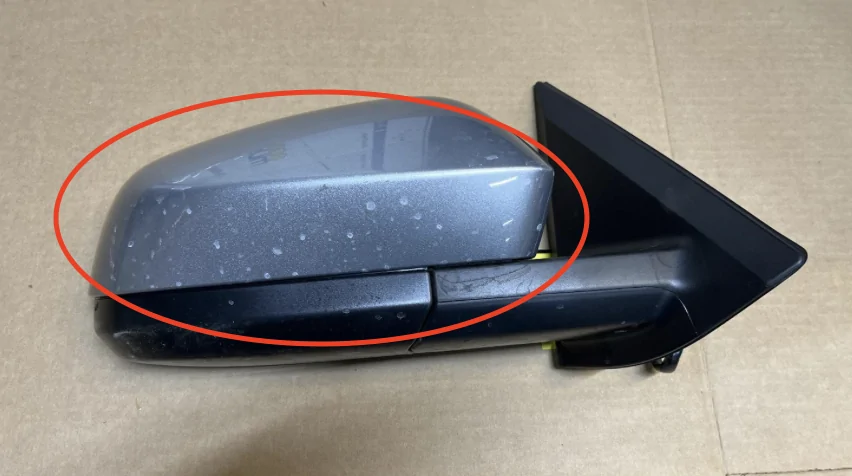

  • The plastic on the OEM mirror housing, shown circled below, is extremely fragile. I broke a couple of the retention clips removing the mirrors. That’s not Suma’s fault, but it’s definitely something to consider.
    2024 Tacoma Suma Performance blind spot mirrors: think twice before buying Screenshot 2026-02-18 at 10.33.19 PM

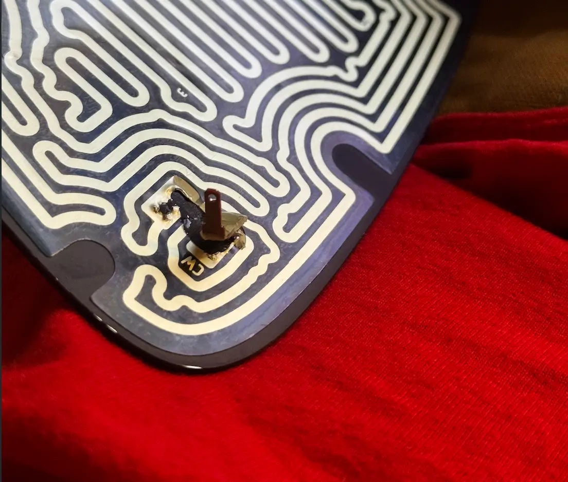

  • The heating element connections on the OEM mirrors are also very fragile. They’re only held on with silicone, and the OEM connectors are extremely tight. That makes them very difficult to remove without damaging the small metal nubs. Even on the second mirror, where I was being extra careful, I still damaged the nubs removing the connections, as shown below. Again, this isn’t Suma’s fault, but it’s something to be aware of.
    2024 Tacoma Suma Performance blind spot mirrors: think twice before buying Screenshot 2026-02-18 at 10.45.38 PM
    Overall, install results may vary, but there’s a real chance you could permanently damage the OEM mirrors, especially the heating elements. That’s the main reason I decided to continue with the Suma install instead of going back, since I didn’t want to reinstall damaged OEM mirrors.

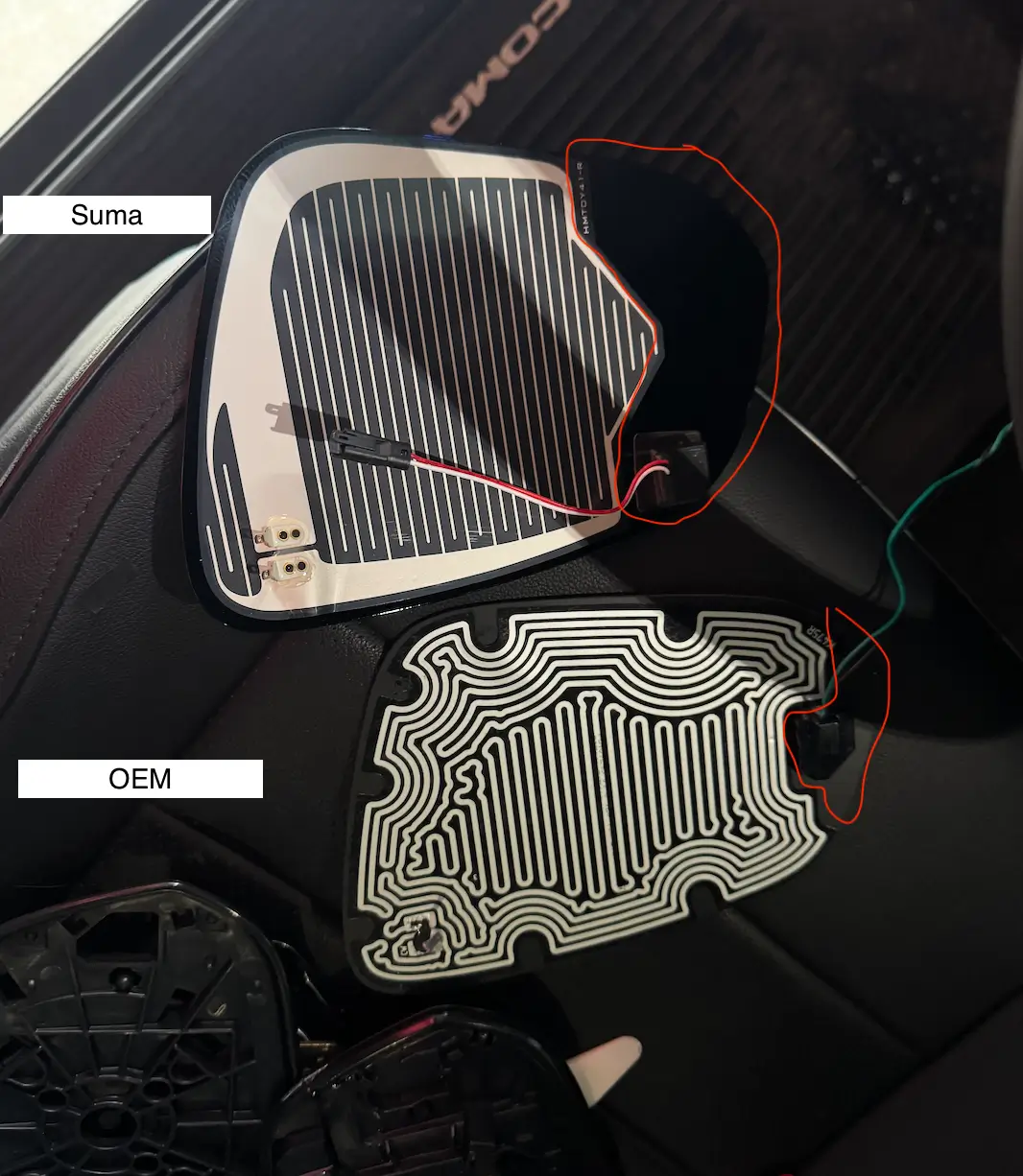

After damaging the OEM heating elements, I was basically committed to making the Suma mirrors work, since I didn’t want to reinstall damaged OEM mirrors. After inspecting both mirrors more closely, I suspected, correctly, that the poor viewing angle was caused by the thicker Suma frame limiting how far outward the mirror could adjust.
I removed the mirror glass from both frames and installed the Suma mirror into the OEM frame. This completely fixed the viewing angle issue, but there are some things to consider.
1. The OEM frame has to be permanently modified.
The blind spot monitor indicators are in different locations. To fit the Suma mirror into the OEM frame, you have to cut plastic out of the frame. It’s not difficult, but it is permanent.
I didn’t take pictures during the modification, and I don’t want to remove the mirrors again. You can still see in the picture below that the blind spot monitor lights are in different spots.
2024 Tacoma Suma Performance blind spot mirrors: think twice before buying Screenshot 2026-02-18 at 11.23.19 PM
The modification itself is straightforward, but you need to be careful removing the mirror from the frame. The OEM frame is much tighter than the Suma frame, and I actually shattered the first OEM mirror.
Lightly heating the frame with a hair dryer or heat gun might help. If you take your time and work around the edges slowly, it can be done.

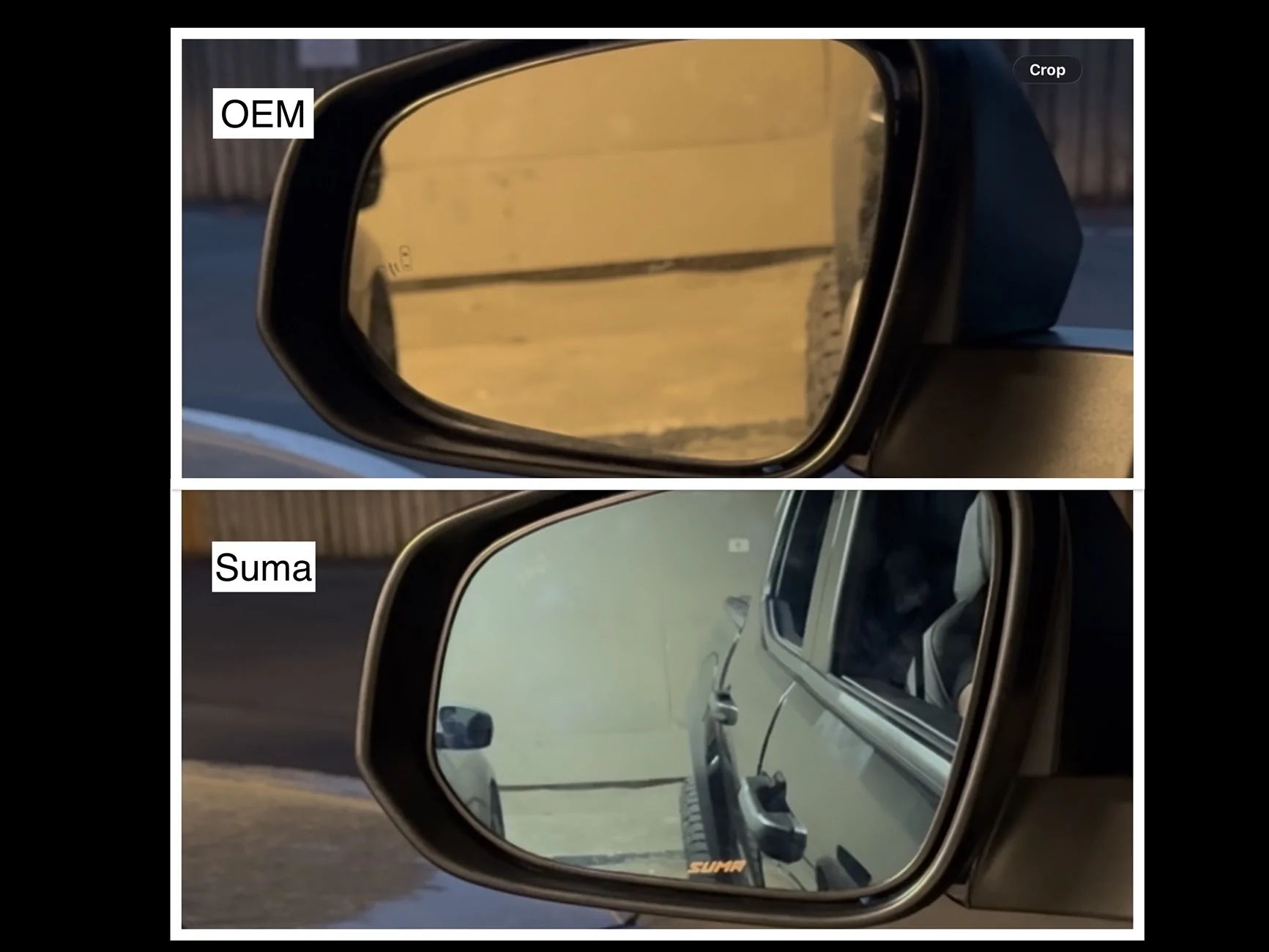

Final Results:
2024 Tacoma Suma Performance blind spot mirrors: think twice before buying collage2-2
As you can see, the Suma mirror installed in the OEM frame is vastly better in terms of actual usable view compared to how it ships from Suma.
The last photo was taken on a different day and in different lighting, but you can clearly see that the truck takes up much less space in the mirror than before. I wouldn’t compare the exact position of the vehicle next to me between photos since neither car is in the same exact spot. Just take my word for it that the modified setup lets the mirror angle much farther outward and actually provides a meaningful increase in field of view and blind spot visibility.
Final Results:

The translucency was caused by me altering the frame. I don’t think it would have been noticeable at all if I hadn’t messed with it. I was worried it would be an issue, but so far it hasn’t been.

It wouldn’t say it was super easy but it wasn’t super difficult either.
The biggest issues were working the mirror into the frame, I actually broke the OEM mirror frame but I was able to epoxy it back together where it cracked without any problems
you also have to cut out a small portion of the frame as the heating element connections are in different spots but that’s easy.
I don’t know what adhesive you’re referring to I don’t think I made any mention of adhesive besides where the SUMA might have failed. Besides epoxying the cracked frame I didn’t use any adhesives.
Thank you! I am clumsy so trying to get a local shop to help me do the swap.
I know there was not mention of adhesive, just thought that it may require some glue to secure the mirror…

No there’s no glue necessary.
if you’re talking about the thin black plastic frame that holds the actual mirror glass. The frame has a lip that goes around the mirror glass and secures it in place. That goes for both the mirror frames, the OEM and Sumas. That’s the “difficult” part as you have to try to wedge the glass into the frame and past the lip. See the pic to see the lip that I’m referring to. You have to be careful with this part because you could easily brake the glass if you try to force it. You could probably heat the lip and fit it in much easier since it’s just plastic.
2024 Tacoma Suma Performance blind spot mirrors: think twice before buying IMG_5771
The mirror is then held in the housing with plastic tabs/clips.
From what I can tell the 4th gen Tacoma mirrors are the same as the 3rd gen. You might be able to find more videos about the 3rd gen mirrors than the 4th gen.
Appreciate the feedback! I have a 2025 Toyota 4Runner TRD Pro, used to have a 2017 Toyota Tacoma TRD Pro. Not sure how that affects the install but I imagine it’s the same size as the tacos….

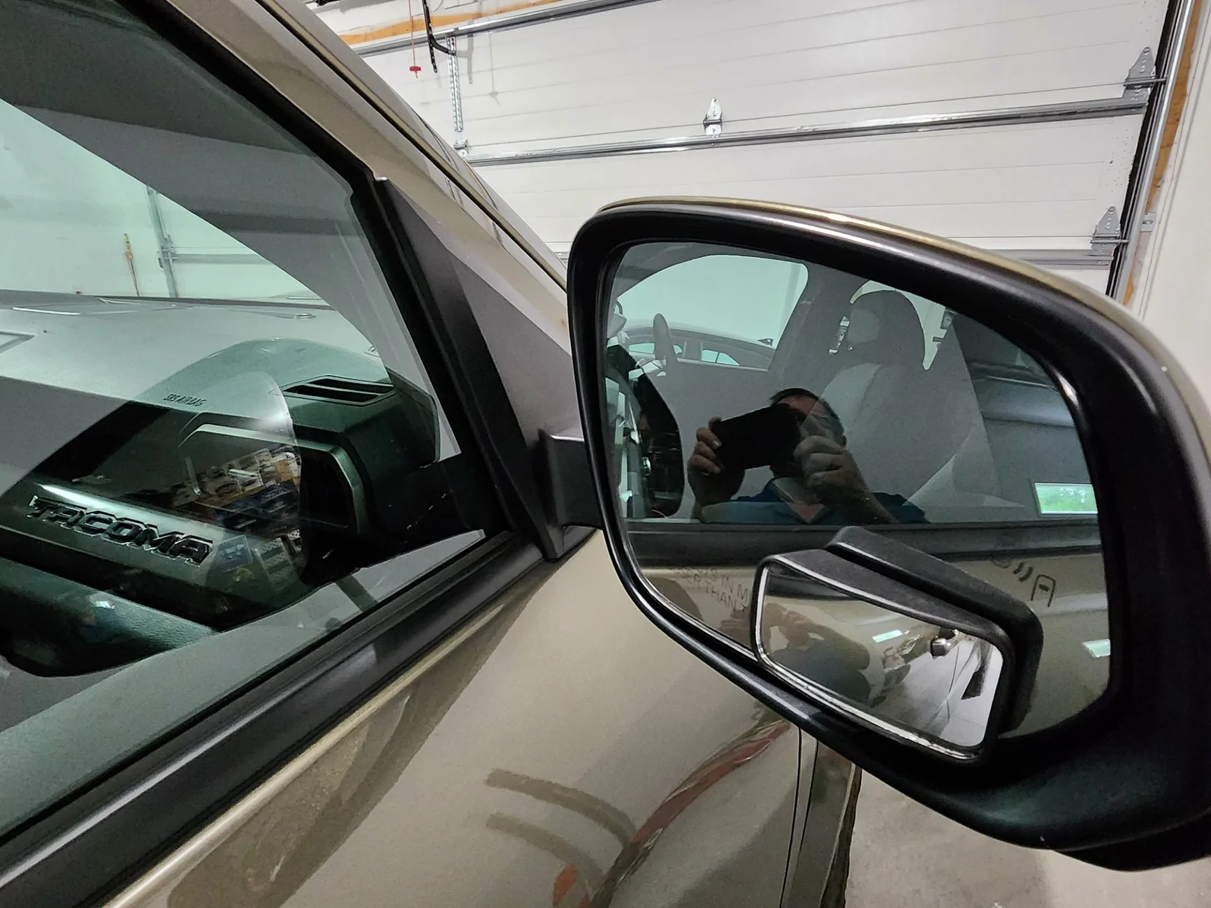

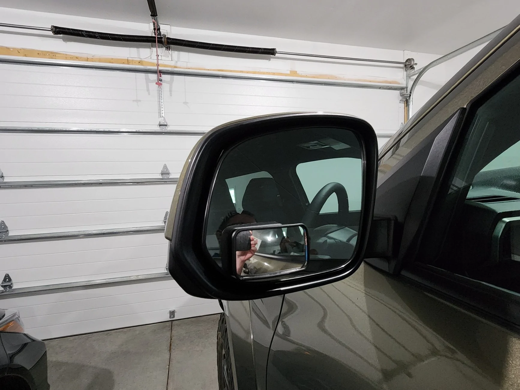

My under $5 blind spot mirror solution.
Works great at highway speeds and are the only mirrors I use at speed. The rest is only used for backing up.
My old 2010 SR5, I broke the passenger side mirror off but still had the skeleton arm. Solution for about a year before I finally fixed it was just slap one of those blind spot mirrors on it. I had the full aluminum topper and it worked fine at highway speeds no issues.
2024 Tacoma Suma Performance blind spot mirrors: think twice before buying thumbnail_20240524_123016
2024 Tacoma Suma Performance blind spot mirrors: think twice before buying thumbnail_20240524_123040
2024 Tacoma Suma Performance blind spot mirrors: think twice before buying DSCN0411_zps2e720e92
