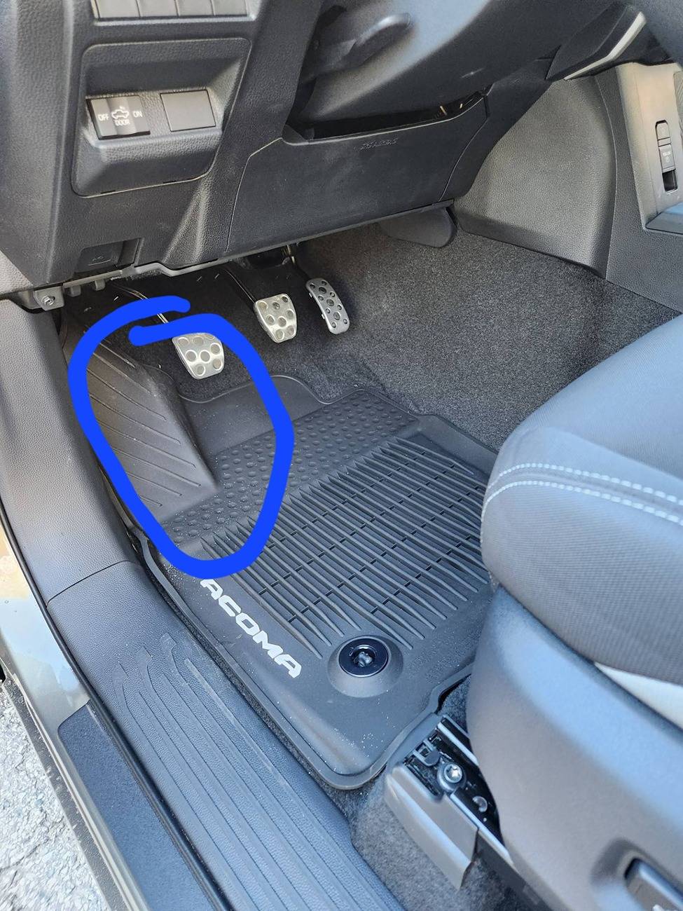

Hey y’all,
I’ve got a 2025 Tacoma TRD Sport (6-speed manual), and I’m running into a bit of a safety concern with the OEM all-weather floor mats. Every so often, especially when I press the clutch all the way down, the edge of the mat gets caught on the clutch pedal and doesn't let it come fully back up right away. It’s not constant, but it happens just enough to be annoying — and honestly kind of dangerous.
I double-checked to make sure the mats are clipped in properly with the retention hooks and not sliding around. They are locked in place, but it seems like the front edge is just a little too high or stiff, and it catches when the pedal is fully depressed.
Anyone else having this issue?
Did you trim the mat?
2024 Tacoma ⚠️ All-Weather Floor Mats Catching on Clutch Pedal in My 2025 Tacoma TRD Sport thumbnail_20240413_084200

Are the mats you have specific to the manual trans? I think I remember something from last year about the dead pedal being a different width.

My 2 pedal mats are quite different from your 3 pedal mats.

it looks like you have the mat meant for automatic trans, the mats for the manuals have a skinnier face near the clutch.
@Dansflhti - canada mats are nicer and beefier
I use the oem mats in the summer and husky exact contour in the winter . The oem and husky are very similar flexible rubber.

I have a six speed manual and the mats are different. I would assume most dealers only stock the mats for the automatic. I am using Lasfit, no issues.
