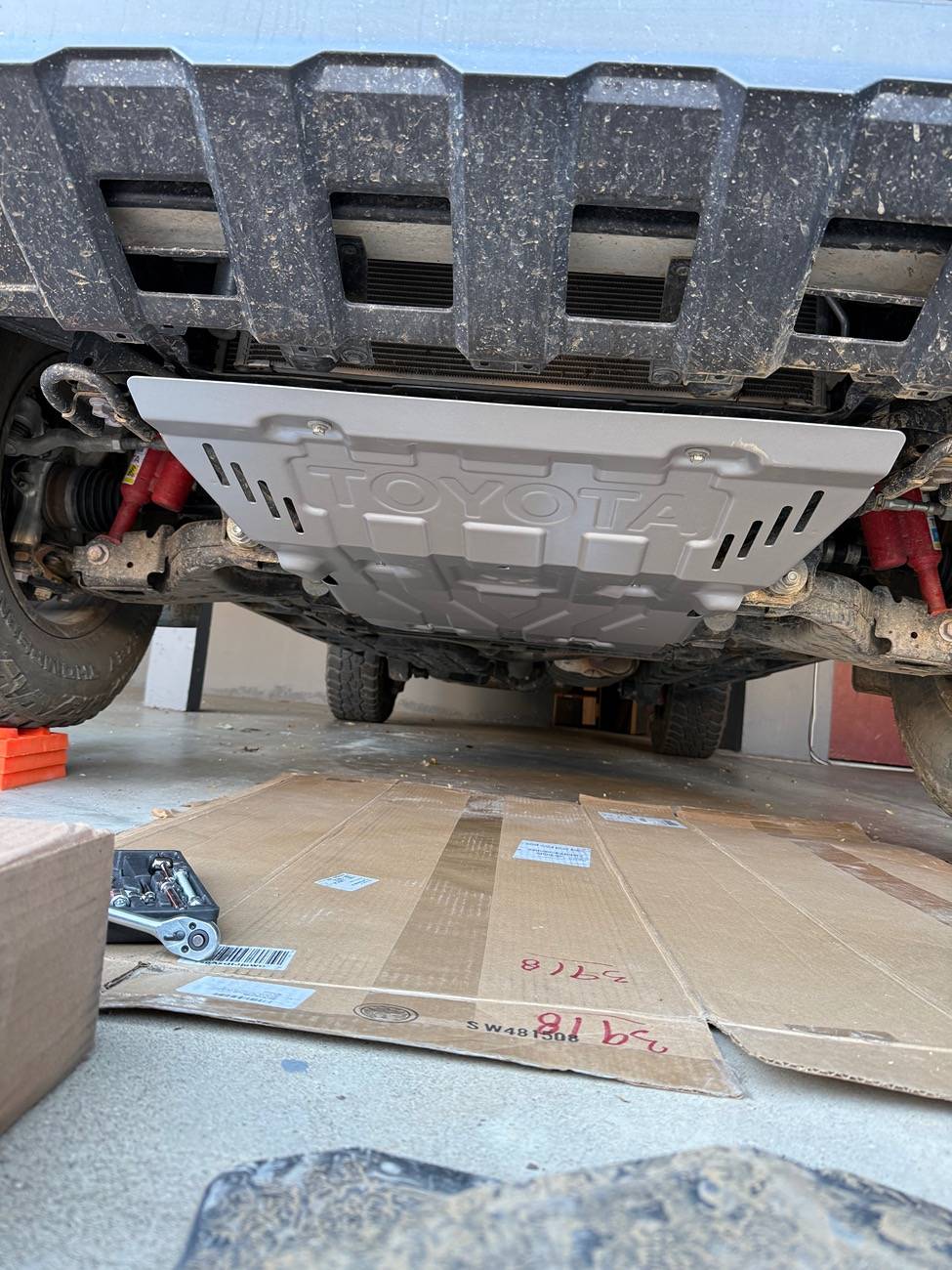

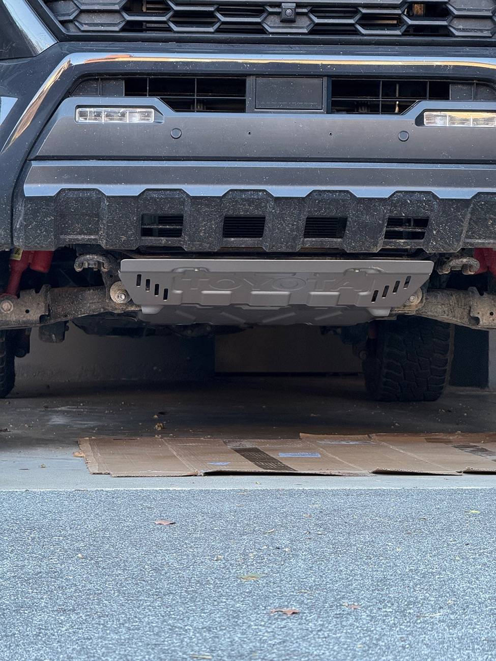

So the front skids of the land cruiser 250 fit the Tacoma off-road pretty dead on. It’s basically identical to the trailhunter skids, except it’s stamped Toyota rather than trailhunter.
Part name / number: Toyota 2024 + Land Cruiser Front Skid Plate - Toyota (PT228-60242)

Looks great! I much prefer this one over the Trailhunter skid plate.

Instagram, FB, you name it! Lol. I don't mind the trailhunter I just like the TOYOTA one better!

Does the Land Cruiser also have the center transmission skid plate or can you tell if the center transmission skid plate from the Trailhunter will work with the Land Cruiser front skid plate?

Want me to snap a shot under my 24' land cruiser so you can see what's stock under mine. I have the Land Cruiser - "Land Cruiser" model (yeah toyota got really original naming this middle model) not the "First Edition" model though.

OP is your truck a hybrid or no? Curious whether fitment is the same on non-hybrid models

Sure, if you don't mind a get a chance. That would be great. Thanks. I am looking to add these skid plates to my Tacoma and prefer the "Toyota" stamp for the front versus the "Trailhunter". It would be nice to verify the transmission plate is the same or not.
I only tested the front skid. The trans skid plate is from the trailhunter.
so mine is non hybrid. But considering that the land cruiser is hybrid, front skid should fit. Not sure if the sway bar disconnect would change that though.
as for the trans skid plate, it’s from the trailhunter, which is hybrid.
yeah gimme a couple days. I'll grab cardboard at work to lay on when I get underneath my vehicle.

Front skid plates are the same, just stamped with different words. Transmission skid plates differ between hybrid and conventional. I have a conventional, but the parts guy gave me the part number for a hybrid. Now I'm stuck with a $325 skid plate that doesn't fit my truck. Anybody wanna buy the behemoth?
