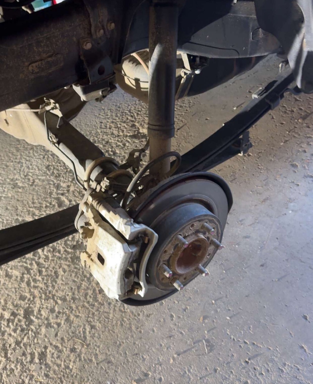

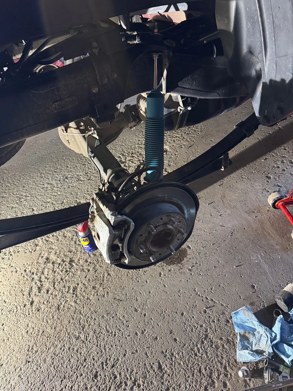

I love my SR with the 6 speed manual, however I felt the rear took bumps mouch rougher than I would like. Although it wasn't the end of the world, I wanted to find better shocks if I could. All listings for shocks online say that the coil shocks won't work on the leaf setup in my truck, however after looking at the shocks for both trucks I thought otherwise. After I cross referenced part numbers online I was sure enough they were the same, so I decided to take a bit of a gamble and bought $200 trd offroad bilsteins on ebay.
I got them in and the ride is so much more stable, my truck feels planted to the ground and the handling is way better.
2024 Tacoma PSA: Tacomas with leaf springs and coils share the same shocks - TRD Offroad shocks installed on SR! befor
2024 Tacoma PSA: Tacomas with leaf springs and coils share the same shocks - TRD Offroad shocks installed on SR! after
What part #'s did you use? I have an Xtracab SR5 that is a bit bouncy in the back end and would love to smooth it out.

Did you change the front also or just the rears ?

Just the rears, the ride quality isn’t night and day but it’s a bit better. I wouldn’t recommend changing it just for ride quality (I personally think it’s pretty good as is) but more if you feel the truck is unsettled over bumps.

Is yours 4WD? I can find rear shocks for 2WD with leaf springs, and 4WD with coil springs, but nothing for 4WD with leaf springs which is what I have.
The take offs were on a 4x4. The rears are the same 4x2 or 4x4.
