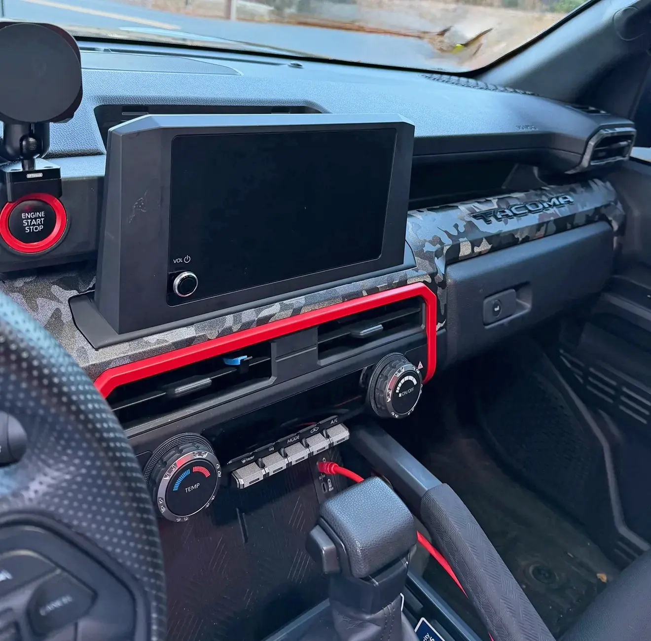

How did you wrap this? Disassembled? Stick it on cut away the excess? Where’d you get the wrap?
underground_weaz
Aug 13, 2025
58
Georgia
I used vinyl wrap from Vvivid, you can get precut rolls (1’x 5’) for around $20 with tax and shipping. I ordered a vinyl wrap kit on Amazon that had a couple of craft razor blades, knifeless tape, squeegees, etc. Also need a heat gun or can use a hair dryer but recommend heat gun.
I used some trim removal tools, everything is easy to remove except the large trim piece with the ā€œTacomaā€ lettering. You have to remove the radio head unit first (4-10mm bolts). Just be gentle and don’t force anything out so you don’t break any tabs.
After that? Slow and steady wins the race. Watch a few YouTube videos about vinyl wrapping and take your time
