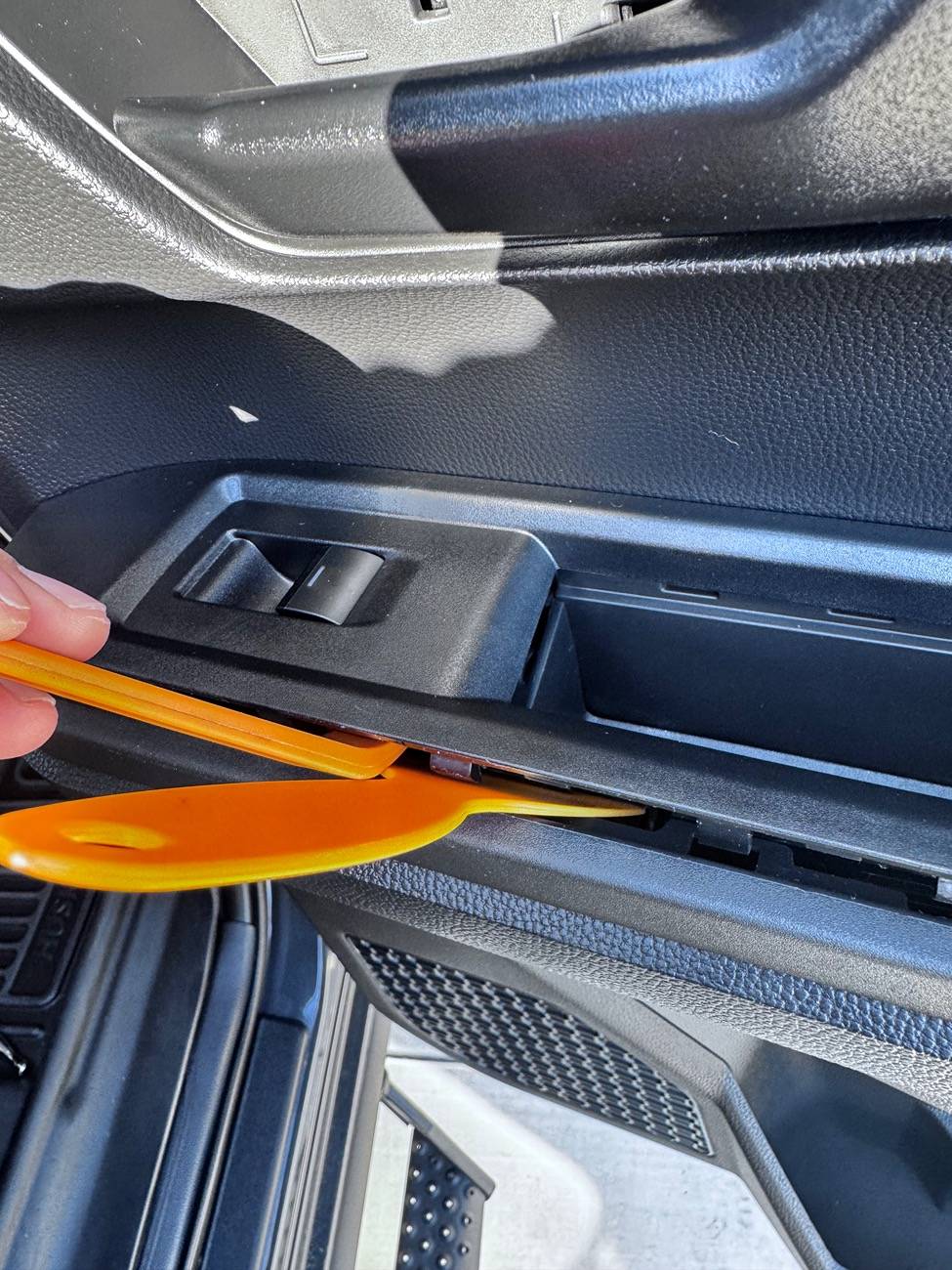

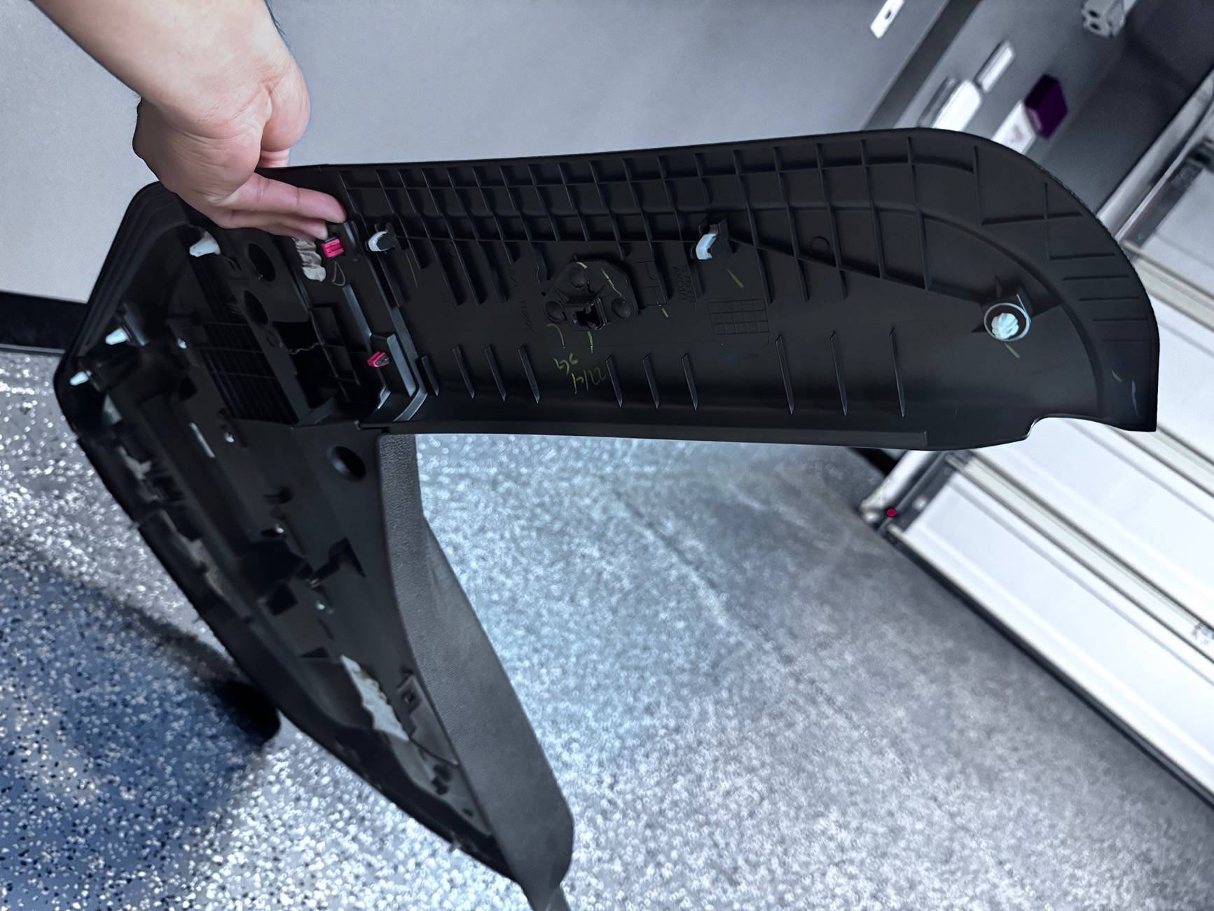

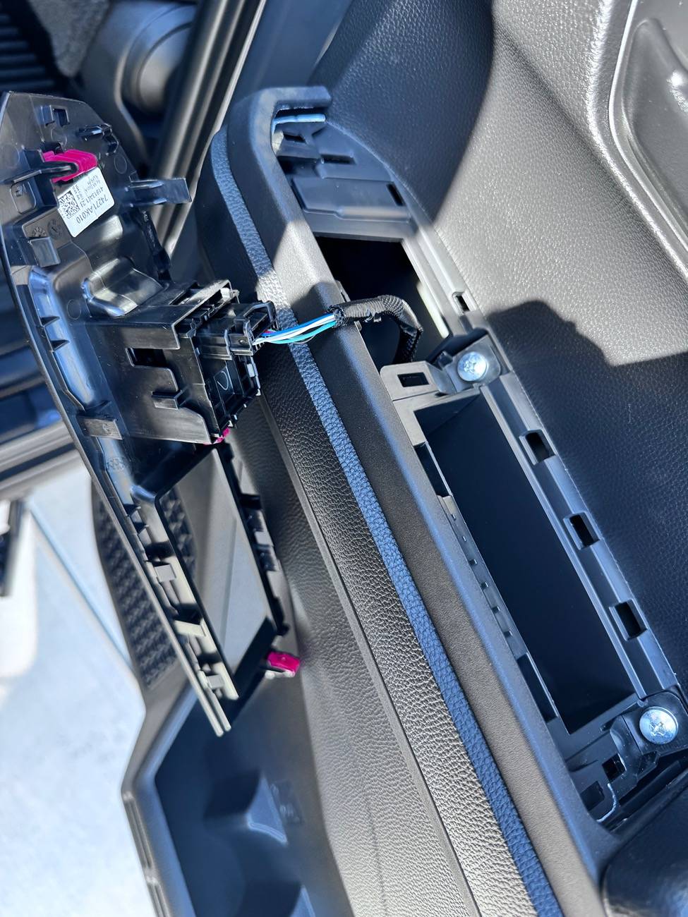

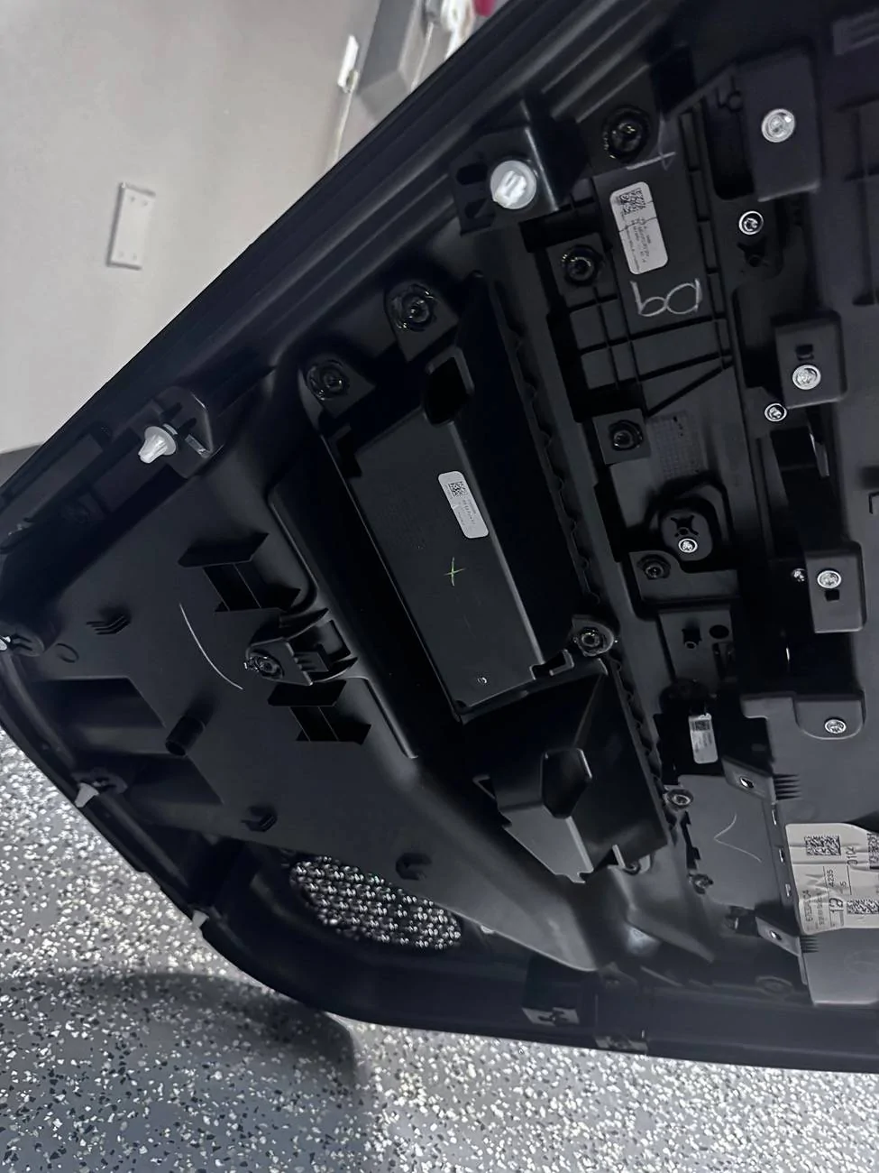

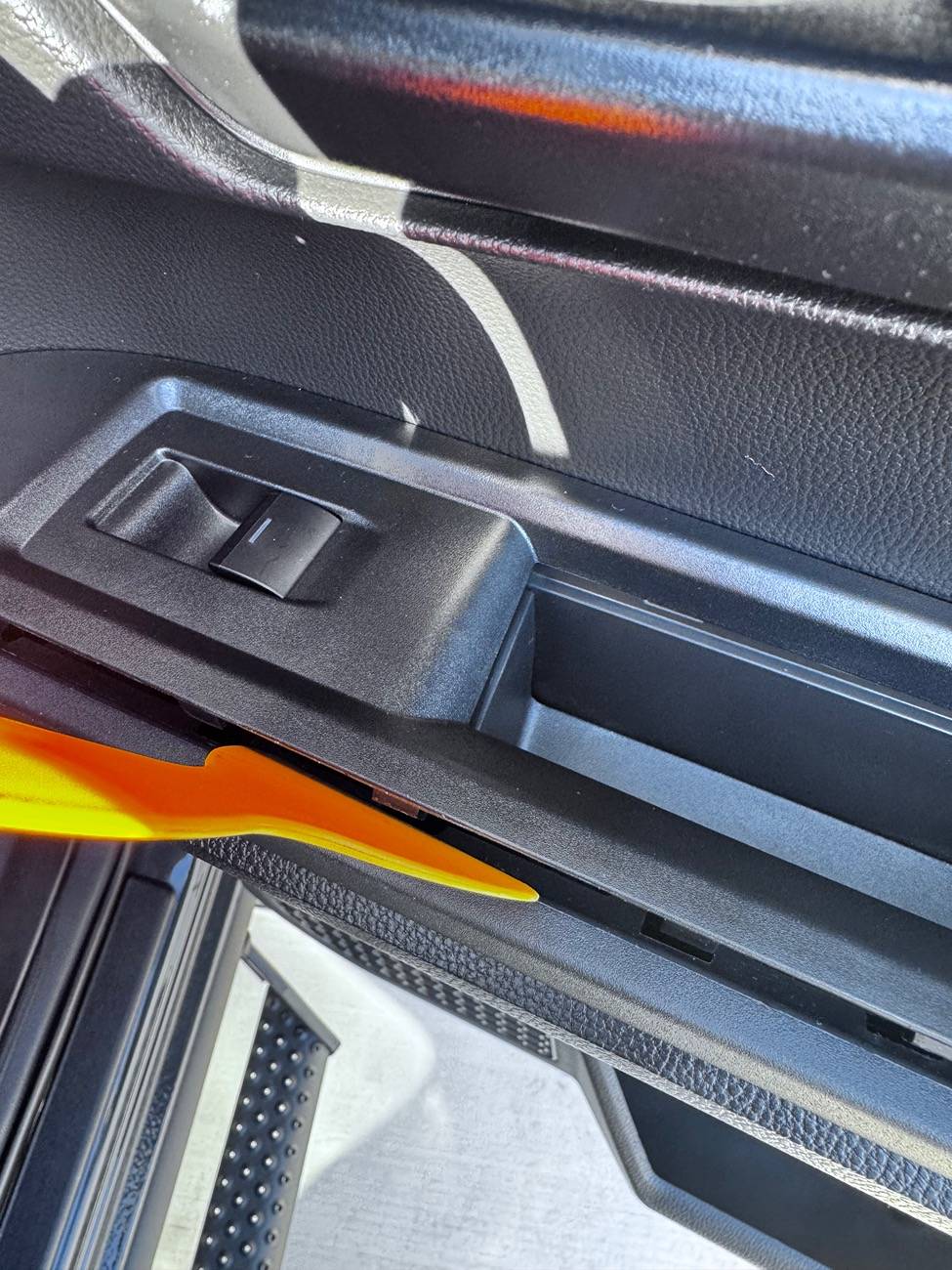

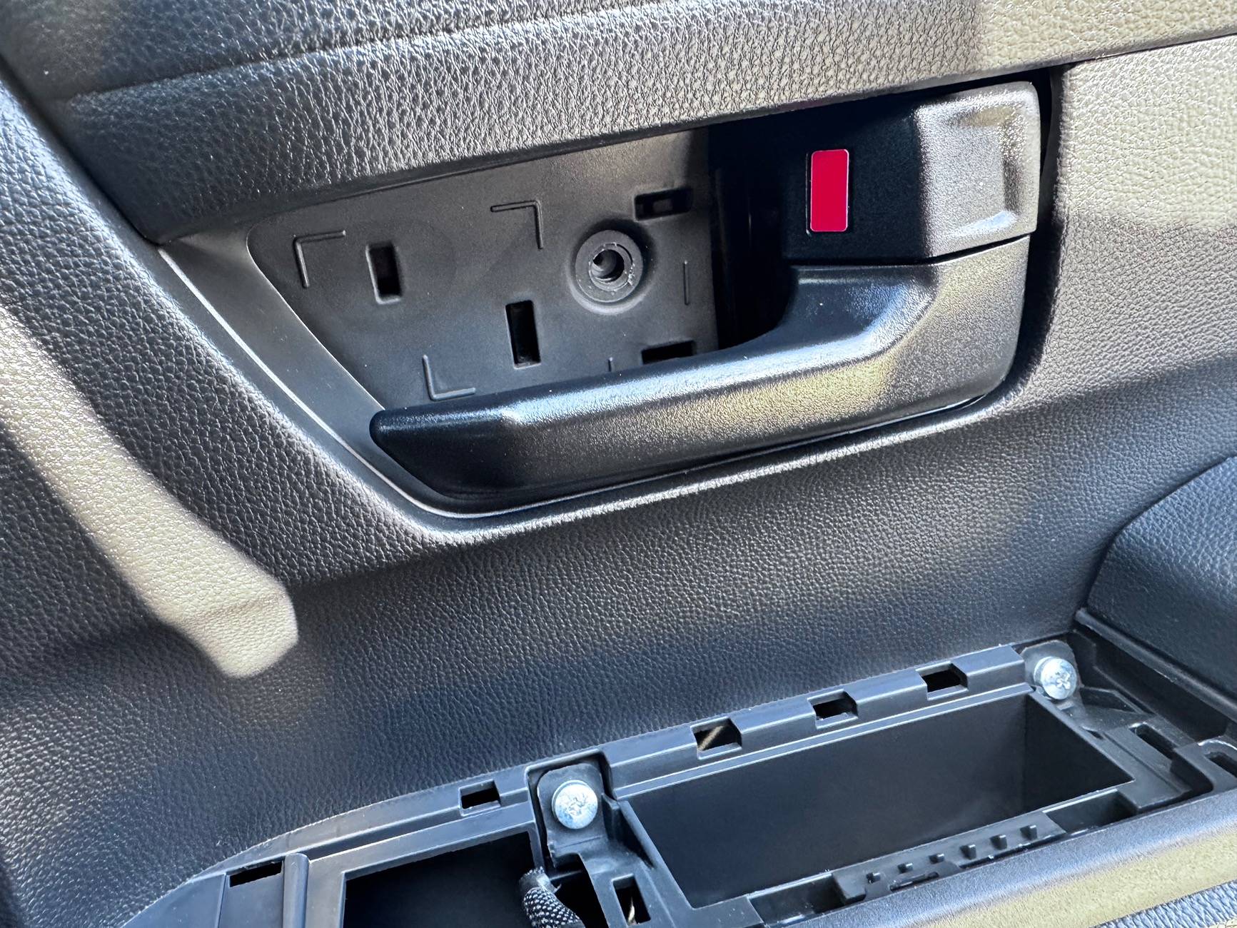

Hello! First time posting anything in any forum, but I had zero success trying to find out how to do this elsewhere until I did it myself. 90% of the removal is push clips similar to the front door panel which are easy to pry off. The door handle plastic cover is just the same as well. Only tricky part is the window control switch which requires a thin pry tool and a secondary to shimmy in and pry upwards. I started from a bit off of the middle like in the photo and pry upwards/ inwards. The rest is easy once the first clip is off (just keep repeating the process until the furthest left side). Hope this helps anyone for any speaker upgrade or sound deadening install :):beer:

The back panel’s accent pieces don’t slide out. The way to remove the rear the back door panel is removing 3 screws shown in pictures and everything else you just pry off, staring with the trim next to the window.
