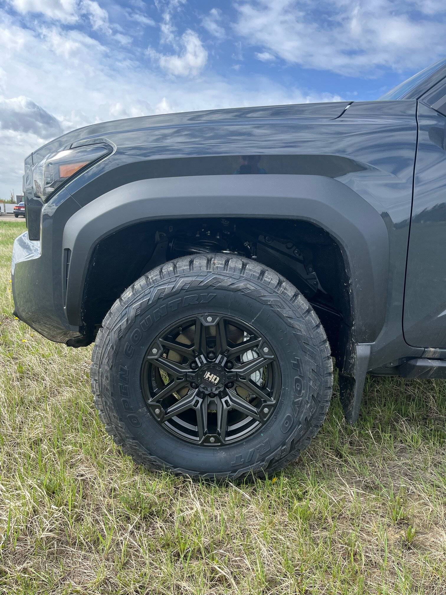

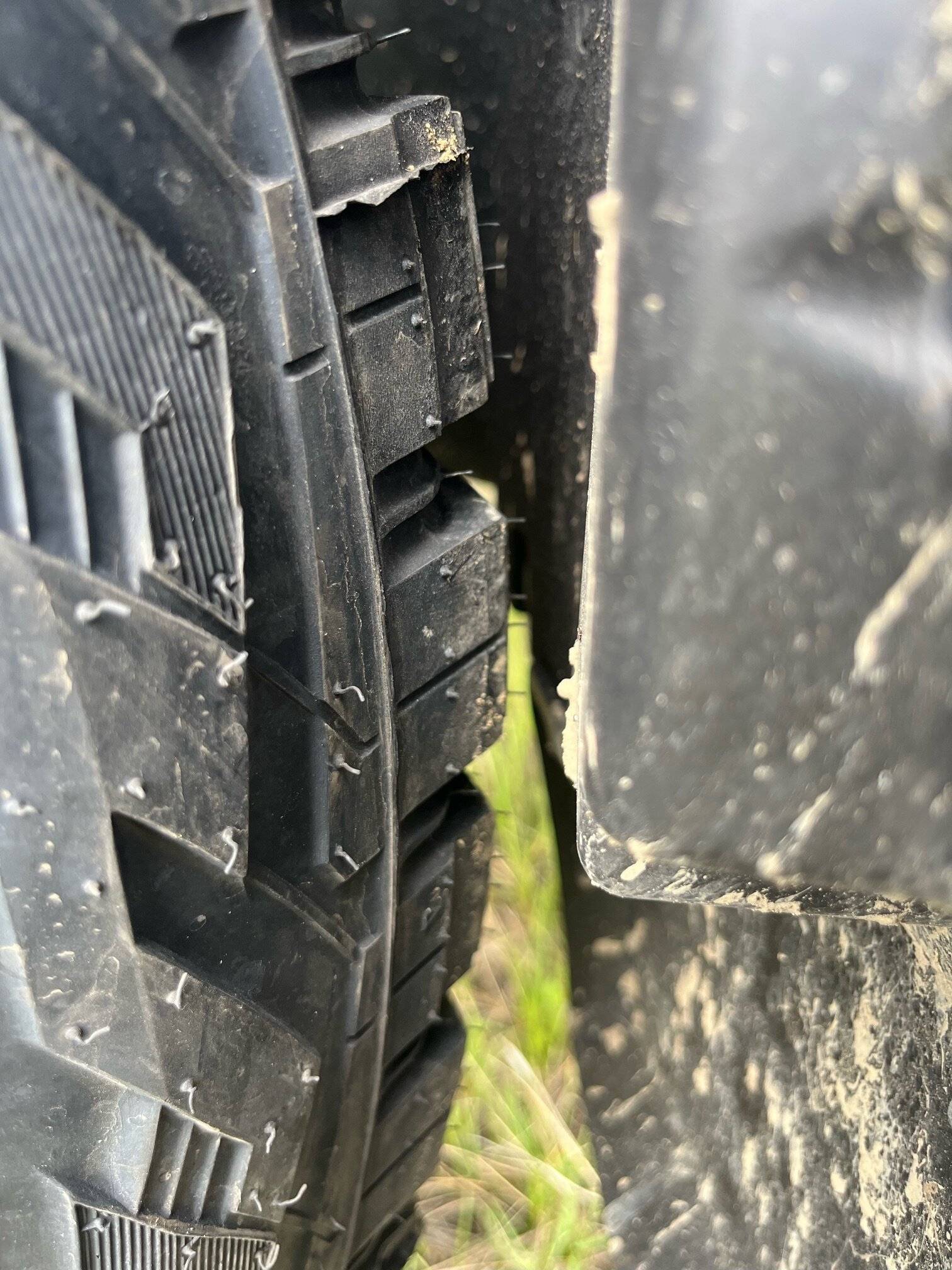

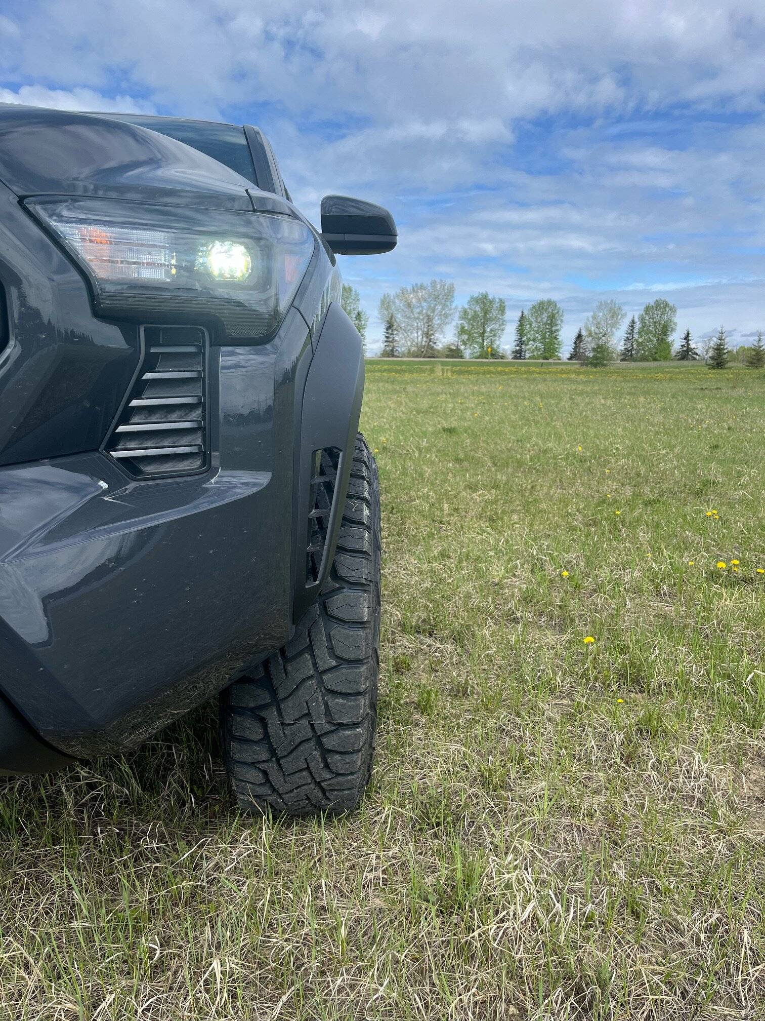

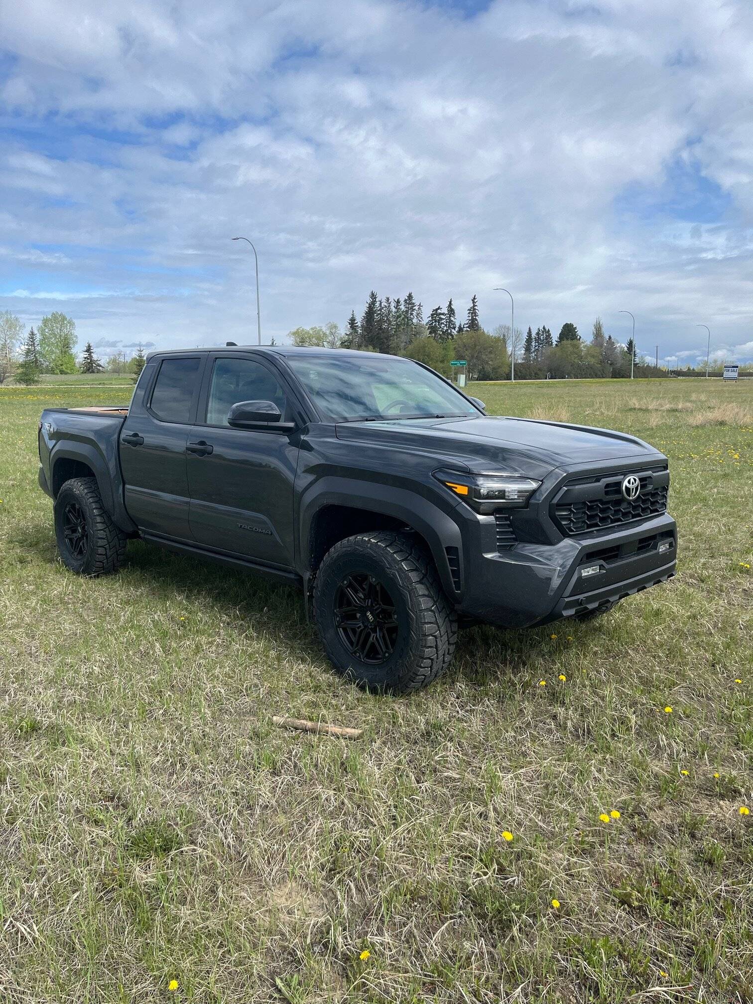

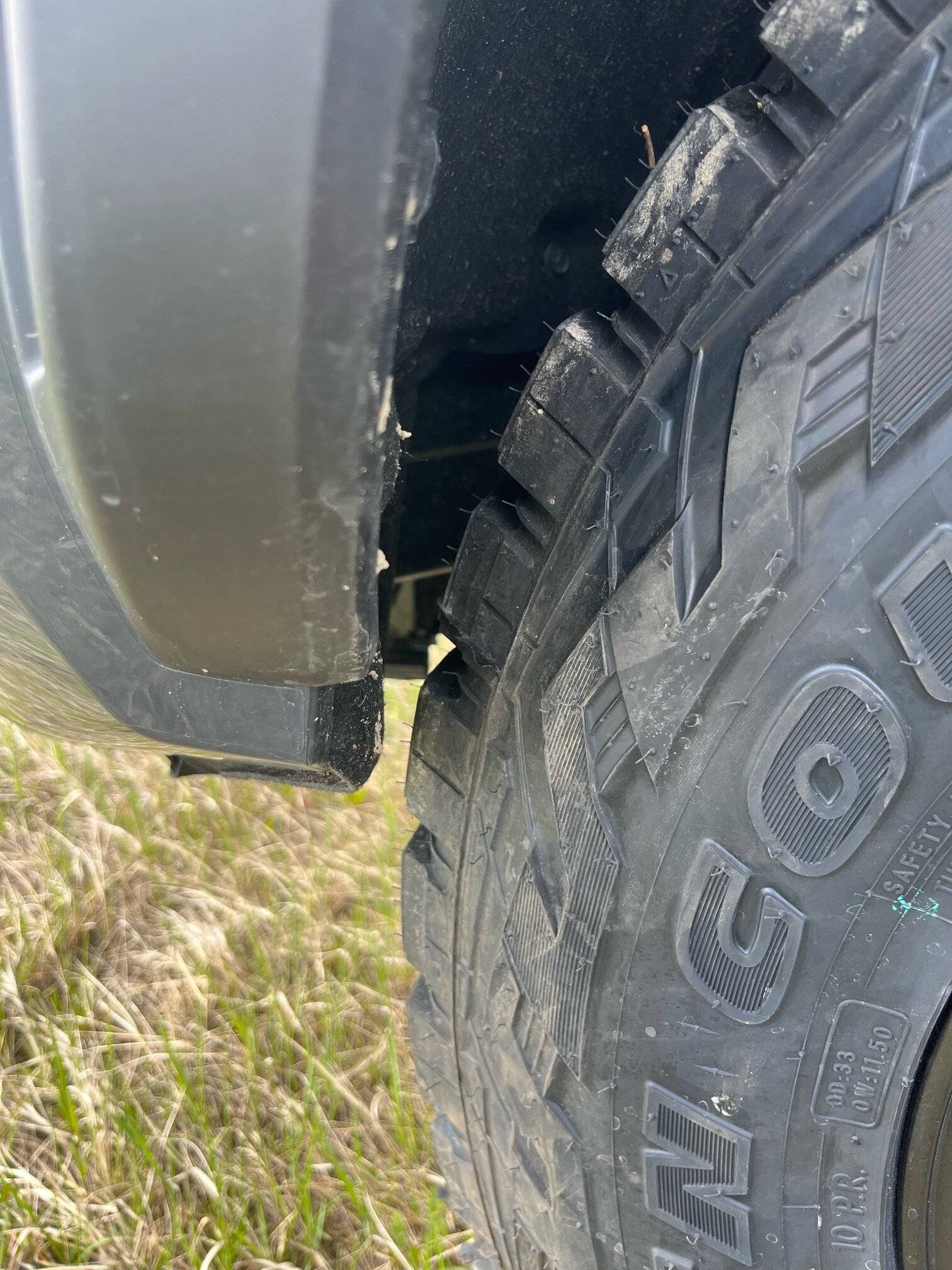

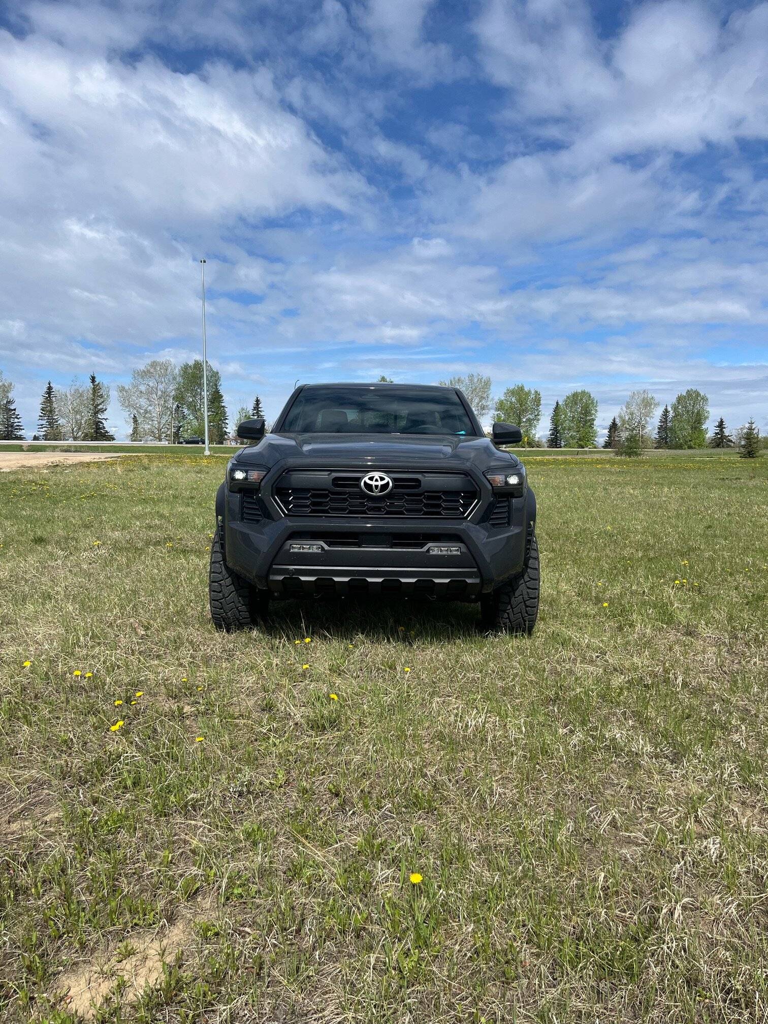

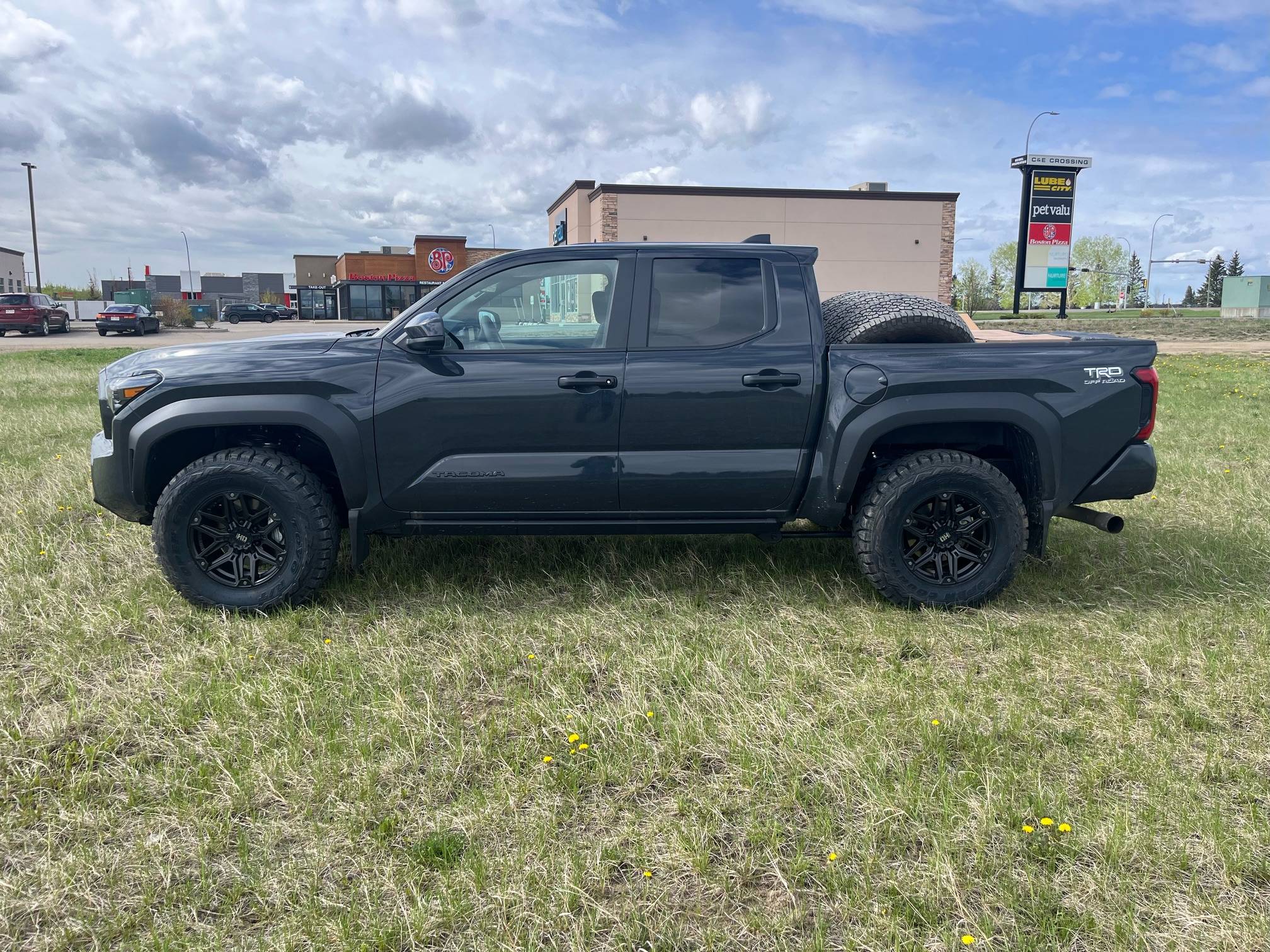

Fast HD Recon 17x8, +20 offset, 95.1 hub, weighing in at 24.8 lbs. Wrapped them in Toyo Open Country R/T tires 285/70r17. No rub at full steering lock or ripping through a very bumpy field by my place. Very happy with the setup so far and looking forward to getting it dirty on some real trails once work settles down next week.
Truck is completely stock, I was thinking of levelling it, but after seeing how it sits with the stock wheels and tires in the bed (which is probably around 250lbs) I intend to keep the suspension stock for the time being. I’m sure it will be very capable off road as is.
Fuel economy took a bit of a hit. I was running around 20.5 mpg combined city/highway, now I’m probably around 17.5. This is with the 6MT.
Nice! I actually like the looks of these. Glad to see something other than Method put on a new vehicle.

Don’t get me wrong, I love the functionality of the Method bead grip, but yeah, it seems they’re already overdone. A couple reasons swayed me over to these Fast HDs.
1. Hubcentric
2. Narrower and lighter
3. Looks
4. Slightly better price here in Canada.

Your truck looks great .... Same four reasons here ... I never looked at Fast wheels but need to look into them now ... thanks

I used this tool https://www.customwheeloffset.com/tire-wheel-backspacing-offset-calculators quite a bit when I was shopping for wheels. By the calculations my wheels are out 1.59ā€ further than stock resulting just slightly more poke than I was hoping, but given the chance I’d still go with these wheels again over the 17x8 +35 Black Rhino Stadiums I was considering.
The Fast HD Recon 18x9 +10 would be 2.46ā€ further out than stock, or 0.87ā€ more than mine, which I agree with you, would be too much poke.
