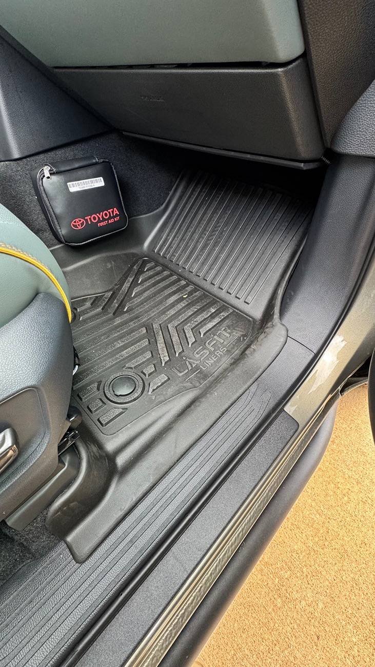

This is what I’ve done so far.
-ScreenProTech screen protectors
-Lasfit mats

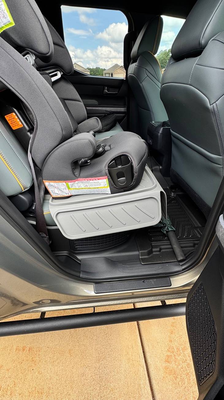

-WeatherTech car seat seat protector

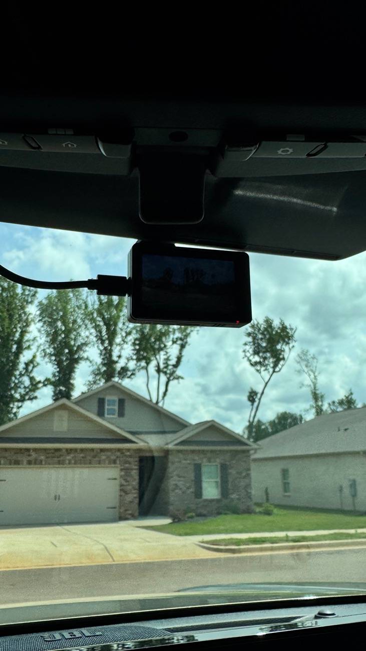

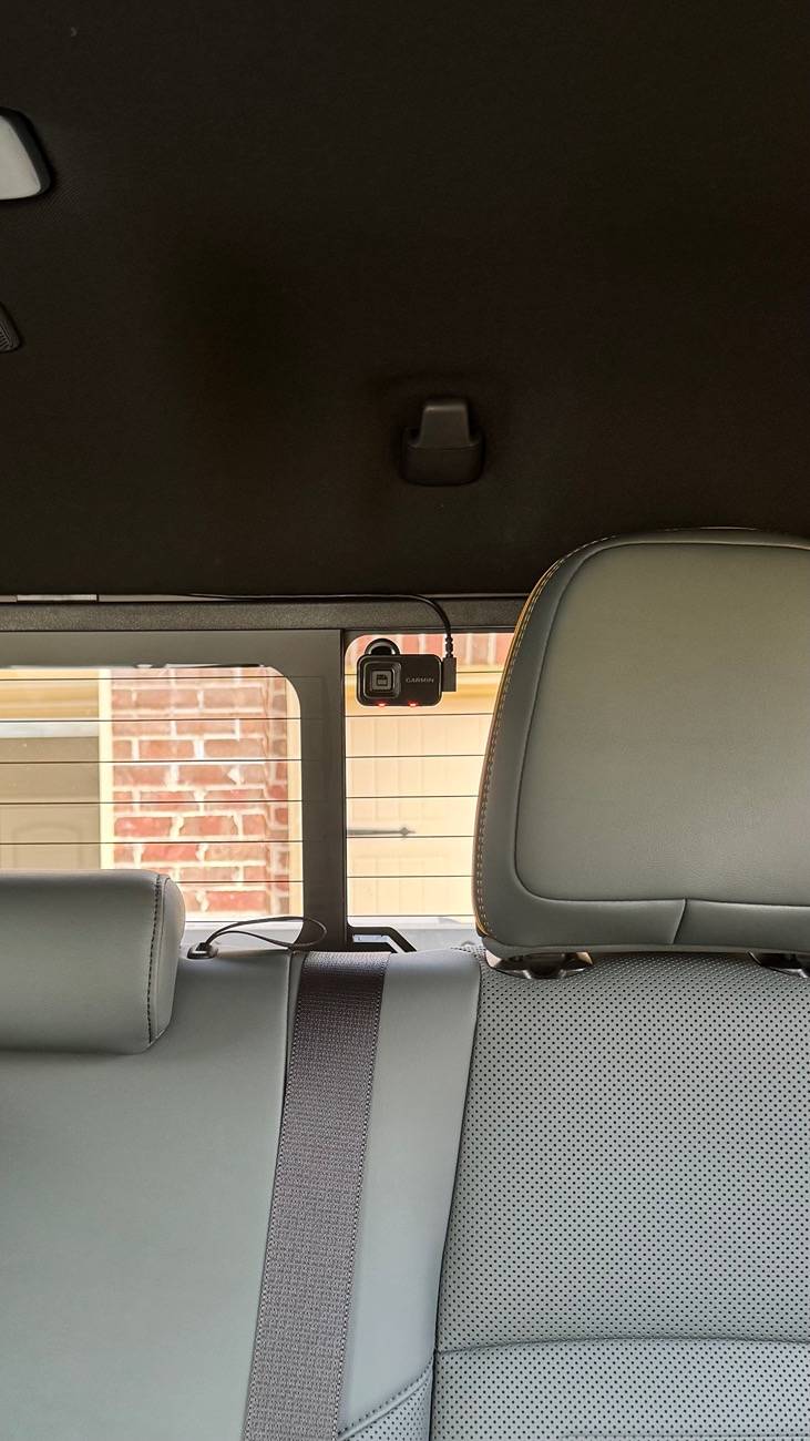

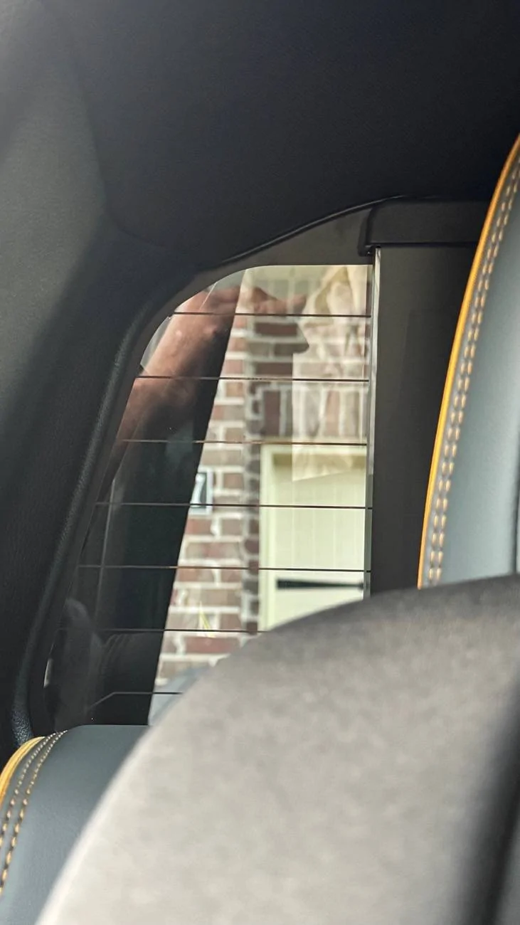

-Front and rear Garmin dashcams front with Dongar tech adapter and rear is hardwired into fuse box.

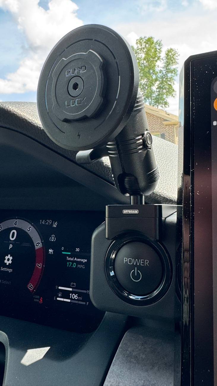

-Quadlock case and wireless charger on an Offroam mount with Tackform 20mm ball adapter made for Quadlock mounts and 2”20mm arm.

Looking good! Do you have a link for that phone mount? I've been looking for a good spot. How is it attached to the console? Thx

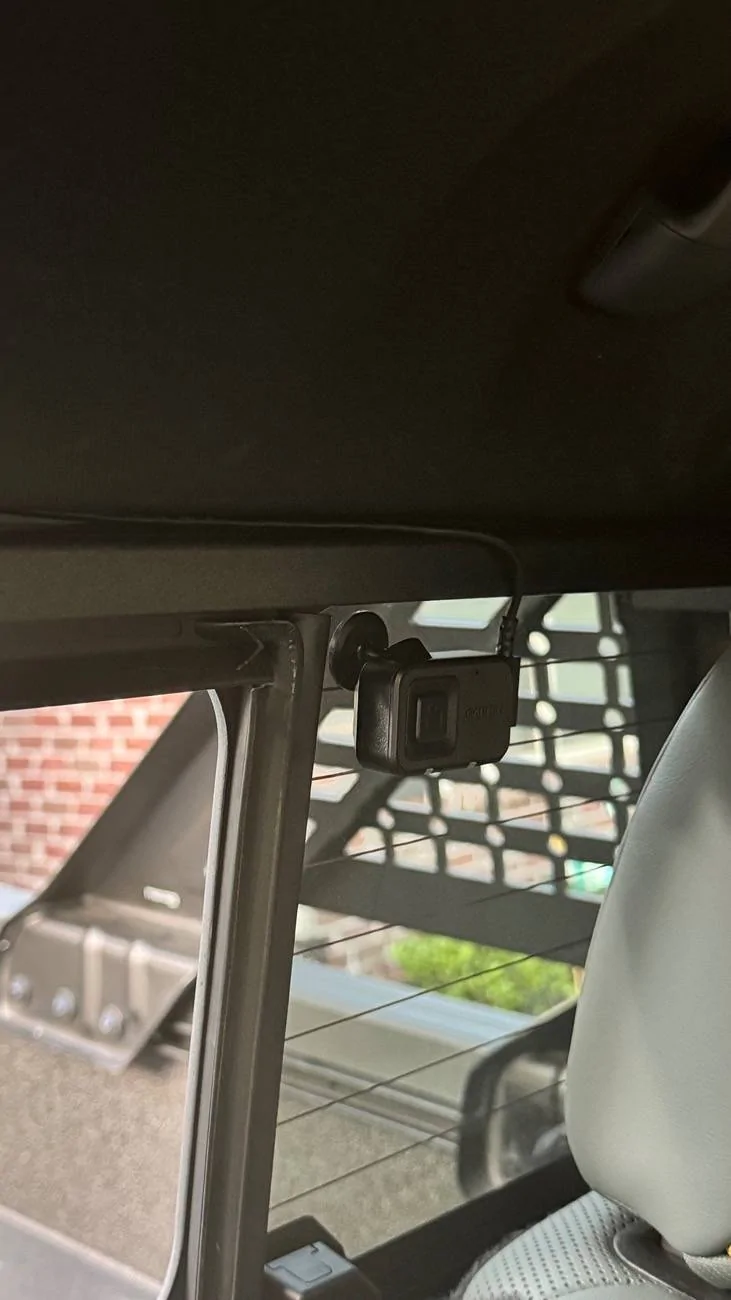

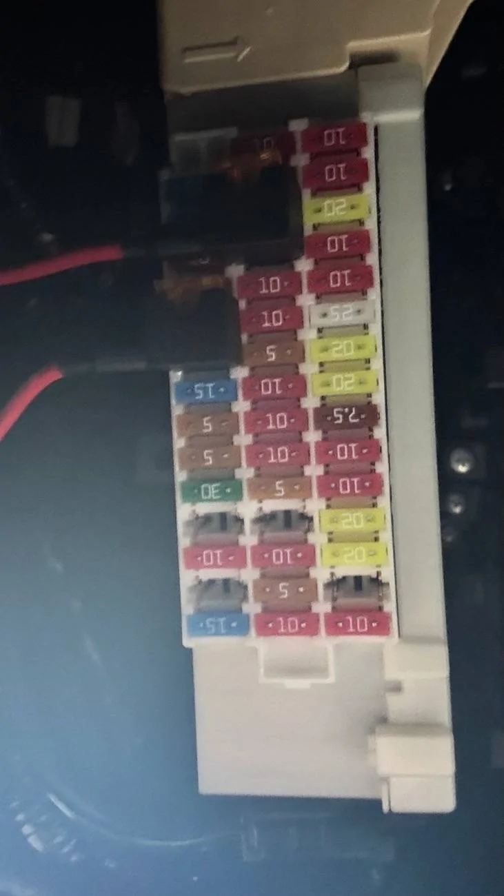

Where did you pick up the fuse box and how did you run the wire for the rear dashcam? Nice work!
so for this issue, I considered dropping the headliner and running the wires straight to the fuse box; It’s what I did on my 4Runner. Easiest cable management by far but super time consuming.
Instead, I did what everyone does and ran the cable ticking and hiding where I could, along the rear window, down the C pillar, under the sill or kick panel (I forget what it’s called), all the way up to the passenger fuse box.

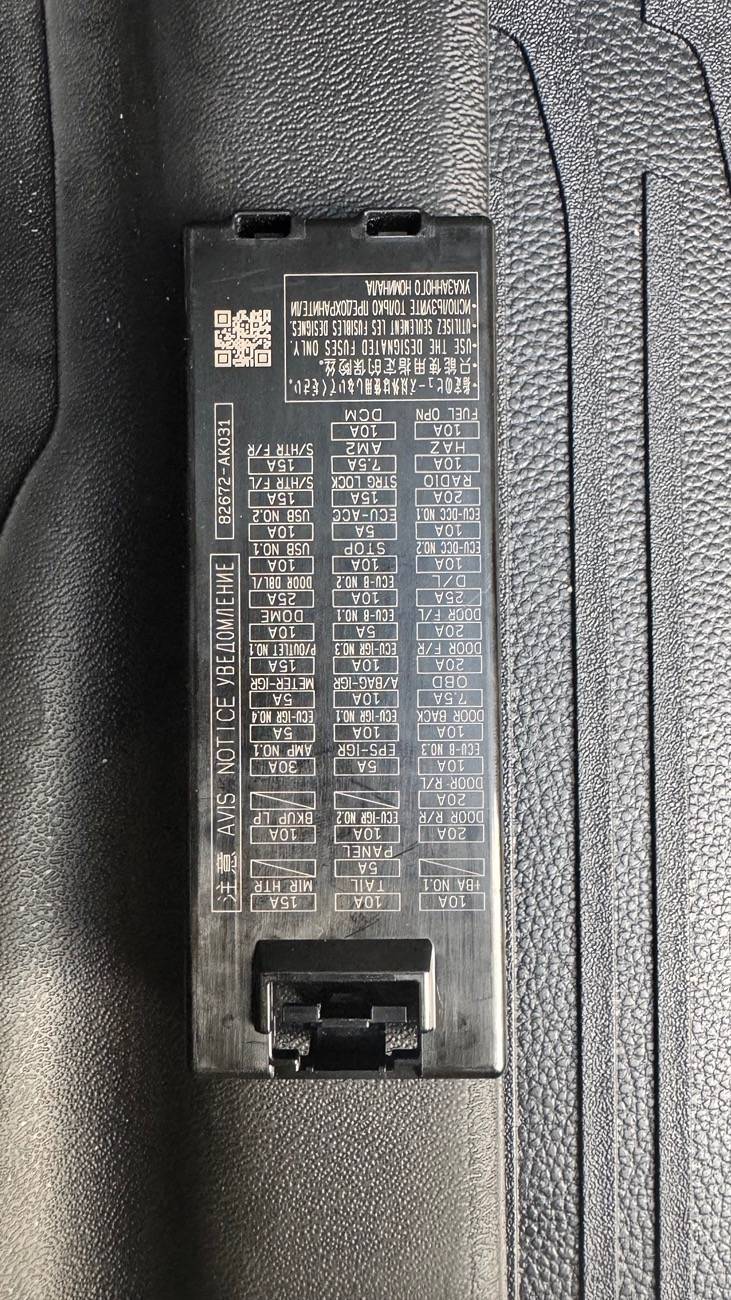

I purchased low profile fuse taps (we use low profile fuses) and pair of Knipex crimpers and crimped the fuses taps to the Garmin parking mode (hardwire cable) and asked AI (Grok) which would be the best existing fuses to use, which I believe was the ECU ACC 5a for accessory power and Dome 10a for constant battery power: (attached photo).
I will say this if you go with Garmin, I’d use Garmin only stuff for power. If you’re like me and want the DongarTech Pro adapter, your front dashcam may give you an error that says the adapter won’t charge the camera. The camera will power on but it may not record in parking mode. So I’ll be hardwiring that camera later.
