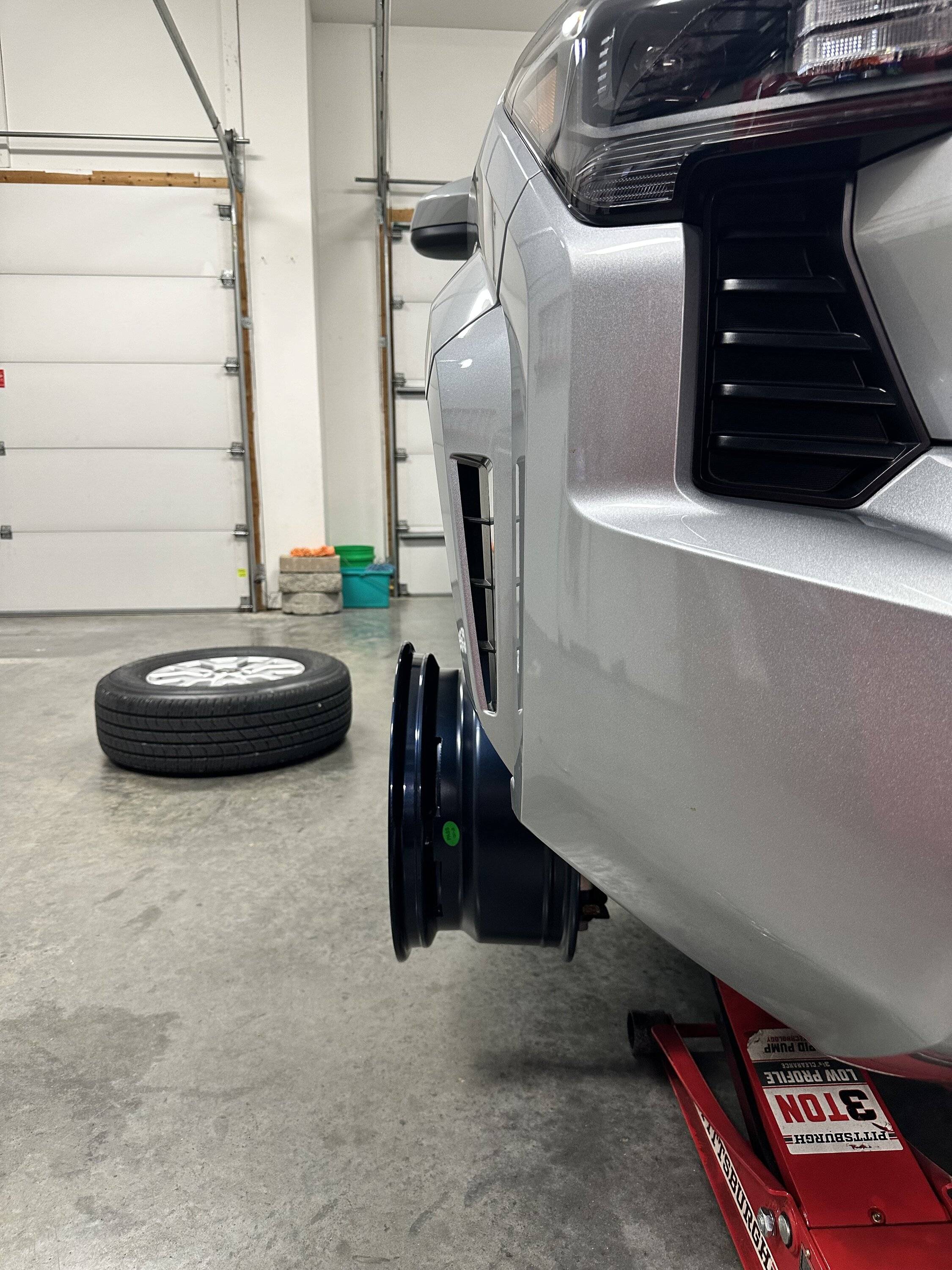

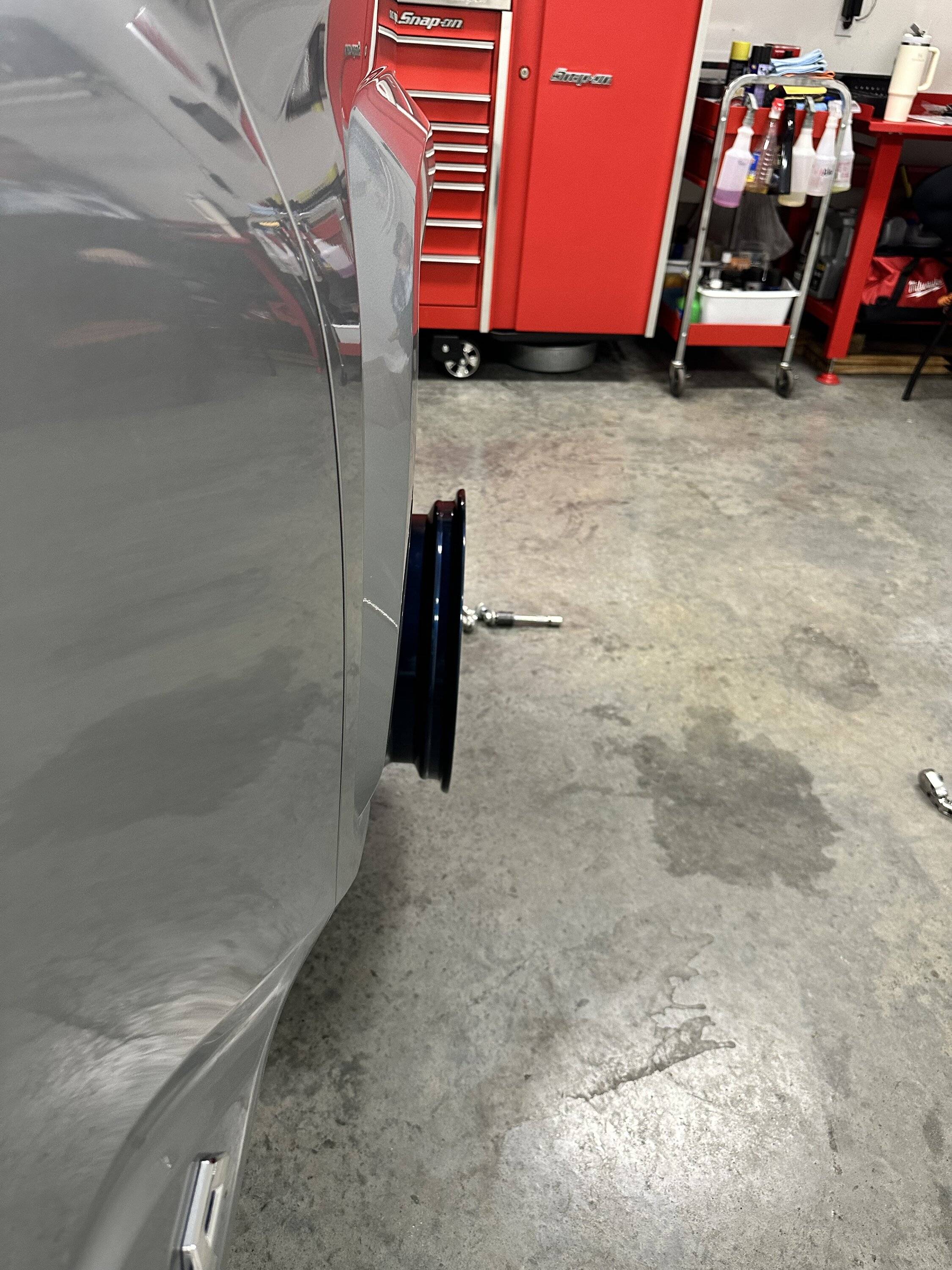

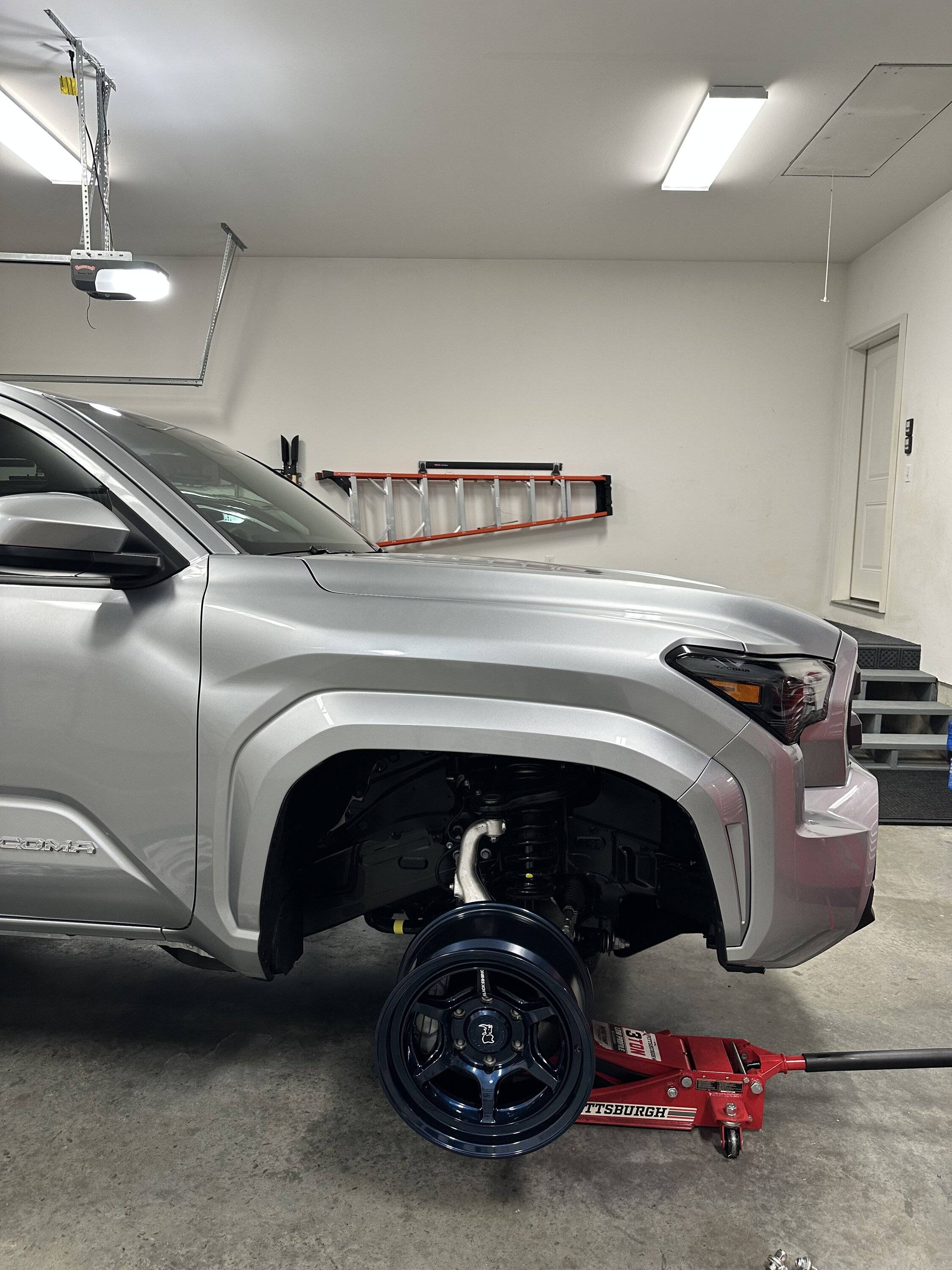

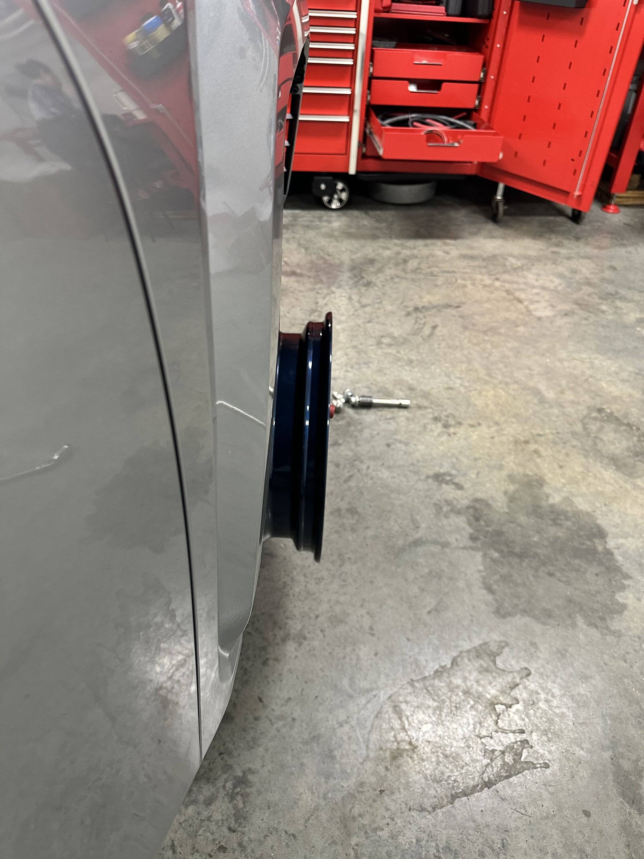

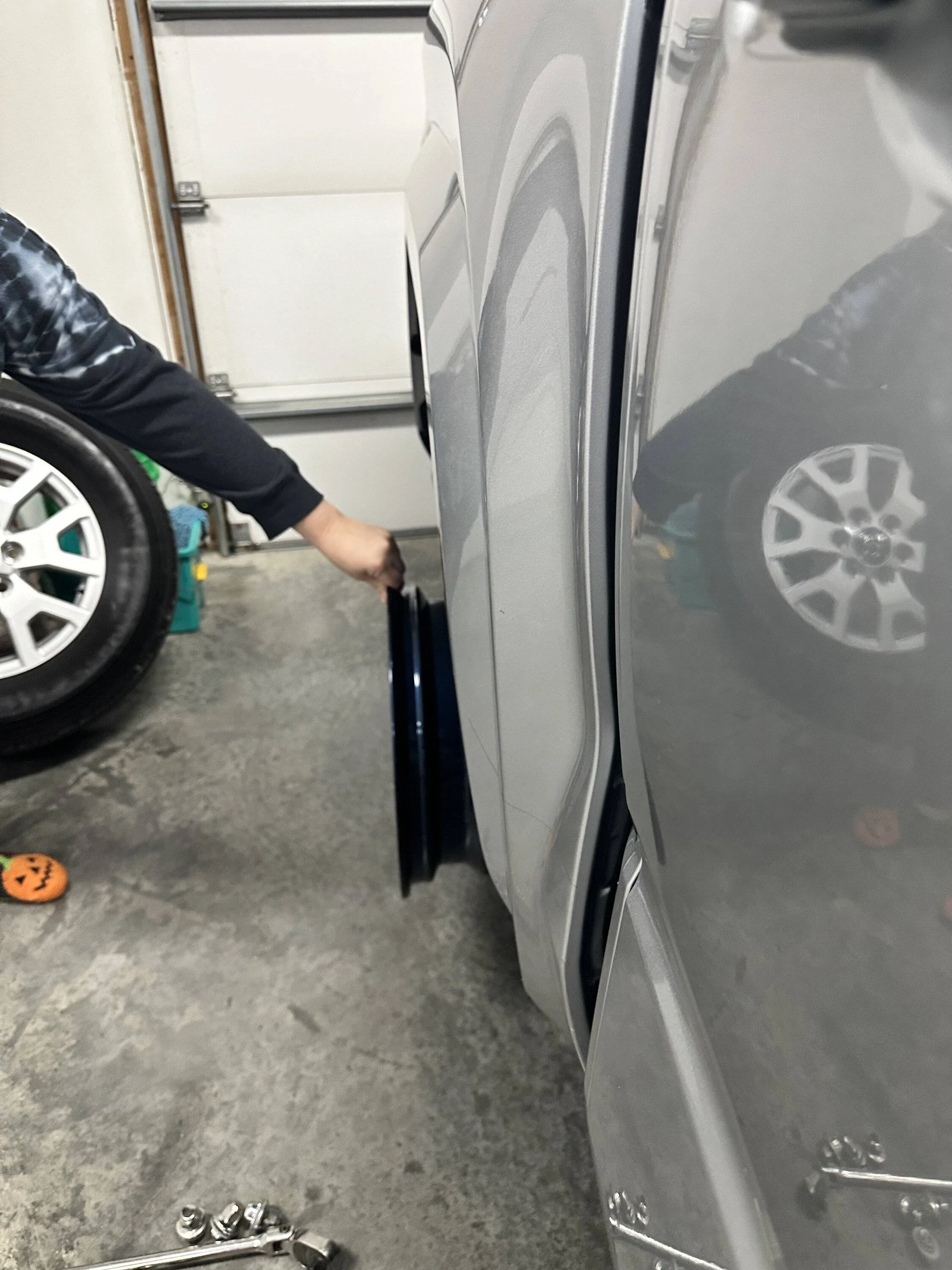

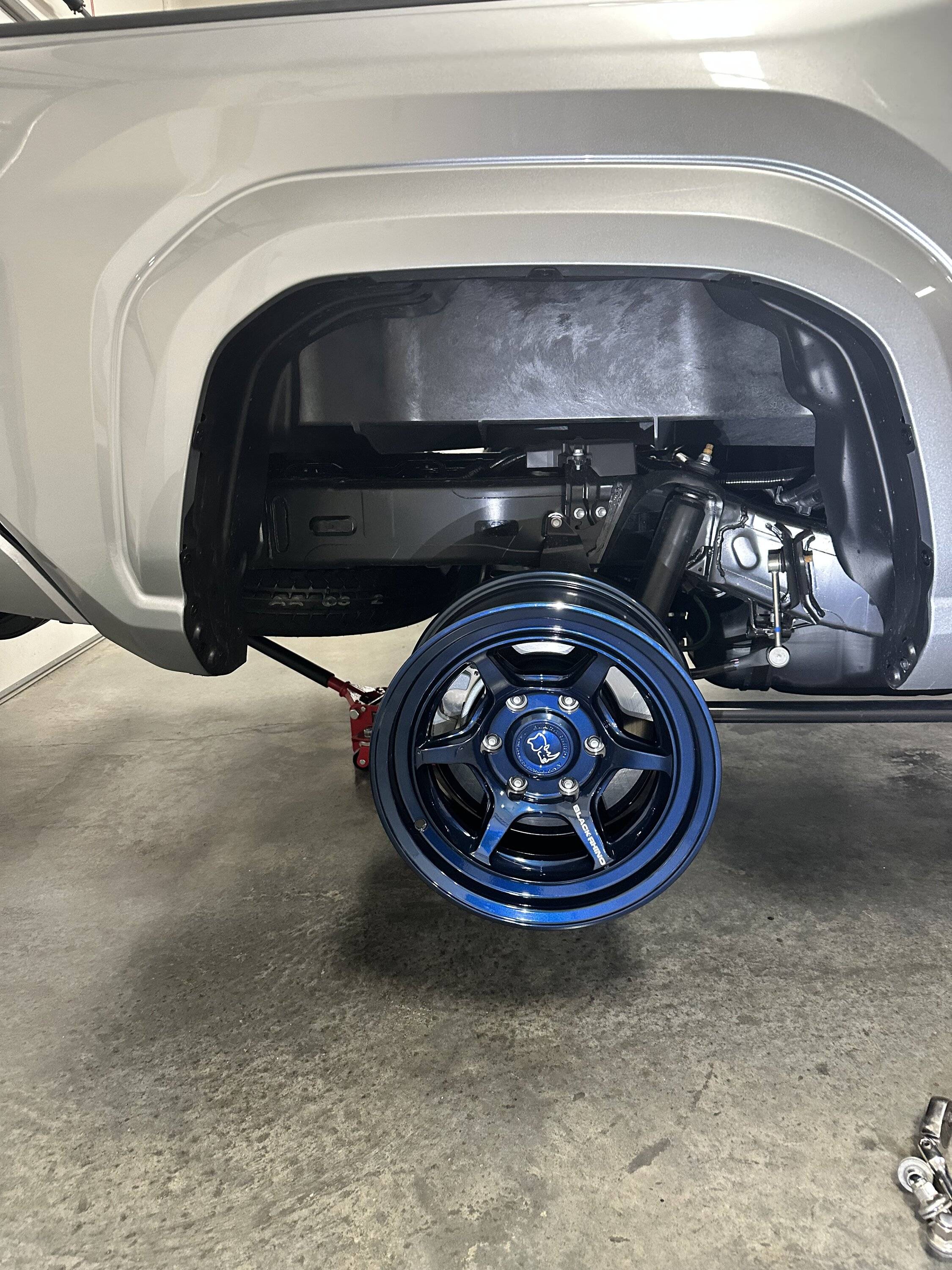

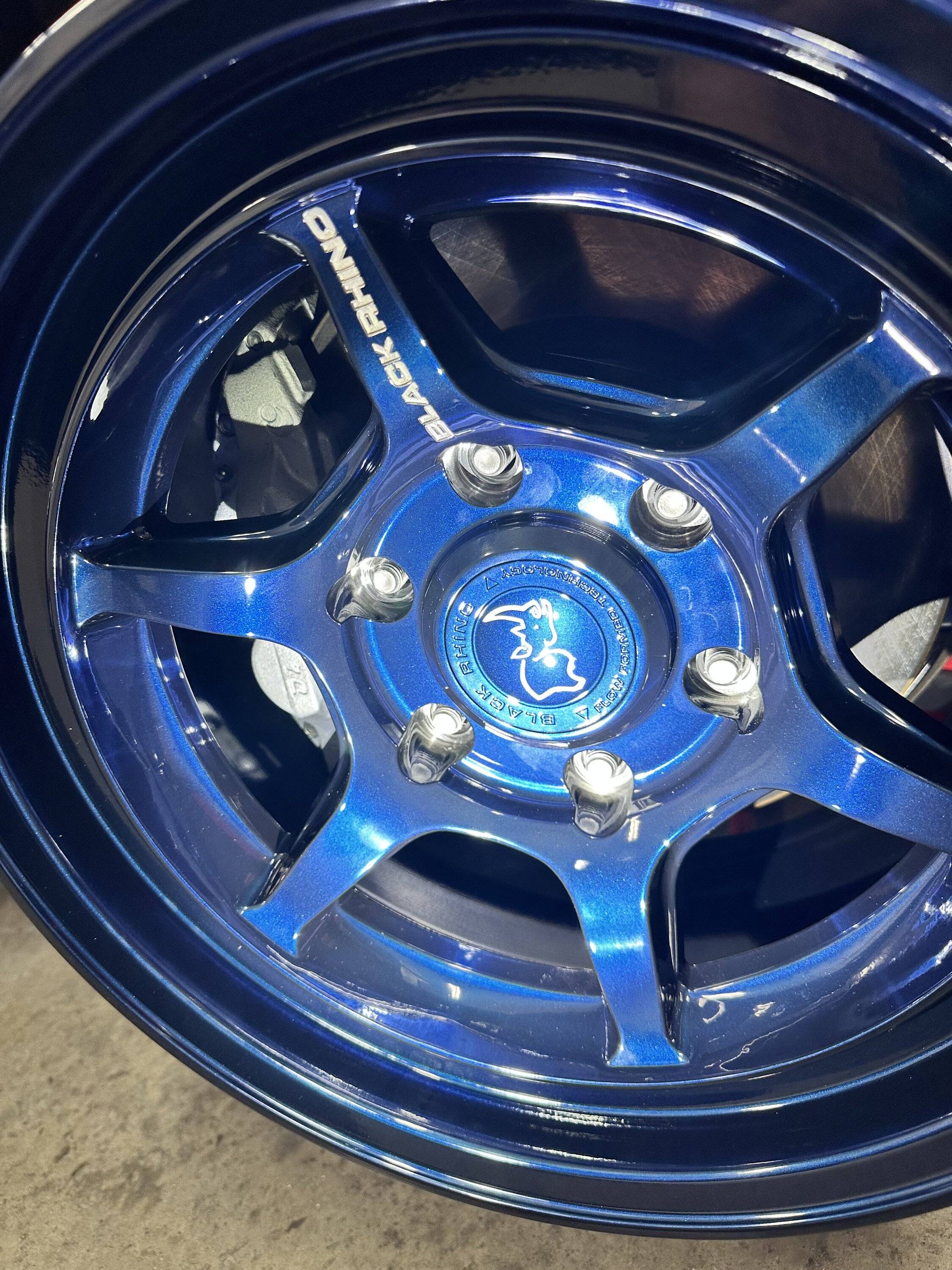

So I’m just gonna verify 16s will definitely clear just fine. This is a 16x8-10. I had just ordered these wheels for my 3rd gen a week before buying my 4th gen. Pretty sure thats a bit much poke. Other than that plenty of brake clearance. I’ll post a pic in the comments of one other similar fitment but in a 17. Flares prob help more with hiding the tire

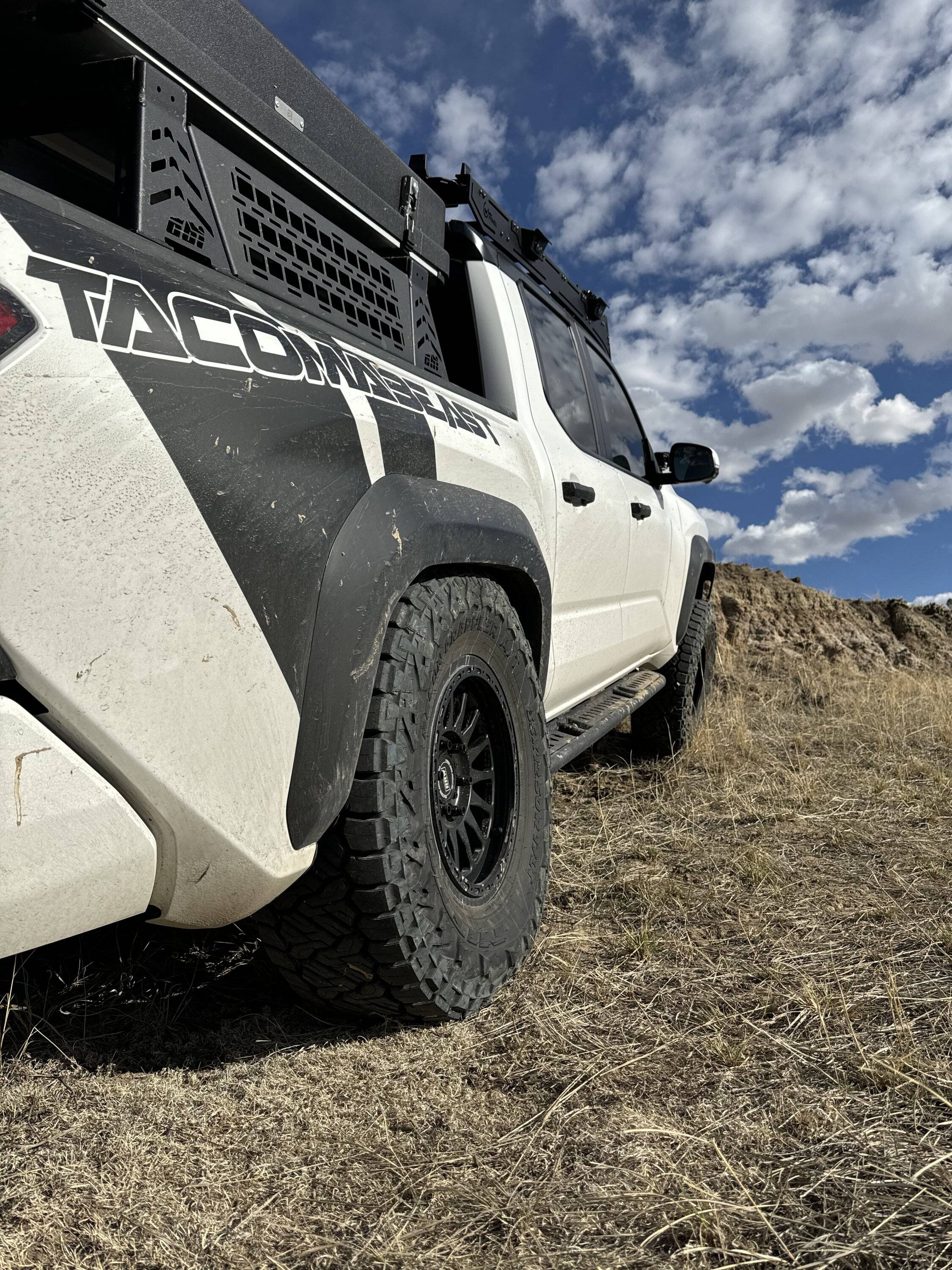

This is a 17x8.5+0 I got this
Pic from this forum. That’s pretty close to the spec listed above , just a shade more aggressive . I don’t plan to run them. If I did would run a 285-75 on them.
Do you think a higher offset 16 like the Black Rhino Stadium ET35 would fit? Is there much taper in there as you get deeper into the wheel like you would with a higher positive offset wheel?

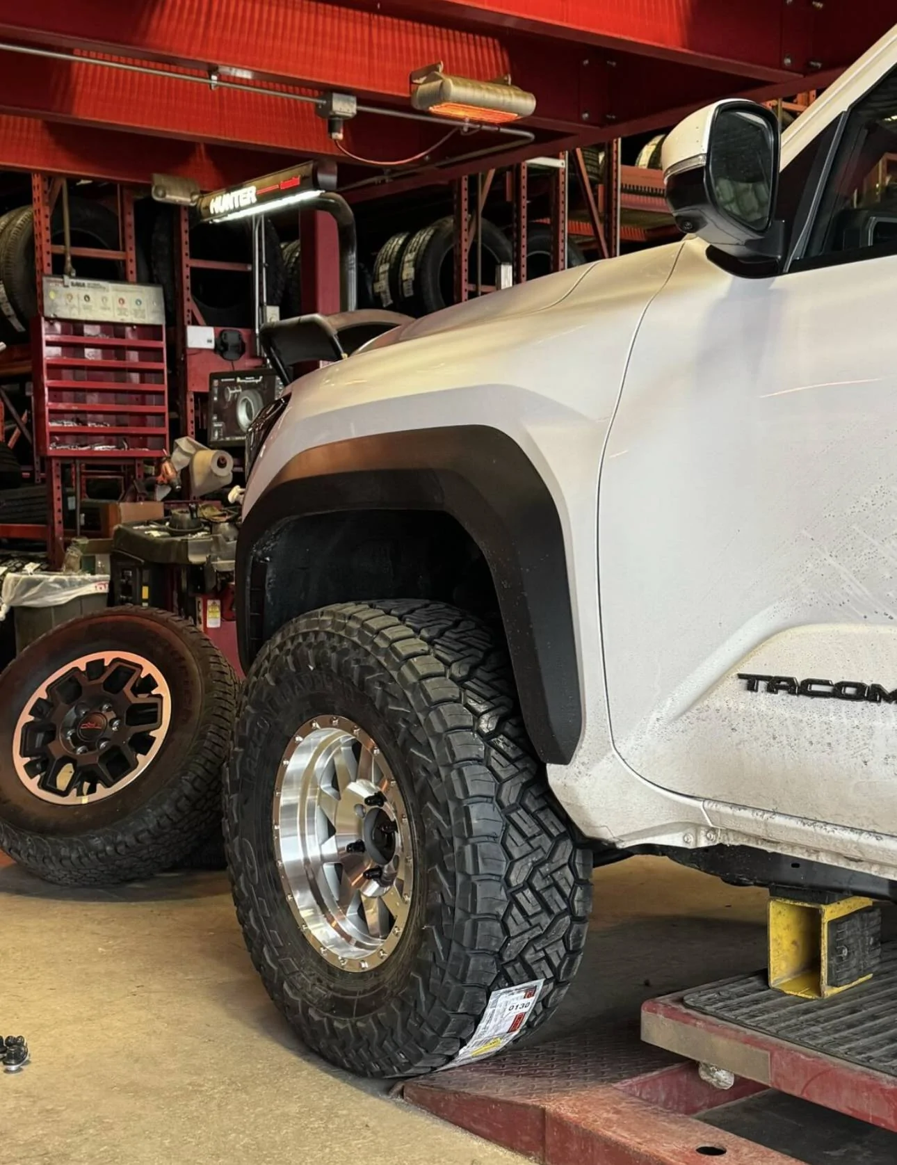

Test fitted a set of 16” TRD wheels off of my FJ onto the ‘24 Tacoma Off road non hybrid, and they didn’t clear the calipers.
